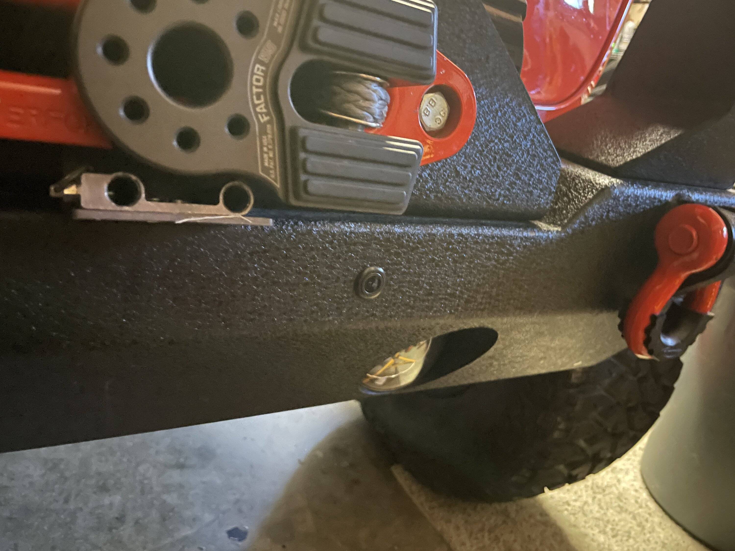

I mounted mine in the bumper. i like the location, but the Z-Automotive camera does have terrible resolution .
