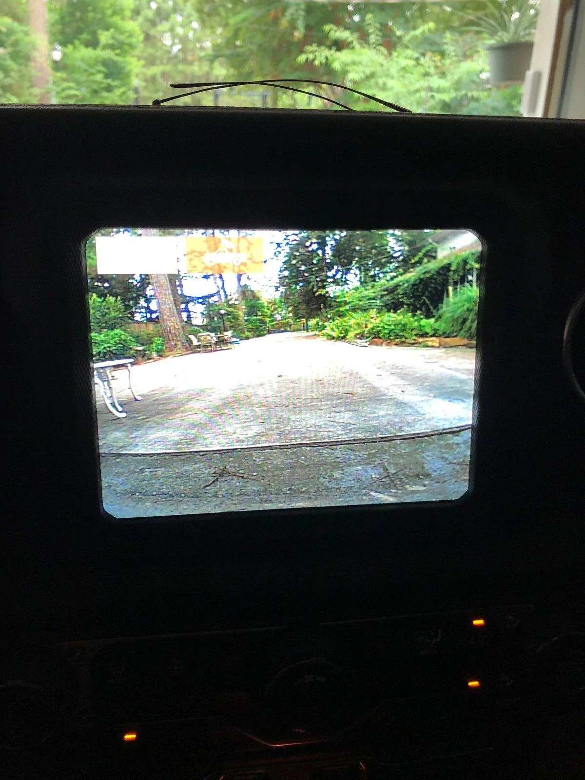

I added a front camera that I purchased off Amazon and connected it to a Z Automotive video cable. It works flawlessly with the Tazer JL. Here are some pictures.
Looks great and great info! Seems easy enough. Can you please share how you actually switch to view your front camera vs. the stock backup cam? Is there a button on the touch screen that allows you to switch between both cameras? Can you switch while in reverse and also while in the camera “app”? Much appreciate the info!
Hey db, cool mod, what camera did you use?
dbtran
D
Feb 5, 2018
76
95
2018 Wrangler JL Sahara
Once you turn on the function in the Tazer JL, there will be an icon in the settings that says "Cargo Cam." Press that button and it will come up. You can go from rear camera view to front camera view. Cool feature on the Tazer JL.

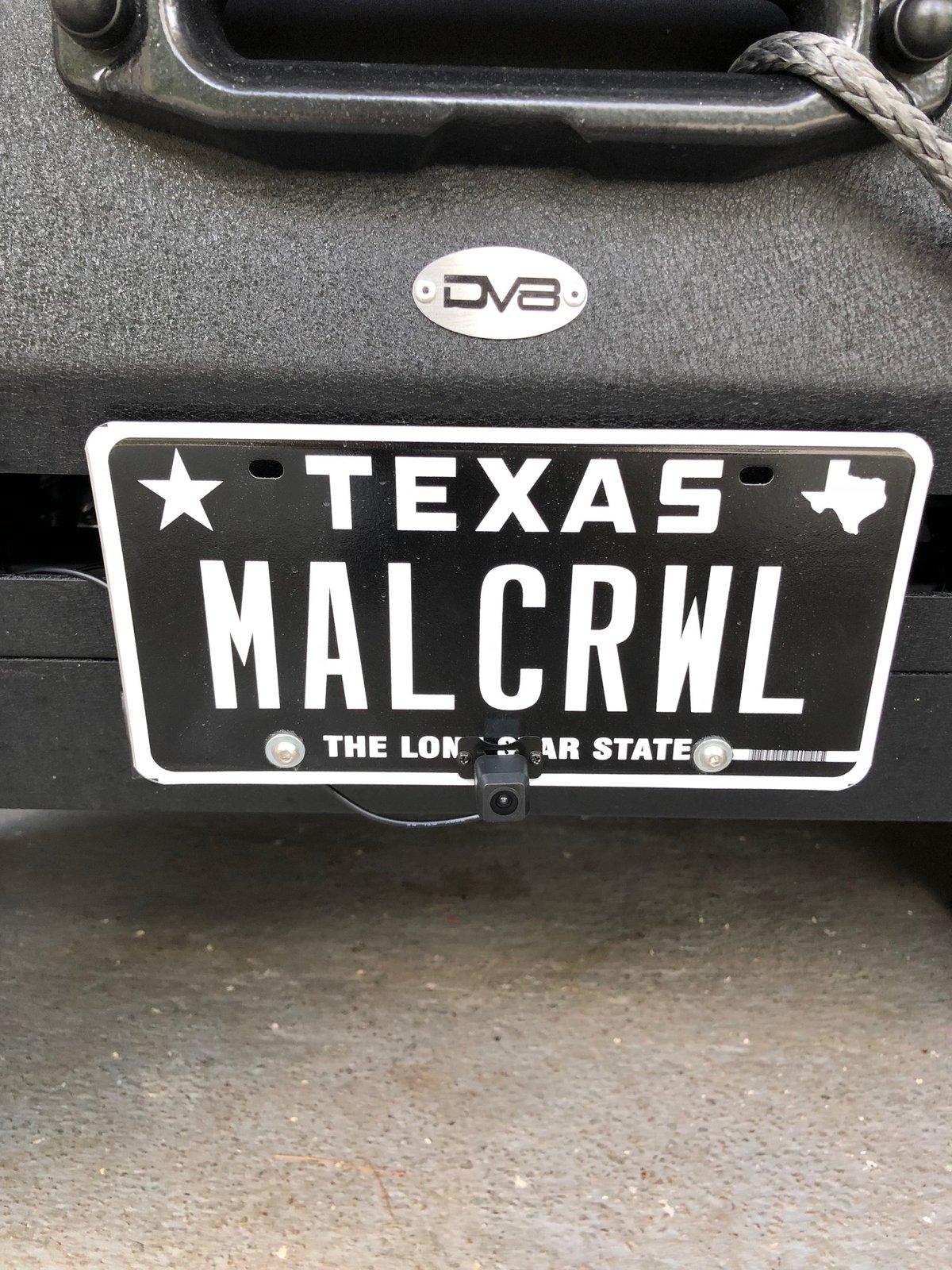

I'm going to do this as soon as the Jeep arrives and my bumpers get here.
One word of caution, whatever camera you get make sure it can be used as a front facing camera, back up cameras are mirror images. Use that on the front and everything will be backwards.
