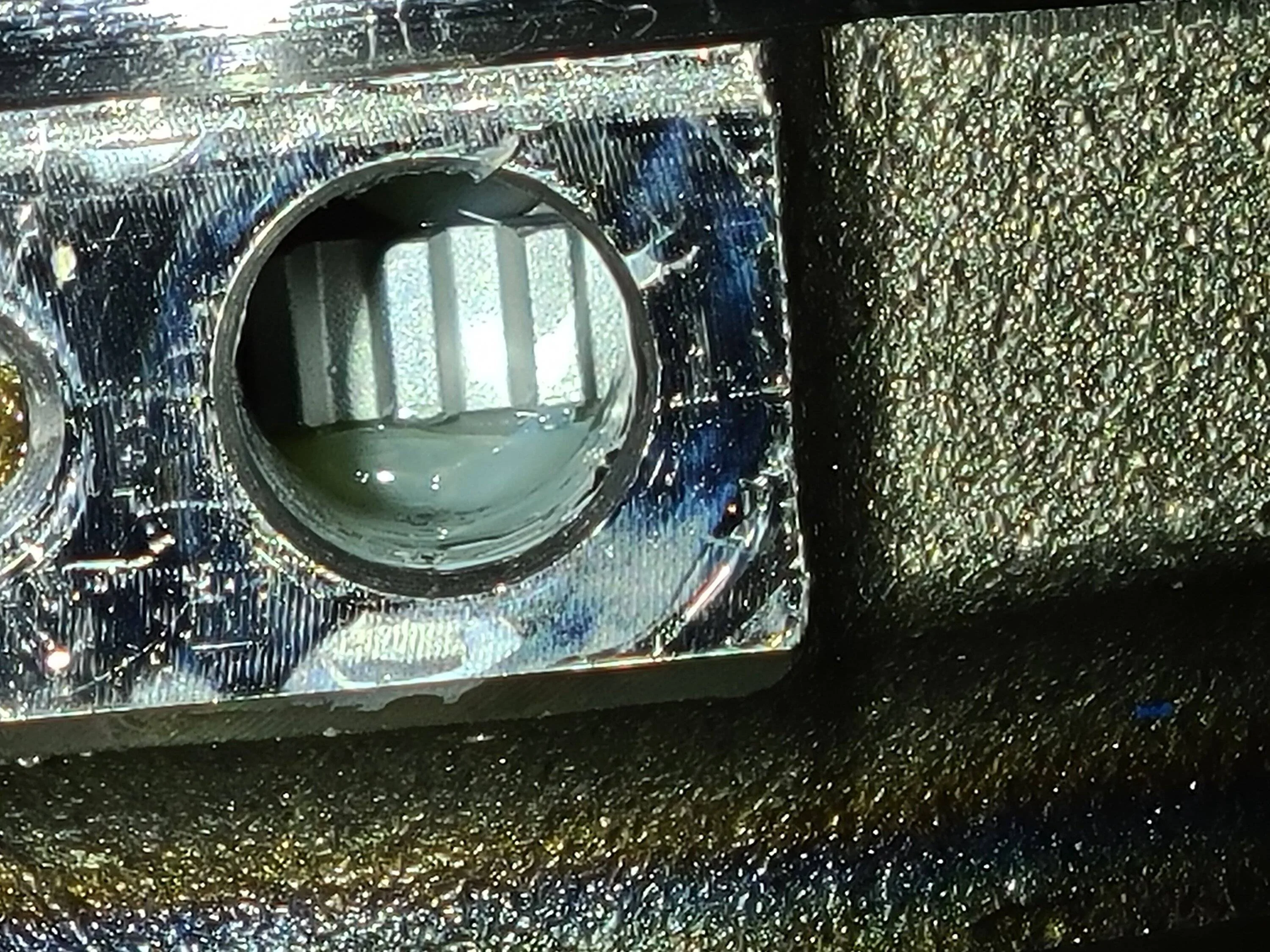

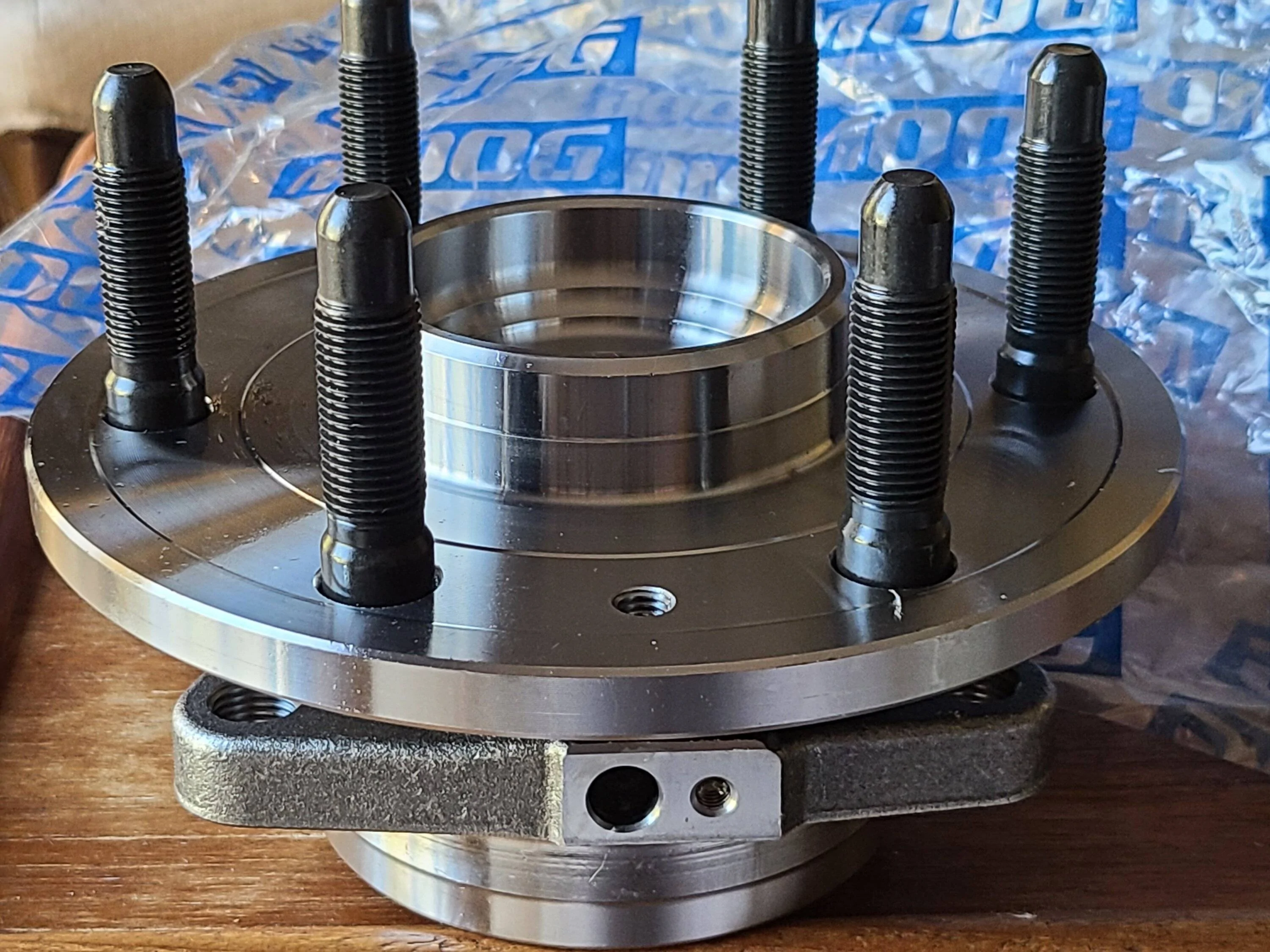

Looking at my new Moog hub for the truck, the encoder is surrounded by grease, same grease that is around the external seals, indicating its sharing the cavity with the bearings.
Jeep Wrangler JL Anyone Ever Grease A Modular Wheel Hub Assembly? 20220806_093523
Jeep Wrangler JL Anyone Ever Grease A Modular Wheel Hub Assembly? 20220806_093136
As for grease compatibility, yes it's a concern. I worked a high profile airplane accident where grease compatibility was initially implicated. I learned more about grease compatibility than I ever imagined.
