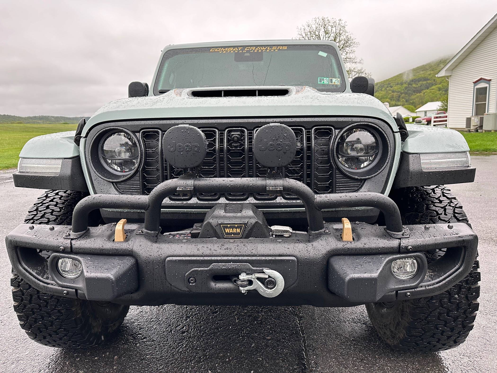

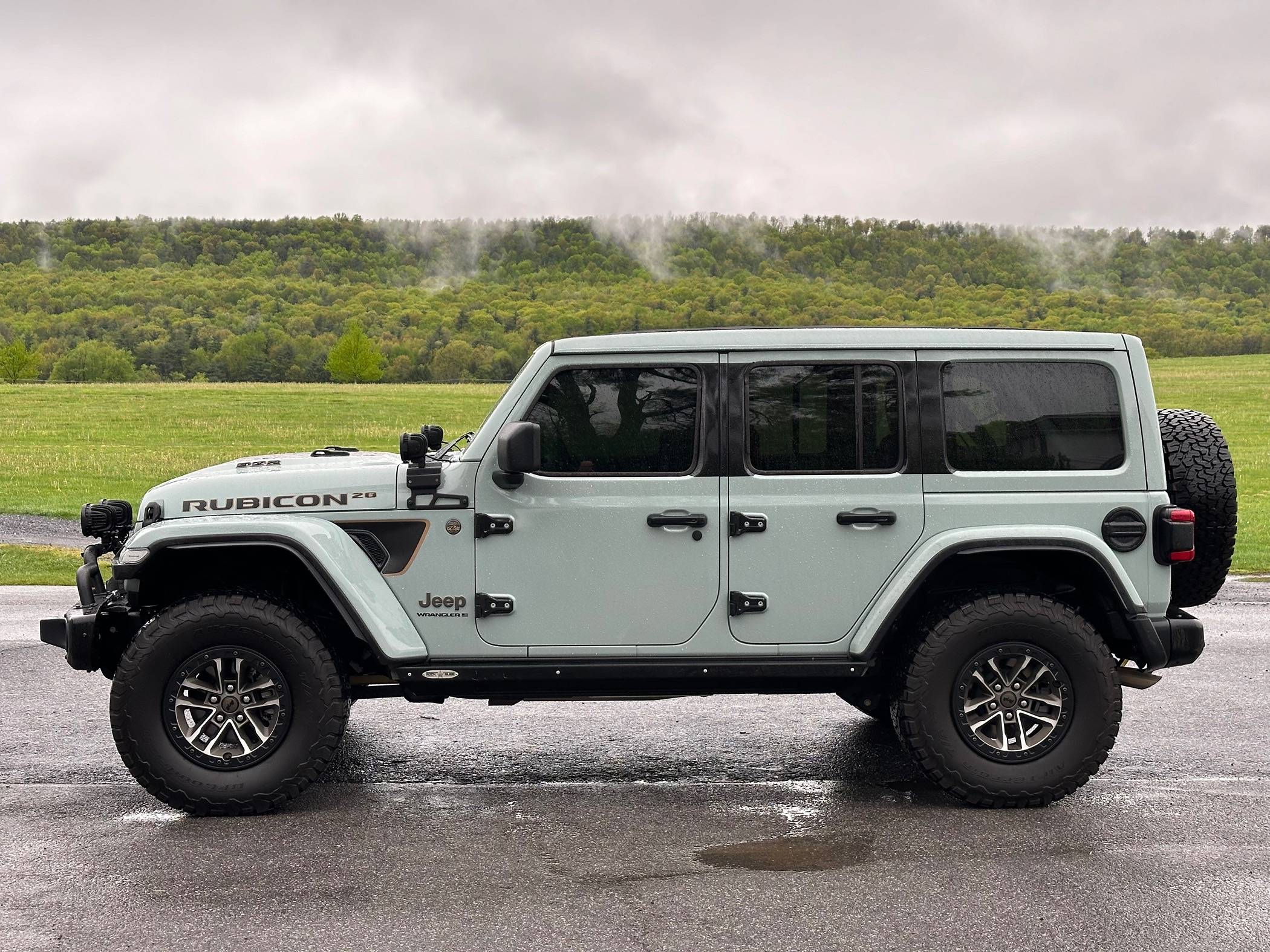

I have a question for anyone who installed 37" tires on their 392. I have a 2024 392 XR and am on the fence whether or not to install 37" Mickey MT's with KMC tank wheels 17". I actually use our 392 to check fences out in very uneven hilly terrain in storms and at 2am in the morning. I also go up mountains at the same time to check other fences that might come down along with trees. So, I use 4L and disconnect, and have full skid plates including exhaust. I'm seriously thinking of getting 37"s but don't want to lift the Jeep. It handles and drives absolutely awesome. Just wanted to know people's real-world experience before I pull the trigger. Thanks everyone. Pick of the jeep.

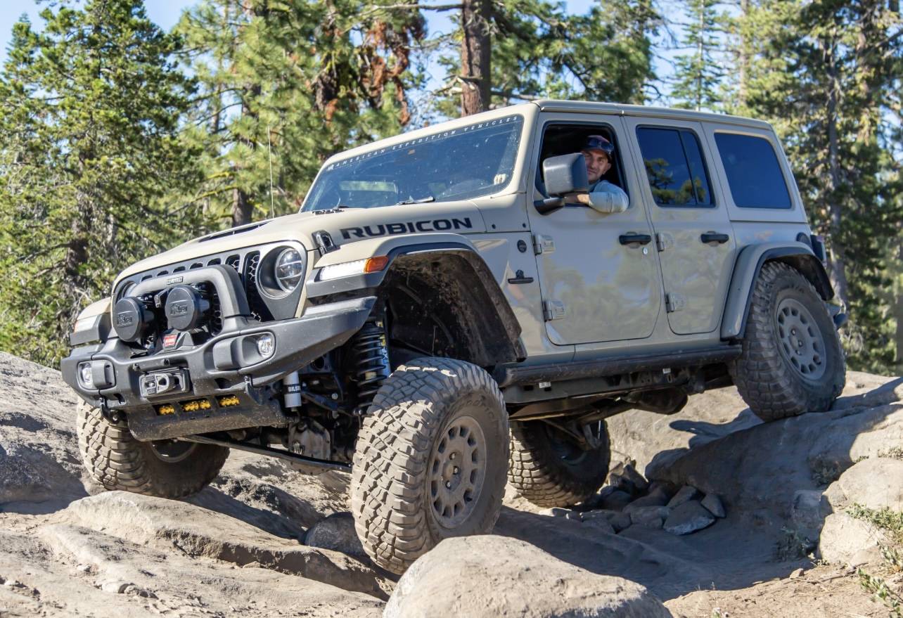

My AEV JL370 392 feels absolutely perfect. The AEV 2.5” lift and 37’s are a great combination. You can really tell AEV did their homework engineering their suspension and wheel offset around a 37” tire. Mine came with the rather rare 4.63 Nitro gears from AEV since I sent them a none XR, and they didn’t have the 4.56 ratio available at the time.
