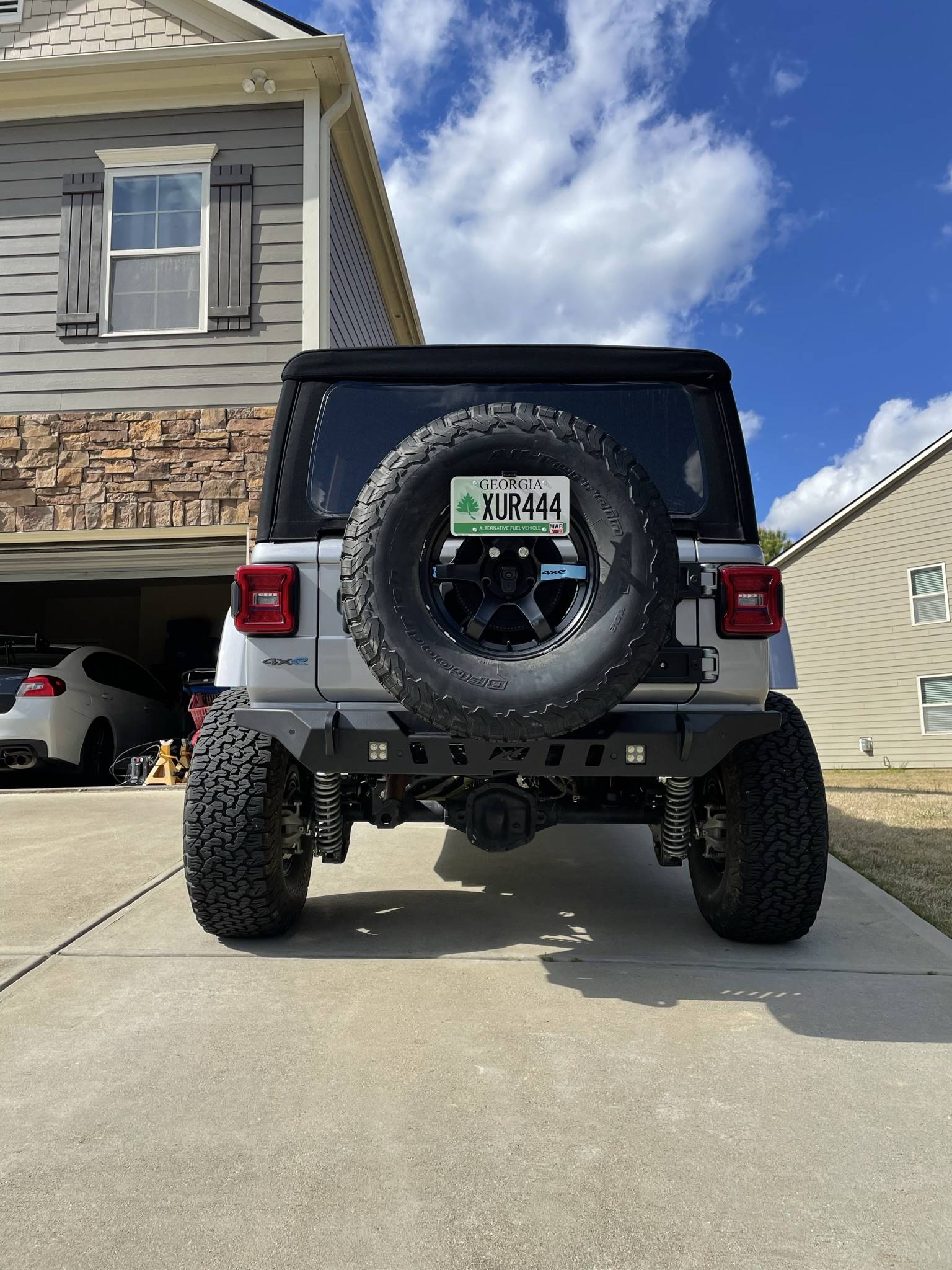

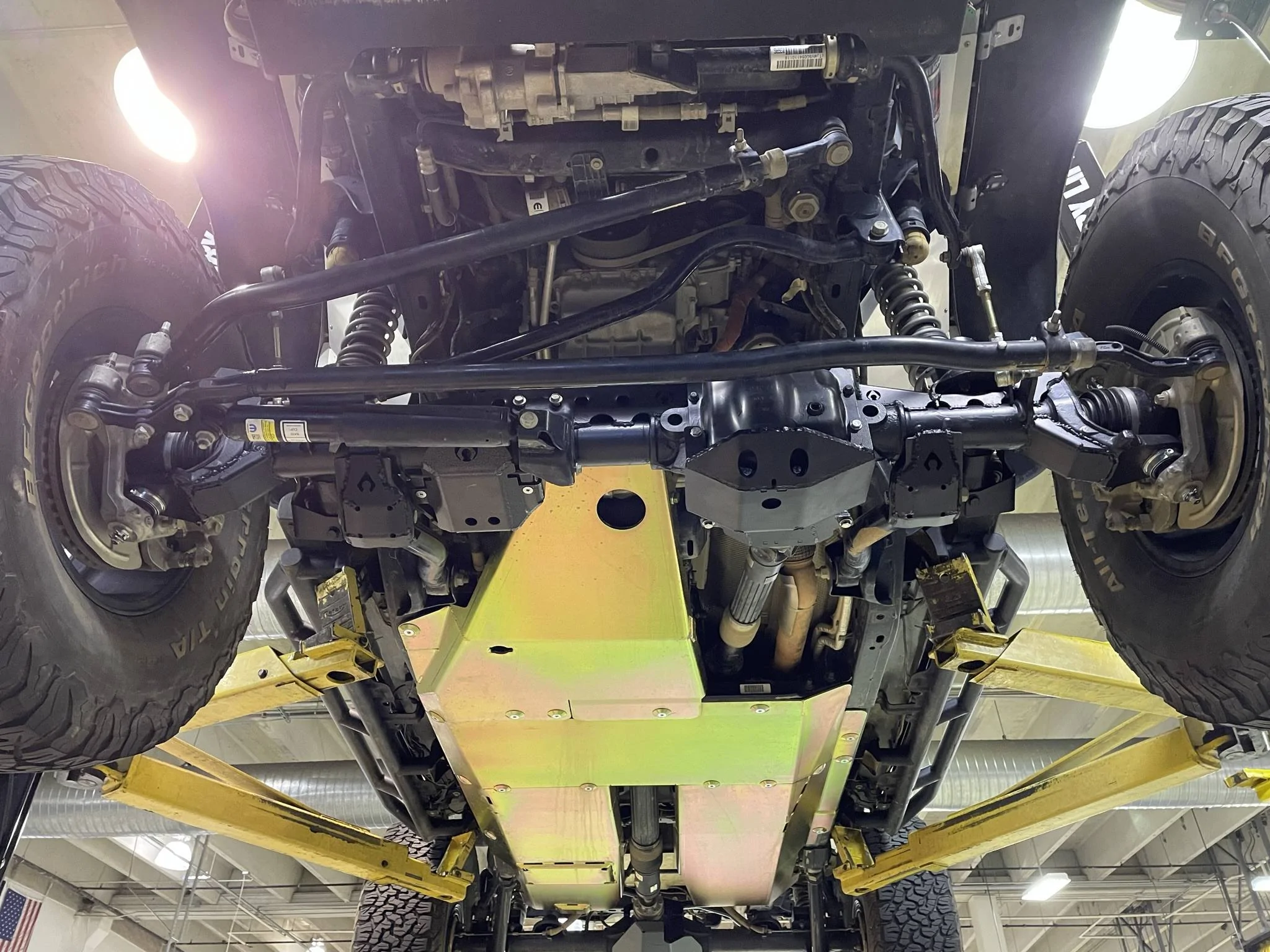

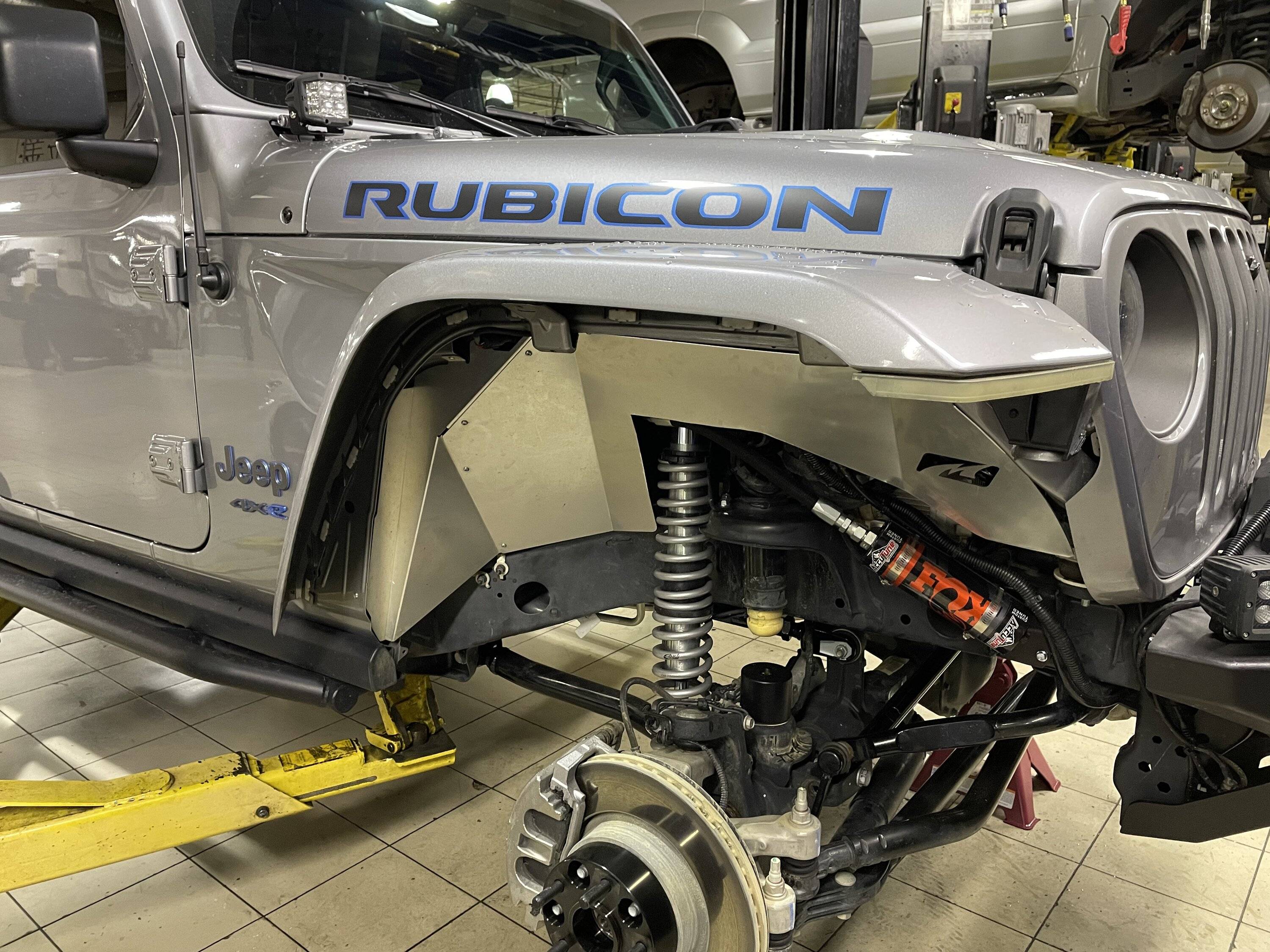

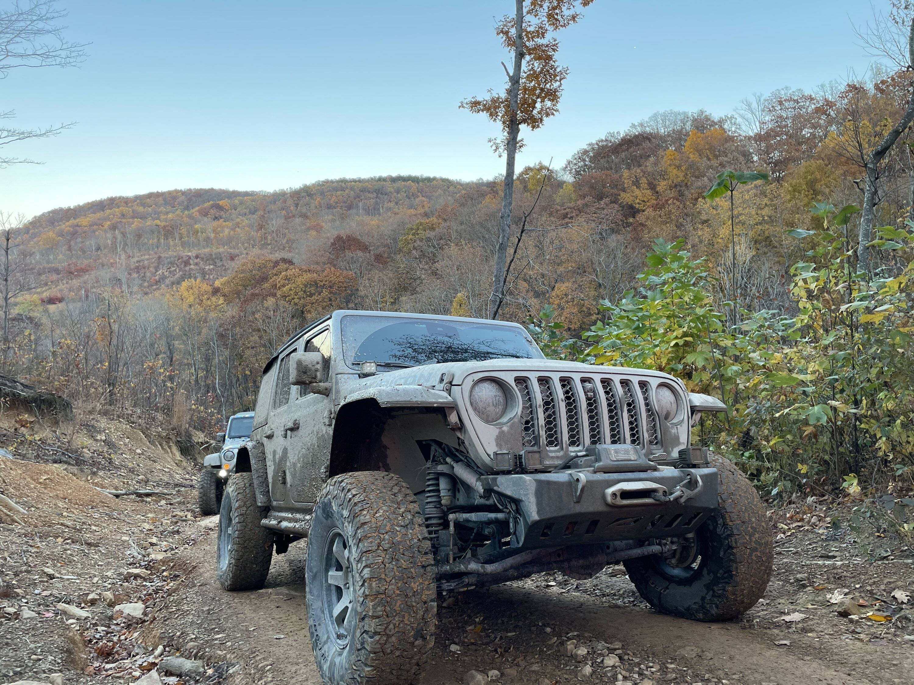

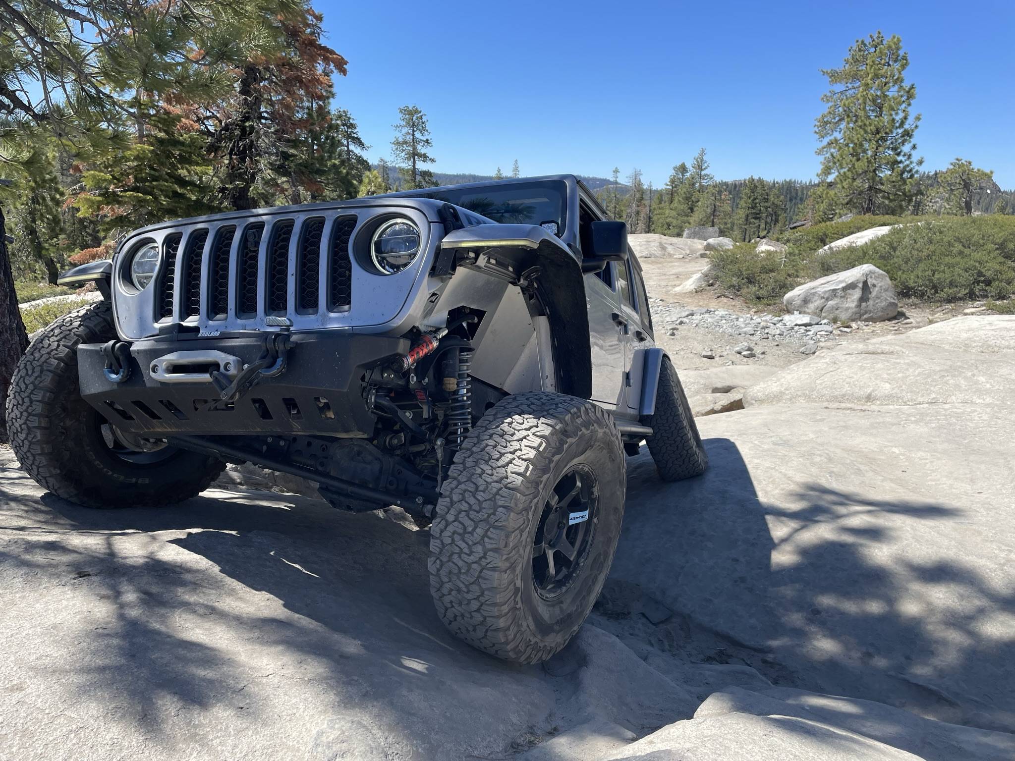

Here is mine.
accutune fox 2.0 coilovers with all adjustable arms
Metalclok skids
Artec truss/c gussets
Dynatrac ball joints
Motobilt bumpers
Ace sliders
Badland winch
Motobilt inner fenders
Aal fender chop
37” bfg k02
Motegi trail lite 17+8.5 +0 and 1.75” spacers
over 30,000 miles since the 37’s and about 20k since the coilovers went on
Been to multiple malls and 6 boh trails
Windrock-26
Windrock-51
Beasley knob
Stoney lonesome 404
Stoney lonesome switchback
Rubicon trail

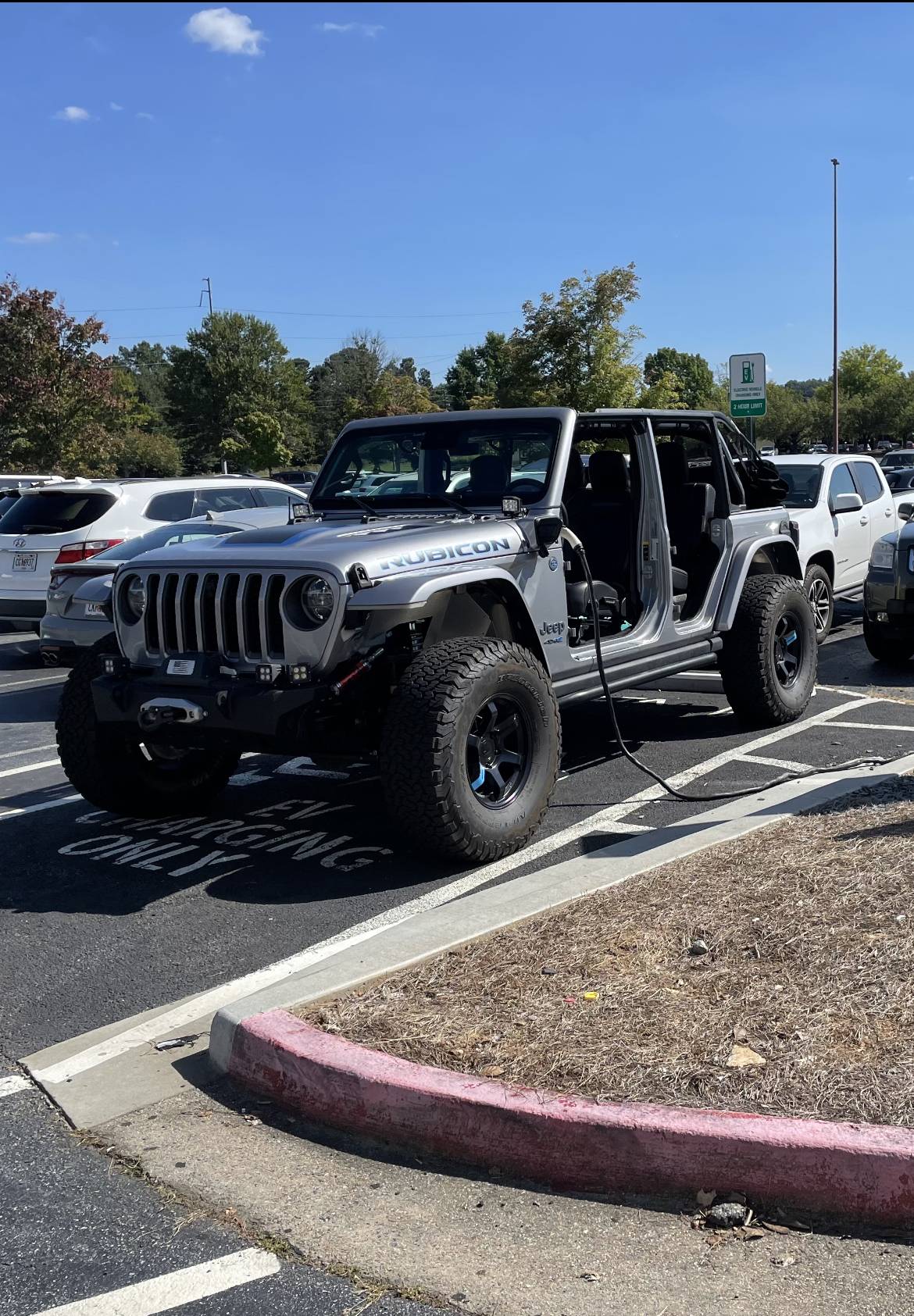

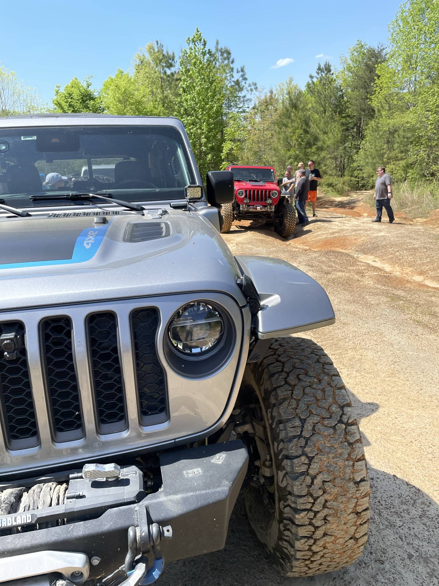

Also here is my 4xe on litebrite when I went wheeling with them:

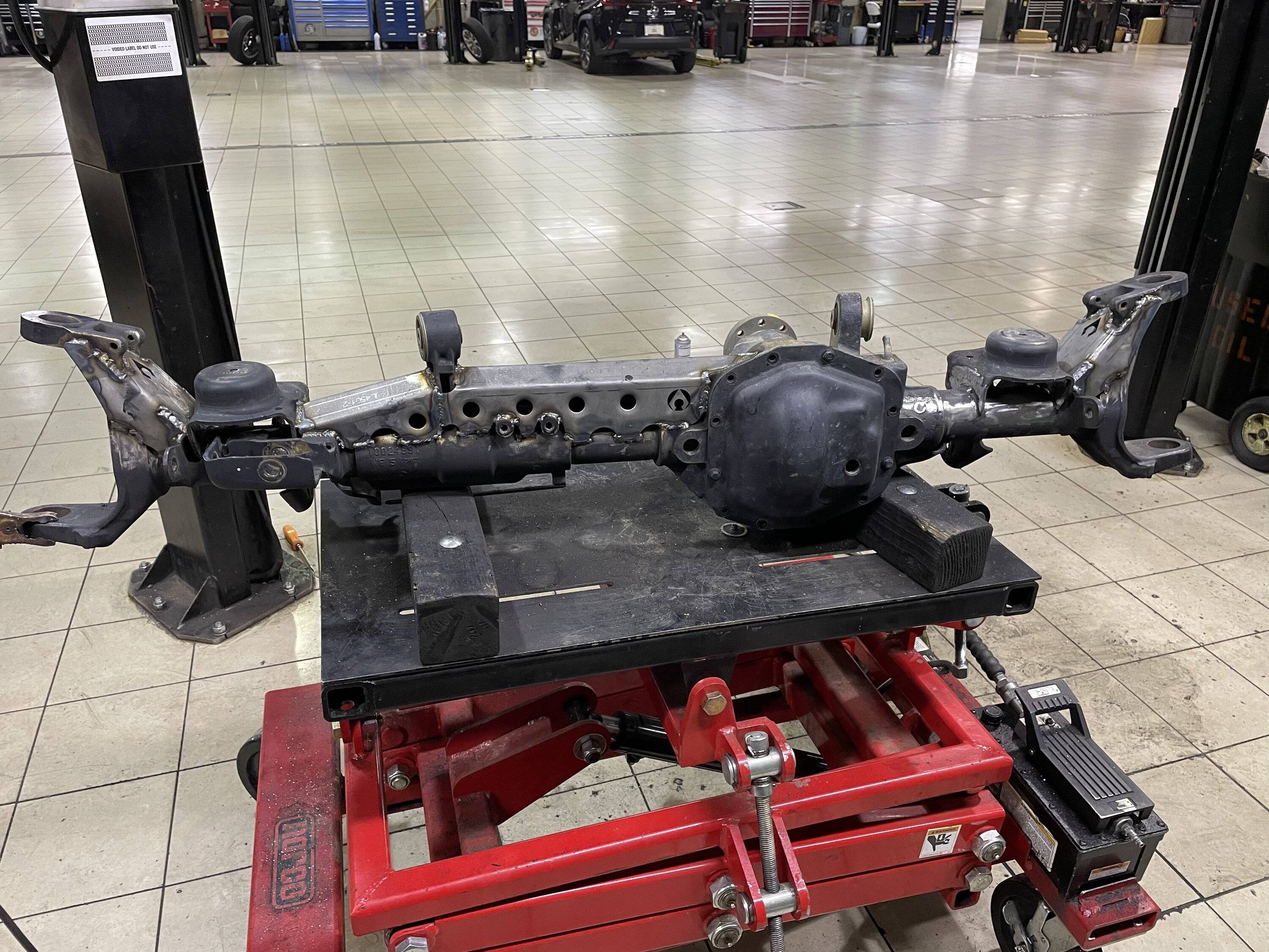

I dig the build!
I'm a little concerned about the non pre heat cast welding on the front axle truss. What machine are you using to weld? Some areas have a big HAZ and others have little HAZ.
That ground clamp is suspect and I see no alignment bar.
installer88
Justin
Feb 13, 2021
96
137
acworth, ga
2017 wrangler unlimited, ordered 2021 rubicon 4xe
I dig the build!
Thank you
I did not heat treat it. I started to, but ran out of gas. And due to the timing when I could do it at the dealer I work for, it was late at night and I couldn’t get any at the time. I did wrap i to let it cool slowly. The machine is a millermatic 211. No alignment bar was used, and I haven’t heard of that? Is it to keep the axle straight? This was my first axle I trussed, so still am learning some things. I did check the Jeeps alignment before and after to verify it didn’t warp at least.
Rocksmith
Rocksmith
May 29, 2022
41
Murrieta Ca
2021 wrangler rubicon 4xe
Janitor
What are you running on your Millermatic?
Cover gas and wire diameter?
Rocksmith
Rocksmith
May 29, 2022
41
Murrieta Ca
Janitor
My setup... for mild steel
Millermatic 255 [pulse mig]
C10 gas
.035 ER70 [mild steel]
Welding onto cast requires me to switch my setup.
75%AR 25%HE
.035 ERNiCu
The second setup is specific for cast welding and I have had good results with pre heating, peening to relieve stress and then post heat and blanket for slow cooling.
The copper nickel wire shrinks less and you don't hear the crackling glass like cold welding with ER70 mild steel wire.
Definitely pick up an alignment bar and pucks for the diff housing and axle ends.
Not to be a jerk but you need to watch the puddle. You have areas with little penetration [tall bead] and over penetration [shallow bead]. Plus, I think your setup is making it more difficult. Not that you aren't skilled but you are fighting something that may not be fixed with technique. It may be bad ground, I don't see much bare metal around your clamp.
That ground clamp looks like a 110v machine. You absolutely need to be using a 220v machine. Not a 110/220
BTW, I am no expert. Lots of people way better than me at welding and probably have different opinions. I can say this with 100% confidence... welding axles is whole different ball game.
I found that out when doing it that axles seem different. I did a lot of reading and online some people say just weld, and others say all the additional steps you recommend. Without formal training it’s hard to say what was needed. I honestly don’t know the wire or gas setup since the shop foreman got it all. Is there something I should be worried about? Would you redo them? I am always willing to learn/improve. I don’t weld for a living (lexus diagnostic specialist) and the welder we have is mainly for rusty exhausts and repairing broken shop equipment. But this is a 110-220 machine ran on 220v for the axle.
