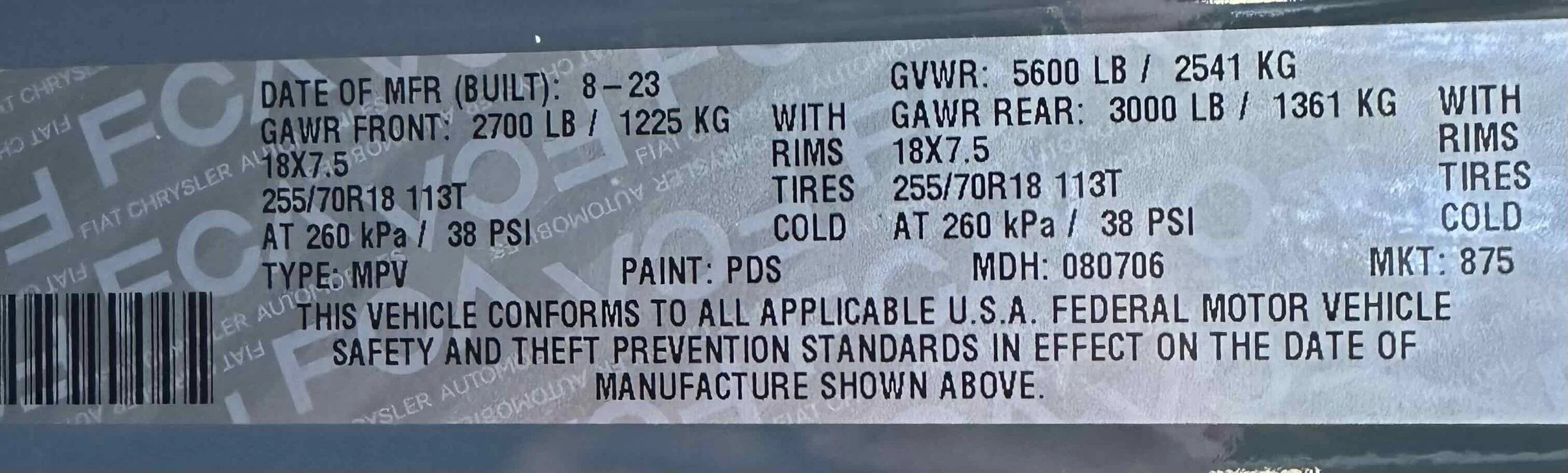

I disagree. Look at the PSi on the Rubicon door jam. They state tire pressure to be 37psi for both the 33” standard Rubicon and the Xtreme Recon 35” tire. They didn’t do any figuring there.

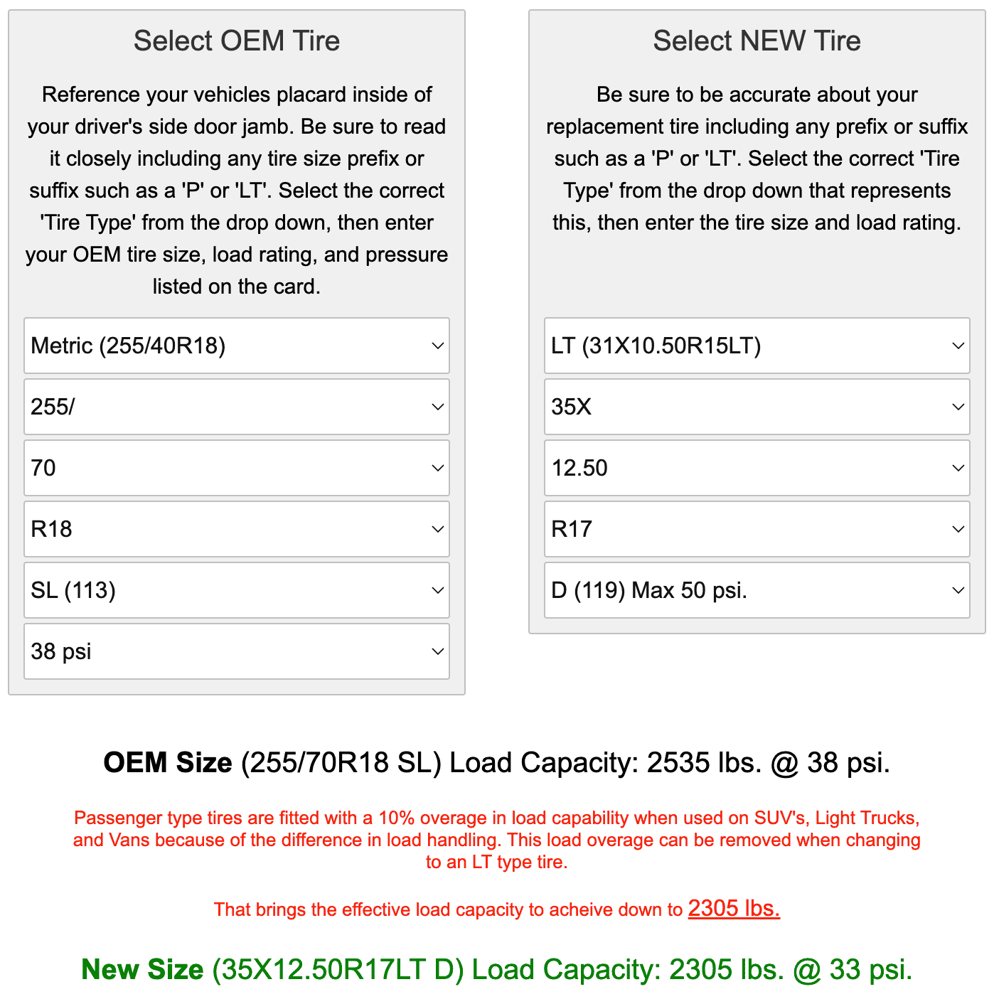

This comes out to 33 psi (which is essentially what I'm running now) and is a full 10 psi difference to the calculation above! ? ?‍♂
https://tiresize.com/pressure-calculator/
In that calculator your comparing the vehicle manufacturers tire spec not the tire manufacturers spec. That doesn’t work for our 35 tire spec on the XR.
