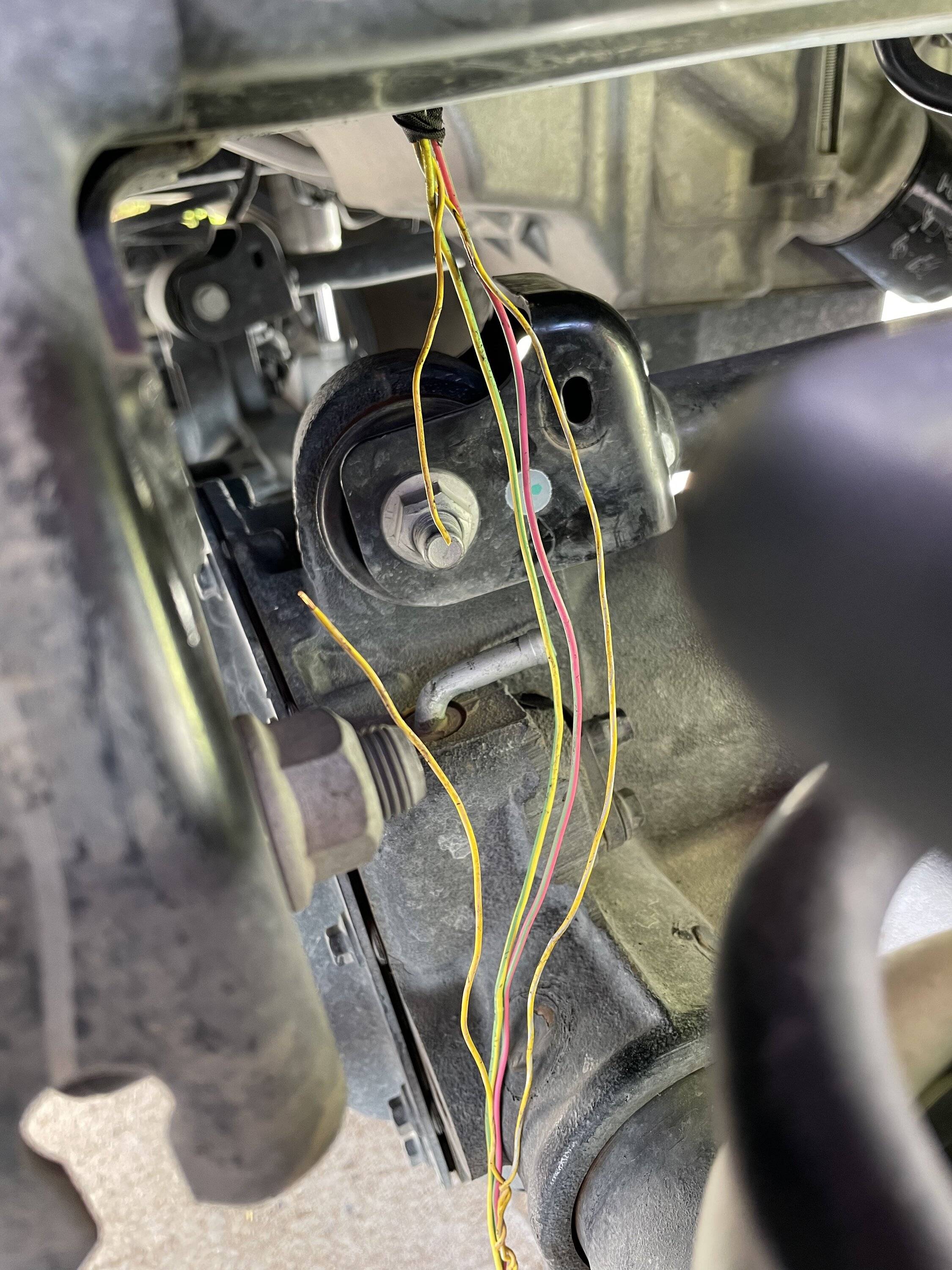

Same thing happened to my wife’s Jeep. It was broken sensor wires, both front and rear. Strip the loom off the wires and check for breaks in the harness between the chassis and the connector on the axle. I fixed the break and all has been fine for 5k miles.

Thanks! I was wondering if it was something like this, but not sure where to look. I'll check that out next time I can crawl underneath!
