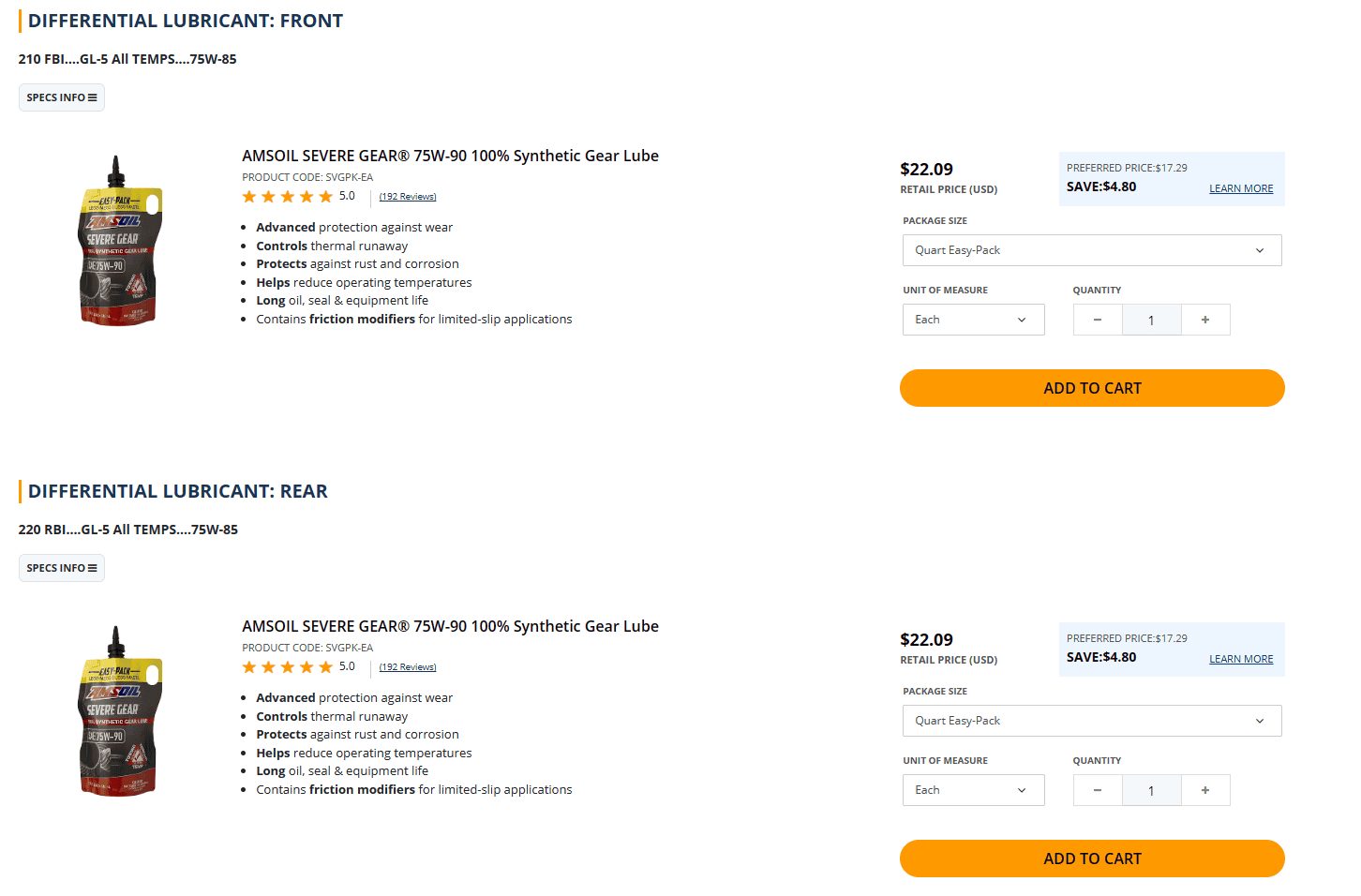

I am looking at Amsoil and from what I can tell, below are the correct ones, both contains FM:
Jeep Wrangler JL Another Differential fluid thread 1702528476931
On Amsoil website, there are 2 listings of 2.0 L turbo.
Jeep Wrangler JL Another Differential fluid thread 1702528563268
Any idea what the differences are? doesn't matter which option I select it seems like the oils are the same.
The 4XE has a 2.0 gas engine. I bet the number in brackets is the VIN code for whether it's a standard 2.0 or 4XE 2.0 with electric motor. The 392, 3.0 diesel and 3.6 engines will have a different code.
But regardless of the engine, the axles are pretty much the same. There is little to no difference between them as far as oil needs go.
Spec is for 75w90, Dana recommends 75w140. You can use friction modifier in any stock axles. You need it if you have the limited slip.
If you install a TrueTrac, they recommend not using friction modifier since it affects the torque bias. But that's the nature of helical gear limited slip.
