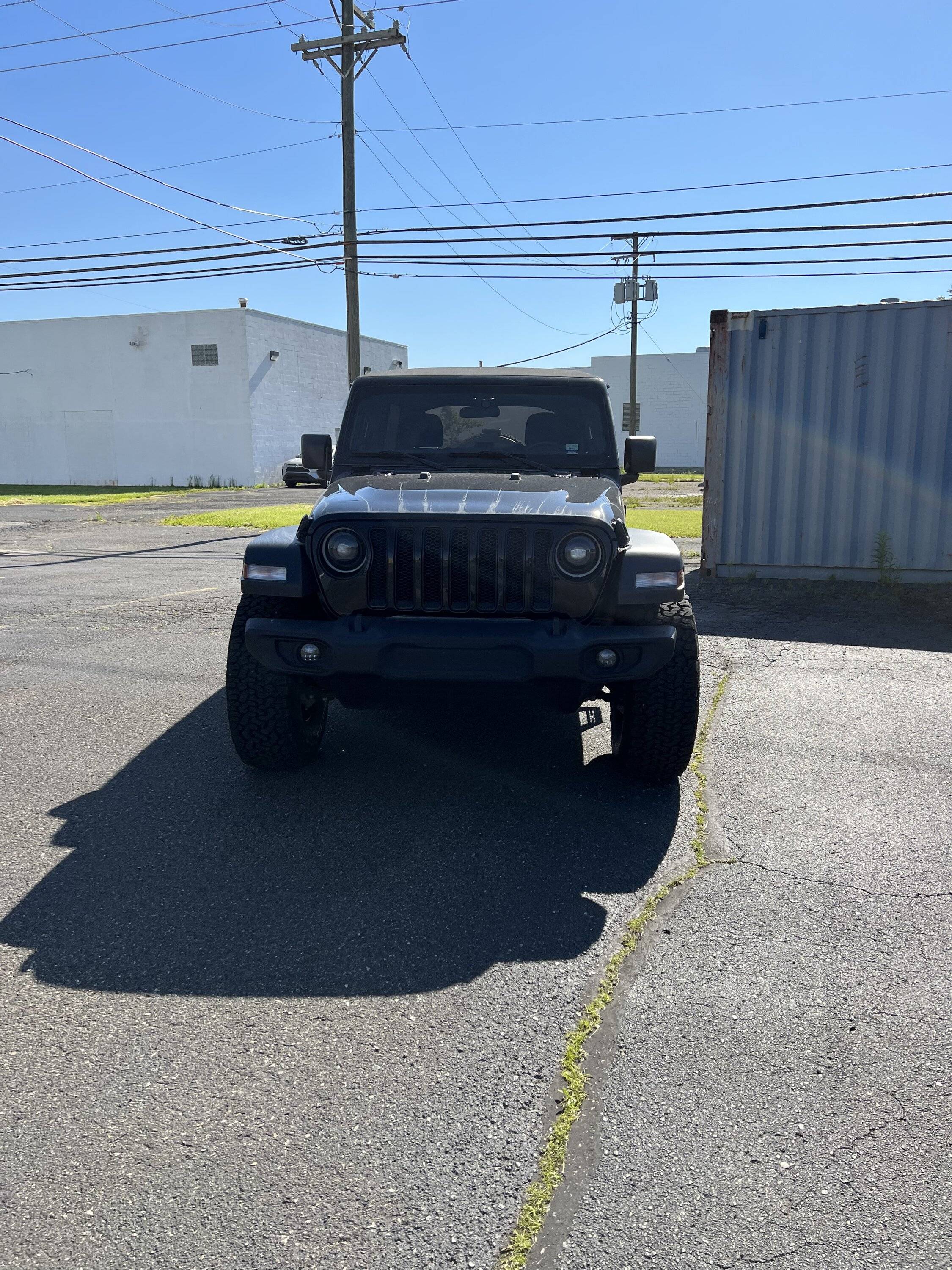

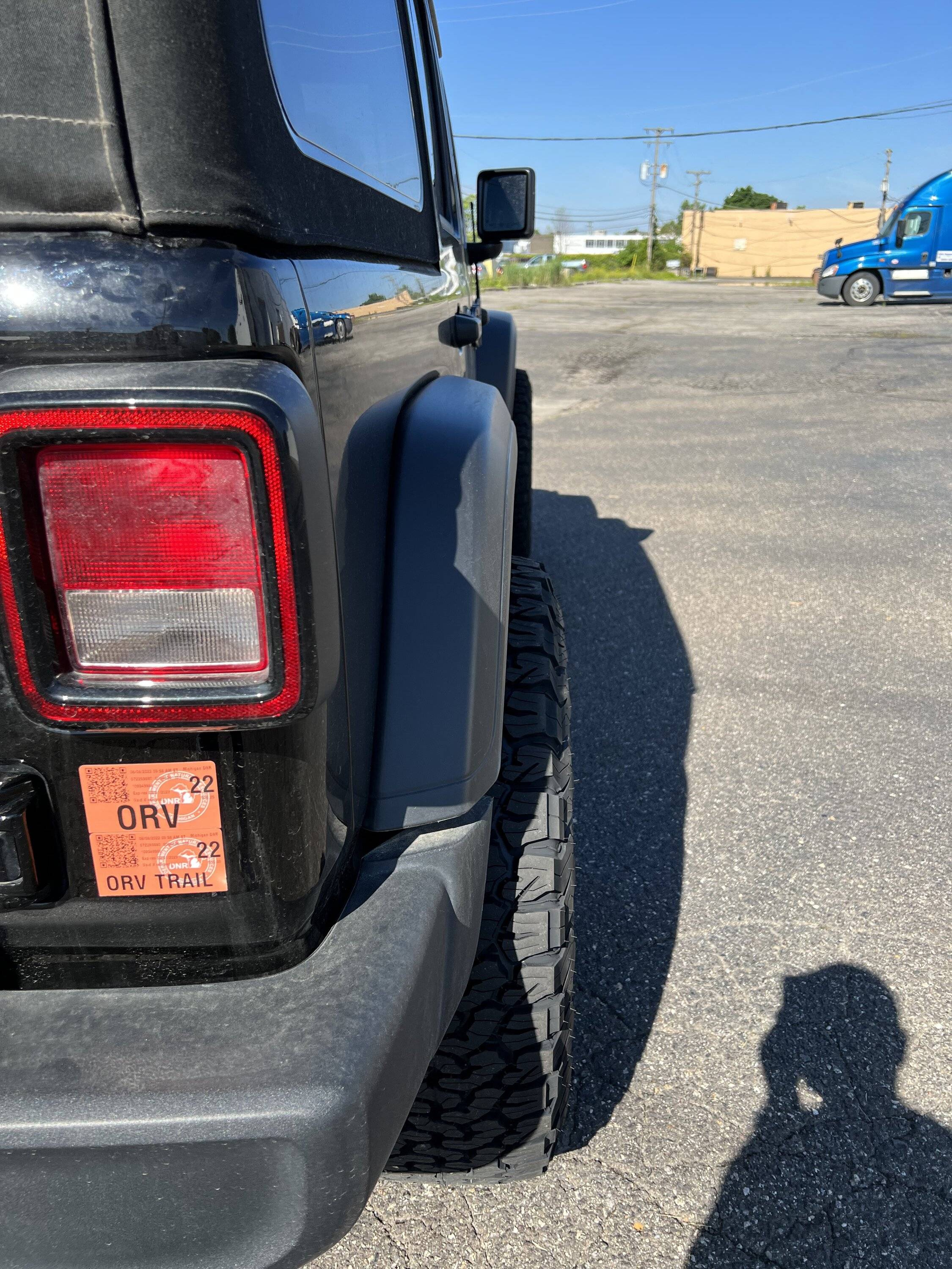

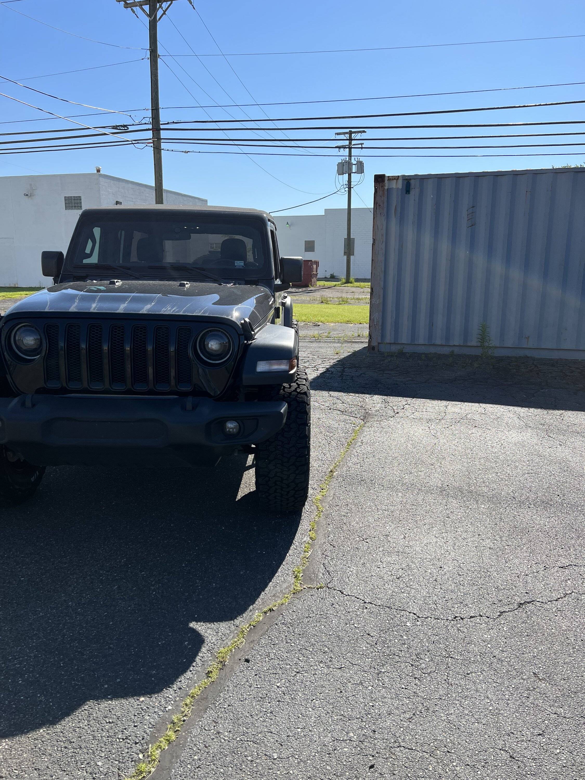

New wheels and tires on and it landed exactly where I wanted it.
Jeep Wrangler JL Another 35 spare tire question 3DF512A8-F08C-4F73-AB12-8AAC593E32B4
Jeep Wrangler JL Another 35 spare tire question 14C297F9-865A-41B0-B1DF-6B699283C997
Jeep Wrangler JL Another 35 spare tire question CD914333-4037-4CCD-AC6F-0F2F1308BA89

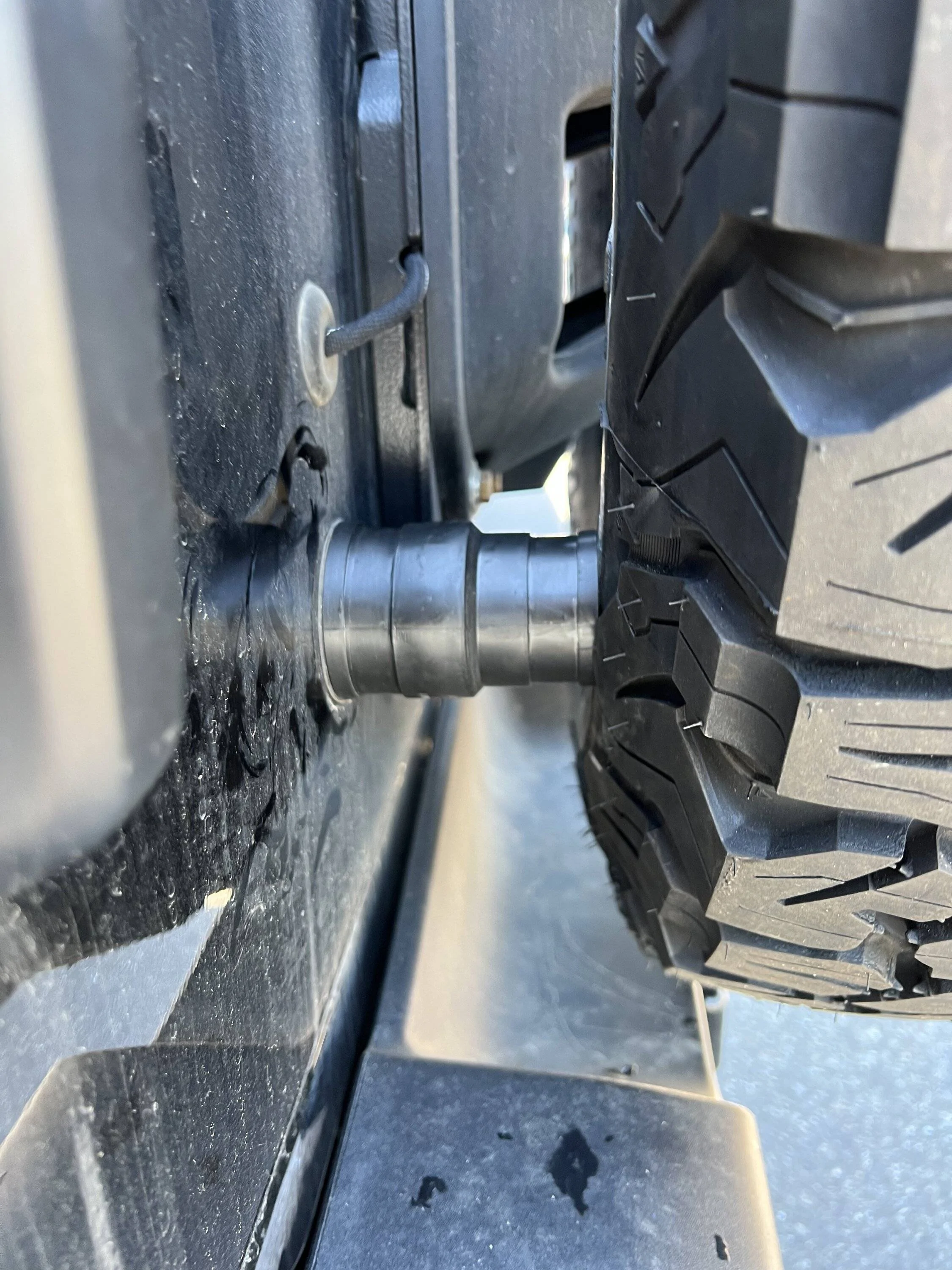

Got the bump stops extended also with the pvc couplers. $17 at lowes.
Jeep Wrangler JL Another 35 spare tire question F9899F7A-327F-45F2-8AD4-DD71310FAFFC

A little bit of poke but not too much. Looks really good.
The reason I worry about too much poke is that apparently in IL you can get a ticket. From what I have read they generally don't ticket for tires poking past fender but best not to tempt fate by going over the top and yours looks perfect.
