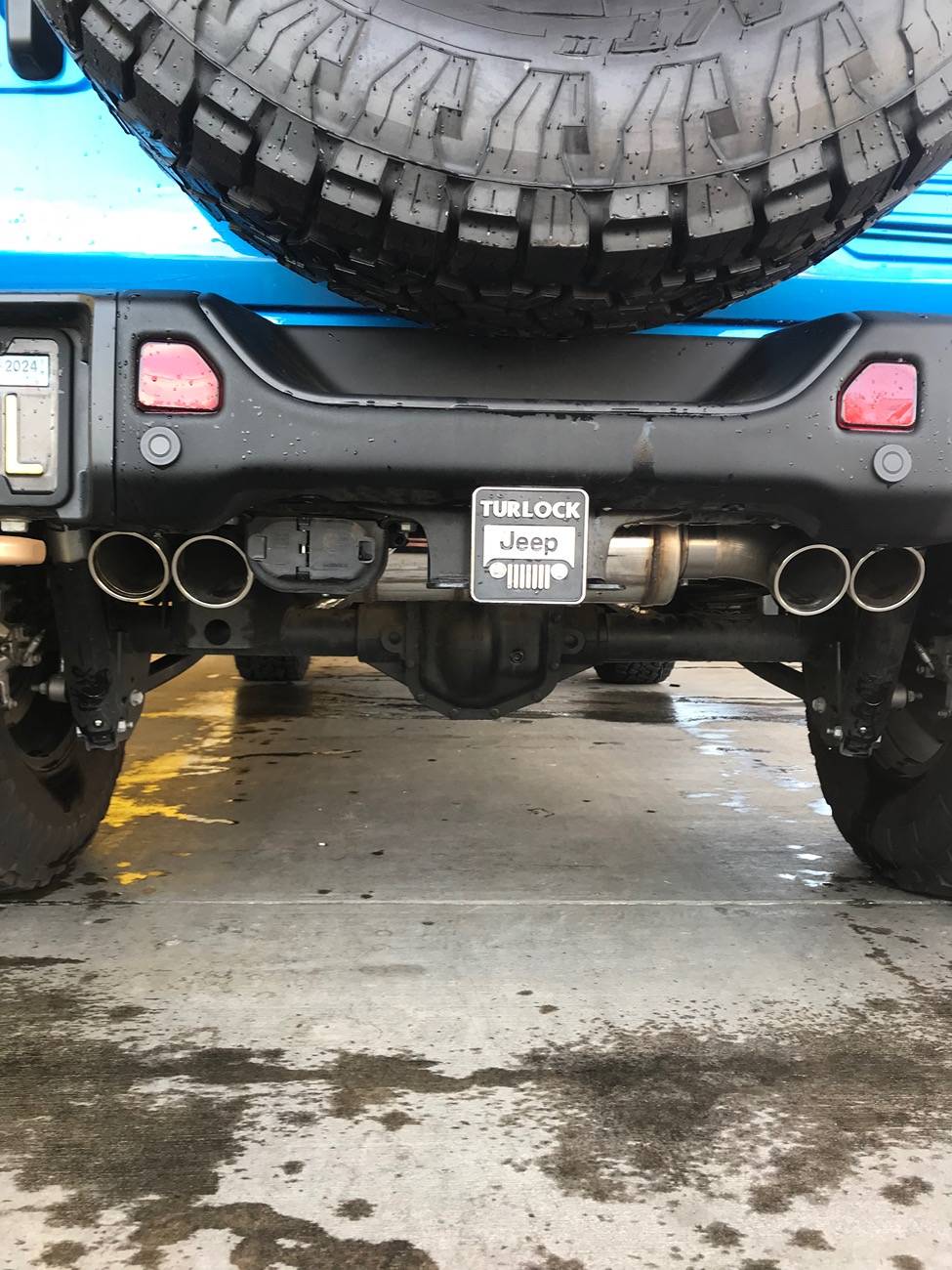

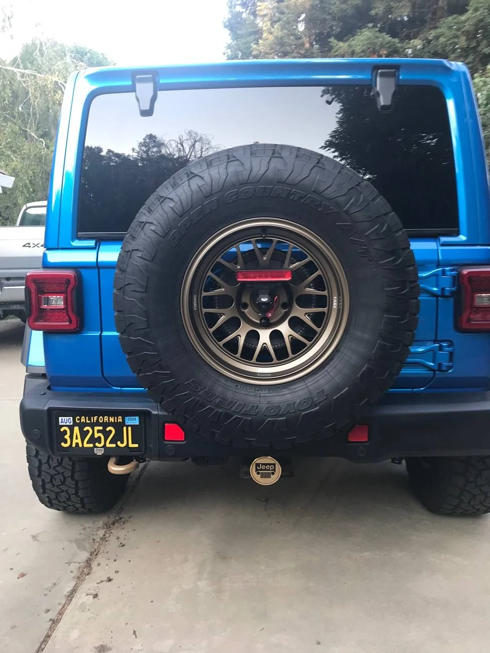

If you aren’t strapped for price just spend the extra ~$200 for the adjustable Alpha.. The tires are now just above the bumper and back to the stock spare bumpers, some go back to the gate. The above the spare 3’rd brake light is eliminated. You are set forever as TF reinforcement can be added if required. Mine cost almost $600 including the $75 RC and $150 brackets added to the ~$365 Alpha :facepalm: The third time is not the cheap charm
Jeep Wrangler JL Spare Tire relocation question 60E98A9E-2075-4F2D-8D9D-9D794A1DC349
Too dark for a new closeup.
