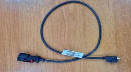

If you're using the USB in the center console this may help. I've ordered a new cable to see if it fixes my issues with Android Auto.
Technical Service Bulletin (TSB)
Floor Console USB Inoperative
REFERENCE:TSB: 08-020-24 GROUP: 08 - ElectricalDate:January 13, 2024REVISION:–
VEHICLES AFFECTED:2018 - 2023 (JL) Jeep Wrangler
2020 - 2023 (JT) Jeep Gladiator
This bulletin applies to vehicles equipped with a Remote USB Port (Sales Code RSX).
MARKET APPLICABILITY:
NA MEA SA IAP EE CH
CUSTOMER SYMPTOM:Customers may comment on the following:
â—Ź Customer states the Apple Carplay/Android AutoTM does not work or is intermittently working when their device is plugged into the center console bin USB port.
CAUSE:Misfit USB cable Fig.1.
USB Cable For Center Console Harness This replacing the center console USB cable.
REPAIR SUMMARY: CLAIMS DATA:
Failure Code ZZ Service Action
SPARE PARTS:
Fig. 1
Labor Operation No: Labor Description Skill Category Labor Time
08-90-82-92Cable, USB Center Console - Replace (1 - Semi-Skilled)6 - Electrical and Body Systems0.9 Hrs.
Qty Part No. Description Notes
168658437AACableBlack USB Cable Console XY331-D3142A
DIAGNOSIS:
If the customer describes the symptom/condition listed above, perform the Repair Procedure.

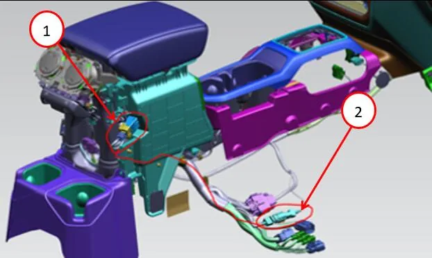

  1. Remove the floor console. Refer to the detailed service procedures listed in DealerCONNECT> Service Library under: 23 - Body / Interior / Console, Floor / Removal.
  2. Remove the end cap from the floor console. Refer to the detailed service procedures listed in DealerCONNECT> Service Library under: 23 - Body / Interior / Console, Floor, End Cap / Removal.
  3. Disconnect off the existing USB connector and connect the NEW USB cable to the media port.
  4. Using zip ties, secure cable to existing console harness every 150mm (6 inches) to avoid a Buzz, Squeak
    or Rattle (BSR) condition when routing to the bracket under the passenger seat Fig. 2.
1 - USB Port to Floor Console End Cap
2 - USB Cable to Wire Harness Connector
Fig. 2
USB Connection End to End
NOTE: Perform push-pull-push on each connection to ensure the connector is fully seated.
  1. Install the end cap. Refer to the detailed service procedures listed in DealerCONNECT> Service Library under: 23 - Body / Interior / Console, Floor, End Cap / Installation.
  2. Install the floor console. Refer to the detailed service procedures listed in DealerCONNECT> Service Library under: 23 - Body / Interior / Console, Floor / Installation.
  3. Confirm USB port functionality.
