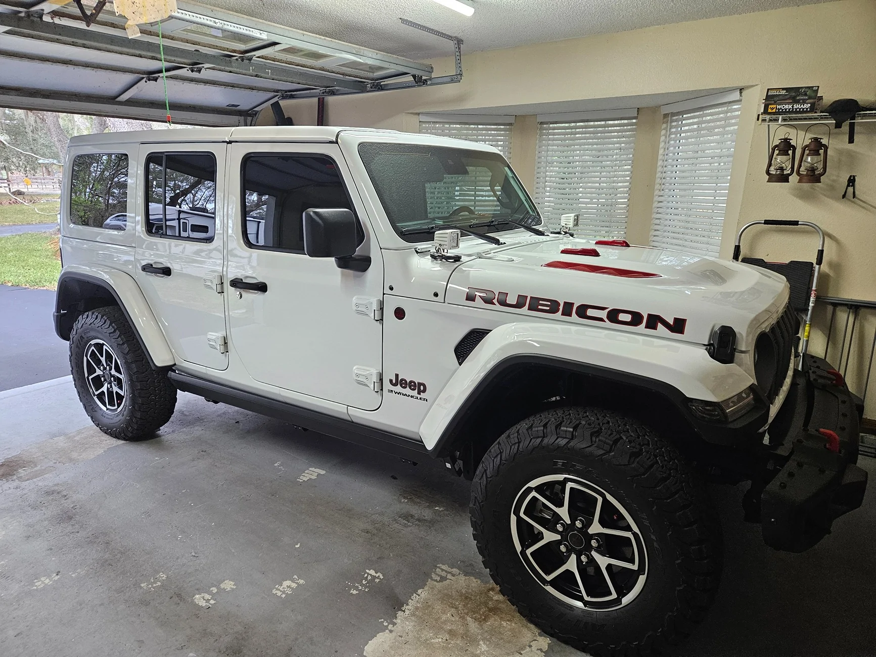

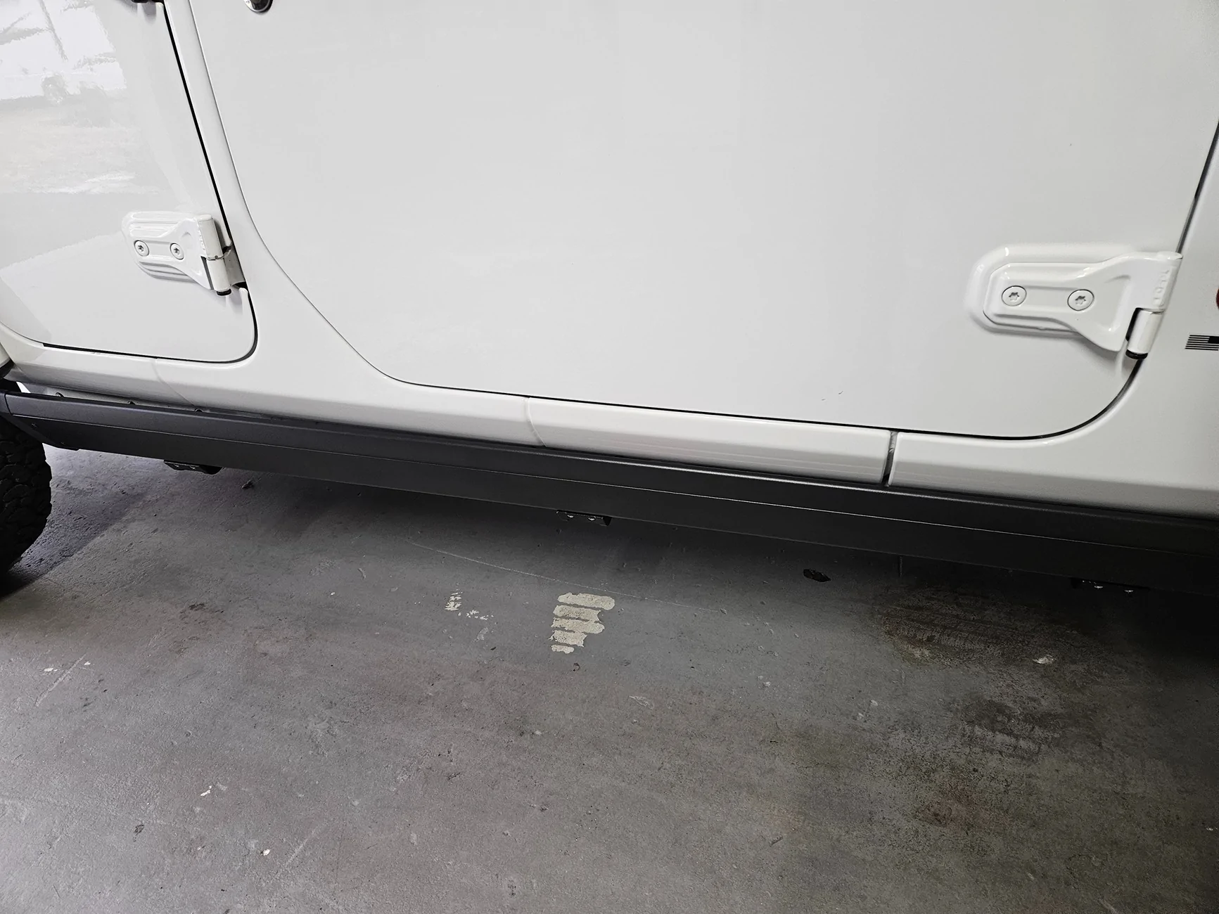

Well, I finished the SoFlo running boards yesterday. I'm super happy with them. They plug into the bus bar behind the glove box and activate when any door is opened - no door sensors to run. They have three brackets per side, with the center one being the motor. They came with a wire harness that had plenty of length. Everything was pretty much plug and play to include the four LED lights. I ordered them last Thursday and they were in my driveway THE NEXT day. Nothing was damaged or missing. They tuck up pretty tight to the body, so you don't see the pinch weld.
I paid less that $1,200 with discounts and they were super easy to work with. No directions are in the box, you download them from their website.

They look good, and definitely tuck in better than my AMP Research steps. The gap is wide enough that I can fit my hand between the steps and the body.
