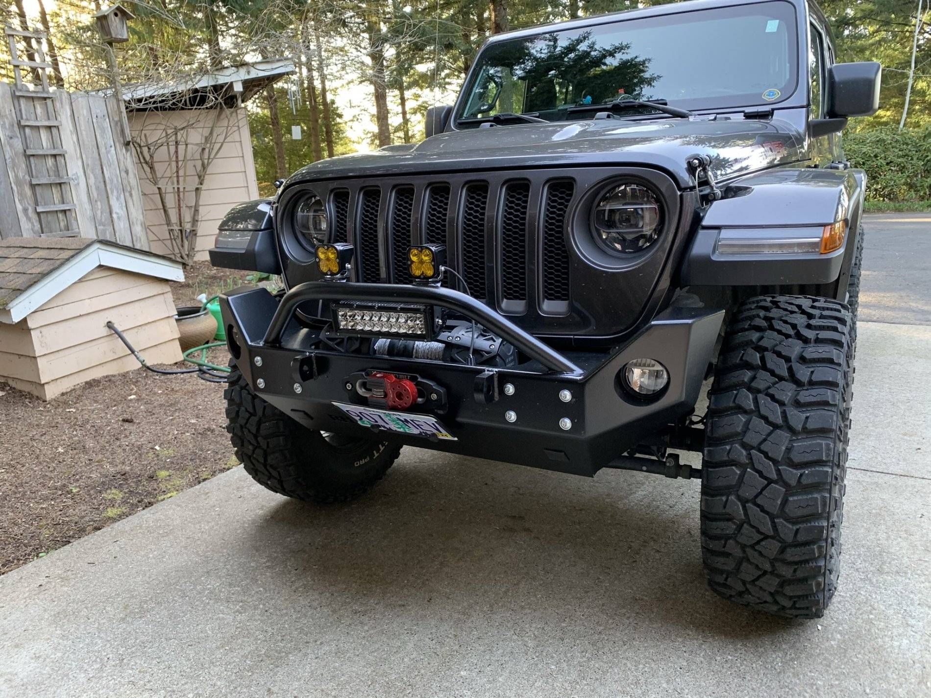

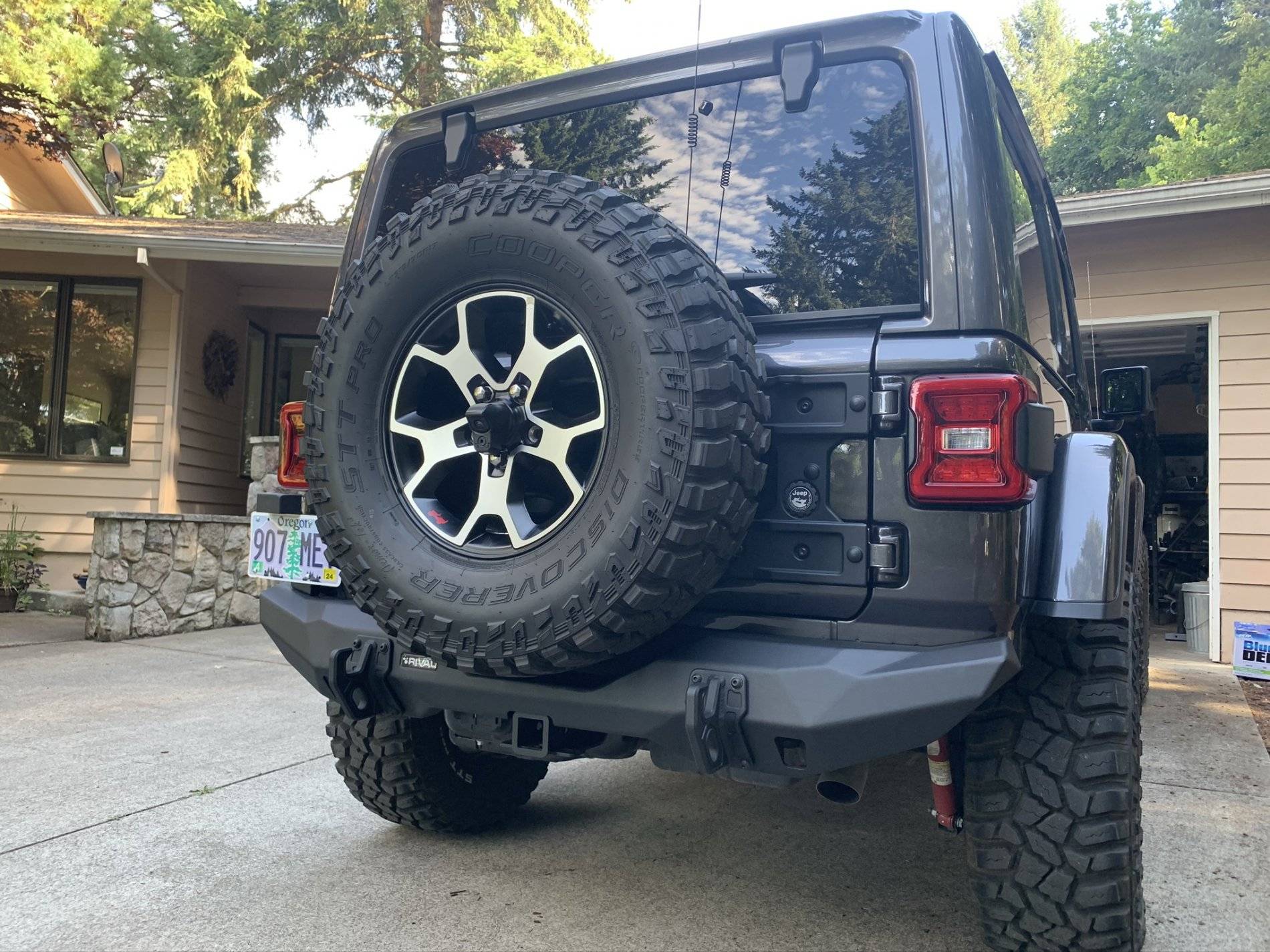

I just installed the Rockhard mid width front bumper. I have the rival back bumper as well and the two don’t seem to clash too much. Both are of good quality and easy to install

Both are looking really good! :like:
It is very difficult to choose. Thanks for sharing!

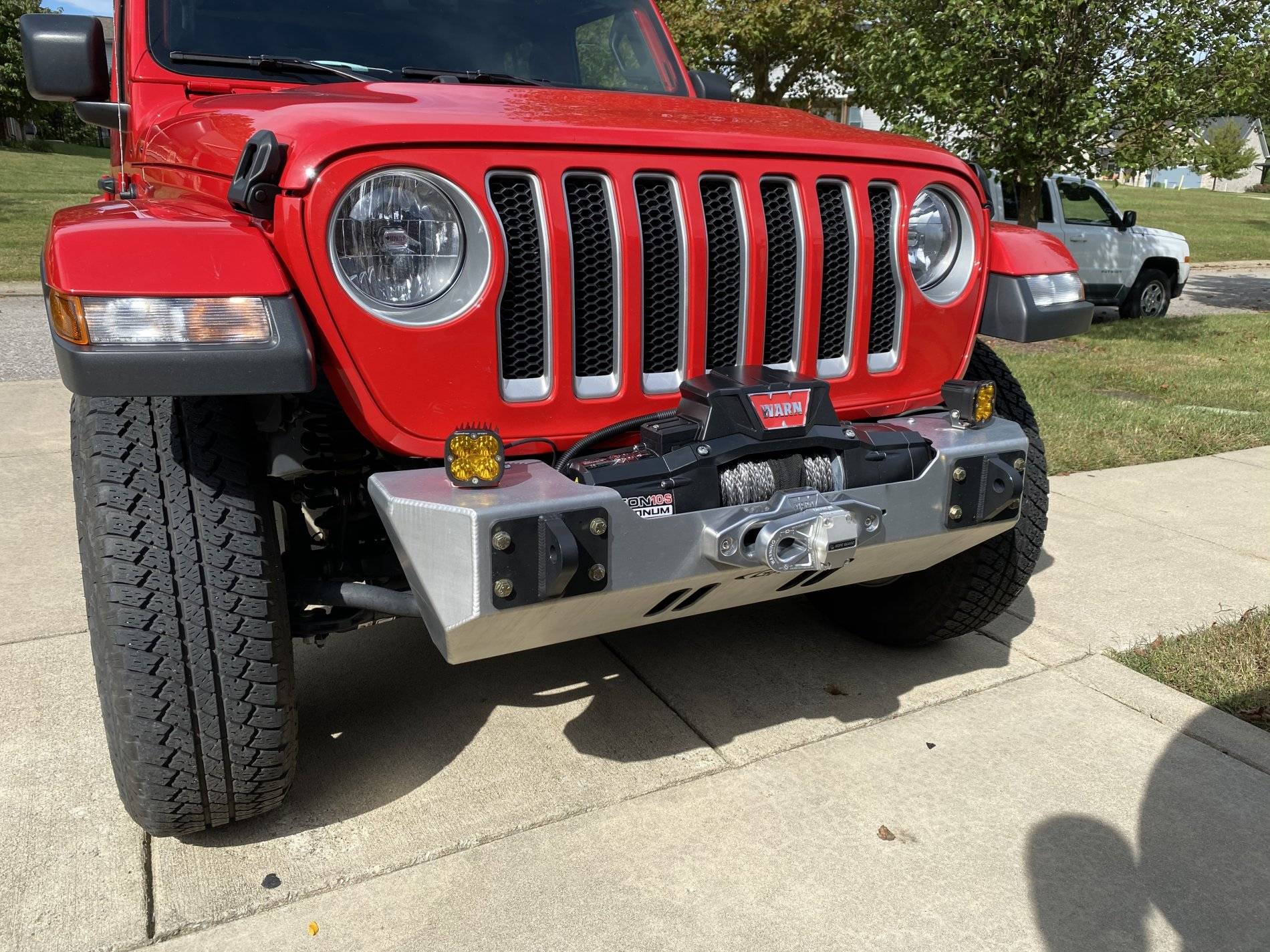

Never Again. I would NOT go with this bumper when using a Warn Zeon 10k or larger at least. Way too much grinding on the winch itself, light grinding on the plate, grinding on the nut plates to get them to fit in the extremely tight ā€œcreviceā€ that was about the width of the nuts themselves. And then using a screwdriver to slide the nut down VERY carefully through that crevice down to the threads and using another screwdriver to wedge the side AND start the bolt into the nut...
Pain in the ass. It took me off and on two days with all the test fits. Had to grind on the frame tabs taking off about 1/8 on the insides too. Looks good but if it comes off, I’m recycling the aluminum lol.

Well that really stinks. At least after all that, it looks awesome :like:
Thanks very much for the info. That is really good to know

Huh... that sucks, I contacted genright and they assured me that combo works. The bumper is already ordered, I guess I'll measure it out before ordering the winch.

I am a good fabricator. That’s why I had the tools and improvising skills needed. Unfortunately, this was NOT bolt on.
Genright says you ā€œmightā€ have to grind ā€œhereā€ (on the back) on the winch. I was not happy about grinding on a $1800+ winch but ok. Then it was more ....and more ....on the back of the winch taking off those pointy parts about 1.5ā€ or so to either side of the spool. THEN is was the winch plate too where those points WERE previously making contact. AND THEN....it was the front but in the same spots as the back. FINALLY, the winch fully dropped in. Then the supplied nut plates... they’ll work if you basically cut off 90% of the metal on either side of the nut basically making it where zipping them on lightly rips the metal. My memory is getting fuzzy but I ended up having to totally remove at least some of the nuts from the plates as the nut plates could NOT go down either side of the winch. That’s when I used screwdrivers as a guide to let the nut slide down it toward the end of the bolts. Keep in mind there’s an assembly and test fit each attempt!
I had to grind even more on the right front of the winch to make room for the gold colored threaded machined insert that let’s the right side of the fairlead have a bolting point.
I know you’re excited for it probably but even if you only have half the issues I did, it’s ridiculous. With all sincerity, I’d turn that thing right back where it came from. lol

Very good to know! Seriously, thank you very much for the info.
It is really good to hear real world experiences with this stuff.
I do all my own installs too, and can make pretty much anything work as I am also an amateur blacksmith and have a full shop with multiple grinders, forges, anvils, torch, power and treadle hammers, etc. at my disposal HOWEVER.....
If I am spending this kind of money, well yeah - it better fit! And quite frankly that is not the kind of work I want to do on my brand new overpriced Jeep! haha.

Yikes... They shouldn't say it fits then. That warn winch is pretty big, I'd assume other winches might have less issues. I doubt Genright would make a bumper that can't accomodate any winch. Also, returning it is out of the question at this point. I have all the tools and knowledge to go through what you did but thanks for the heads up, I'll probably consider other winch options.
