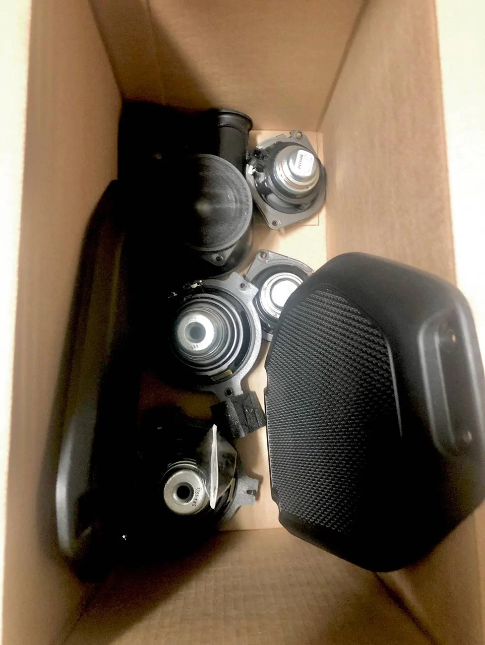

I bought 8 speakers plus the sub off a guy with a premium audio 2020 Sahara. When I went to install the speakers in my 2021, I realized they looked the same, and had the same part numbers. I made a post about it.
Then you did not get the actual Alpine speakers.
The sub yes, speakers no. The Alpine speakers should have different part numbers.
Unless something has changed:
  • Standard eight speakers
    • Two 2.5-inch speakers in the instrument panel
    • Two 4.5-inch front door speakers
    • Two 2.5-inch sound bar speakers
    • Two 4.5-inch sound bar subwoofers
  • Available premium Alpine audio system with nine speakers
    • Two 3.5-inch speakers in the instrument panel
    • Two 3.5-inch sound bar speakers
    • One 10-inch quad voice coil subwoofer
This post on the JT forums shows the difference between the 2.5" base and 3.5" Alpine speakers:
https://www.jeepgladiatorforum.com/...alpine-premium-sound-system.45869/post-862165

You’re right, all this time I thought they were the same but I guess the guy i bought them from lied or accidentally got the wrong speakers.
Are the 4.5” ones the same part numbers between options? Is it just the smaller speakers they use different ones?
Alpine are different but same size.
