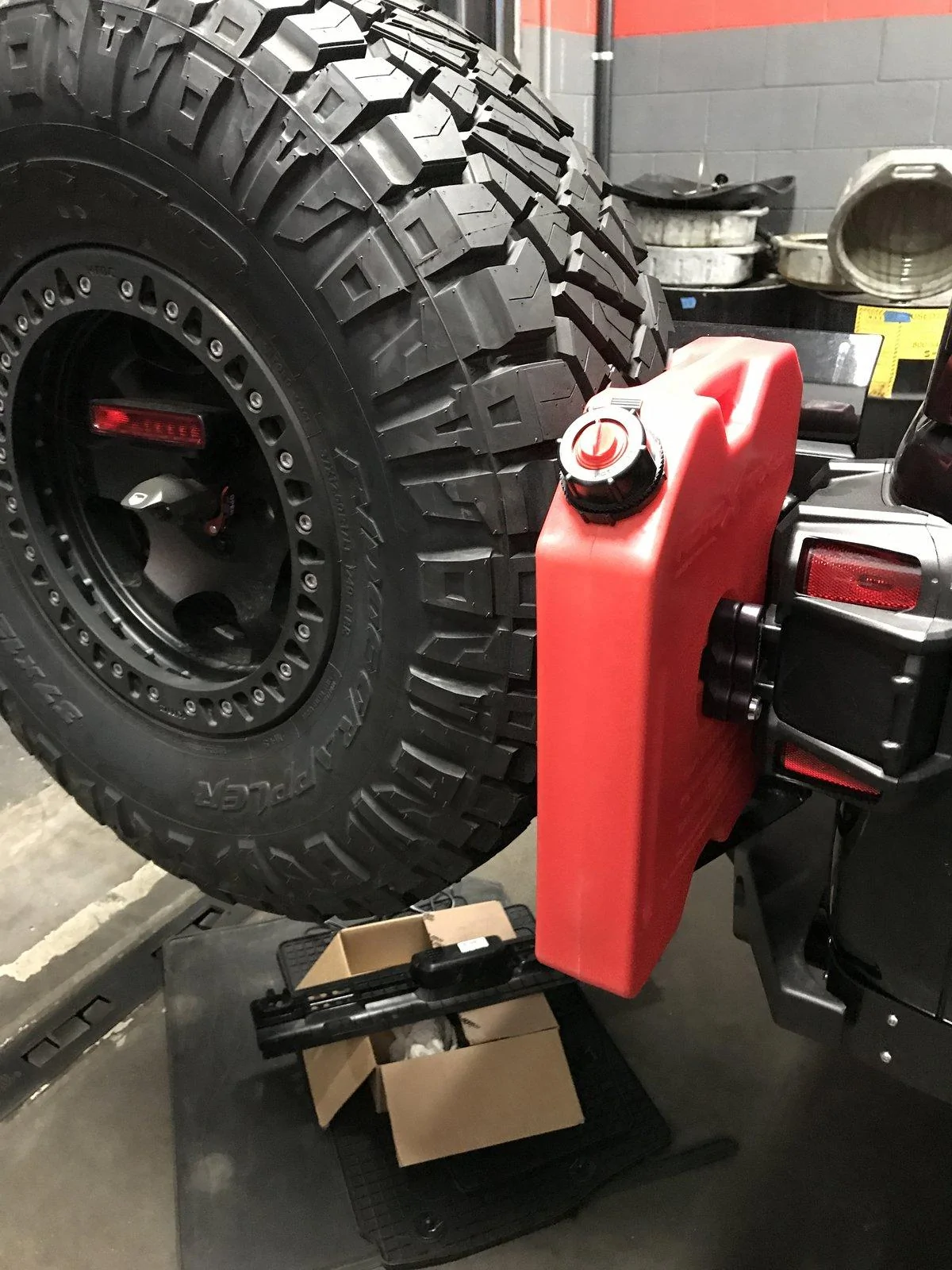

Drago Jeep Products. This is a 37x12.50 Nitto Ridge Grappler (37” effective diameter). They also have a higher mount version which will clear a Trail Grappler (38” effective diameter).
It is rock solid and over-engineered. Works with the Mopar tailgate reinforcement.

looks like that location on the side of the tire limits the tailgate from opening fully and the taillight is the bump stop. Neither of which would be ideal.
It’s open more than it looks (Pretty much all the way) and it’s only because I have taillight guards. They offer another high mount version also.

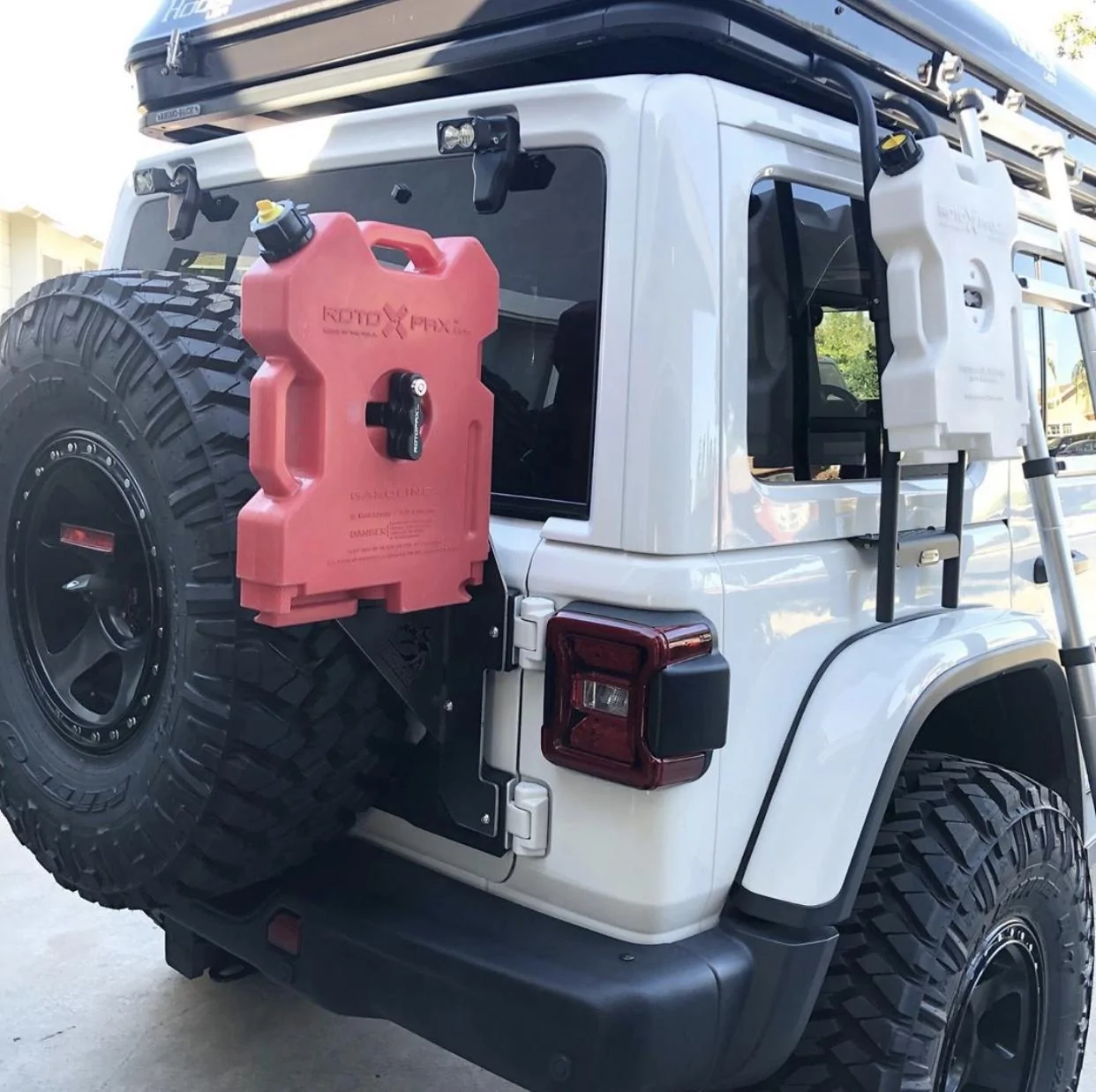

That's a nice set up. I notice they show a 2 gallon Rotopax in their product pics. They also say the max spare tire diameter is 33". Larger tires will cause the Rotopax to contact the tail light before the tail gate is open fully. I use a 3 gallon Rotopax, so I emailed them to ask if this larger Rotopax would contact the tail light, even with 33's. I'll post what they tell me.
So here is Retrofit Offroad's response to my question about the 3 gallon Rotopax:
"Unfortunately we have not tested it with a 3 gallon rotopax so I cannot say 100% if it would contact the taillight or not. We only tested with 2 gallon rotopax as they are the most common size. Sorry I don’t have anymore information for you."
Not terribly helpful. However, a quick check on the Rotopax website shows that the 2 gallon containers are 3" thick. The 3 gallon are 4.5" thick. From a clearance standpoint, mounting a 3 gallon on a 33" tire would be like mounting a 2 gallon on a 36" tire. Since they say tires larger than 33" will cause the Rotopax to contact the tail light, I'd say this product is a no-go (for me, anyway).

The Drago high mount fits a 3 I believe. The high mount will fit a 38" mounted tire.

If you would like, send me your 3 gallon to test in my retrofitoffroad . I only have 2 gallon planning to do a double stack of 2 gallon on it ( maybe gas and water or 2x 2 gallon of gas and not a big deal to me to remove it if I want to fully open the tailgate

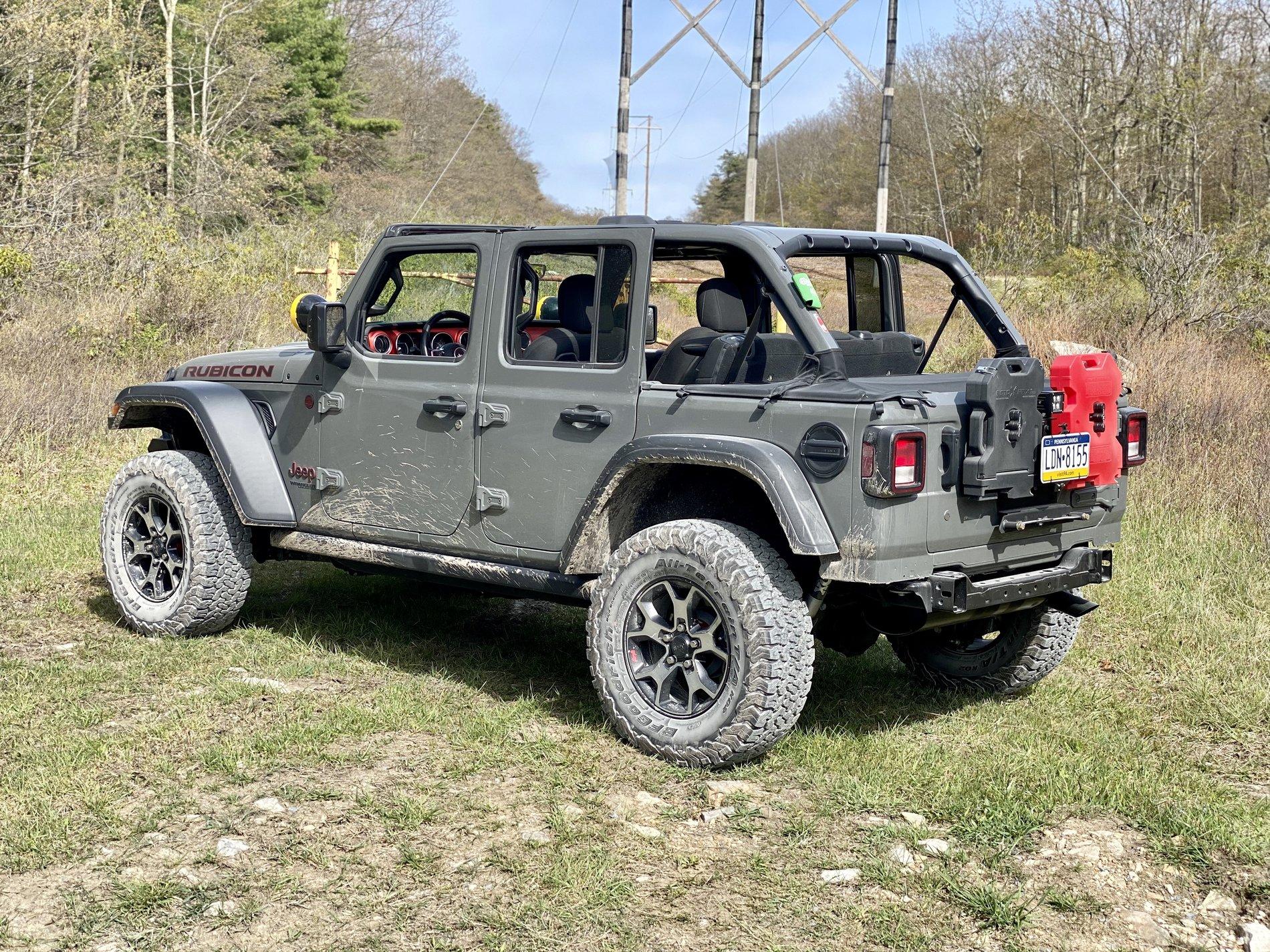

Ace Engineering Gatekeeper Rotopax mount. Very sturdy and arrived in great condition.
Their website is finally up! Lots of cool new products they’re working on also.
Posting this because of all the PM’s.
https://dragojeepproducts.com/
