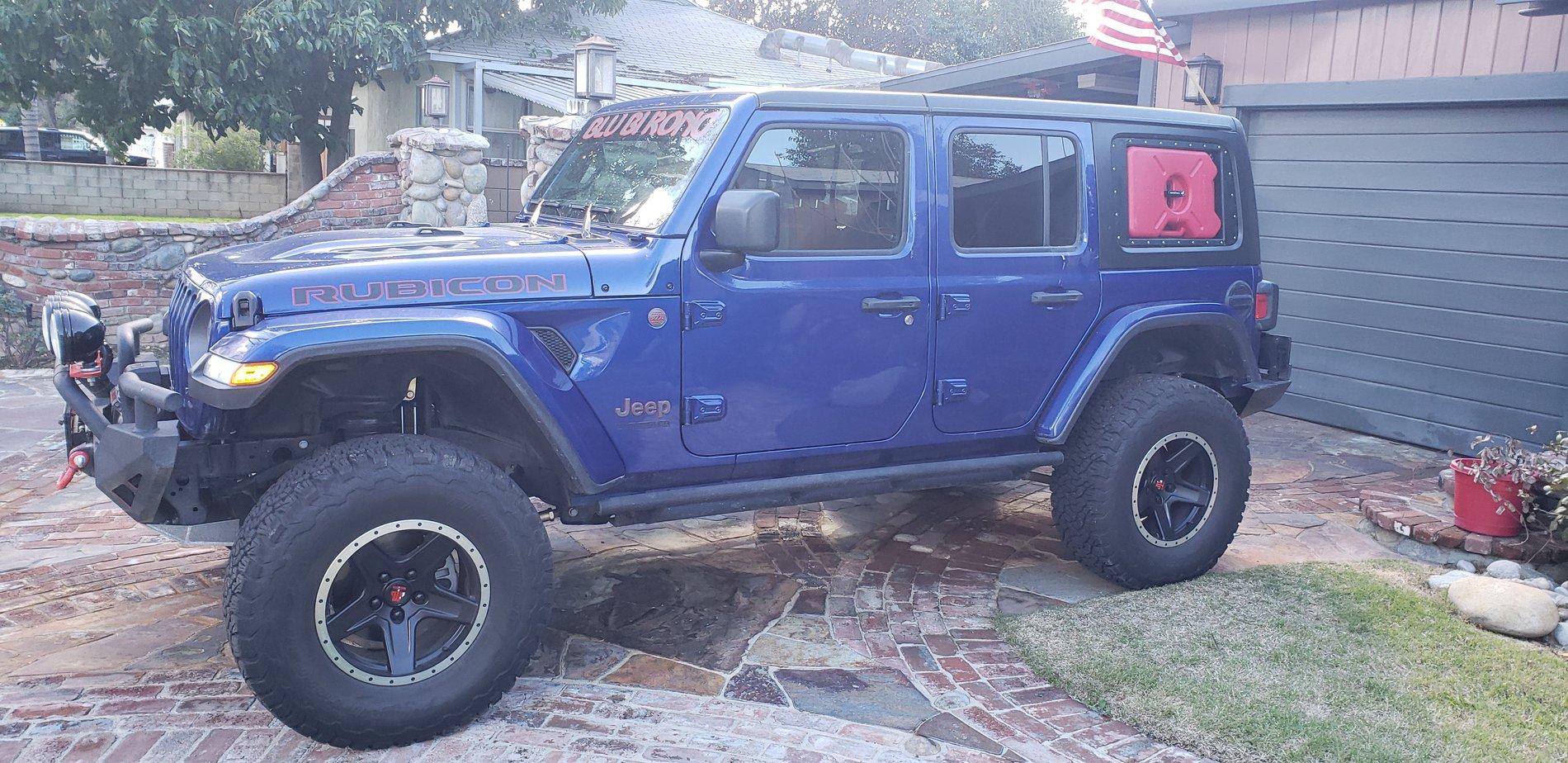

Drago Jeep Products. This is a 37x12.50 Nitto Ridge Grappler (37” effective diameter). They also have a higher mount version which will clear a Trail Grappler (38” effective diameter).
It is rock solid and over-engineered. Works with the Mopar tailgate reinforcement.
