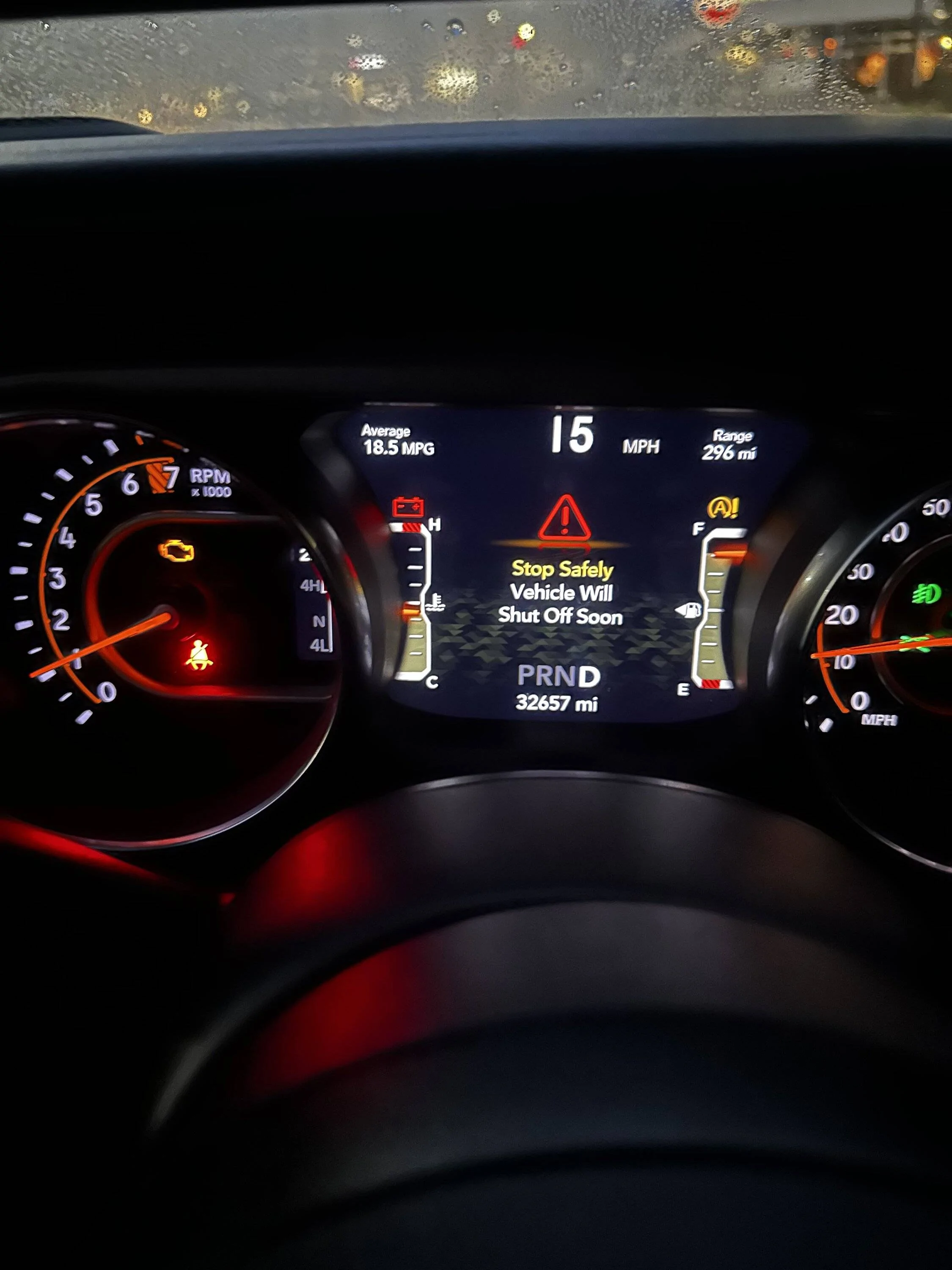

So here's an update...based off of what I learned about the green can-bus connection behind the dash glove box (super easy to get to) I did a bit of wiggling and seating of connections. This allowed me to start and drive the Jeep to the dealer for service this morning. No light show, still had a CEL.
Service tech ran codes and it blew his mind how many were listed. Literally pages of error codes. I showed him the green can-bus connection which he noted and I left it in their hands to resolve. Confirmed that I'm still under warranty, too. I'm anxious to see the outcome and really appreciate this forum!
Is this what you saw on your dash?
Jeep Wrangler JL All Electronic Safety System Service Alerts? 7BF2BC61-C3A8-4EFB-B797-CDE157FEFC6E
Grooster
Greg
Aug 23, 2019
265
342
Wichita, Kansas
2023 Unlimited Rubicon, 2016 Cherokee Latitude
IT Business Solutions Director
Is this what you saw on your dash? (Stop safely, don't die message)
No - never got that. I did get practically everything else. I think I might have been happier to see this rather than the flood of "Danger Danger" messages I got at 70 mph. Wasn't a fan of the engine stumbling during this, either. But it calmed itself and kindly left me without power steering to get home with. Go figure.
