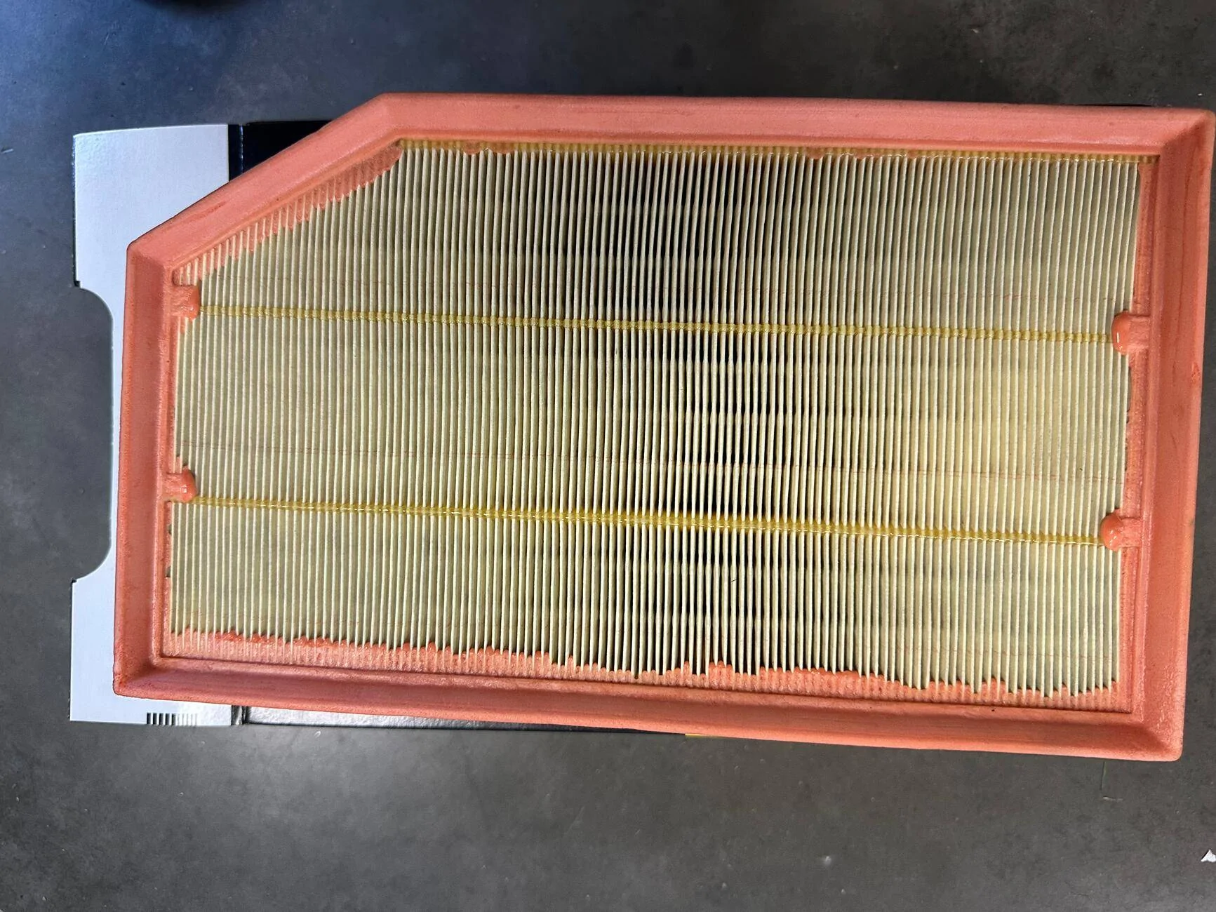

I ordered a couple Purolater A21421 air filters for my 2018 3.6L, from Amazon. They look a lot like the Wix that's in there now. The foam seal looks like the same material. The color of the filter media looks the same as well. I'll pull the Wix later and do a side by side comparison.
The Purolater filters have about 10.5 pleats per inch and about 11 3/8" of pleated media. I don't have a Mopar filter around to compare.

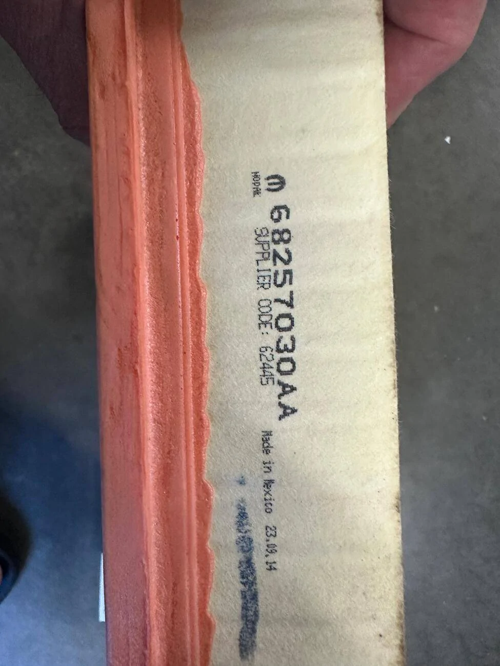

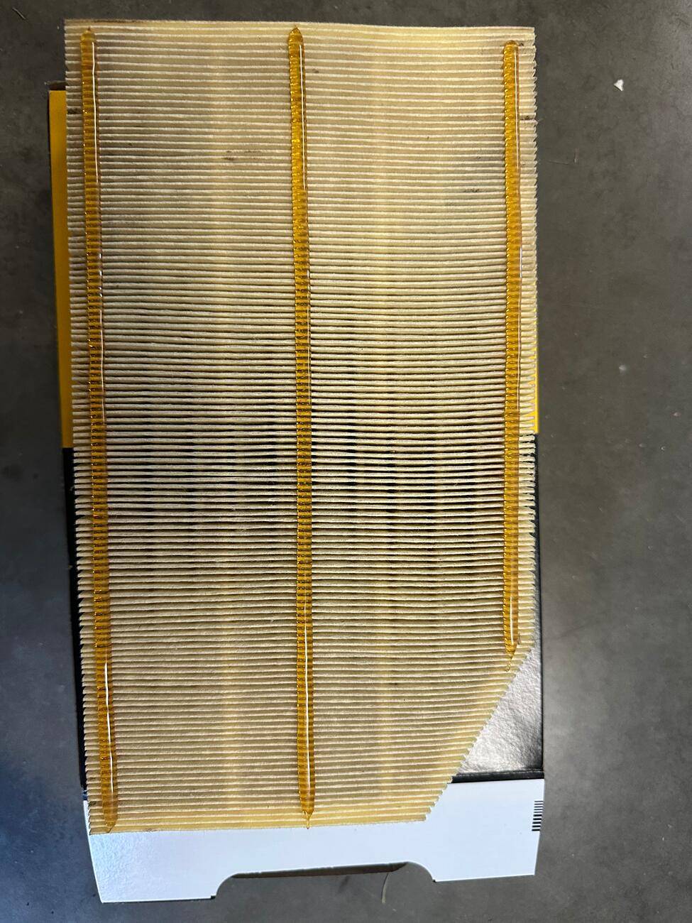

this is a mopar and it is exactly the same as the Wix so probably all made about the same..i counted 11-12 pleats per inch but those are hard to count...Purlator has a good reputation.

There have been a number of posts on BITOG about Mopar filters being Mann-Hummel/Purolator/Wix (all of which are the same company). Everything I've seen corroborates this. I picked up 2 Purolator A21421 filters for $18 ea on Amazon. The Mopar labeled filter is $40

The Purolator air filter (first pic in OP's post) is an aesthetic clone of the Mopar filter. While I tend to use OEM as a matter of personal preference, I'd have no qualms about using a quality aftermarket part such as what's pictured.

I bet more than aesthetic as both made in mexico I bet they are exactly the same.

Yes, they are. The inkjet printer just switches between Mopar, Wix and Purolator codes. (Last assembly stage before packaging.)

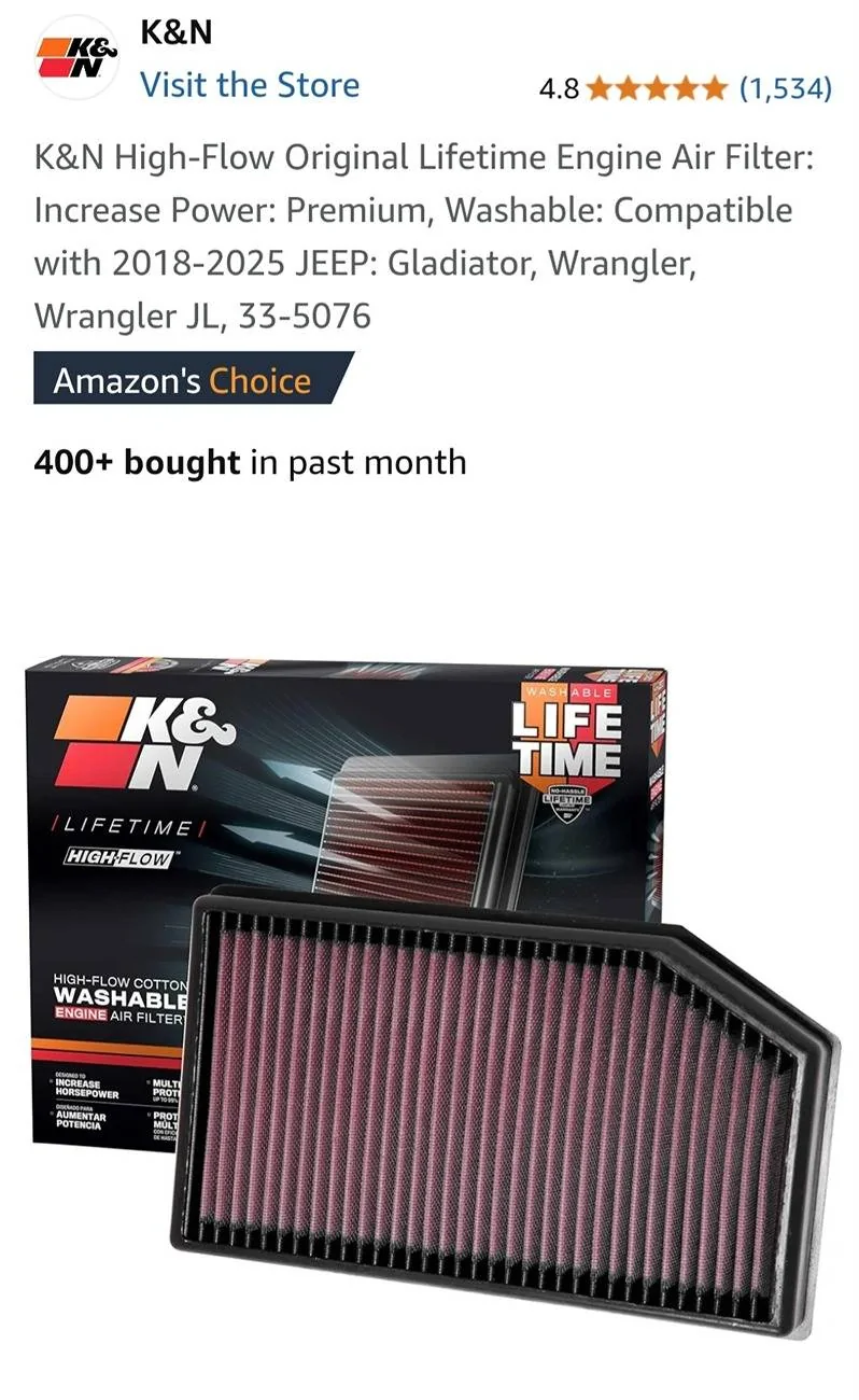

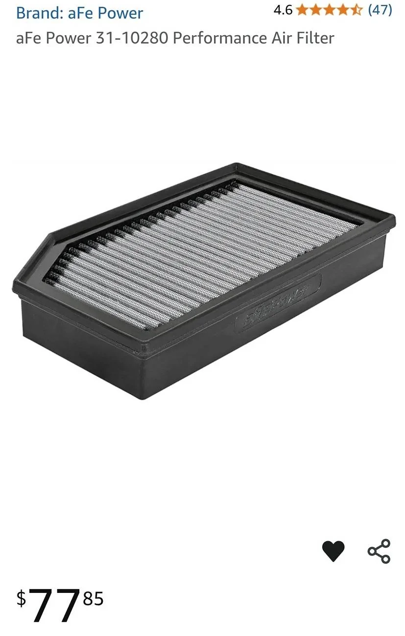

Anyone ever try one of these life time air filters. I'm thinking about it.
The K&N is $64.99

Not specifically for a JL. I've run them on various vehicles over the years. I would not be a buyer again. I found that they let a lot more dirt through than a factory type paper element. I could see the dirt in the intake system.

The K&N high flow filters achieve their high flow by not filtering fine particles. Great if you only care about a quarter mile track speed, bad if you care about engine longevity. Given the conditions that Jeeps are used in I'd say it's an exceptionally bad option.
Project Farm demonstrated this quite clearly. Good 0-60 times, laughably bad filtering performance.

I'm thinking about staying away from these type of filters now. 👍
