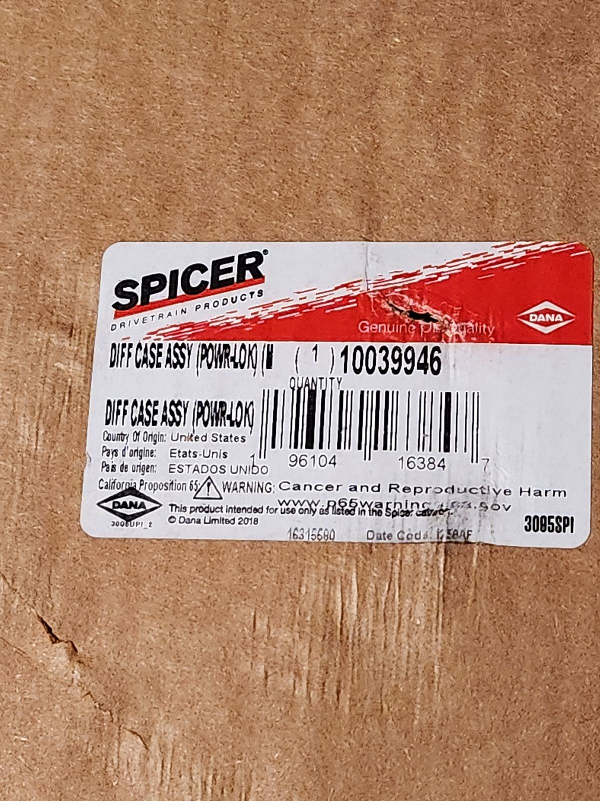

If you want one for one replacement, Jeep does not sell the differential. However, Dana Spicer sells the differential as P/N 10039946, which I have sitting right in front of me. If you pull your cover, rotate the diff around until you find the p/n. It should have a few different numbers, but 10039946 should be on there. I bought from these guys. Sadler Power Train Truck Parts & Service
Jeep Wrangler JL Aftermarket rubicon locker 20240519_054431
Jeep Wrangler JL Aftermarket rubicon locker 20240519_054636
So is this Dana Spicer a direct replacement and plug and play for the Rubicon D44 internals? For $677 that makes me feel so much better, knowing that there is a replacement with e-locker.

It is the identical part for the Rubicon. As you can see, it's only the mechanical part of the differential. It is stuffed with the spider gears and requires the electrical actuator coil, a small spacer. If your electrical parts are good, just swap them over.
On the other hand, If the coil is bad, theres a work around for that I started a thread on since that part isn't available either. It's buried in this forum somewhere. Evidently not worthy of pinning it by the pinning gods.
