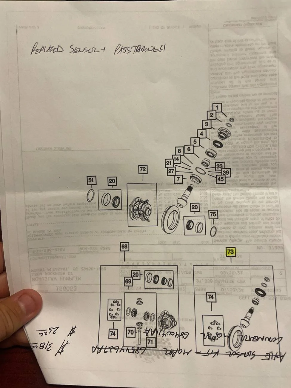

Once parts were ordered, it took three days to receive them:
68544629AA $318 Axle Sensor Kit
68400411AA $23
Plus lubricants for rear axle, because the sensor is inside the rear axle gear case.
Once the parts were received, it took less than a day to install and check, the Jeep was ready that afternoon. I got a look at the sensor (they wouldn’t let me keep it) and it was full of oil.
This is a known issue by Jeep, there is a bad batch of sensors that went into the axles in 21 and 22. They used to replace the whole axle, now there a these kits, but they need to be ordered from factory. There are 5 sensors in a kit, they only replaced the one, guess they kept the other. If I had paid for it, I’d have wanted them all, as it is, I was happy to get my girl back. Topless she is better than a Challenger any day!
The more you know, the less the dealership can try to snow you. You can look up the parts and diagrams on Mopar website, call the parts department ahead of time. Insist on a loaner, this will not be a quick fix, and it’s under warranty!
