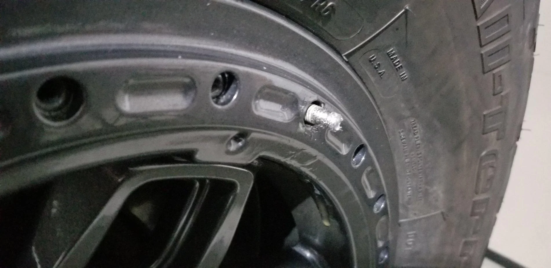

Want to warn about these bolts coming with Borah protection ring, they are extreme soft and will snap with moderate torque (~20 ft lbs). They are grade 8.8. I have two bolts snapped on me, even though I used generous amount of anti-seize and torque wrench. I drilled one out but the thread is ruined, now I am afraid of drilling the other one.
I replaced all other bolts with grade 12.9, for reference these bolts are M8 x 1.25 x 35mm

The good news is they are very soft, so likely a good EZ-out of LHT drill bit should get them out, although you have to go easy on them otherwise the thread could be damaged.

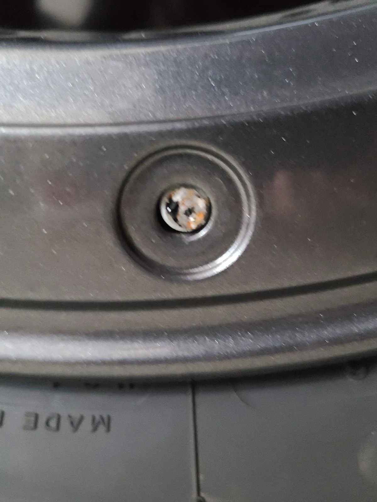

So I drilled out another one today, PITA. Had to tap the thread and replaced all bolts with grade 10.9 black bolts, now it is much less likely to broke, and I dig the black on onyx look.
You can see some of the AEV bolts I get out are already bent, that is how soft they are.
