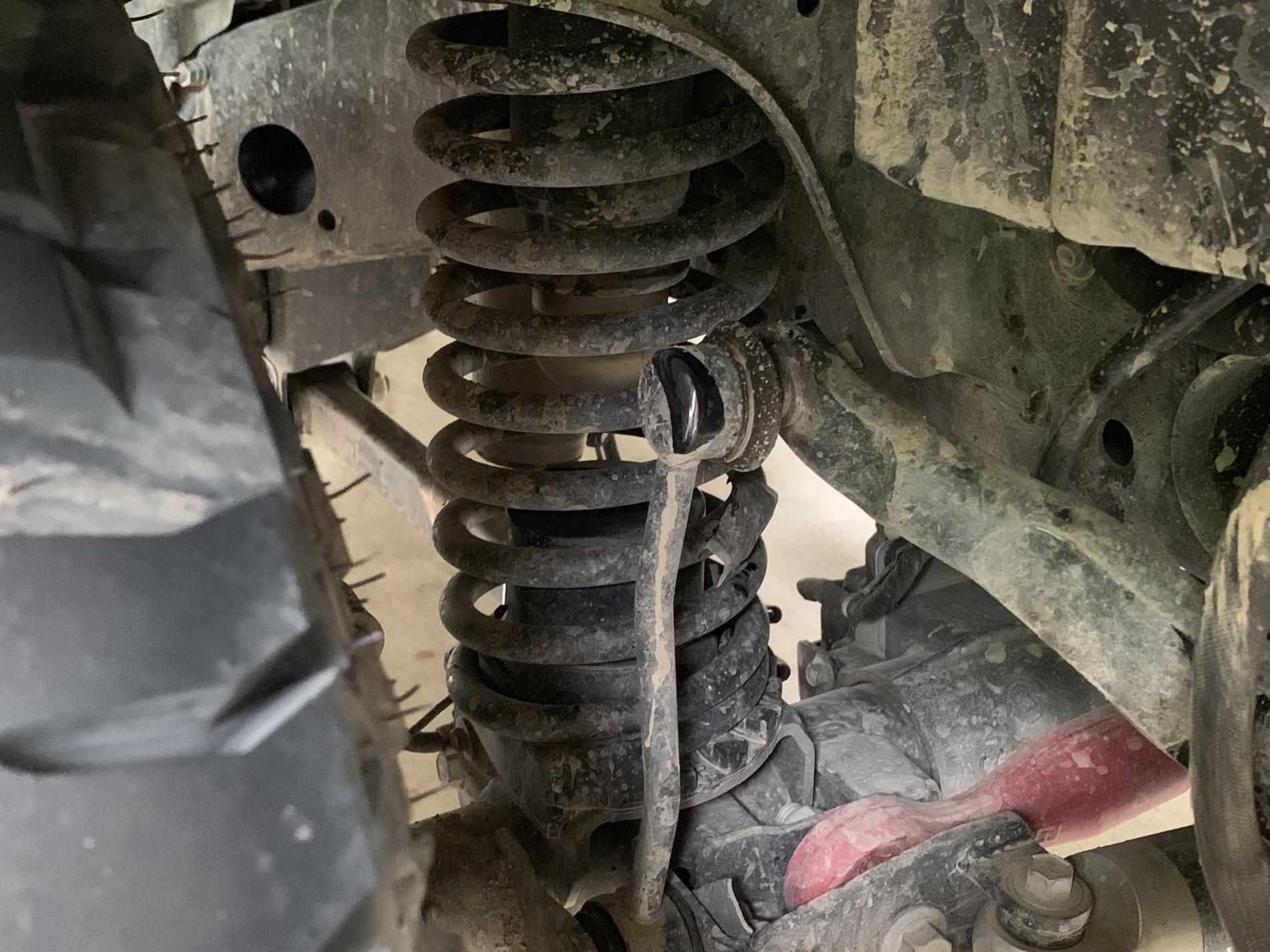

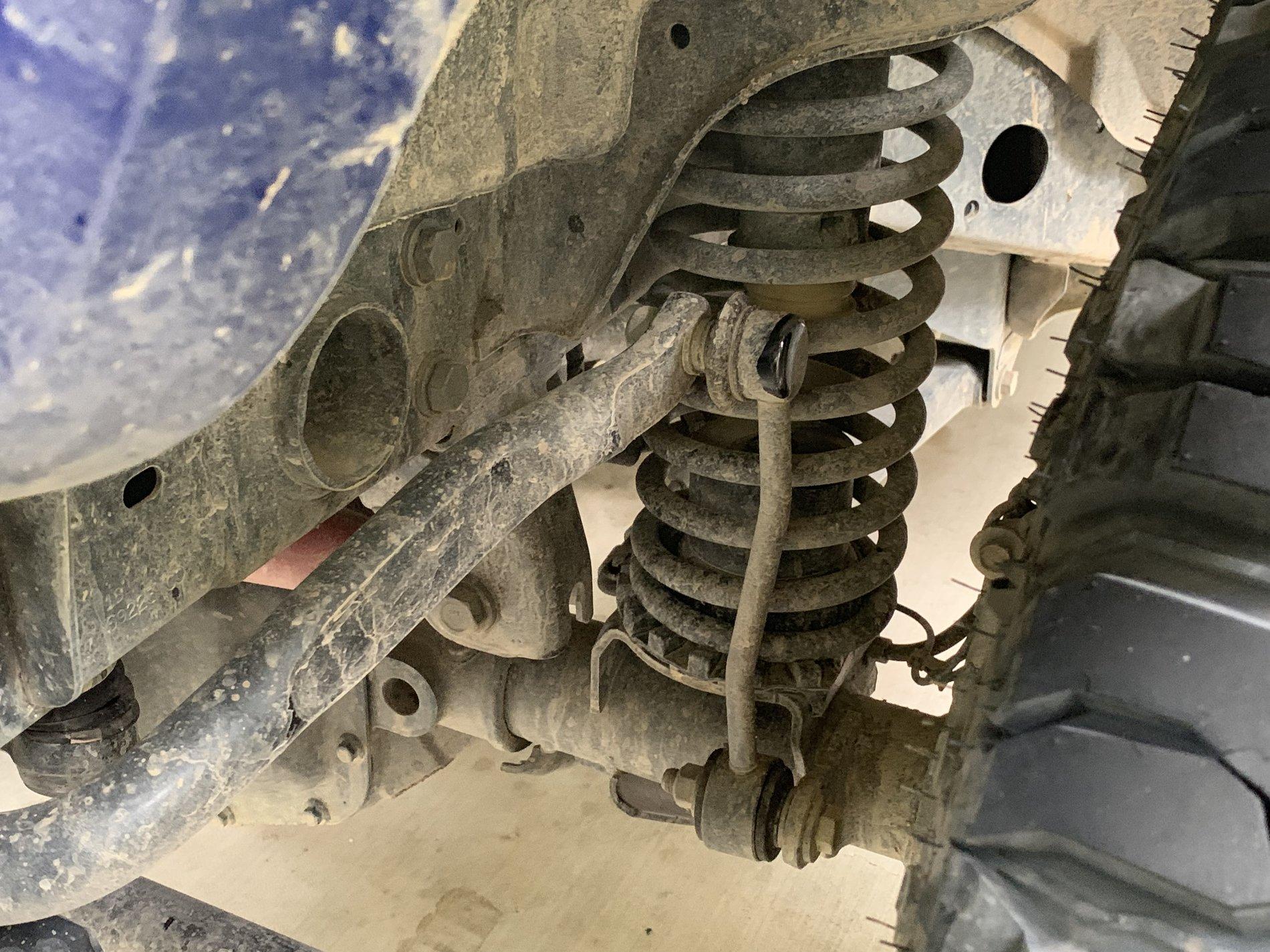

@Rubi-Zero how is the JK fitment wheel working out? Any issues so far?
I discovered while wheeling this past weekend that 315/70/17 tires on OEM Rubicon wheels and the 2” lift I have rubs the sway bar links just a little bit at full lock. What better excuse to get new wheels? Lol.
OEM wheels are +44, JL Borah fitment is +25, JK Borah fitment is +4. The only thing I’m not sure of is if 3/4” more clearance will be adequate or if I’ll need 1.5”.

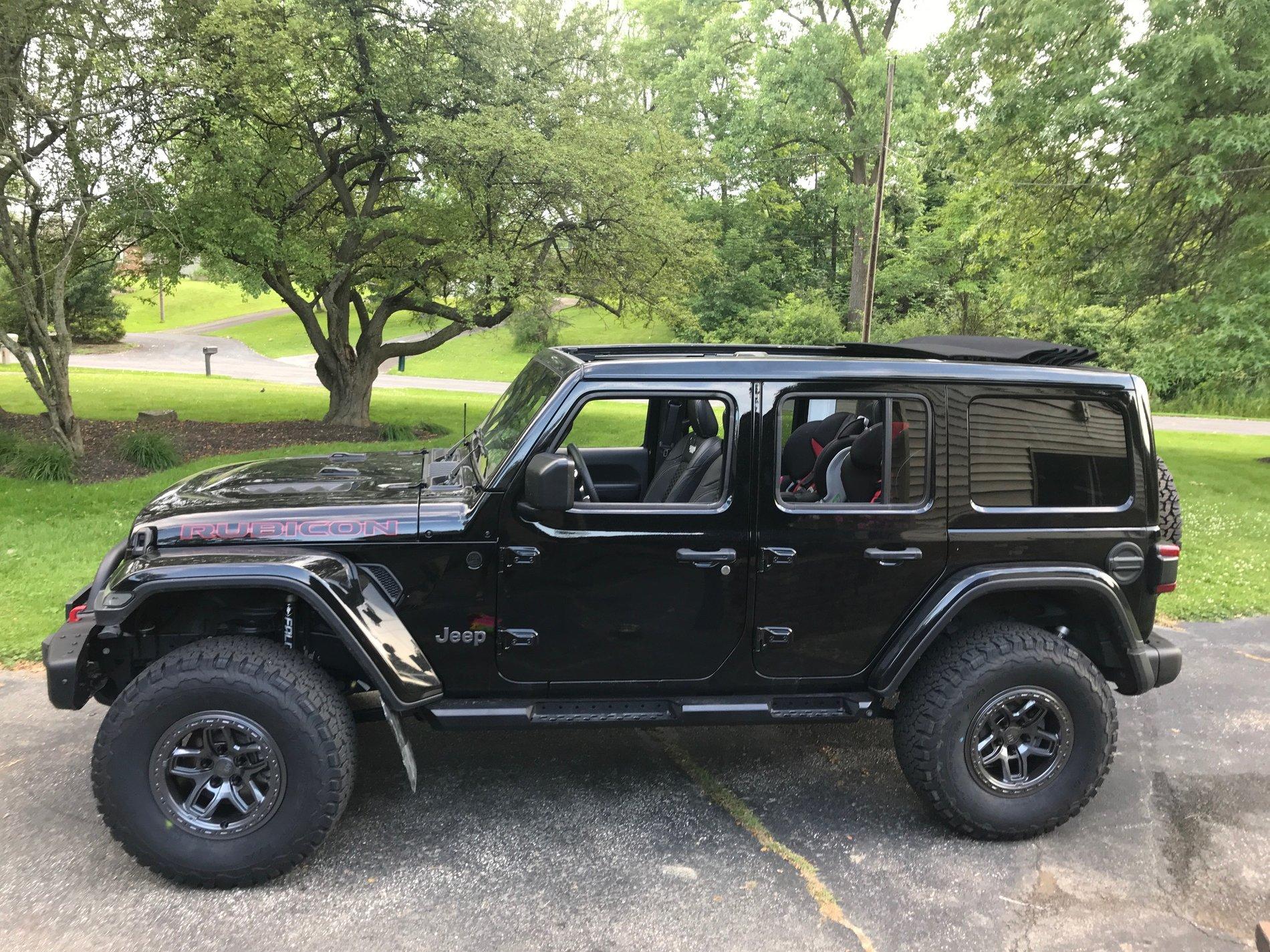

Onyx Black w/ Onyx Black protection ring on Ocean Blue JLUR. (JL +25)
That is gorgeous! I like it as is, but I think I’ll consider painting the protection ring Ocean Blue. Have you wheeled it hard with those tires/wheels on it? Did you rub like I did in the photos above in post #66?
I have not been out on anything hard yet. the only rubbing I show is at the back on the plastic coming off the bumper on the wheel side. But I have heated up the corner and pushed it in like 1 inch . I have not had the sway bar disconnected yet either. I am still waiting to order skids and a few other items before i hit harder trails.

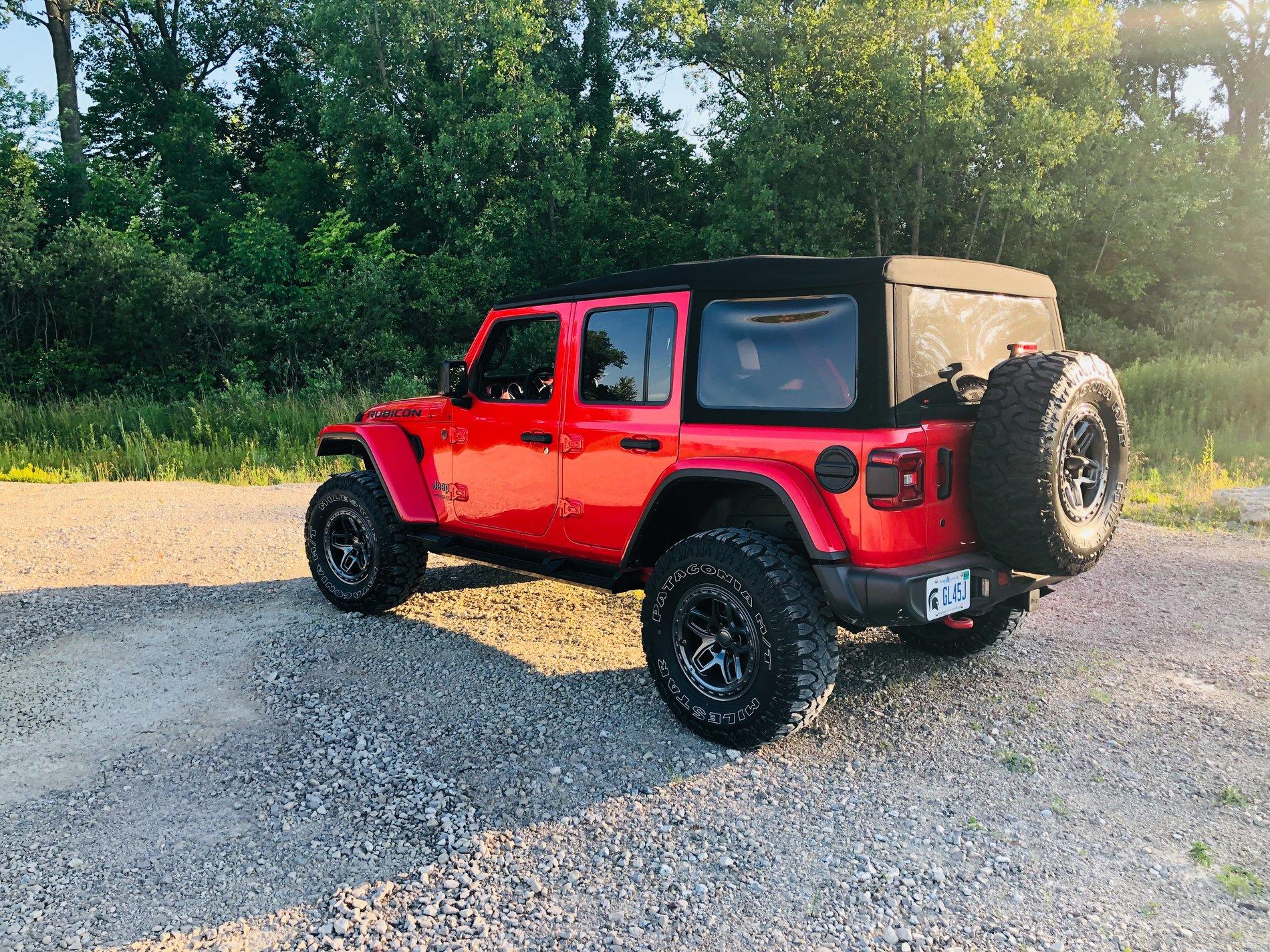

Just had my Onyx Borah's installed on 315 KO2's (Load C) with the Terraflex ST1 1.5" Lift and Falcon Shocks. The wheels look great. I'm very happy with the result.
