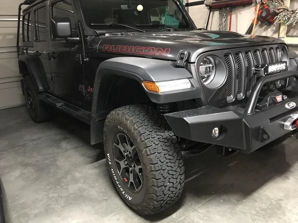

it feels like more lift the 2.5 inches but i think it is deceiving me. see photos, the old girl is is the garage tonight..

Very happy camper with my AEV 2.5 setup... I also went ahead and installed the Steer Smarts components including tie rod, drag links and trackbar... did I say I am a very happy camper???
For tires, I kept the stock Rubicon wheels but upgraded to the KO2 315/70R17 and it is just right for my intended use.
