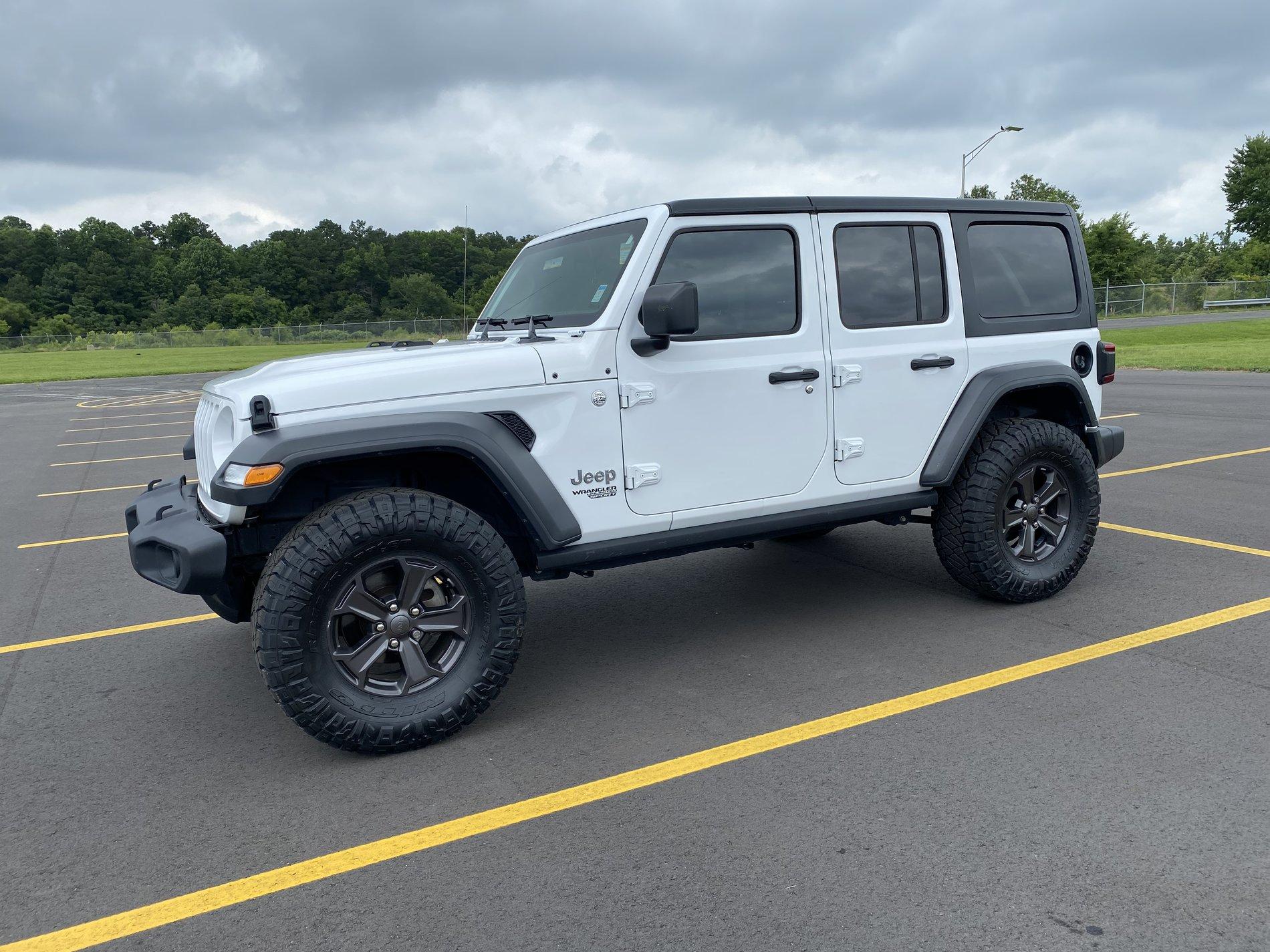

Installed 2” AEV Spacer lift and 35” Ridge Grapplers on stock Recon wheels with G2 wheel spacers. Rides like a Cadillac. Still looks a little stuffed to me so I may install Rubi shocks/springs for another inch or so. The Procal Snap works great and is easy to install.
