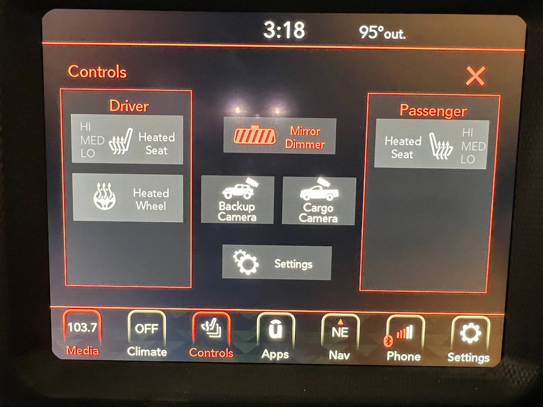

I installed the Z Auto camera. You have to remove part of the dash trim under the Uconnect in order to plug in the video cable. And a power wire to the battery. Not too difficult.
But the camera picture quality is not great, 480p if I recall. Z Auto does state this on their website. It’s limited by the OEM interface the camera plugs into. Poor picture quality is better than nothing I suppose. You also need a Tazer to enable the “Cargo camera” option in Uconnect.

Stock on Gladiators perhaps, but the same interface exists in JLs, it’s just not active. You need the camera kit and a Tazer to enable.

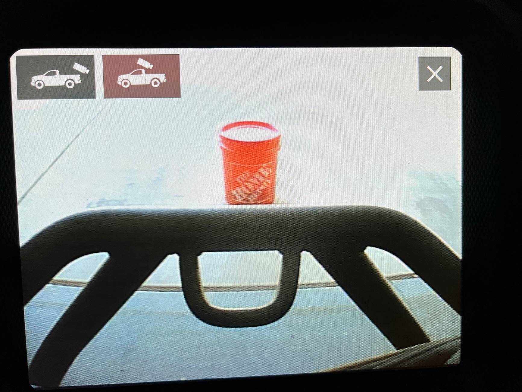

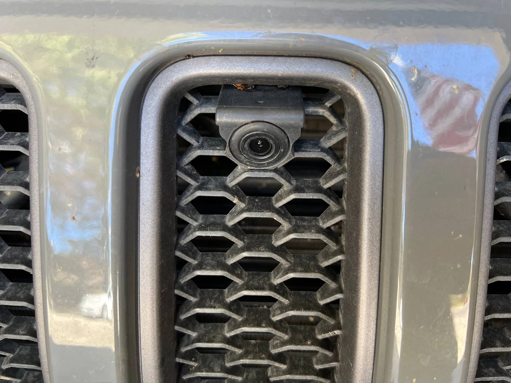

Pics from my ‘21 JLUR-XR.
Jeep Wrangler JL Adding front trail cam IMG_6928
Jeep Wrangler JL Adding front trail cam IMG_6929
“Cargo Camera” is now a front facing camera. It’s only a 480i camera so image quality is not great.
