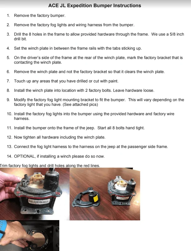

The bumper install was relatively easy. The winch plate, not so much. Ace does not include paper instructions with their products. They send you an email for their video install of the products. Problem was the video for this bumper was not on YouTube. We had to call Ace and ask what was up. They apologized that the video was missing and said it would be up this week. They sent me pictures in the interim of what needed to be trimmed for the winch plate to fit. After that it was easy.

Following this as I ordered both a front (Expedition) and rear bumper with tire carrier during Black Friday. I decided to try the new Smittybilt 9.5K Gen3 winch. According to Nick at Ace, you have to make a notch in the frame on the driver's side to fit in the winch plate. He told me they don't have video instructions yet and that it should be pretty easy... This is my first Jeep and first major modification.

I installed the same bumper this afternoon...well close. I was under the assumption that direct bolt on was actually direct bolt on. In addition to triming the winch plate, you need to drill out the mounting holes along with modifying the fog light housing to fit the new bolts and sit flush. Neither a huge deal but I don't have those tools nor was I planning to need them so I now have no winch plate (not an issue since I don't have the winch yet) or fog lights and am running with 6 of 8 bolts securing the bumper.

I caught them after hours so I'm going to call back tomorrow. A bit disappointed since these seem to be made to order so why not make them correctly? From what I gather the drilling of the frame holes is to accommodate the larger bumper bolts. The fog lights aren't a huge deal since I wanted to go aftermarket LED anyway but wasn't planning on it right now so forcing my hand a little. The winch plate is my biggest gripe but at the end of the day I don't even have the winch yet.

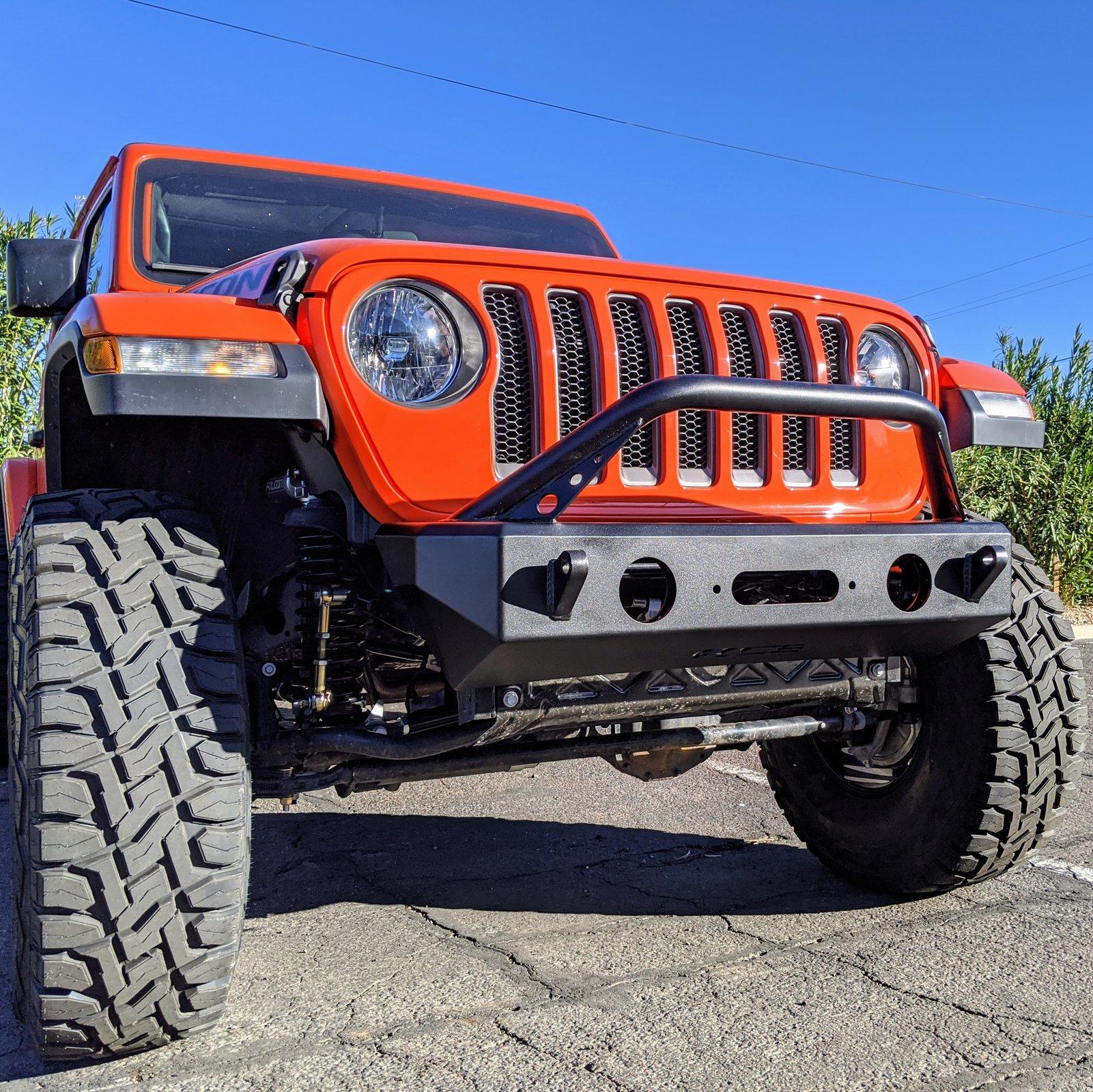

I have this bumper...I had no issue with install but I am sure that depends on your level of skill and equipment.
@n1vek - There is no issue with light blockage.

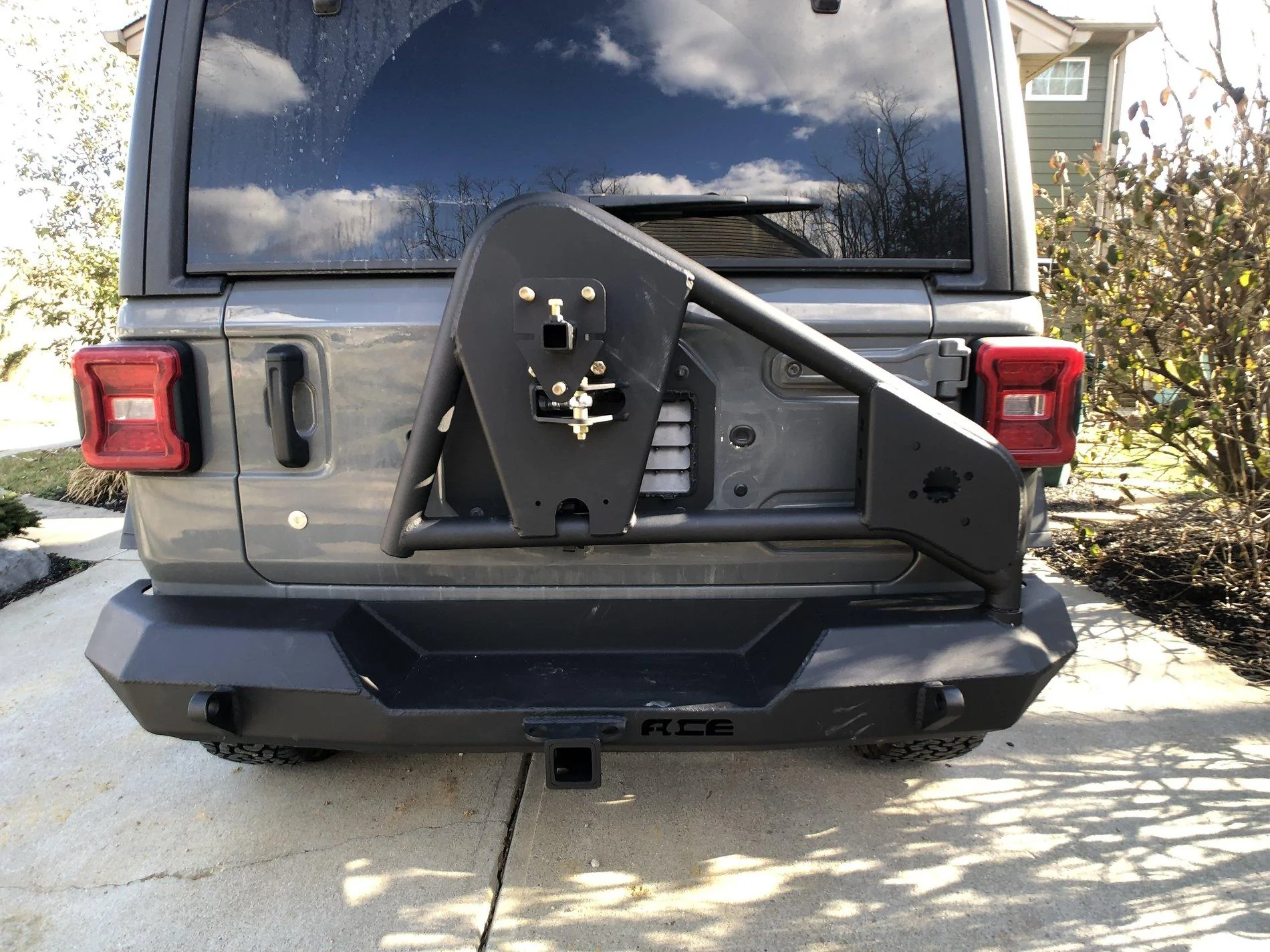

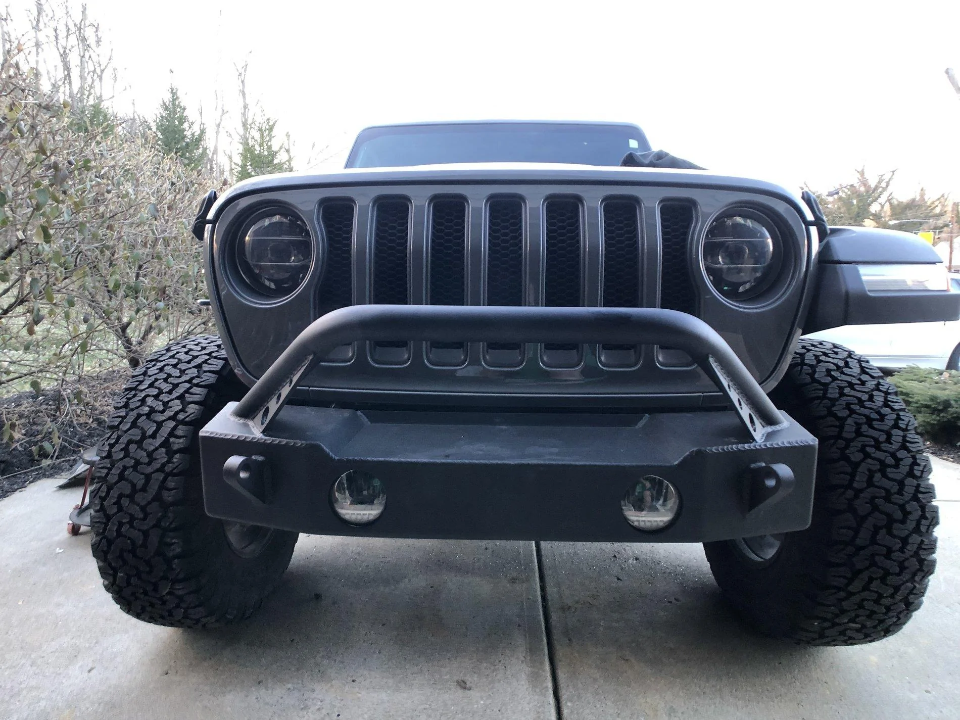

For those that have the bumper or are looking at the bumper, get the sway bar disconnect flip kit. It is a fantastic little part. you gain almost 3" of clearance under the disconnect unit and can remove the flimsy shield that "protects" it.
here are a couple pics of the bumper (and the rear bumper) and linked below is my link to the install of the bumpers (and my lift).
Jeep Wrangler JL Ace Stubby Pic Request IMG_7262
Jeep Wrangler JL Ace Stubby Pic Request IMG_7265
Rear bumper
Jeep Wrangler JL Ace Stubby Pic Request IMG_7219
Build thread with tons more pics:

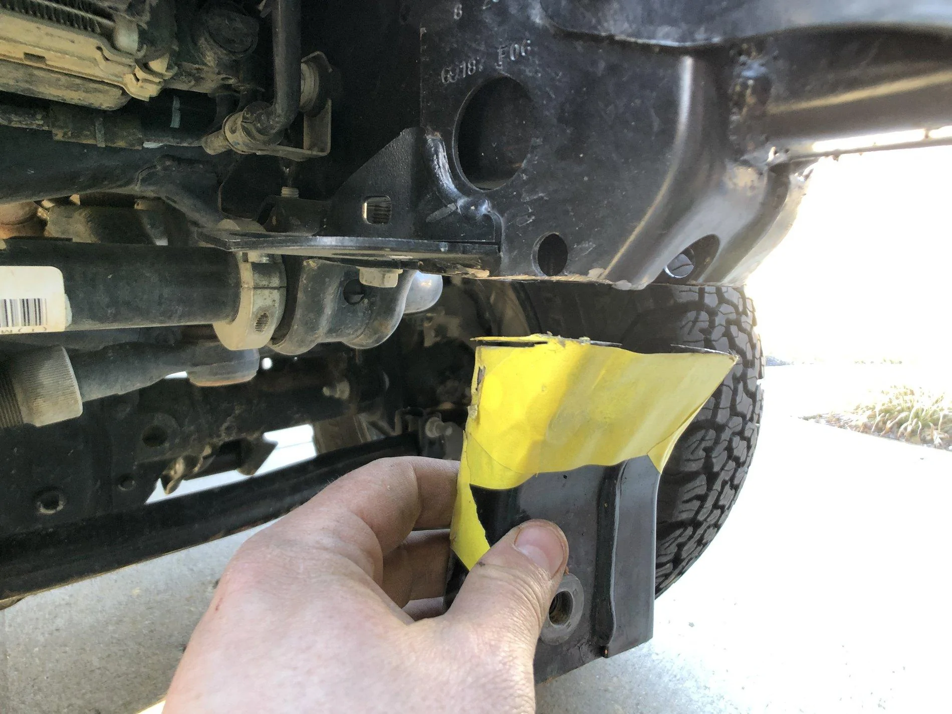

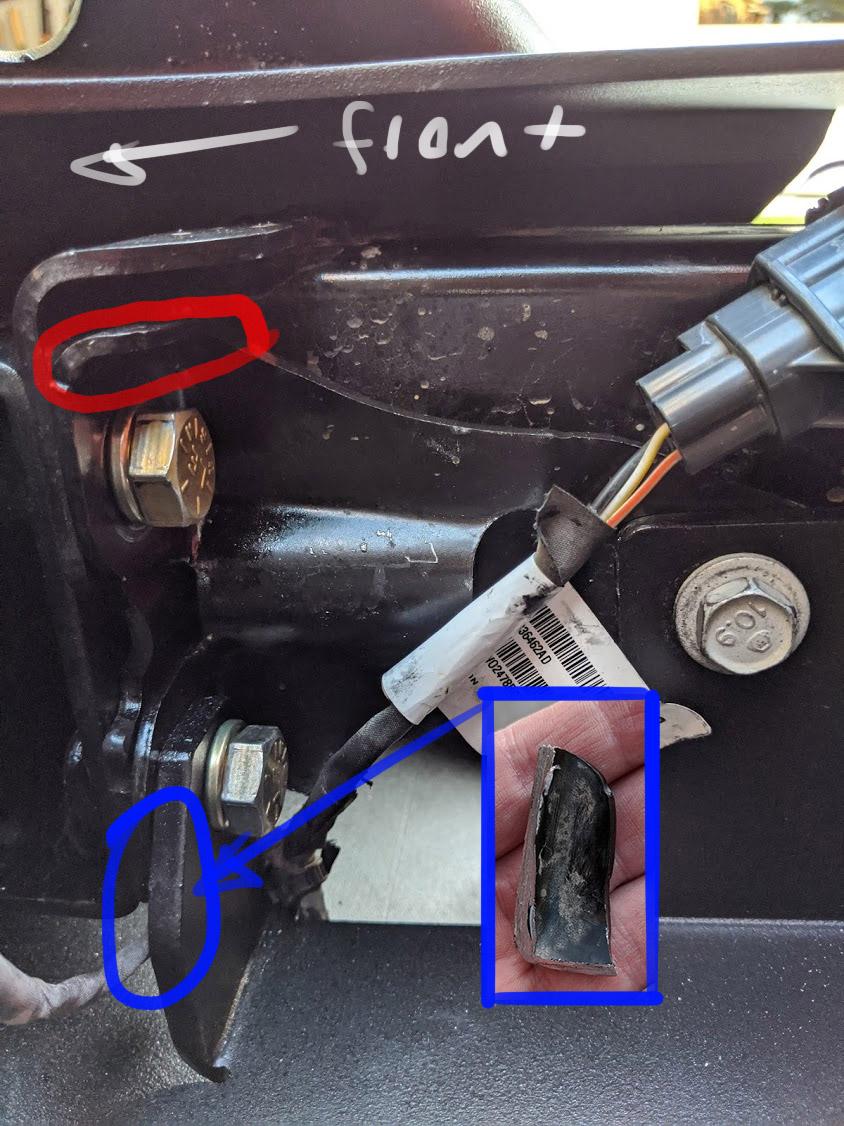

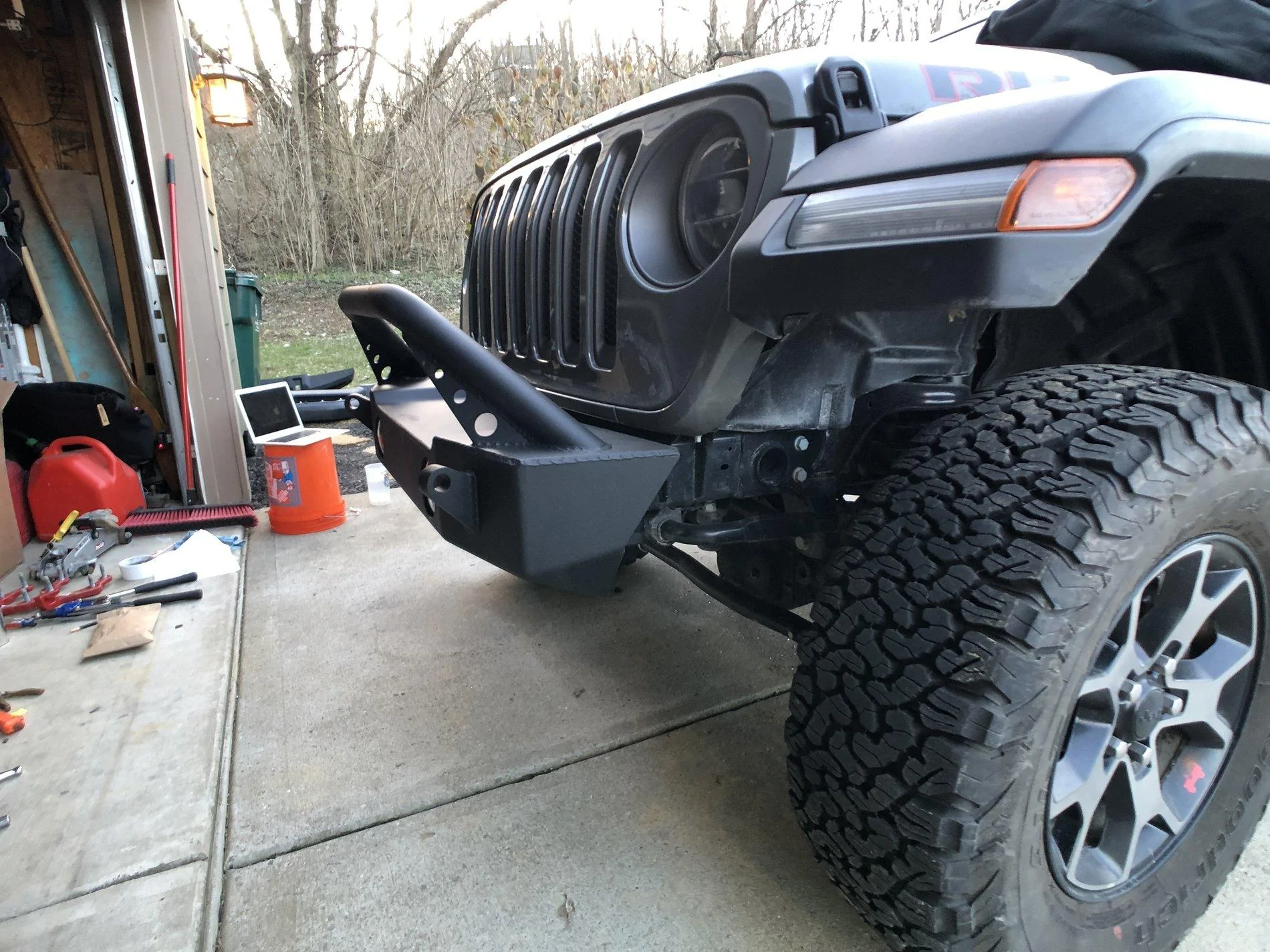

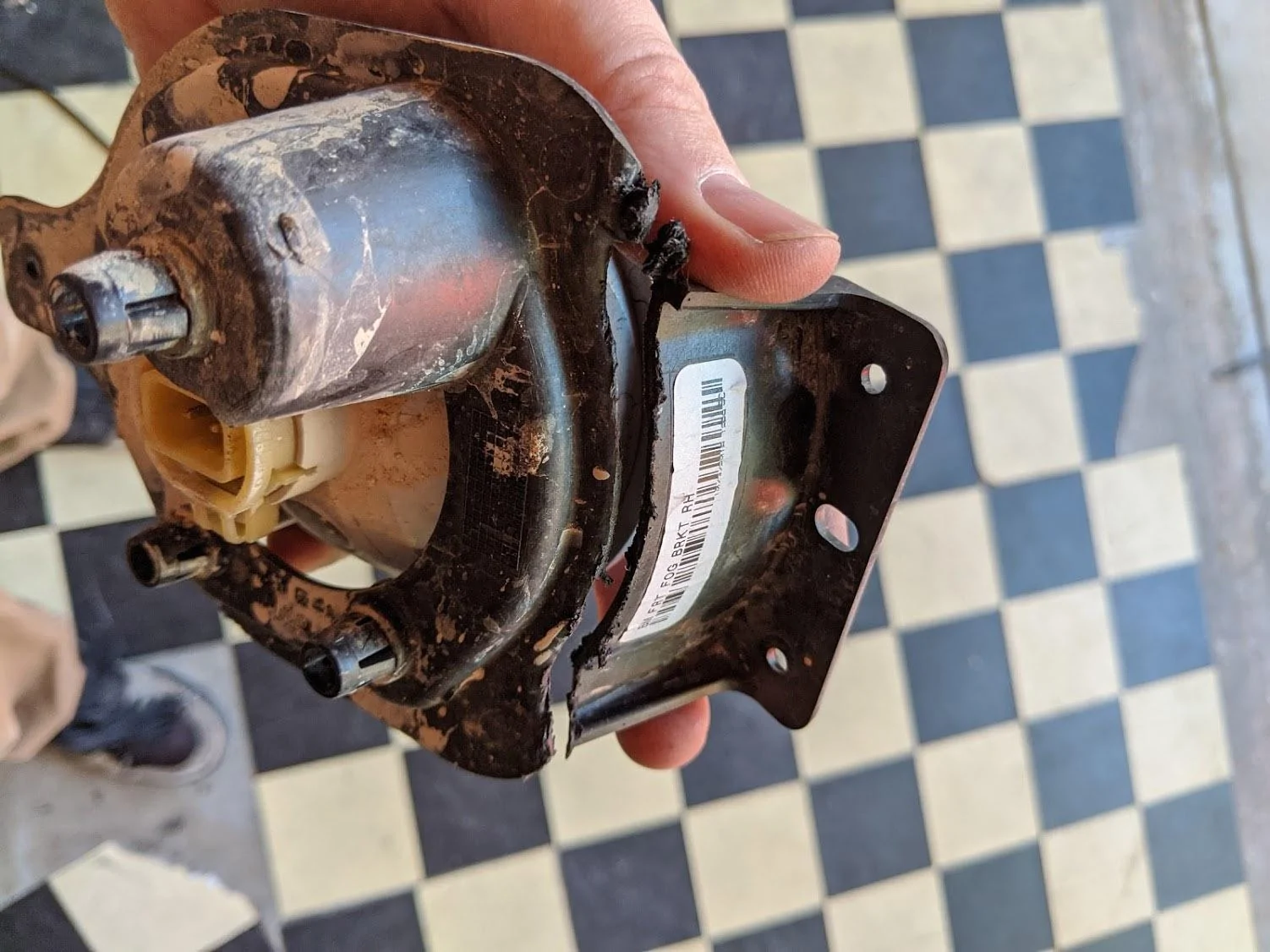

installed mine this morning. All of the above mentioned cuts and drilling seemed appropriate and necessary. I also ran into an issue with inner side support brackets hitting the winch plate, it seems reasonable as in the ace photo above that they are removed. I considered that, but the fitment of the winch-plate really seem like they should stay installed, so I had to cut an angled bit off the bottom of each, then it worked fine. attached photo.
Jeep Wrangler JL Ace Stubby Pic Request bumper
Jeep Wrangler JL Ace Stubby Pic Request bumper2
Dremel'd the foglight
Jeep Wrangler JL Ace Stubby Pic Request fogtlightcut
as seen in one of the pix below, the red is what the bottom blue area looked like, before I cut it.
Jeep Wrangler JL Ace Stubby Pic Request winchplate

Thanks for this side-angle pic. The frame sticking down below the bumper like that looks really unfinished. It's kinda surprising. I wish they offered a skid plate to cover some of that up... Out of curiosity, why'd you remove the factory metal plate that goes across there?
It looks likE @CarterRuss left the factory plate on... which, I can't decide if that looks better or not :)
And I saw that @Silent Panda just completely cut his frame off after installing the sway bar disconnect flip... but I'm still not quite ready to cut factory pieces off :)

Thanks for this side-angle pic. The frame sticking down below the bumper like looks really unfinished. It's kinda surprising. I wish they offered a skid plate to cover some of that up... Out of curiosity, why'd you remove the factory metal plate that goes across there?
And I saw that @Silent Panda just completely cut his frame off after installing the sway bar disconnect flip... but I'm still quite not ready to cut factory pieces off :)
yeah I think down the road I will cut those lower tabs off. I guess just general preference on leaving or removing that that crosspiece.
