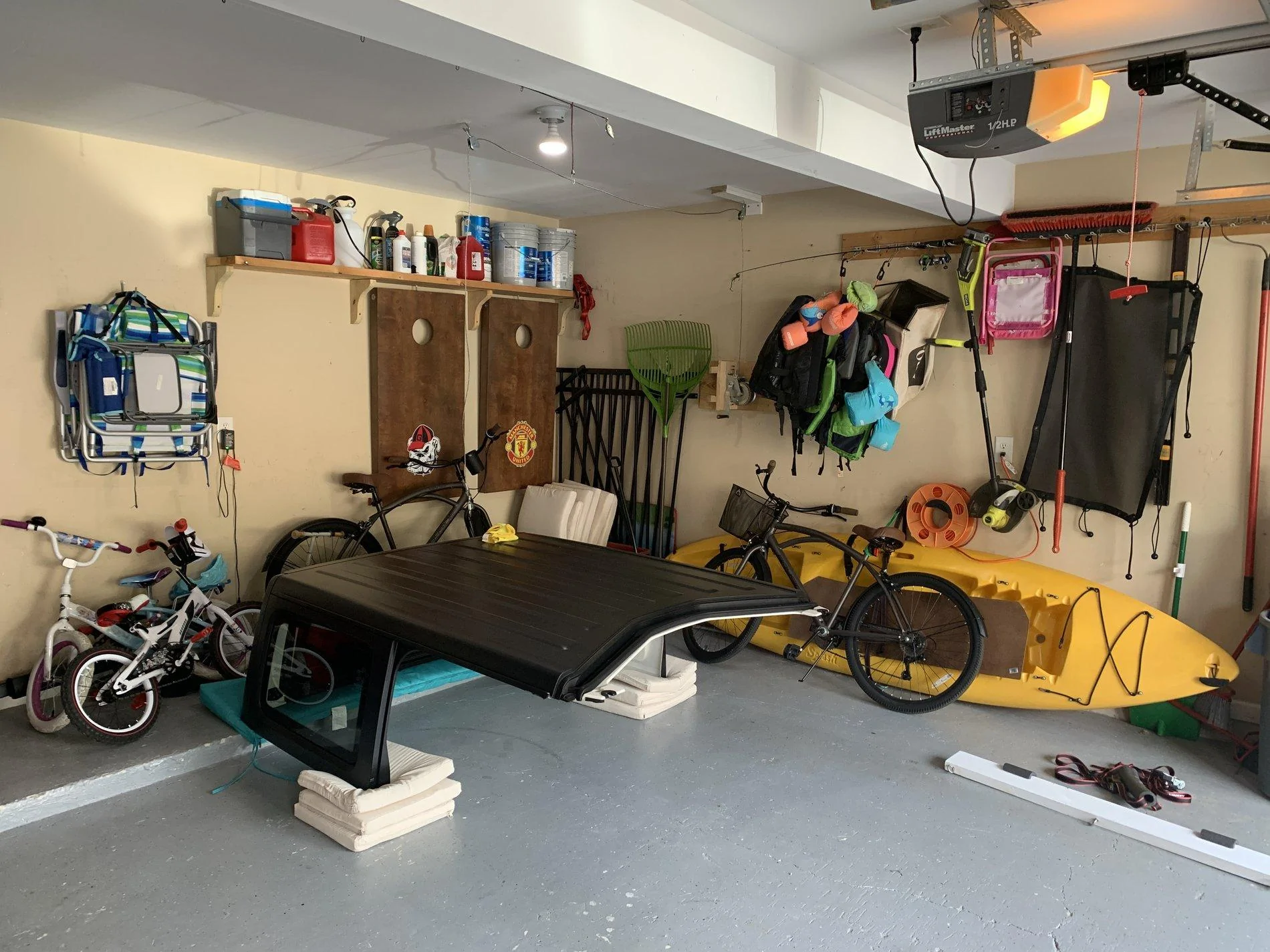

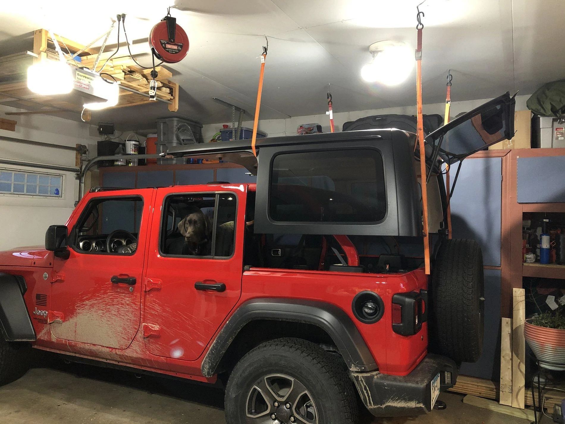

The main bar is angle iron so before I drilled the hole for the lift point I rigged everything up and used the winch hook to lift the top very carefully just an inch off the ground to find the sweet spot. There were lots of pillows involved. But it actually wasn’t that difficult.THAT
IS
AWESOME!
How did you measure for your "lift point".
I was planning to build this out of unistrut so that I would have plenty of options for mounting holes/lift point(s).
