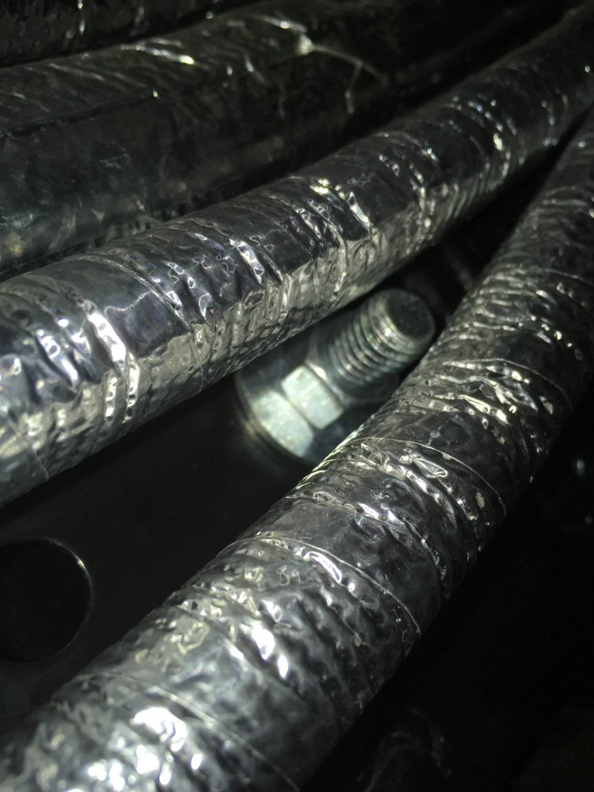

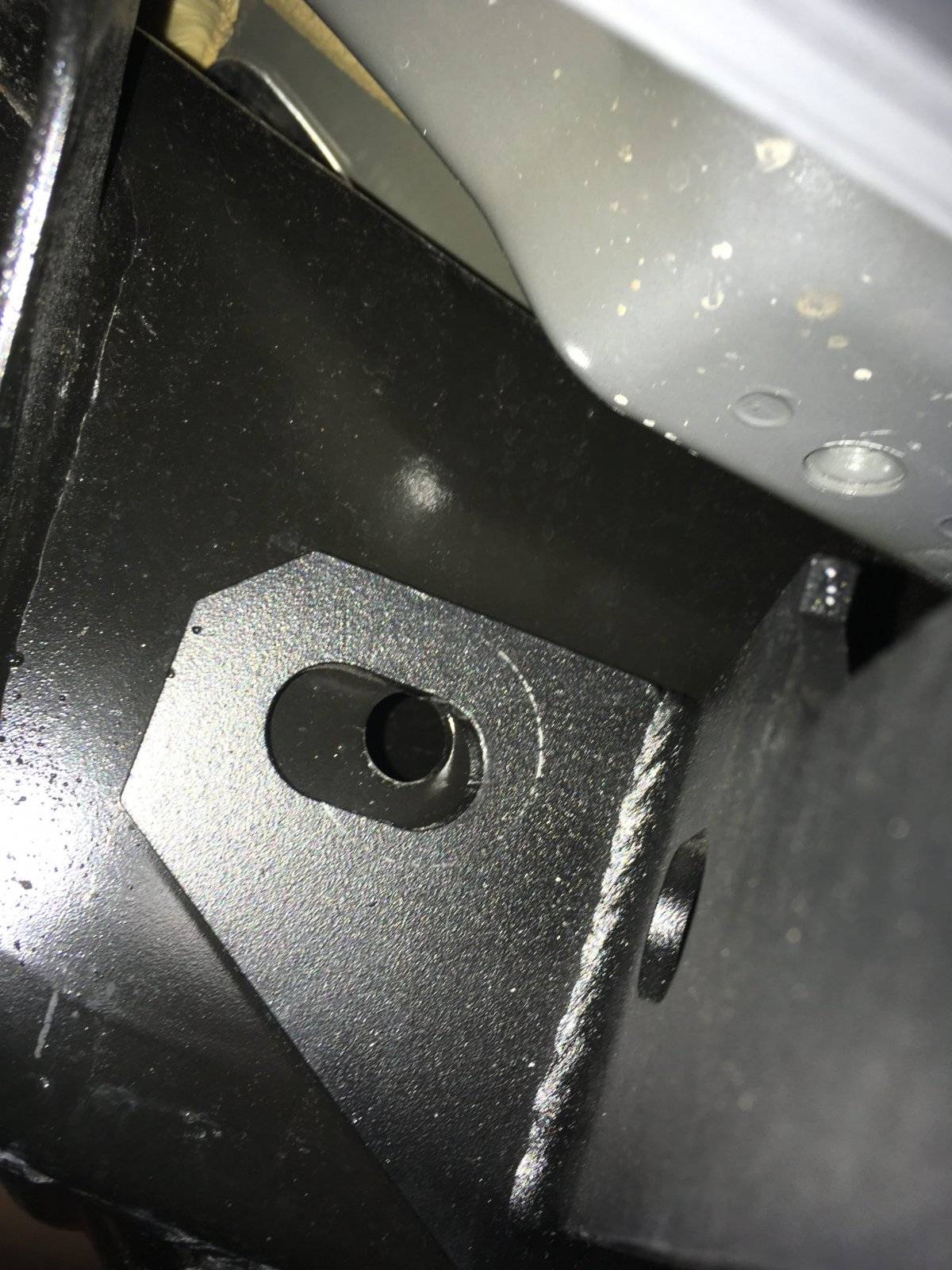

Just put a set of LoD destroyer sliders on my Rubicon 4xe.
Found a few problems
Front bolts are too short. Seems frame have an extra inner layer. Got some 1 1/2 long bolts that solved the issue
Then another issue. The front bolts through frame. Driver side where there is a hole but on inside there is some I think battery coolant lines. They are very tight to this bolt. I had to put it through from outside as bolt head did not fit between the aluminum covered lines. But even now the threads will touch the aluminum cover. Not good. Solution is to make the bolt about 1/2 inch shorter. Have not done this yet. Also tight to get bolt in. Think frame have a extra layer steel.
Passenger side inside of frame have some rubber lines that block access to drill hole from inside. Maybe with an angel drill but I don't have one.
Still happy with result but I know I don't have the perfect bolts in place.
Lifting the rails alone and get the nuts in place is possible as I did that. But recommend having a helper to lift.

Thanks for that info. I suspect I may run into similar problems with the ROAM sliders. If it turns out to be the case I'll just use the body mounts instead of the frame mounts.

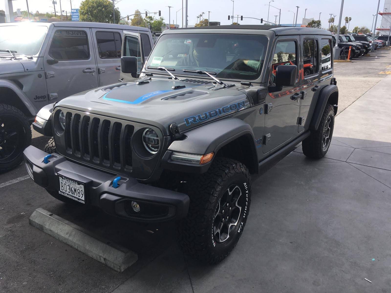

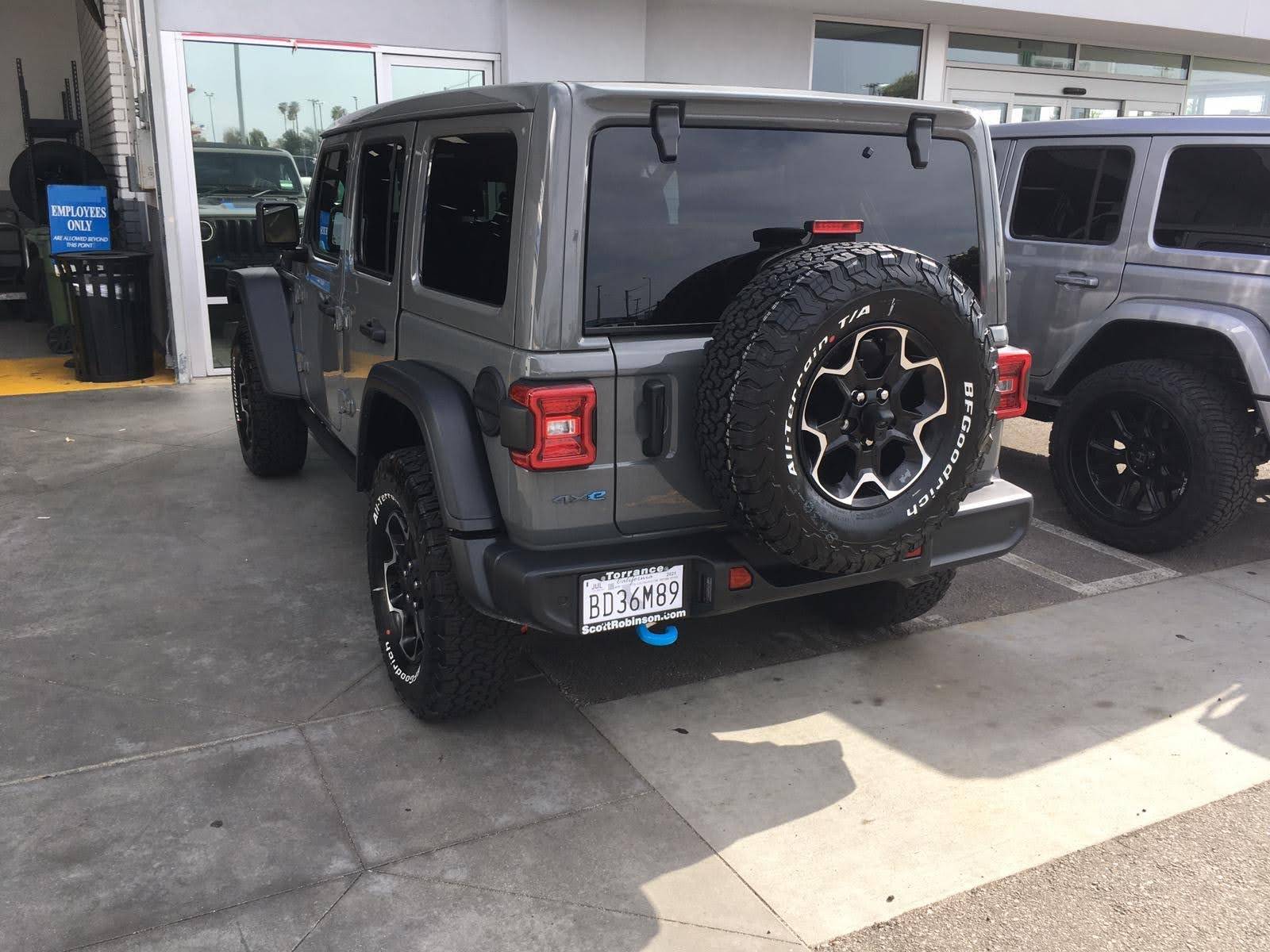

Hakan, you have sting gray with black fenders and black top? Can we see pictures :)
Actually the sky top but yes black fenders
Before I got my sliders on it looks like this

You probably want to cap that bolt with some rubber or something soft. It will wear through this lines eventually and that won't be cheap.
