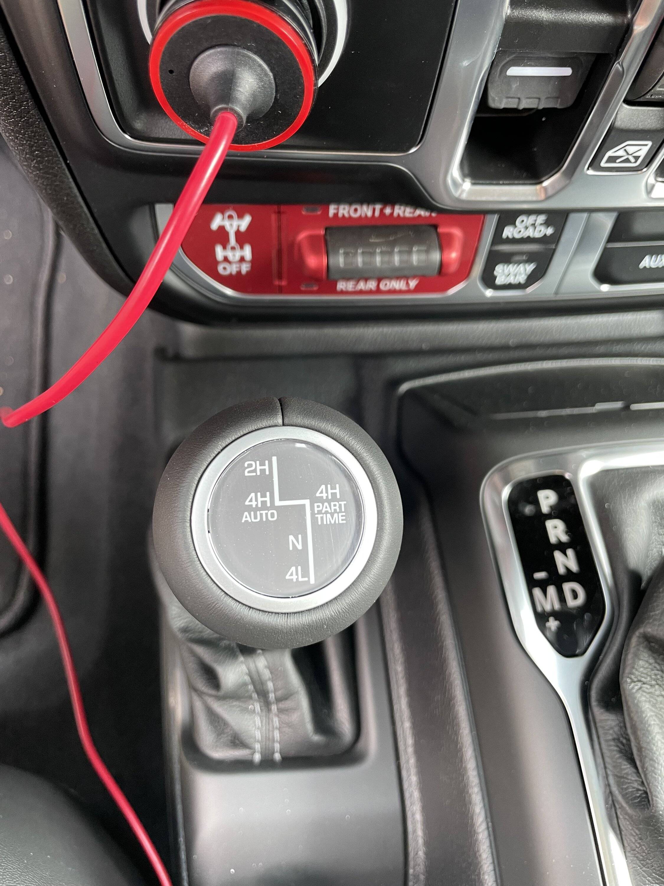

Does the new Rubicon X have the full time 4WD option? I saw a youtube video and on the 4wd shifter, there was an option for 4H Auto as well as just 4H. I thought that option was discontinued?

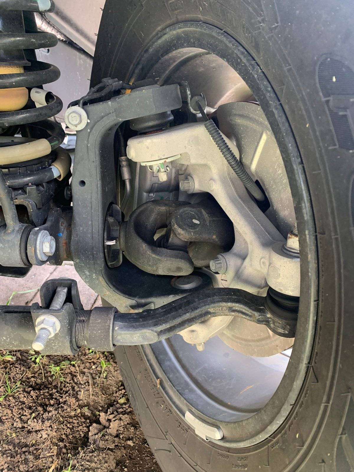

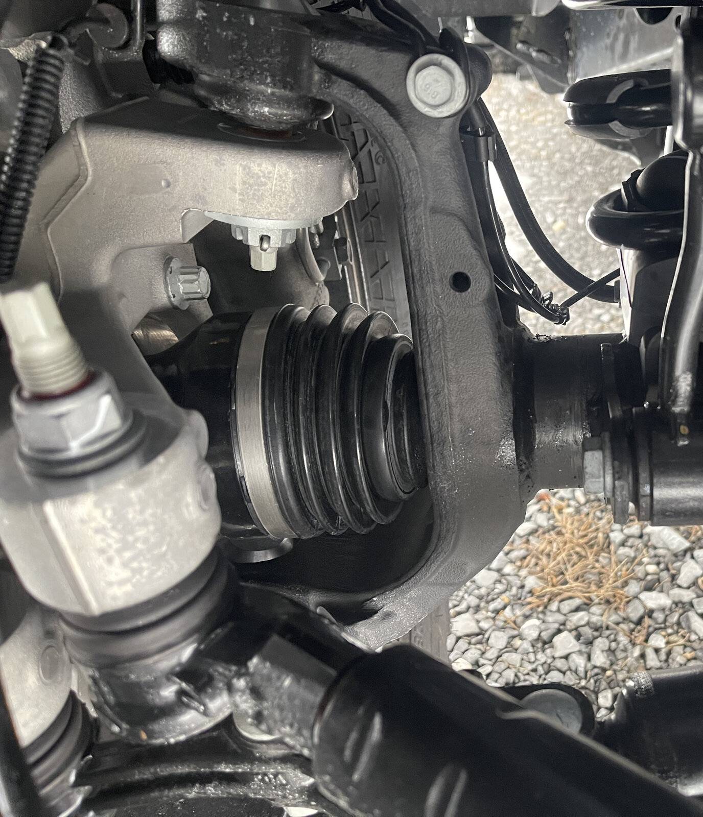

@John VonJeep what are the pros and cons of those joints? I'm reading the CV joint should be stronger and I seem to recall the rubber boot, if torn, will cause it to fail quickly. Is that about it?

Well, the CV joint won’t be stronger, but you don’t hear stories about them failing either. The boot is the main thing to keep an eye on because if you lose the grease things will get fun.
Like I mentioned, I honestly wouldn’t worry about it. If you wheel hard enough to need the U-joints, you’d know it. But there is a difference between the two systems and Jeep doesn’t emphasize that. I just think these things are worth knowing as an owner.

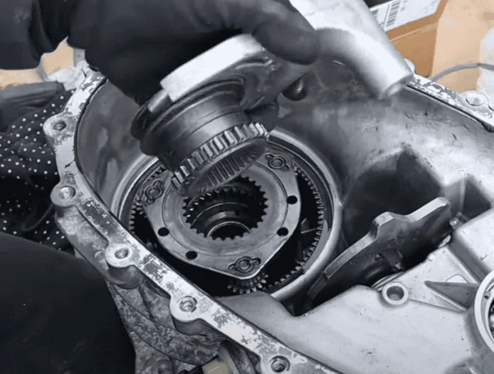

Here is a good video showing a teardown of the "Full Time" transfer case out of a selec-trac JL. Pretty fascinating and will help with understanding how it works.

Cool video!
Is it just me or does it seem like an awful lot of torque going through this gear?
I'd be interested to see if the Rubicon transfer case has a more rugged looking gearset.

I believe you can also steer tighter with the CVs so you have a smaller turning radius.
I'm really surprised some offroad company hasn't developed a Kevlar "jacket" for CV joints.

I used to have a 1995 Jeep GC with full time 4x4 and the 4 low selection, but those boots drove me nuts. They always seem to rip at the worst time. I had lifetime axles and kept spares in the garage. It wasn't really an offroading rig even though it had a solid axle, but all it takes it one stick to jam a hole in that boot. I'd say the 4H auto is a nice feature, but if the weather is bad enough then shift on the fly is good enough for me in my Wrangler.
Looking at the 2024 order guide, it appears that the full-time 4WD system is only available on the 392 model and the 4XE versions of the other models. It is standard equipment on each of those models.
And that is why I am so confused. This video I saw on Youtube was from Summit Auto Reviews. They do a lot of Jeep content. They were reviewing a Rubicon X and on the gear shifter, it clearly showed a 4H Auto Setting. I commented on their video with this question but they haven't responded.

OK. Apparently the Rubicon X package comes with the full-time 4wd system. The order guide that I looked at earlier did not list the full-time 4wd system as part of the Rubicon X package. However, I have seen a 2024 window sticker that shows that the full-time 4wd system is included with the Rubicon X package.
