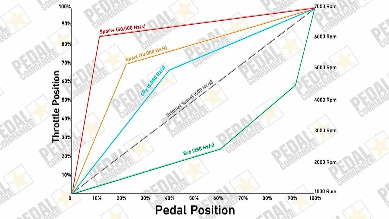

One thing that may help is a Pedal Commander or similar product that alters throttle input. I prefer a sensitive throttle on road, but not off road. So, I put mine in Eco mode when I am in 4-low since it makes the throttle less sensitive than stock which gives me better control with less jerkiness.
Jeep Wrangler JL 4wd Lo is Jerky Jerky 1748543130261-dn
