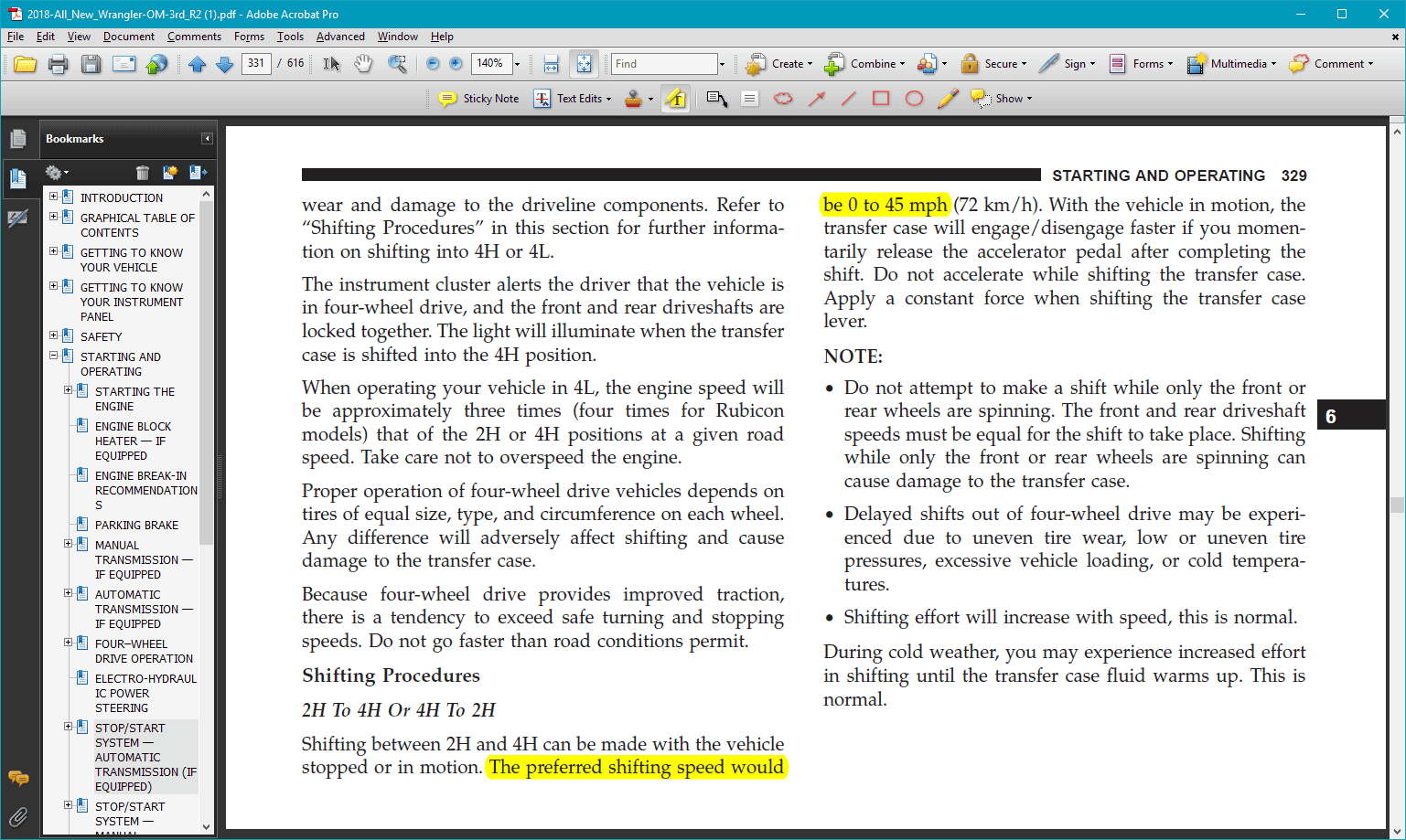

can you show me where it says max 50mph in the manual, because all my other 8 jeeps says it's safe to engage 4hi at any legal highway speed.
i'm just curious if the JL is any different.
XJ-99
Patrick
Dec 26, 2017
214
233
USA
1999 Jeep Cherokee XJ (sold), 2010 Toyota RAV4v6 Limited (sold), 2019 Jeep Wrangler JLU Sport S, Mojito!
Jeep Wrangler JL 4H or 4L upload_2018-11-9_15-36-54
