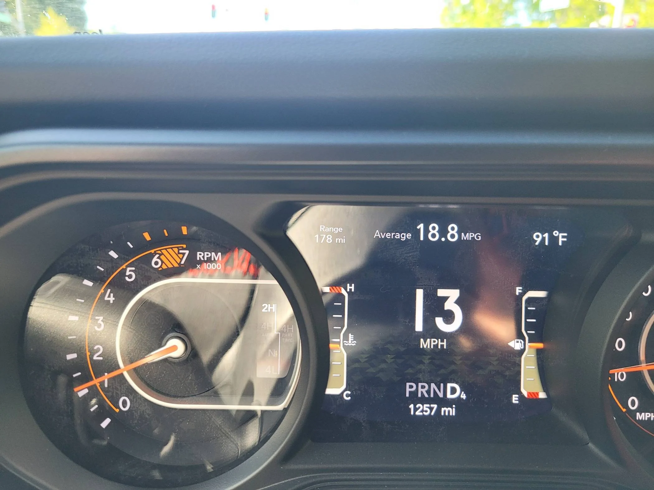

4:88's, V6, Auto, 35's, at 60mph = 2000rpm
70mph = 2300rpm
80mph = 2500rpm
My mileage varies between 16-18 mpg for normal street/highway driving.
Go for it, you won't be disappointed.
