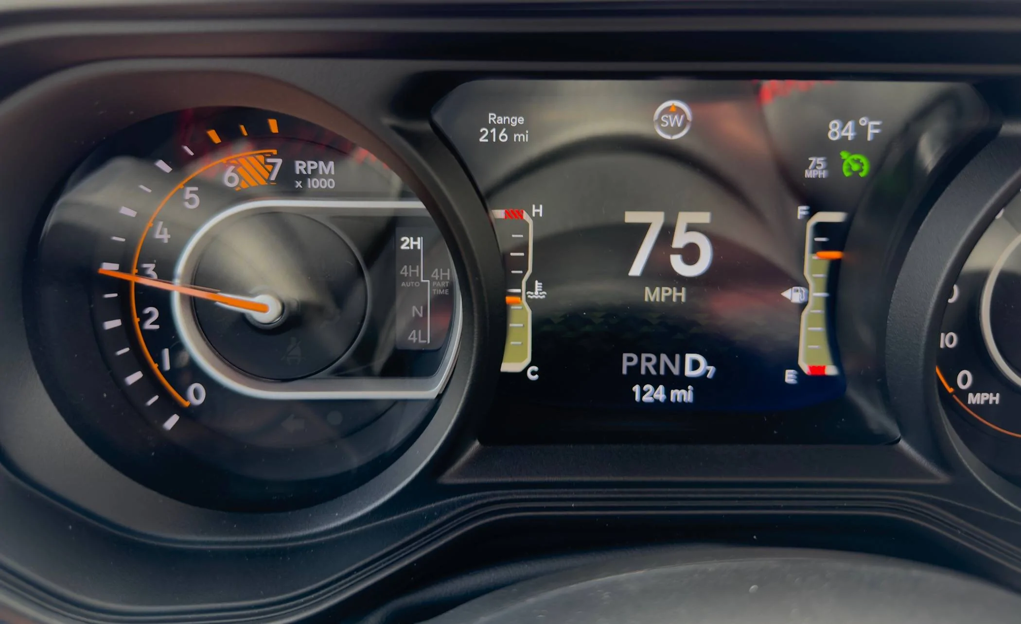

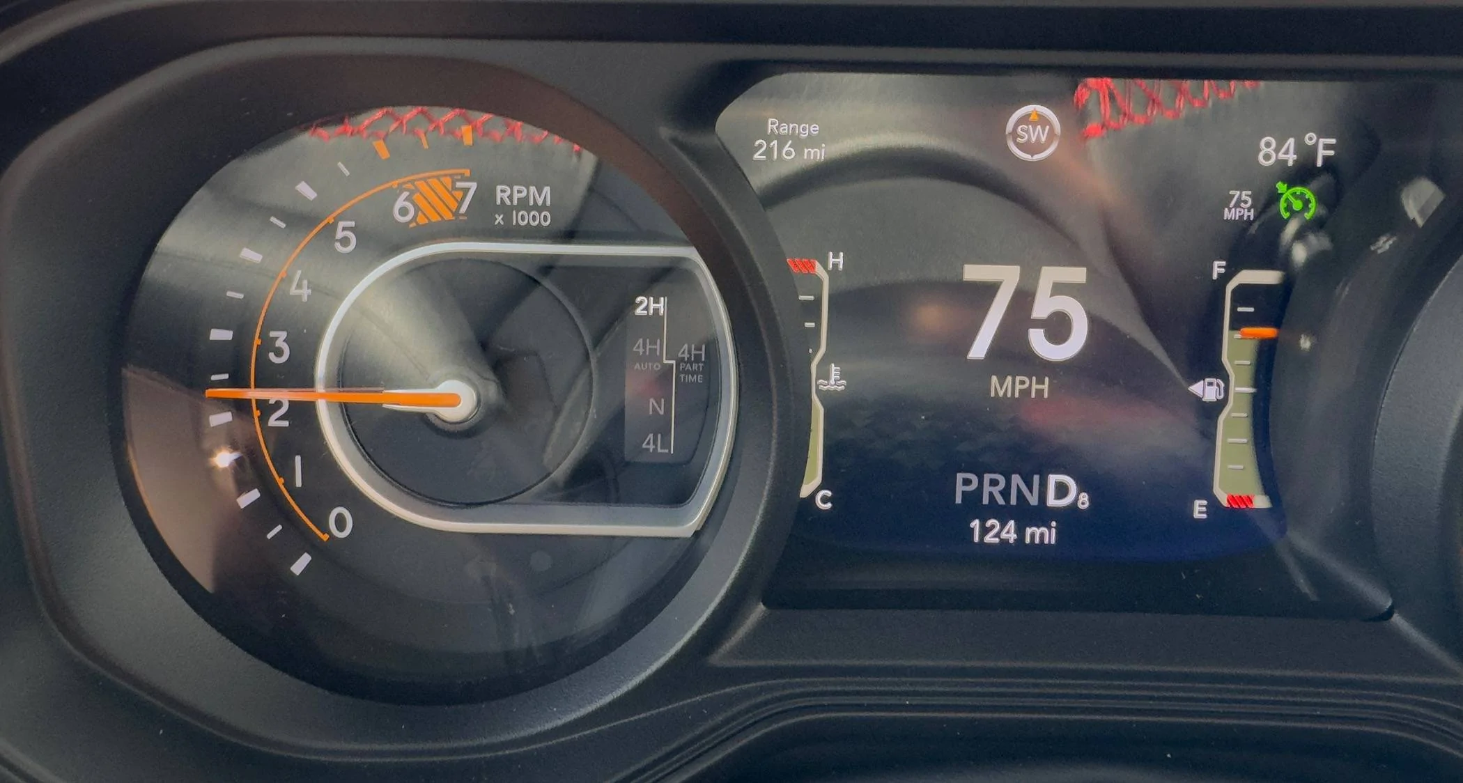

In case someone wants to see a similar setup at 75mph and 8th gear (4:88/Auto/Factory 35 KO2s) :
Jeep Wrangler JL 456 vs 488 Questions IMG_1507
75mph + mild downshift to 7th:
Jeep Wrangler JL 456 vs 488 Questions IMG_1509

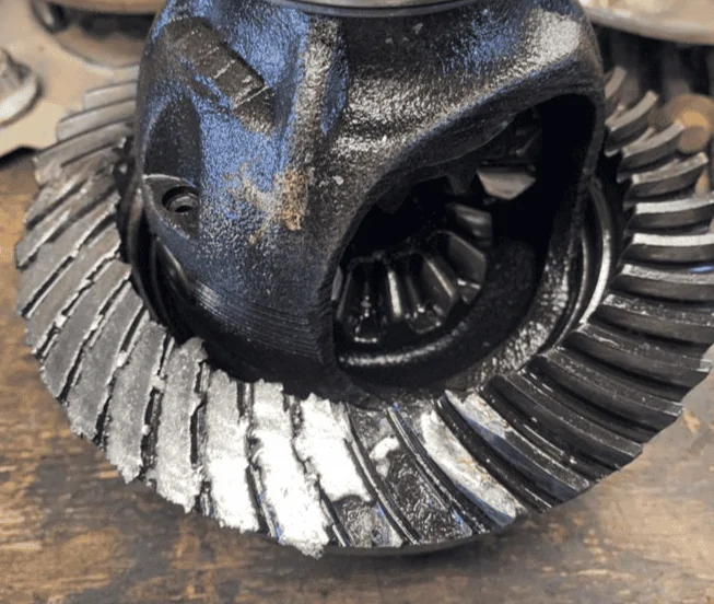

WHAT? Gosh, what you doing to that axle my friend?
Not axle. Gears.
They're either shitty gears, shitty installs, or I'm a really, really shitty rock crawler. Take your pick.
