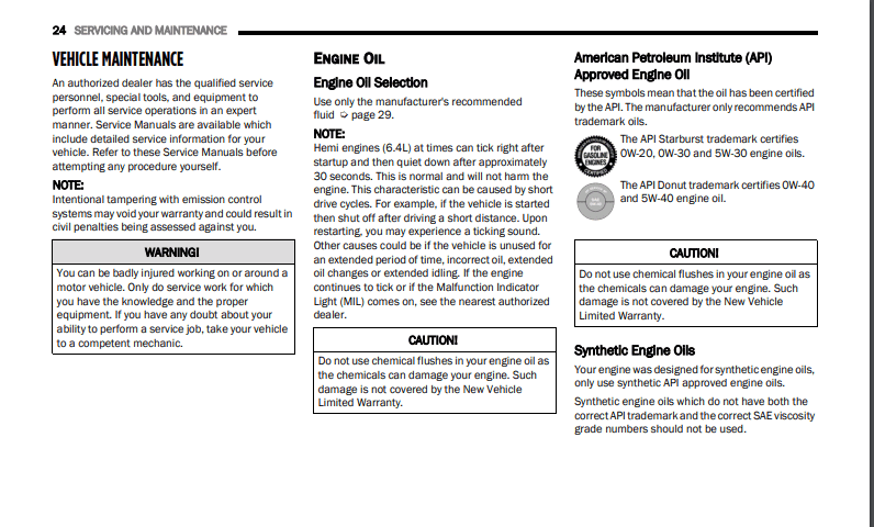

You have a 3.6, not a Hemi. It's a completely different Jeep.
The noise is normal, it is documented in the owners manual here:
Jeep Wrangler JL 392 Squealing upon startup / Recorded audio Screen Shot 2023-02-01 at 11.06.18 AM
https://vehicleinfo.mopar.com/asset...ngler/P121624_22_JL_RUB_SU_EN_USC_DIGITAL.pdf
If it makes you feel better to have it documented then take it in under warranty, but its normal.
