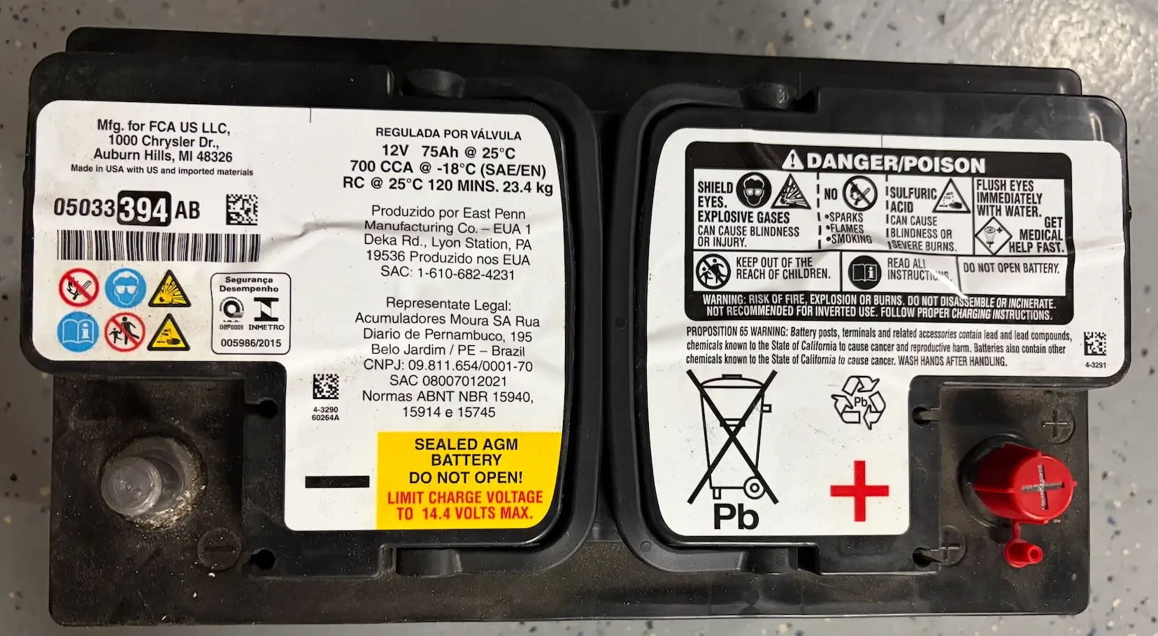

Just add to this thread. I've been noticing this "Aux Switches Temporarily Unavailable Battery Charging" message for a while, at least a few months I think. A week ago the cold start took a a second longer than usual and today I confirmed this behavior again even though it's about 35 degree in my garage. I even tried after driving 12 miles while the engine was still warm. I could definitely tell the start up hesitated.
Without testing, I don't think the alternator is going bad. So just grabbed a new battery from Costco and replaced the OEM one after I got home. All good now.
For reference, the OEM battery will be 4 years in March. My previous Jeep GC had the OEM battery for 7 years no problem.

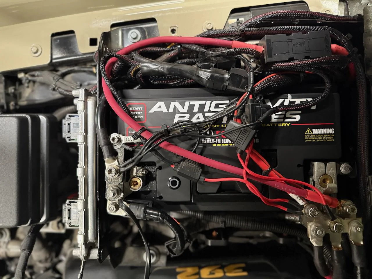

I started having other issues - took awhile to crank. Watching the voltage, it would drop nearly below 10. Now, I run a Bluetti DC/DC charger, ARB Dual compressor, warn winch and a bunch of Diode Dyanmics light off the battery, but was suprised to see this at 10k miles. CEL was on (battery couldn't power on some stuff so threw a CEL) etc.
Either way, decided to bite the bullet and swap in a 80Ah Antigravity. Everything works perfect now, with the added benefit of 32lbs lighter, and built in jump starter, and not limited to 50% of the power of the battery like the AGM OEM is.
Sorry for the mess of cables and wires - I decided to run my Diode Dymamics Ditch lights and REar Chase lights off the Aux switches instead of gettin a whole nother switch pad. Works great, but that means cables are everhwere. Will tidy that at sometime.

I almost went that direction but ended up going yellow top. Next time for sure.
