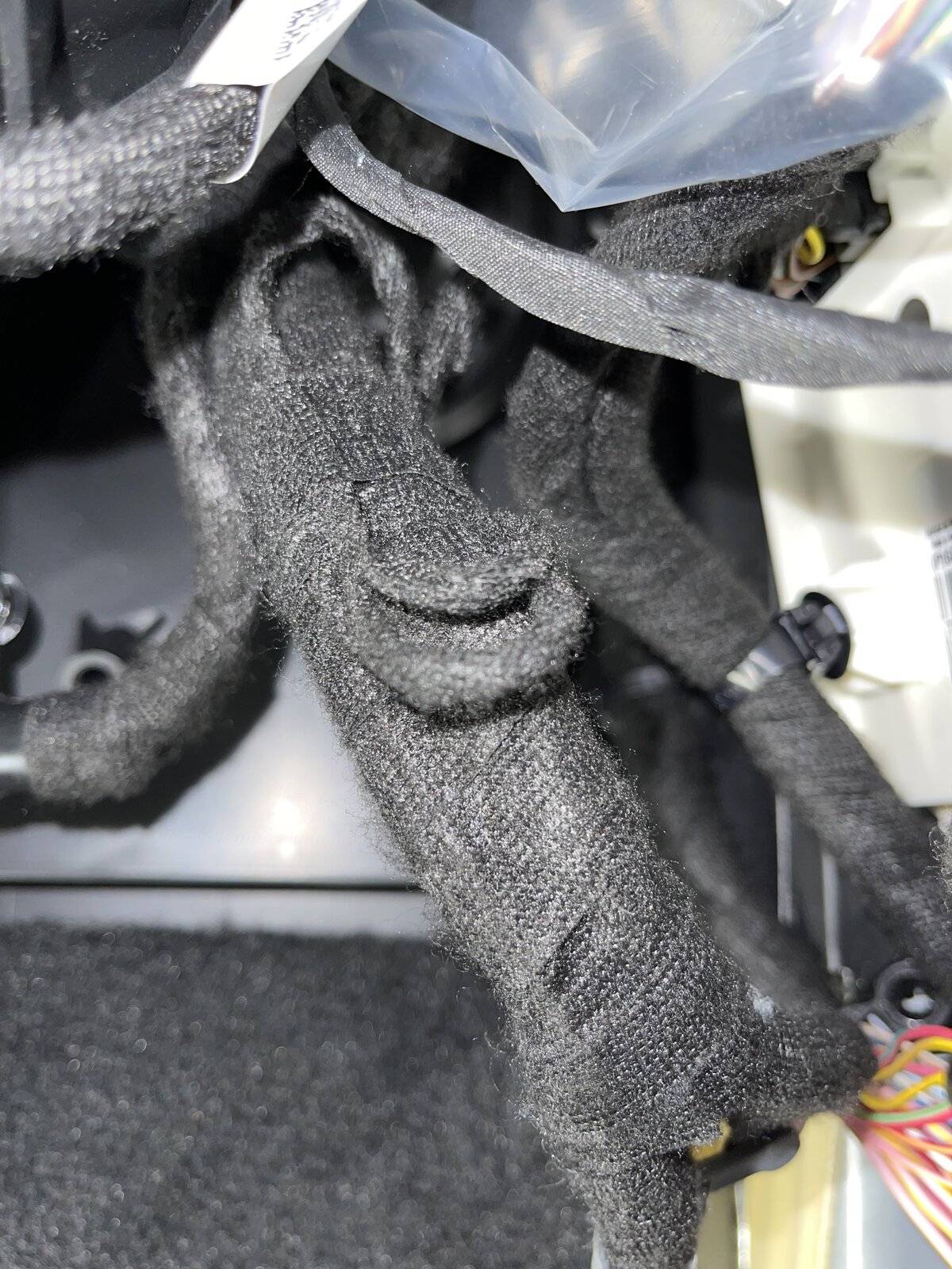

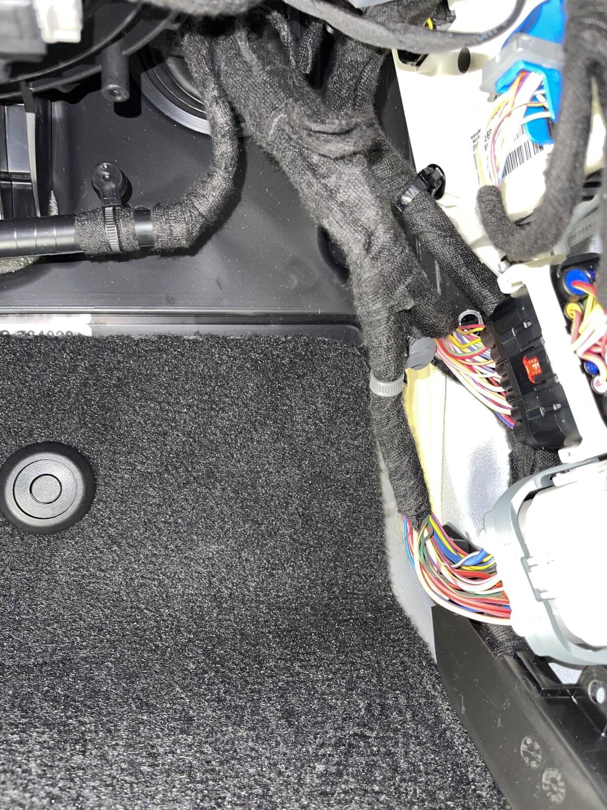

Here you go,
Engine bay, looking straight down side of battery:
Passenger footwell kickplate:
Both should be easily distinguishable as the ends are bundled with electrical tape, not cloth fabric.
Are you able to follow either harness and get a part number for it? My dealer said they will all have a tag and if there is a part number he can order it.

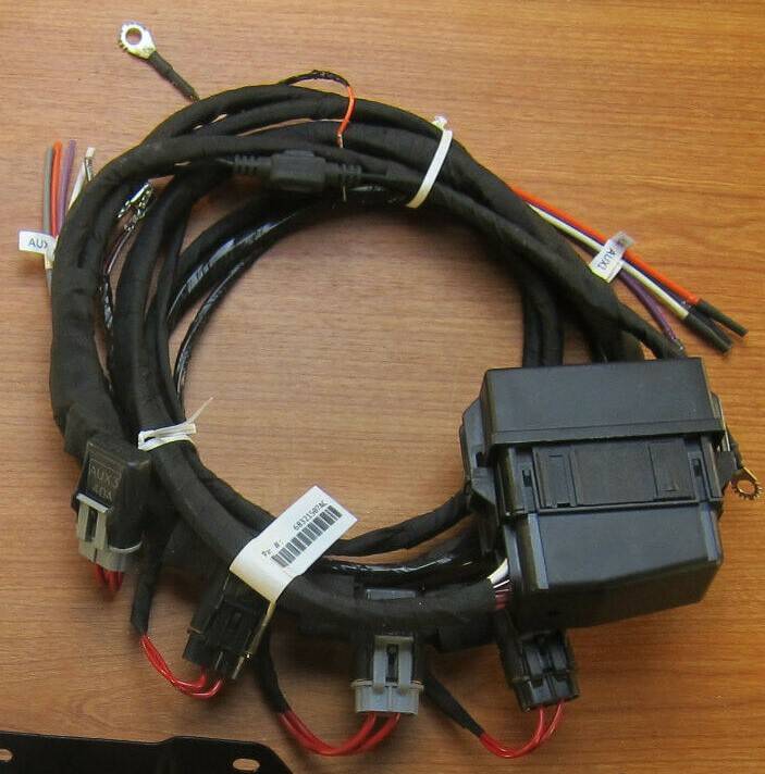

Looks like the harness part number is on the end behind the switch bank. From a sellers' pic, it looks like it's 68321507AC. I don't see it available for sale individually anywhere though, just as the entire switch bank kit.
Jeep Wrangler JL 392 Aux switch harnesses pn

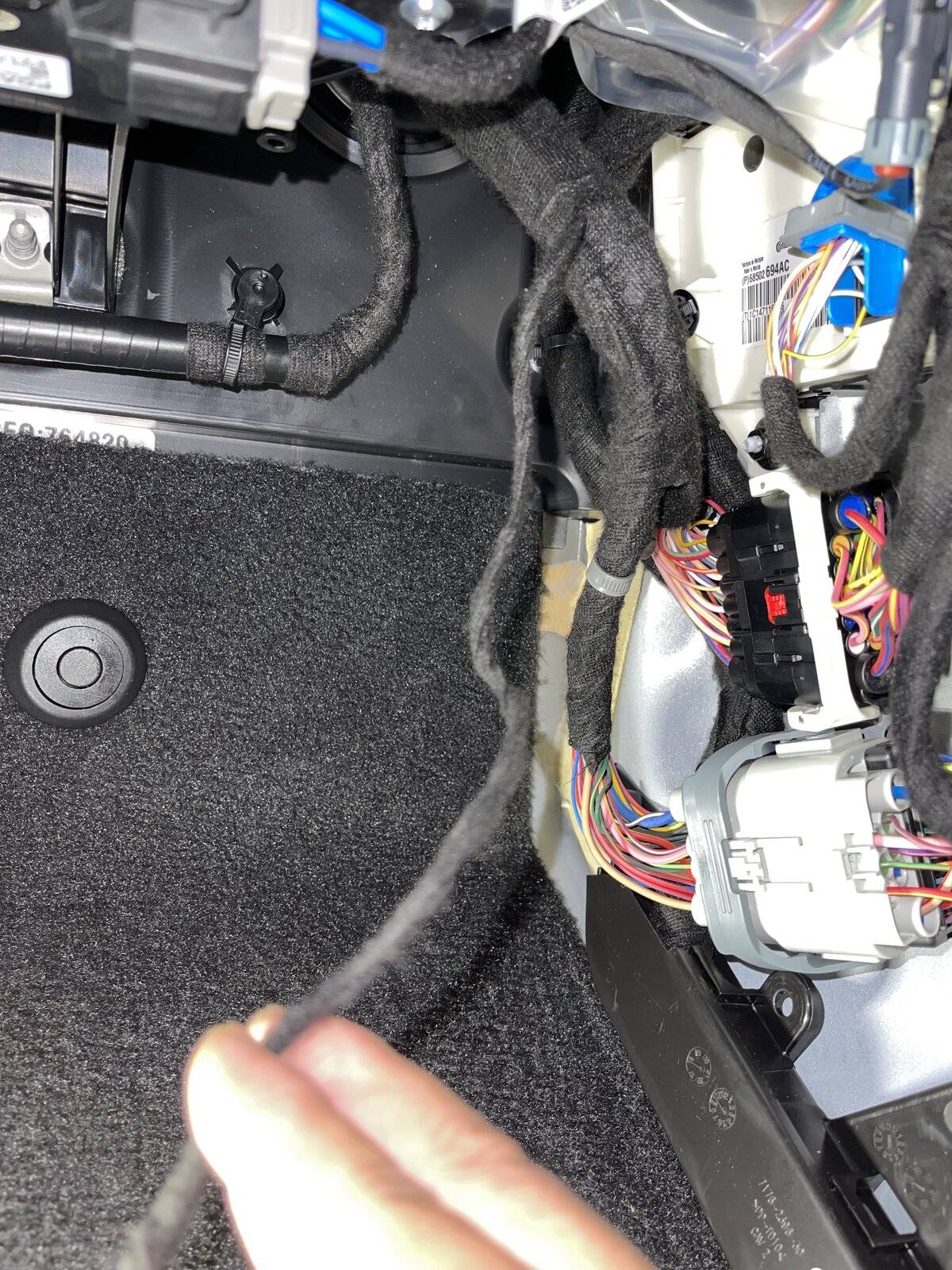

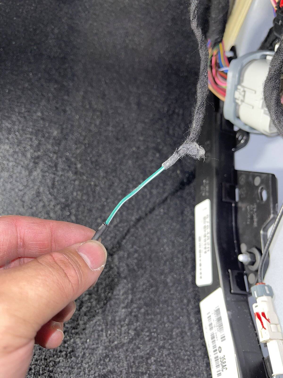

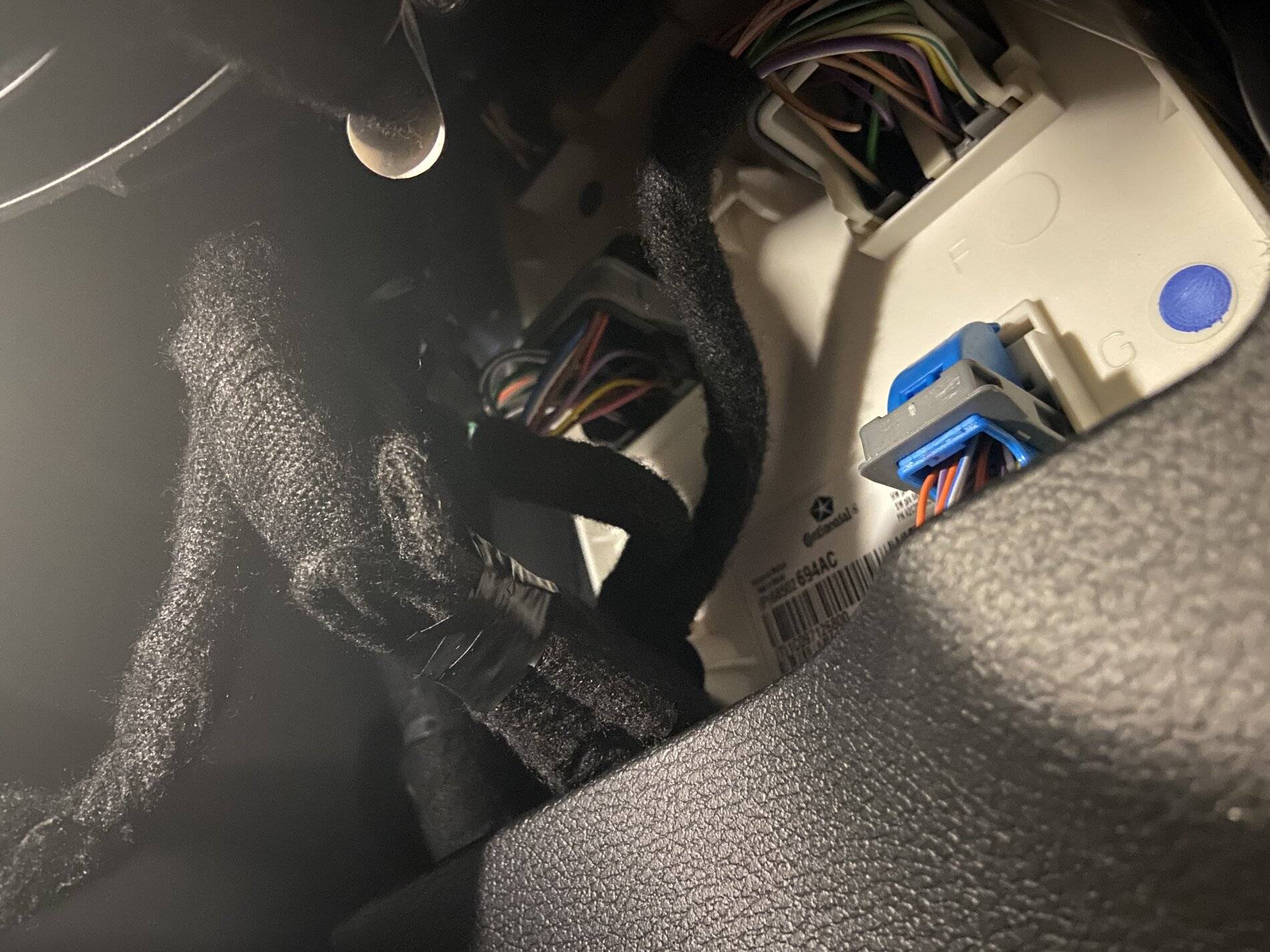

I was able to easily locate 4 aux wires in engine bay however the one in passenger footwell area is giving me trouble. I have only ONE wire. Green with white stripe.

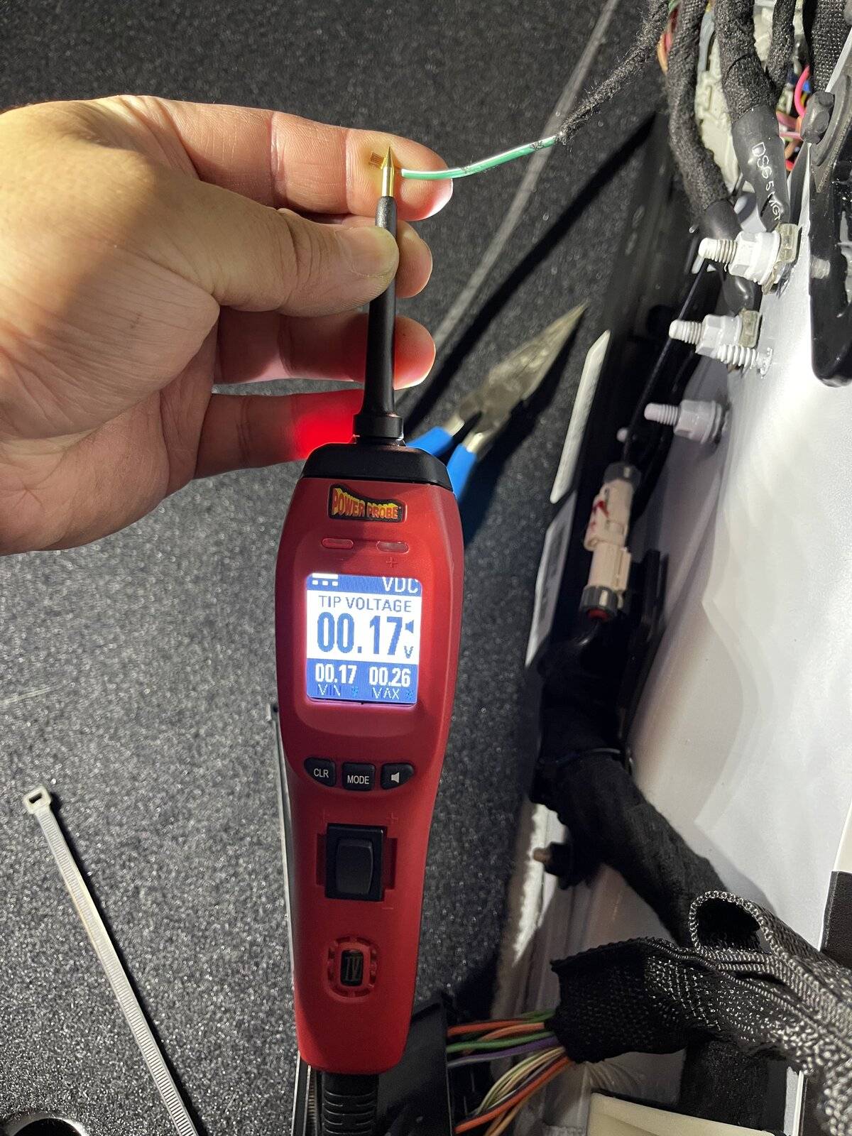

And that green wire has no power whatsoever. Not AUX 1234, not battery, and not ignition either ….

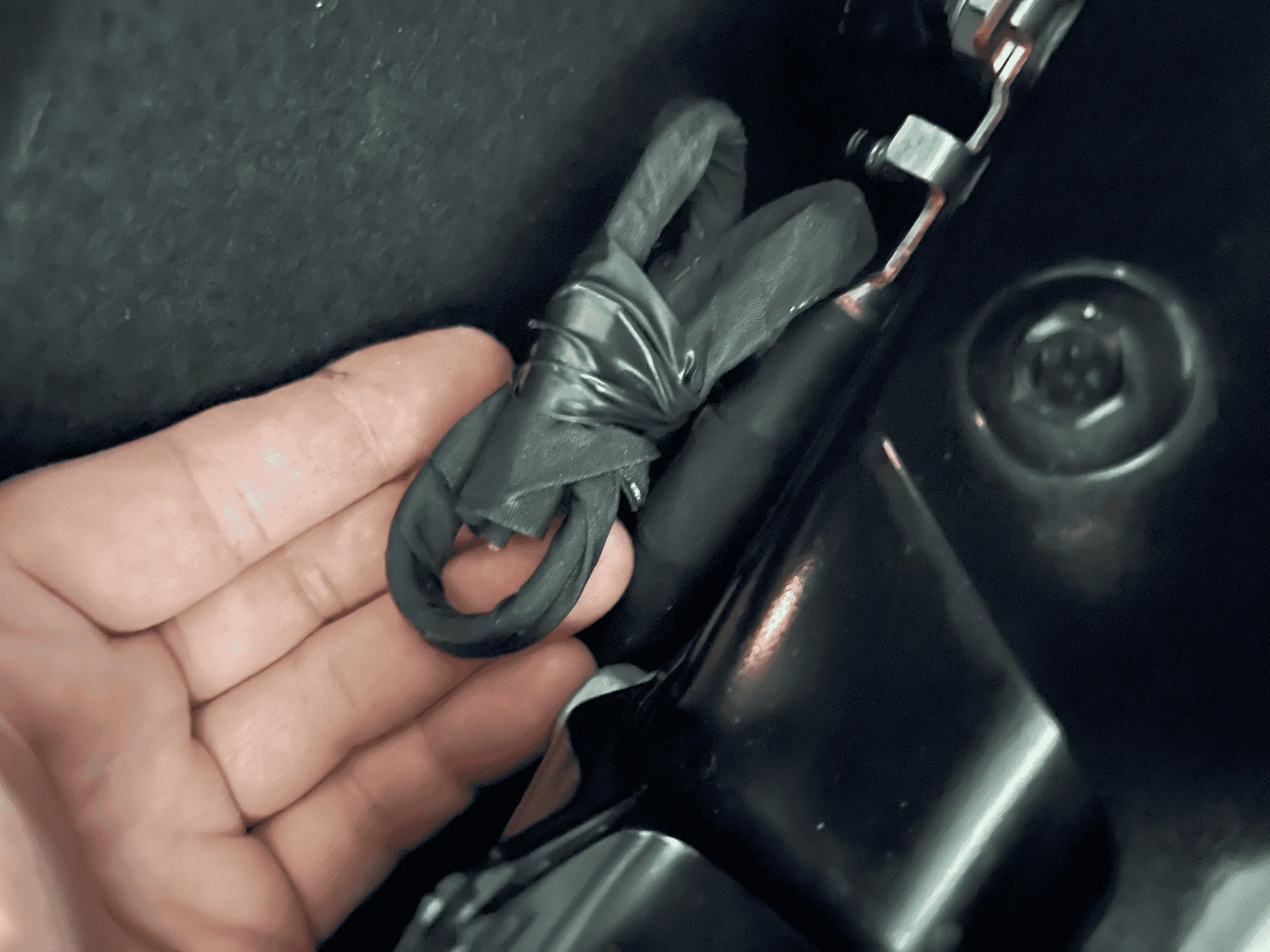

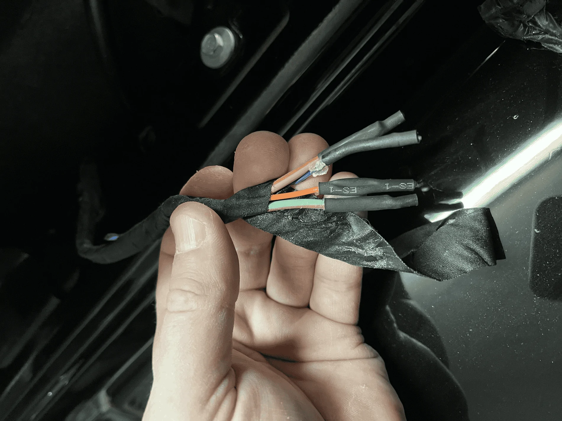

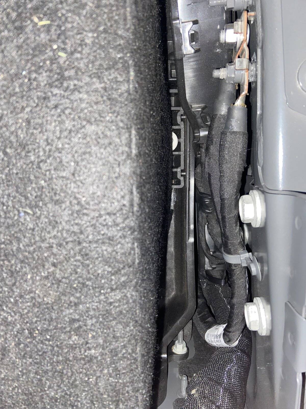

I came to this thread to find my seemingly non-existent underhood aux harness.
FOUND IT! It's very deep (lower than the battery tray), folded over several times and wrapped w/electrical tape. You can see it in the middle of this pic...
Here you go,
Had to use a hanger to pull it up enough to cut the first loop of tape w/scissors. You need to dig and surgically cut tape to get to the point where you can hold it in your hand.

yes, the part in engine bay is definitely exist, however I was saying the one in passenger footwell was missing.
It's on the left side of the passenger footwell... look for the electrical tape holding it up.

Mine was hidden/attached to a harness running from the kick panel to center of dash on the inside. I had to pull my battery to find the under the hood one. Jeeo hides them well
