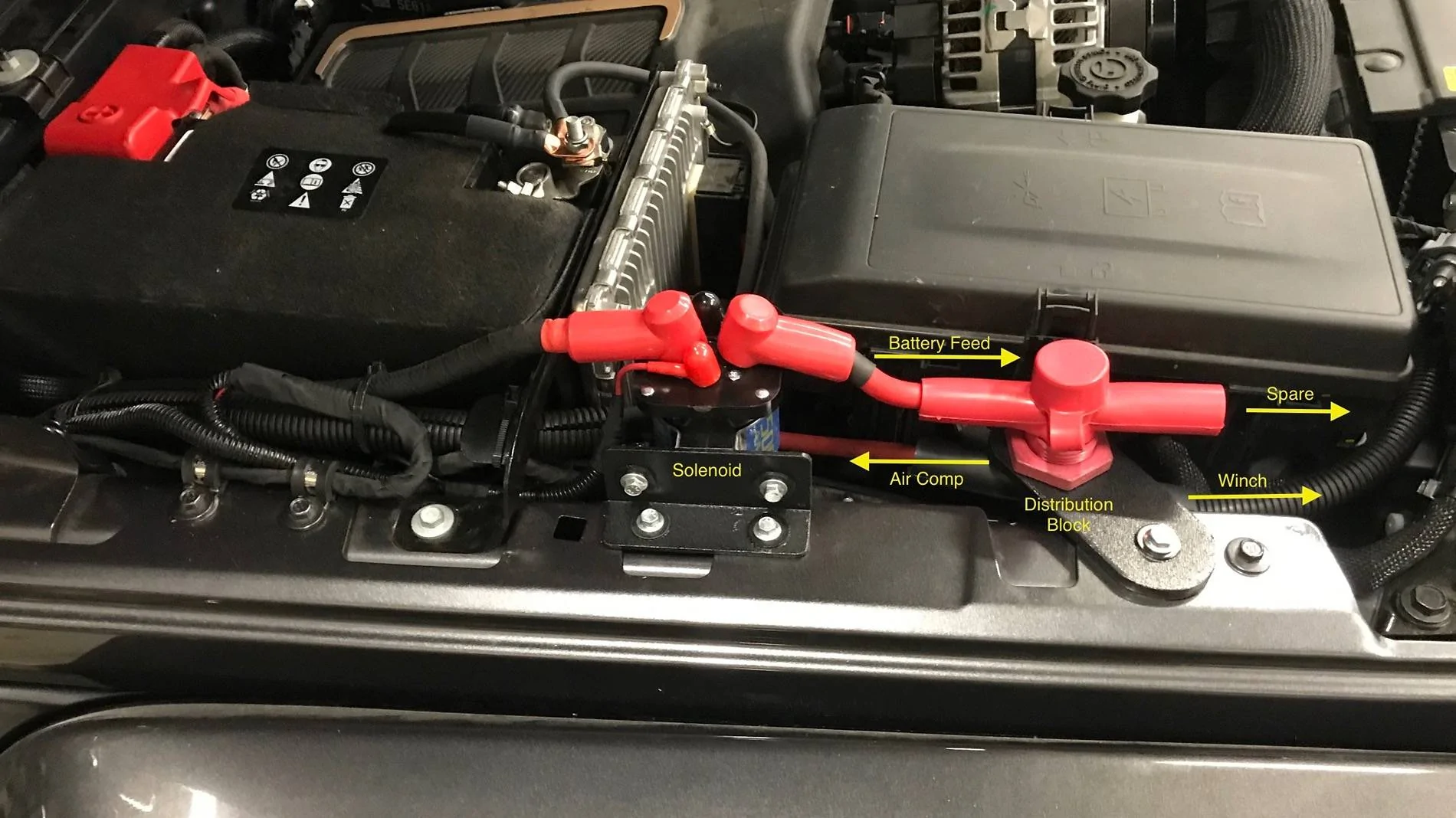

I used the Stinger 500 amp solenoid
First attempt in my 392, just used a small piece of angle iron. It looks ok and does the job.
Jeep Wrangler JL Winch Aux switch/ power interrupt kit install. IMG_0348

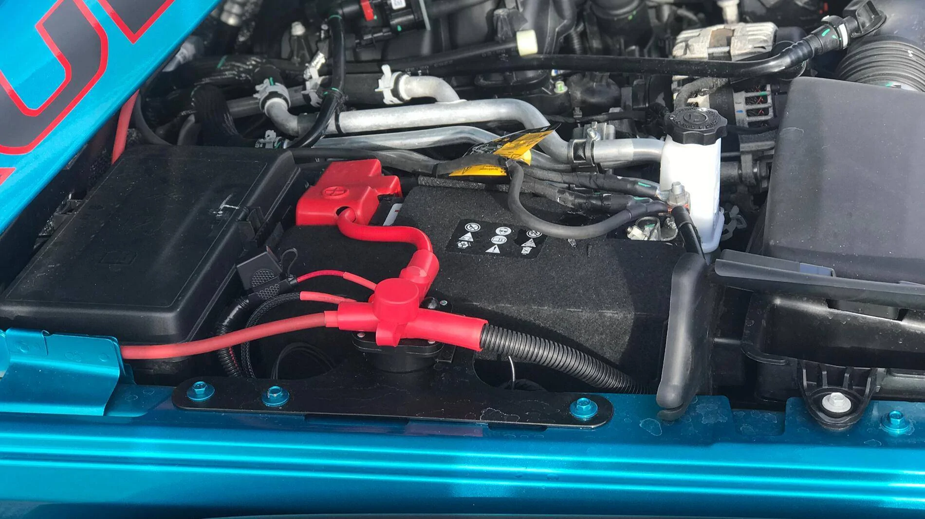

i got a little more picky on my 24 rubicon
Jeep Wrangler JL Winch Aux switch/ power interrupt kit install. IMG_2854
I use the solenoid to cut power to my winch and air compressor in both Jeeps and it’s activated by aux 2. I used the same solenoid in my JK that controls two winches and air compressor

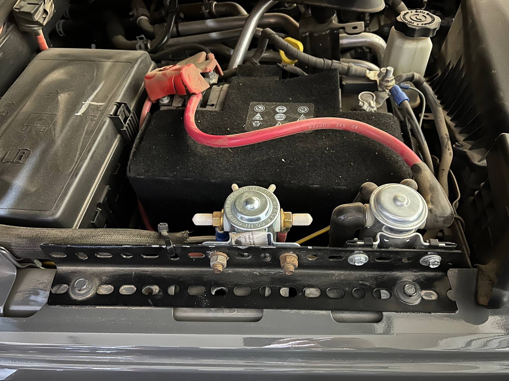

I used some slotted angle iron I had on hand. Then painted it and used the existing Jeep bolts to mount it.
One solenoid is from Warn for the winch, the other is for a 50amp Anderson plug I ran to the rear cargo area for an air compressor. Both are wired to aux switches.
Jeep Wrangler JL Winch Aux switch/ power interrupt kit install. IMG_7124
