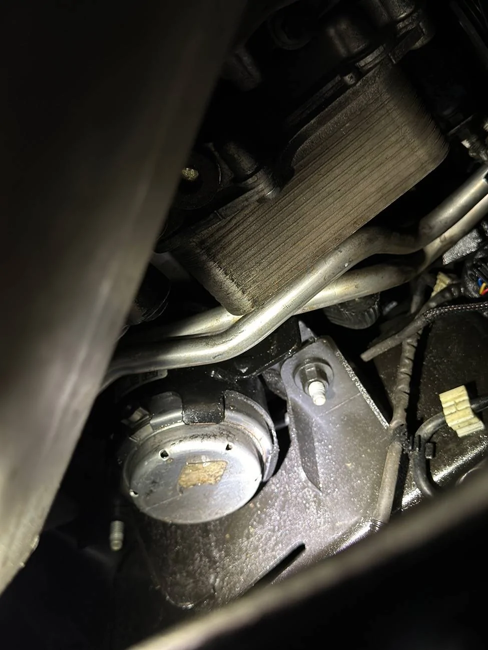

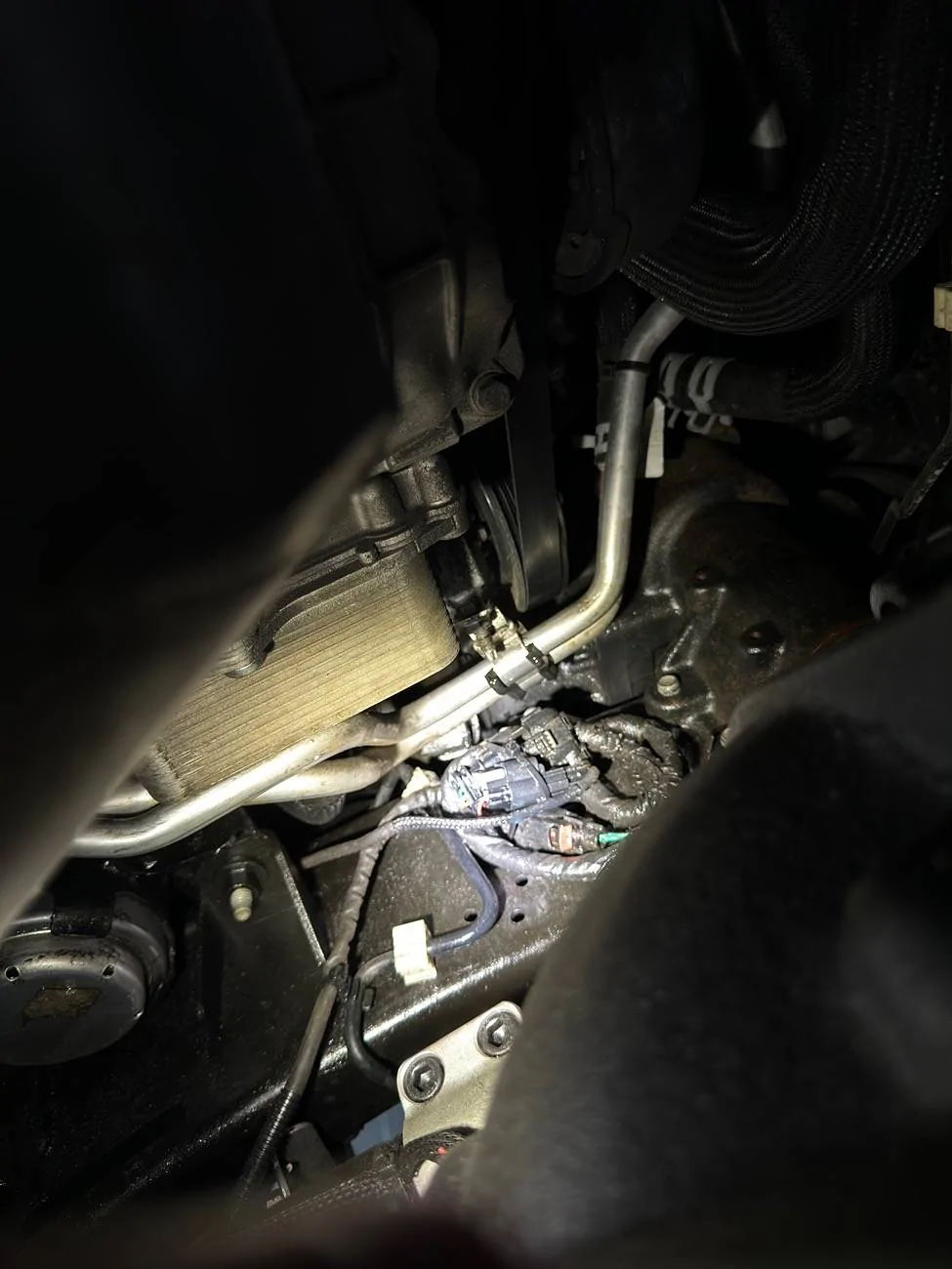

Did you get this resolved? I have fluid leaking all over the driver's side frame rail and I don't think it is power steering, and does not smell like diesel (have a 3.0 diesel). It looks like it is coming from the driver's side engine mount but I do not have clunking yet.

I’m between it being the drivers side motor mount or the steering box. PSC going in next week so hopefully it’s the box.

If its black, it's the mount.
But the engine is firmly in place with both sides broken on mine.
I think it's for nvh, which is mental in an offroad vehicle. So I might not bother to swap them out.

“Broken” engine mounts on the 3.6 will last for years. I doubt the pictures above are from an engine mount, the fluid that leaks from them dries very quickly and leaves behind only stains.
