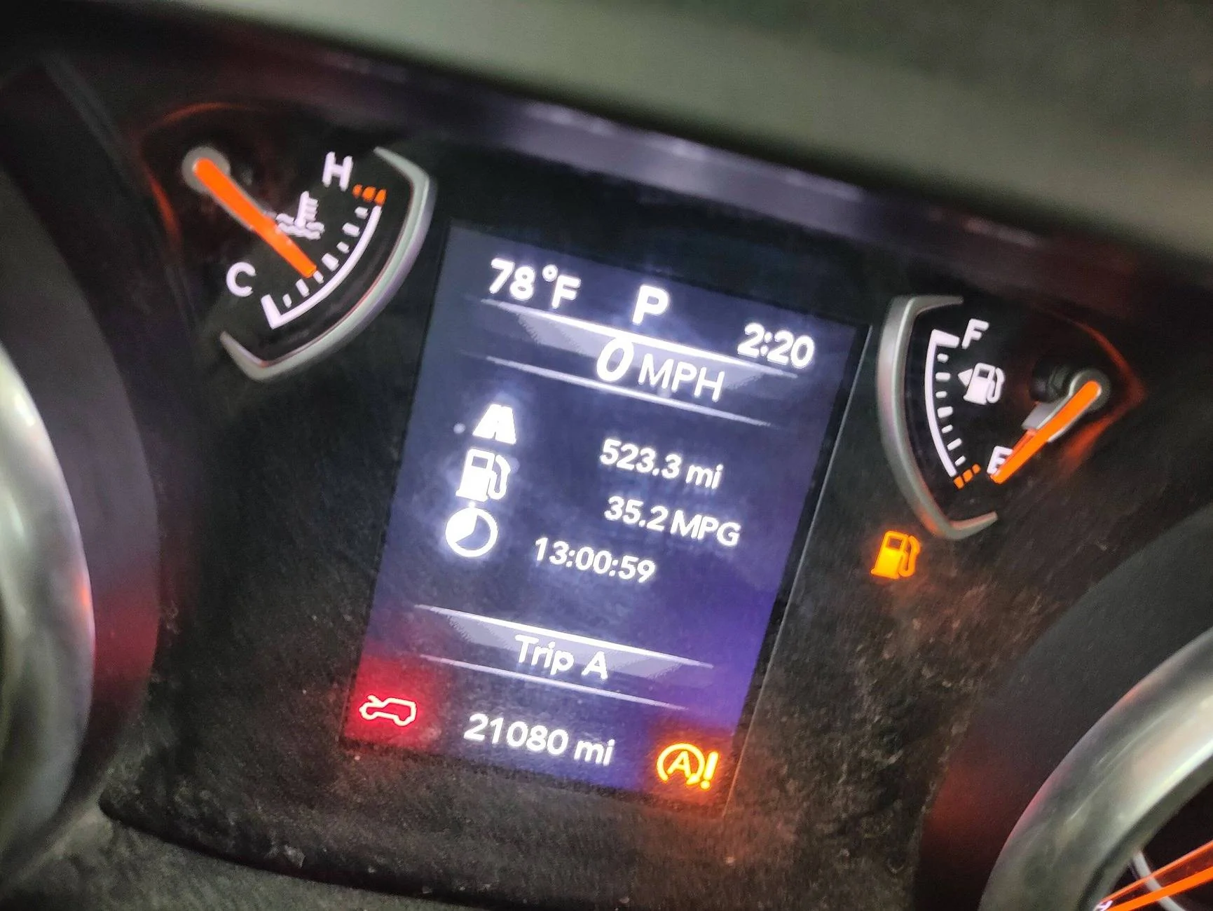

500 Miles you're not going to be getting from City driving. I did that once, 34.86 MPGs, 55 mph was the fastest I drove, 90% highways.
I do probably good 80 to 90% highway driving most days of the week, and I average 23 to 24 MPGs. And that's with all of my weight reduction things I've done. I also like the skinny pedal, so I'm usually going 80 to 90 a lot of times, and I'm still getting 23 to 24 MPGs, so that says something.
You need to get on the highway more often, you're going to kill your EcoDiesel doing City driving. These things live for long distance drives. If you're not at least hitting 70 mph for 30+ miles once a week, your vehicle is going to be doing a lot of regens in your driveway.
Be aware too that the MPGs the dash is giving you on average will be about 1 to 2 MPGs higher than what you're actually getting if you were to measure it at the pump.

Realistically speaking, that ~35 MPGs was done with the factory tune and factory tires. I feel like whenever I do my next MPG run with my stage 1 tune, my numbers will be a lot lower. The stage one makes it a lot more fun to drive, but I don't think it is doing anything for my fuel efficiency. If anything I think that adding 35s will actually improve my fuel efficiency over what I will have lost with the stage one tune..
It's probably one of the few cases we're adding bigger tires actually improves your mileage.

You're thinking that a bigger / heavier tire improves fuel mileage? That seems questionable.
