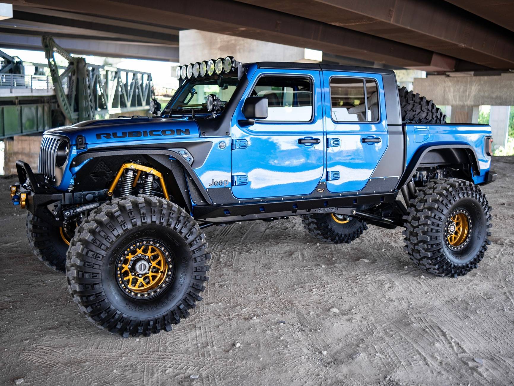

Big Blue

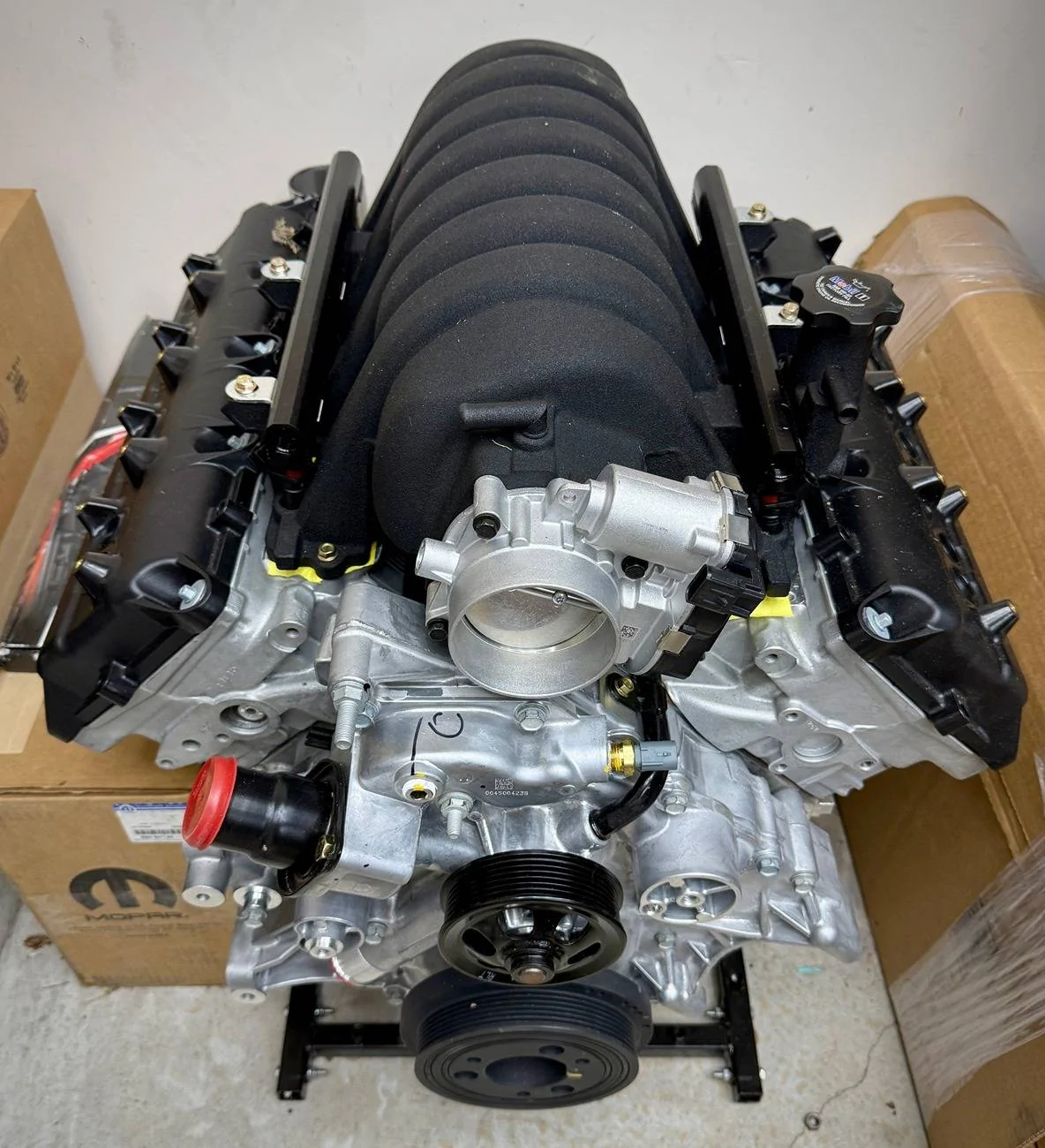

Alloy block 448 Hemi with most of a kit ready to install.
