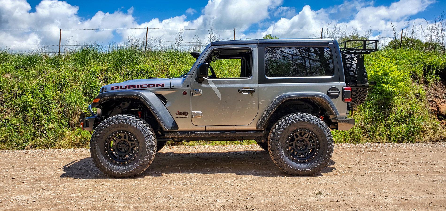

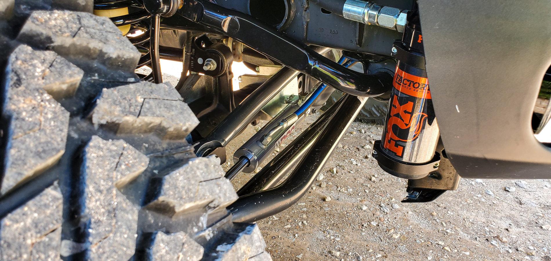

@t0mills have you had much gear loading down the cargo area while wheeling yet? How heavy do you think it'll take before sagging down? I wonder if I just got a pair of adjustable shocks like yours for the rear, I could dial in firmness for camping/towing, then soften them up again when driving around light. Or would that even affect sag, stiffer springs is what's needed. I know fug-all about these systems..
The synergy springs ride great and provide advertised lift, but they are soft which means adding weight will sag them. Pretty much any amount of weight will show up on a tape measure reading.
I've now got 3" lift springs in the rear with a spacer setup. Had it to do over again, i'd have gone with a 4" rear lift spring and no spacer. That would probably net right at 2" of rear lift on my setup to match the front lift.

Love your build man our jeeps are almost twins parts wise. I did the same exact thing as you on springs swapped my 2" rear coils for 3" + RK tall coil correction wedges(about a 1/2") and the 4" 2 door coils would be a better fit for me as well in the rear.

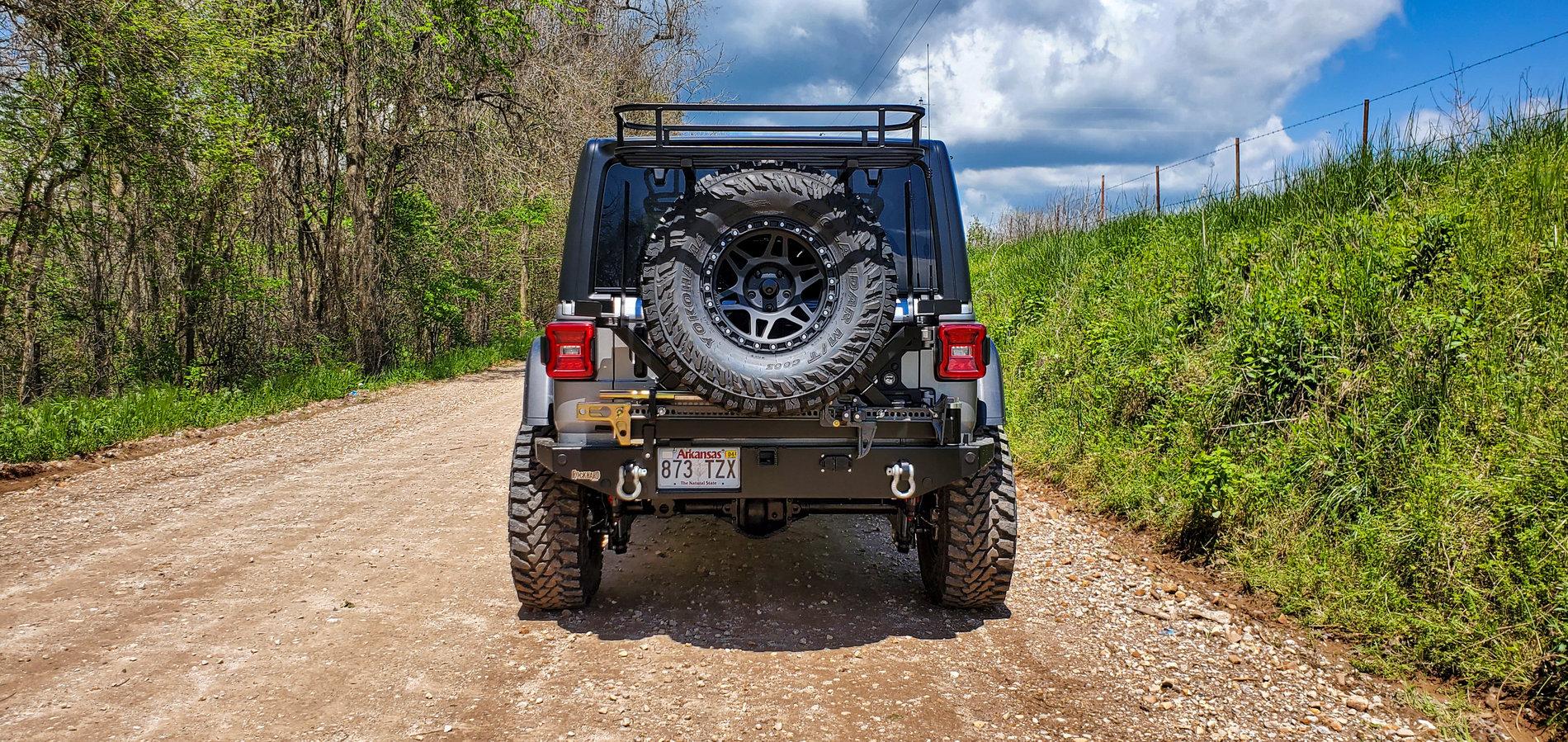

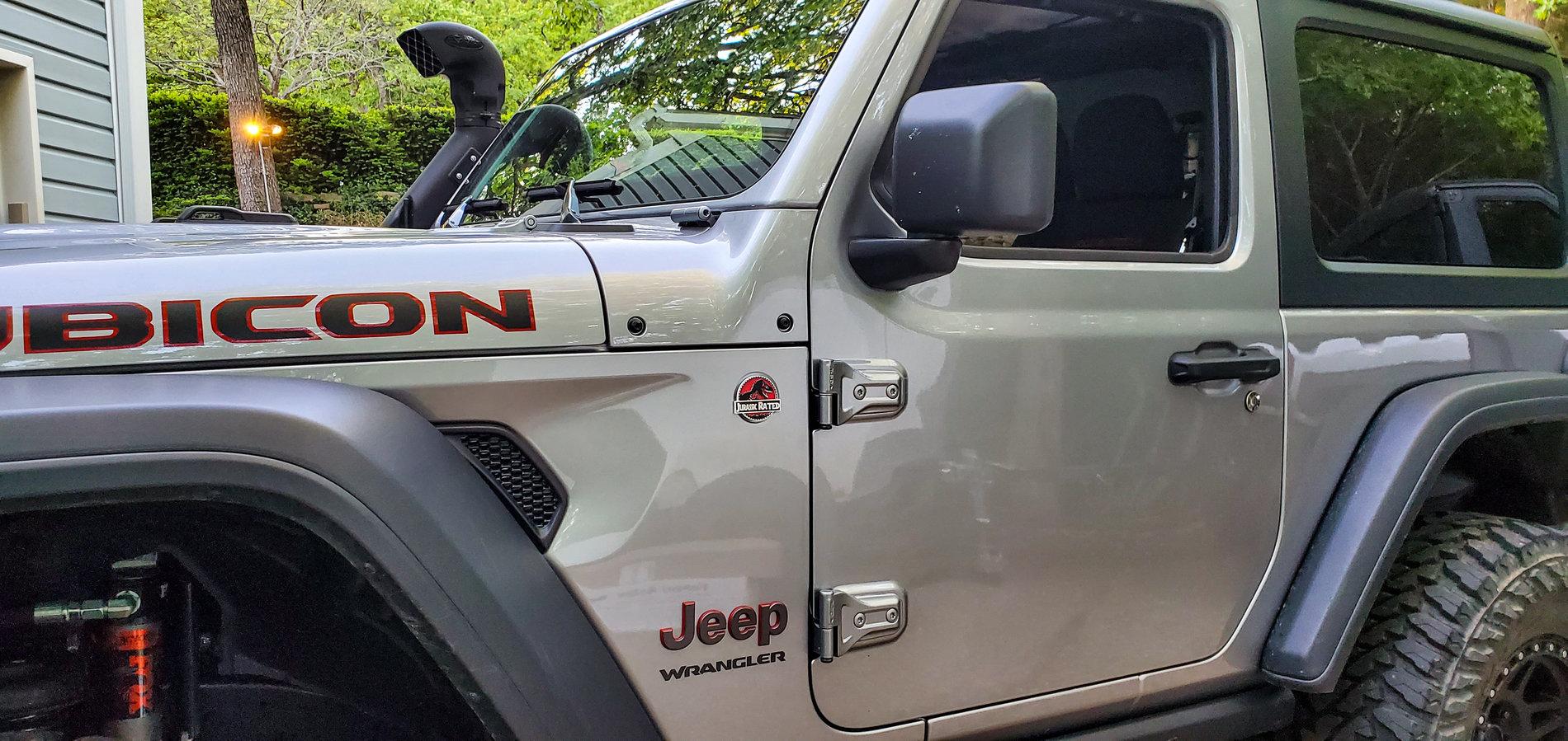

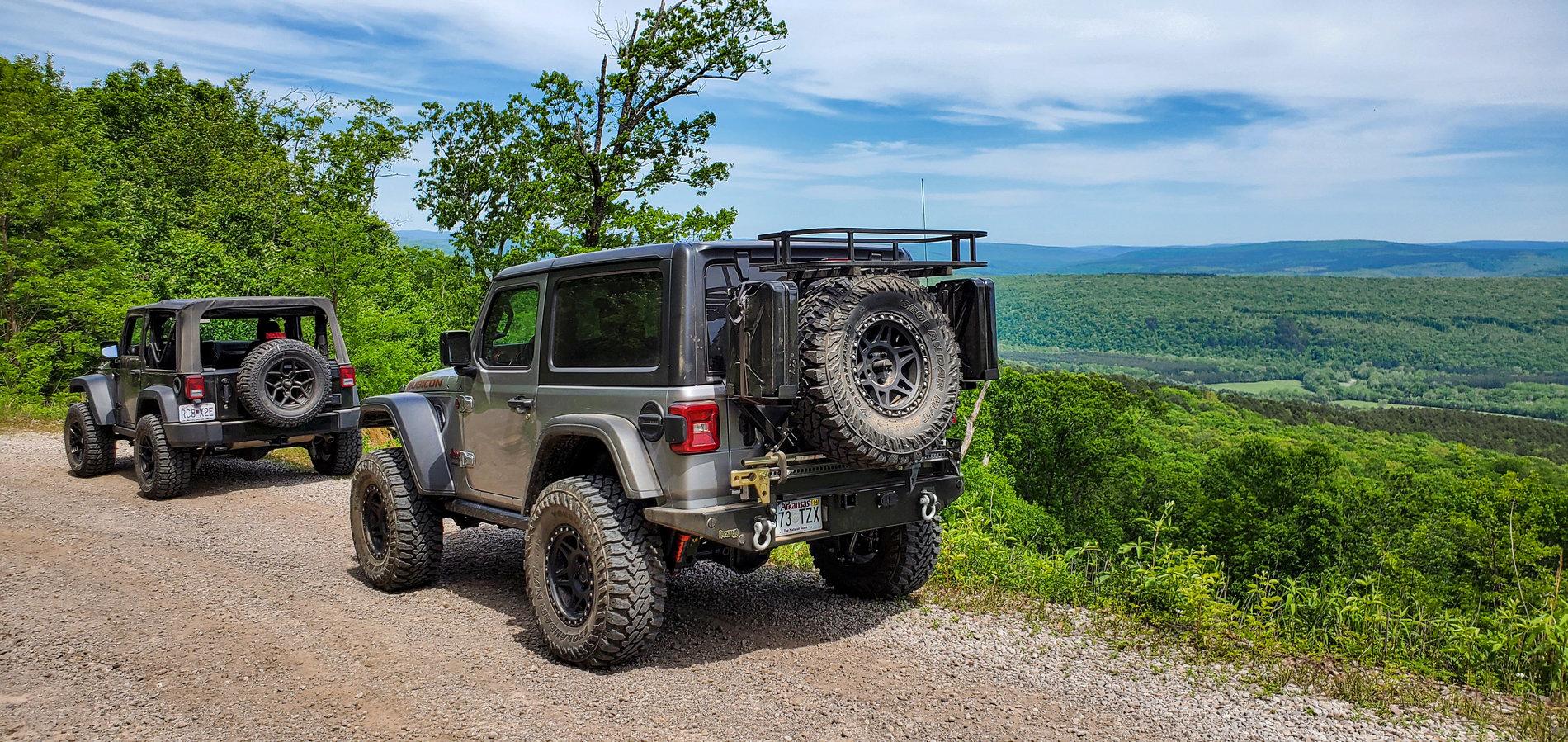

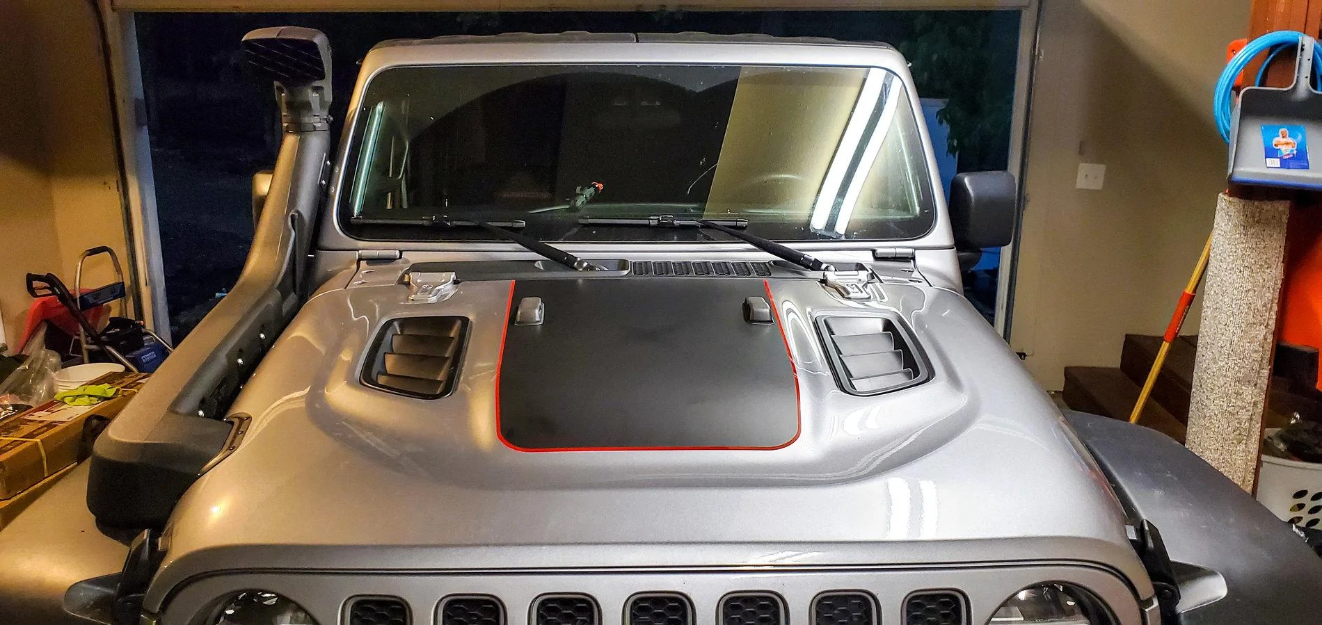

Next up was a sweet stubby antenna mod. I think this one was a 15" version. Puts it right at snorkel height.

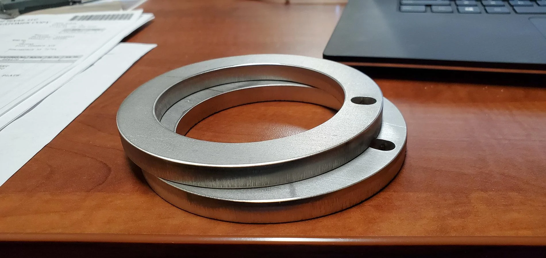

I also installed the Teraflex 1/2" load leveling rear spacers, along with a stainless shim that I cut (0.375"). I probably should have just ordered the Synergy 4" rear springs from the get-go (instead of the 3" rear springs) but it's so hard to guesstimate that stuff.
It sits level now and i'm finally happy with the ride height after installing the heavy rear bumper setup.
Have you had any issues with your 15" antenna in regards to reception? Also, what brand? Thank you!
