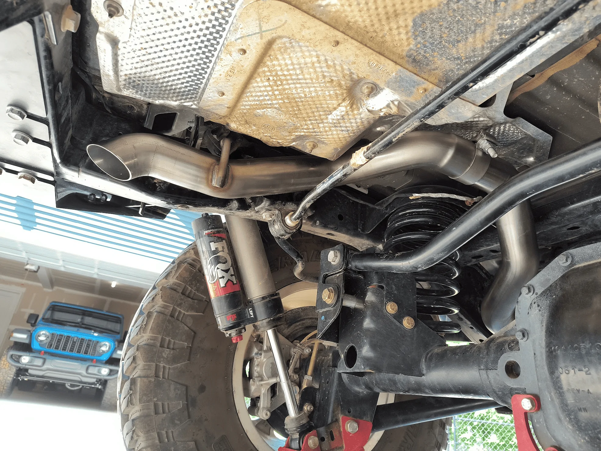

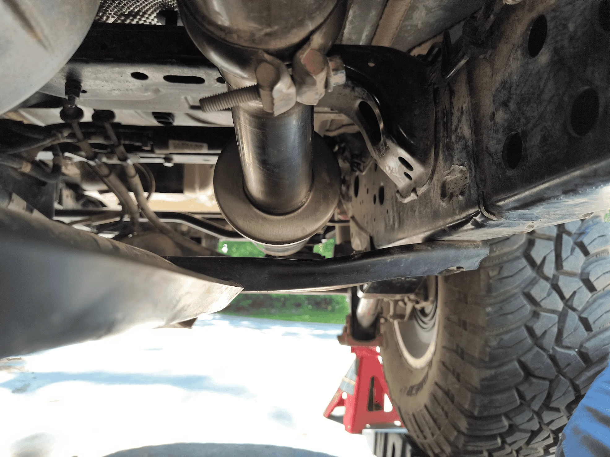

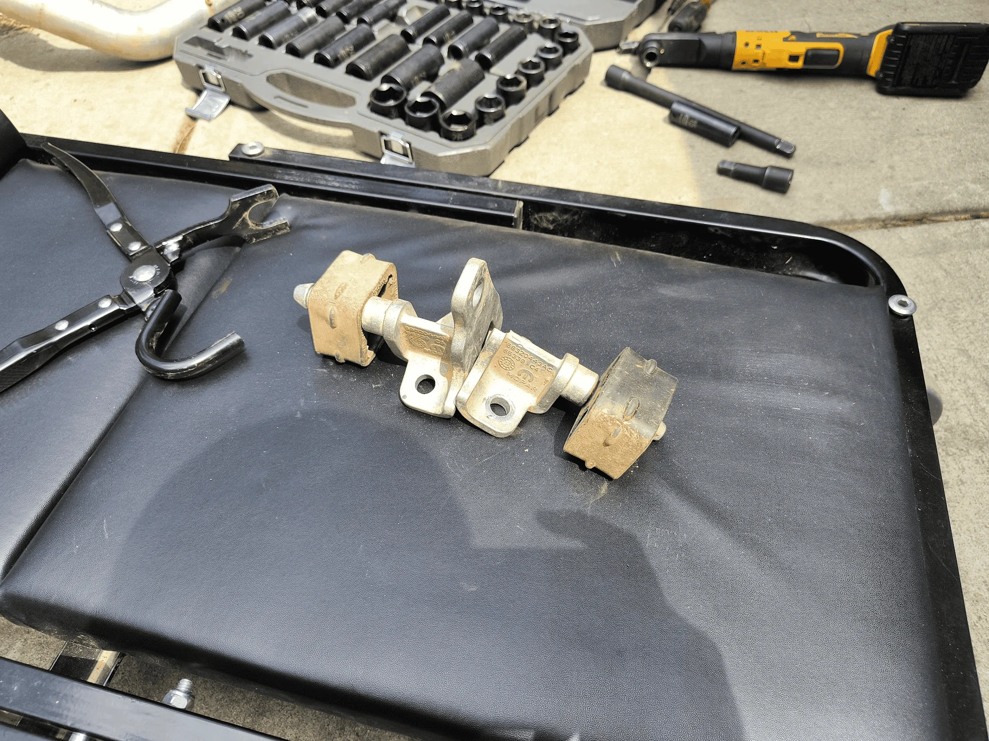

Got rid of the stock boat anchor muffler this weekend. During the process of removing the stock exhaust I discovered that I pretty well obliterated one of the cast (aluminum?) exhaust hangers, presumably when I hit the exhaust on something:
Jeep Wrangler JL '22 JLR 2.0T build progress/wheeling thread 1715633434727-o
Jeep Wrangler JL '22 JLR 2.0T build progress/wheeling thread 1715633460319-gd
New exhaust tucks up nice and tight:
Jeep Wrangler JL '22 JLR 2.0T build progress/wheeling thread 1715633592252-7f
Jeep Wrangler JL '22 JLR 2.0T build progress/wheeling thread 1715633623923-r0
Jeep Wrangler JL '22 JLR 2.0T build progress/wheeling thread 1715633645203-91
I didn't get this exhaust for its sound - purely for the clearance - but I know there's precious little information out there on the Magnaflow Rock Crawler on the 2.0T, so for those curious how it sounds:
Jeep Wrangler JL '22 JLR 2.0T build progress/wheeling thread {filename}

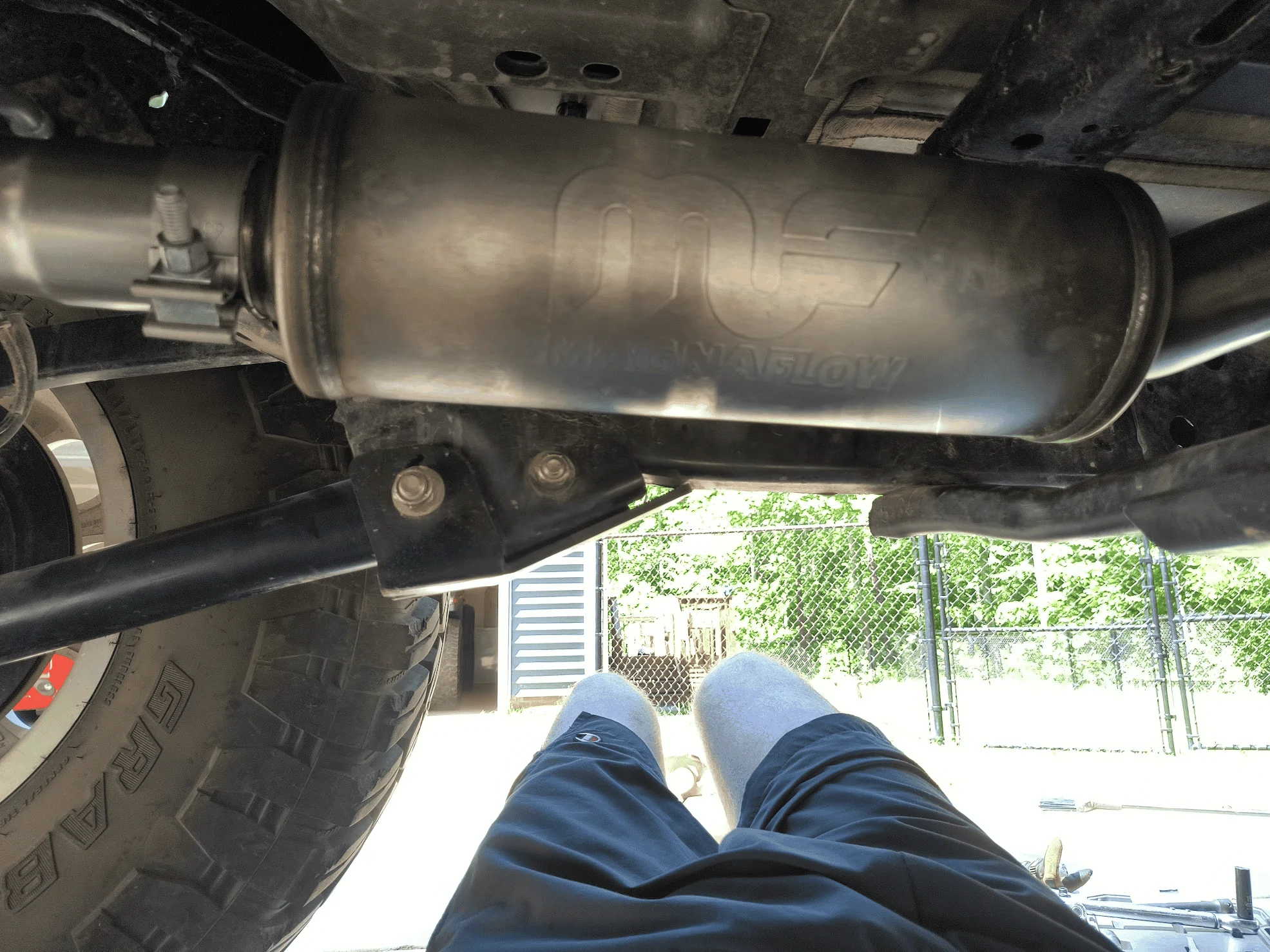

@Remorseless Which transfer case do you have? I was looking at the Borla climber exhaust a while back but they say it won't clear the full-time transfer case.
Have any pics of the distance between the muffler and the t-case?
I'm also curious to hear how you like the exhaust after some highway miles. I think it's safe to say most of us didn't buy the 2.0T for the exhaust note...
Edit: I have the regular part-time transfer case.
I'll see if I can grab some pics this week. Drove some on the highway yesterday though, still in safari mode with doors off, and it was a little droney in 6th, but quieted down in 7th and 8th. It's definitely not something I'd do for an enjoyable exhaust note lol, but that's just a factor of the 2.0 being a 4 cyl. Will have to see how it is with doors and top put together though, looking like we may be wheeling in the rain this weekend so I might be forced to put the Jeep back together.

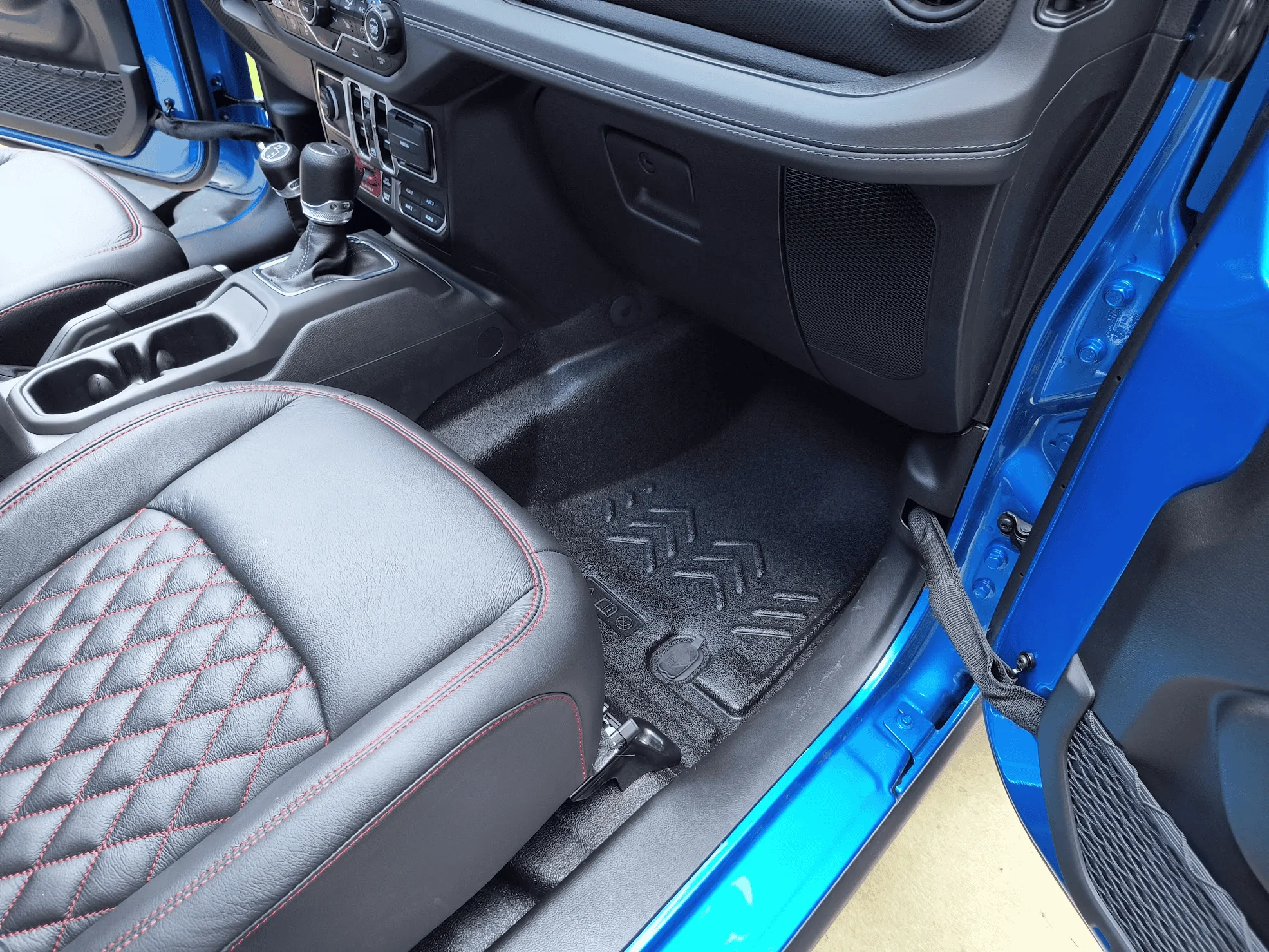

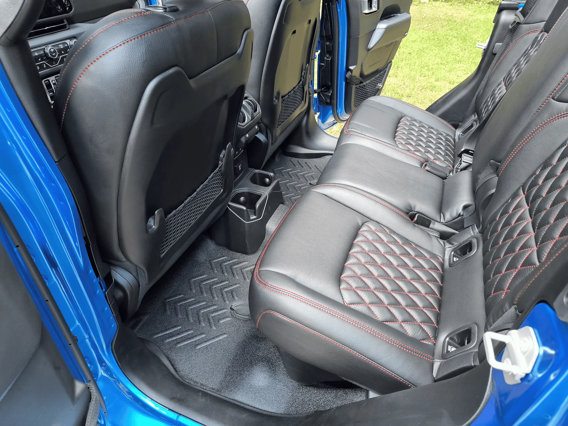

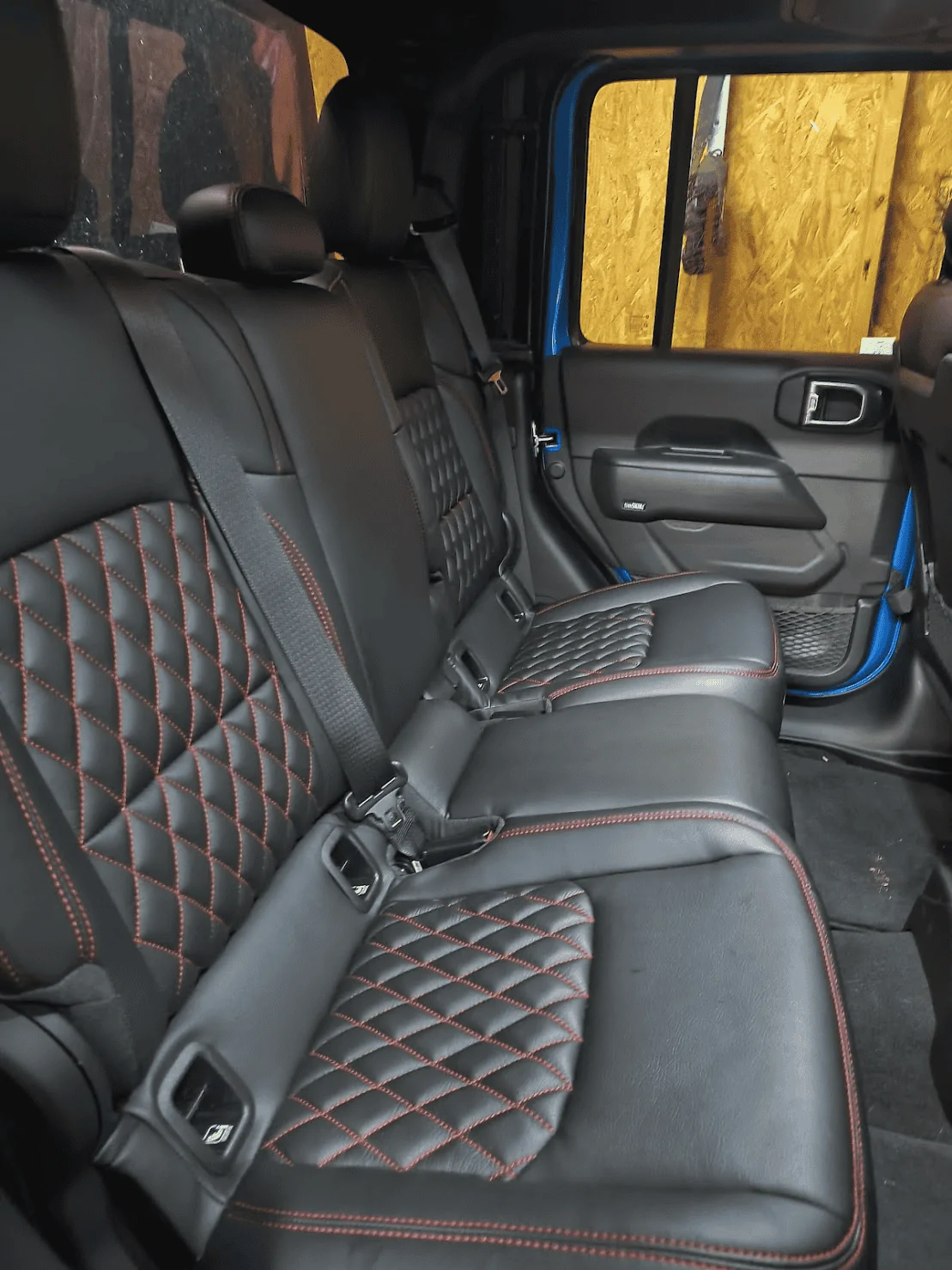

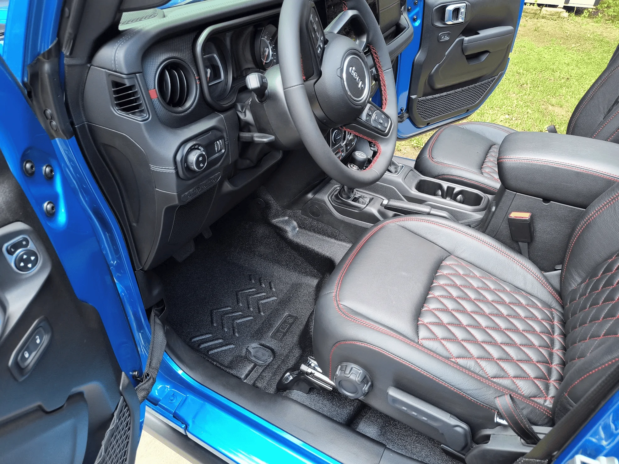

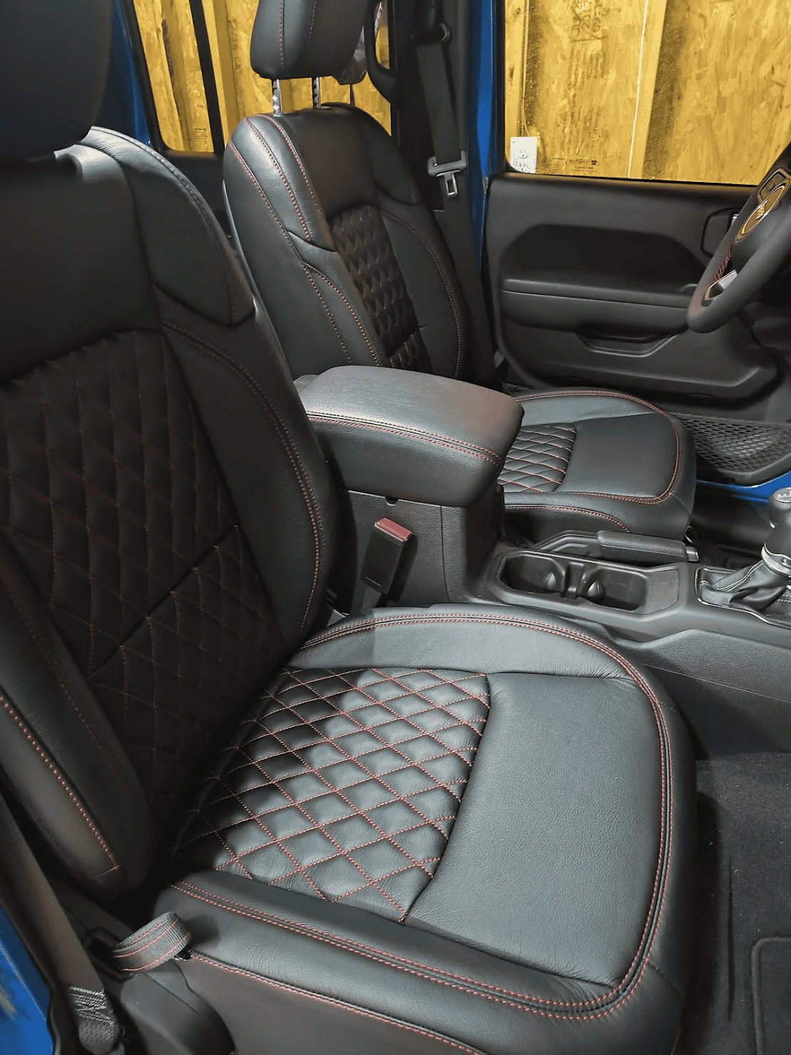

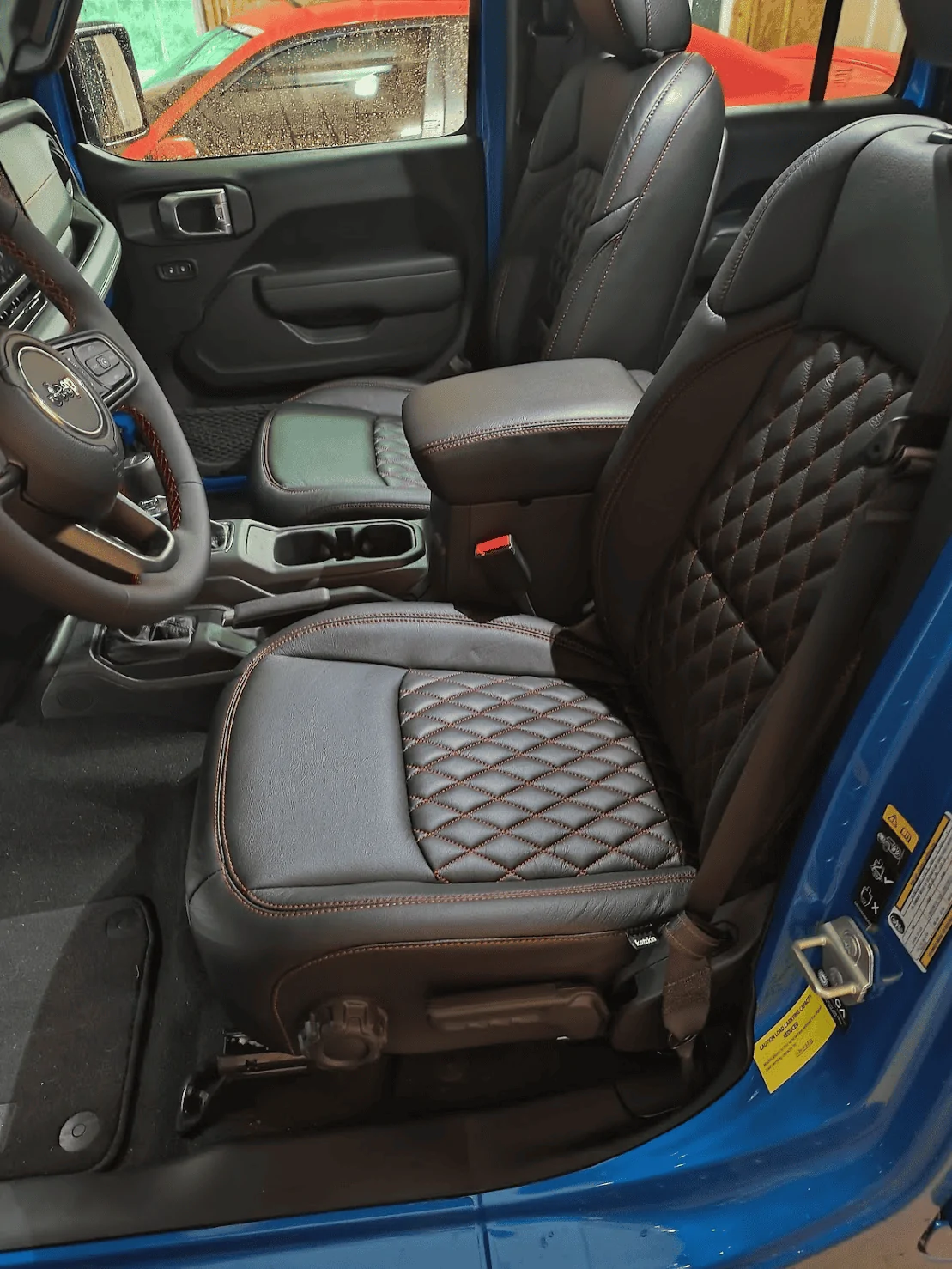

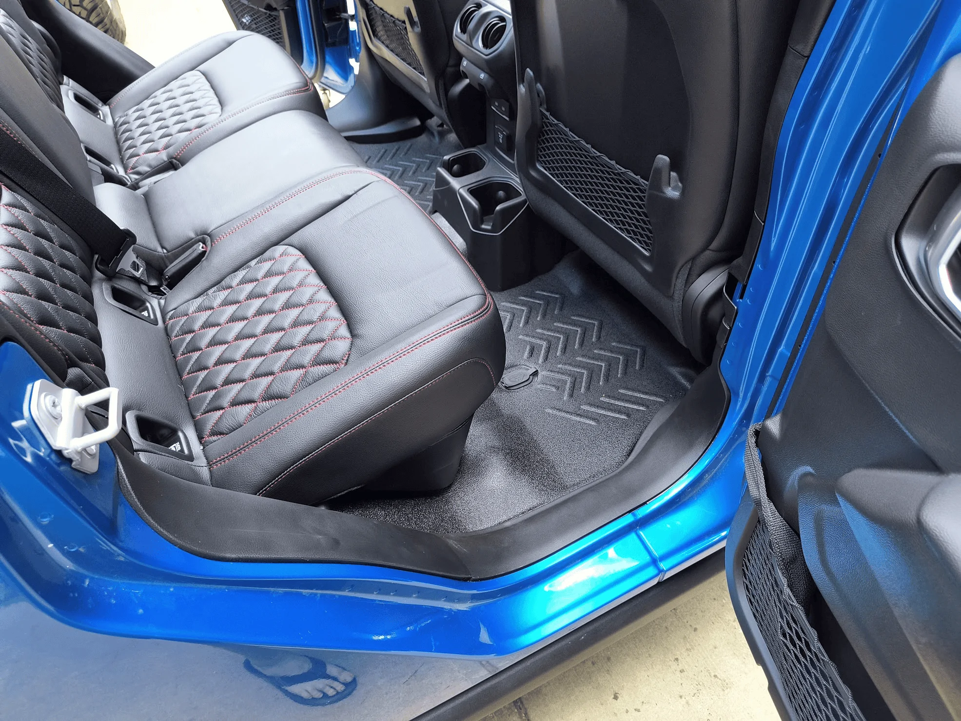

Had an upholstery shop install Katzkin in the truck, came out great I think:
Jeep Wrangler JL '22 JLR 2.0T build progress/wheeling thread 1717532145435-2l
Jeep Wrangler JL '22 JLR 2.0T build progress/wheeling thread 1717532200201-yi
Jeep Wrangler JL '22 JLR 2.0T build progress/wheeling thread 1717532247687-7k
Wife wanted a little more butt cushion, which the quilting does (surprisingly) help, and I wanted something that wouldn't absorb sticky kiddo messes as well as the cloth seats, so this ought to fit the bill.

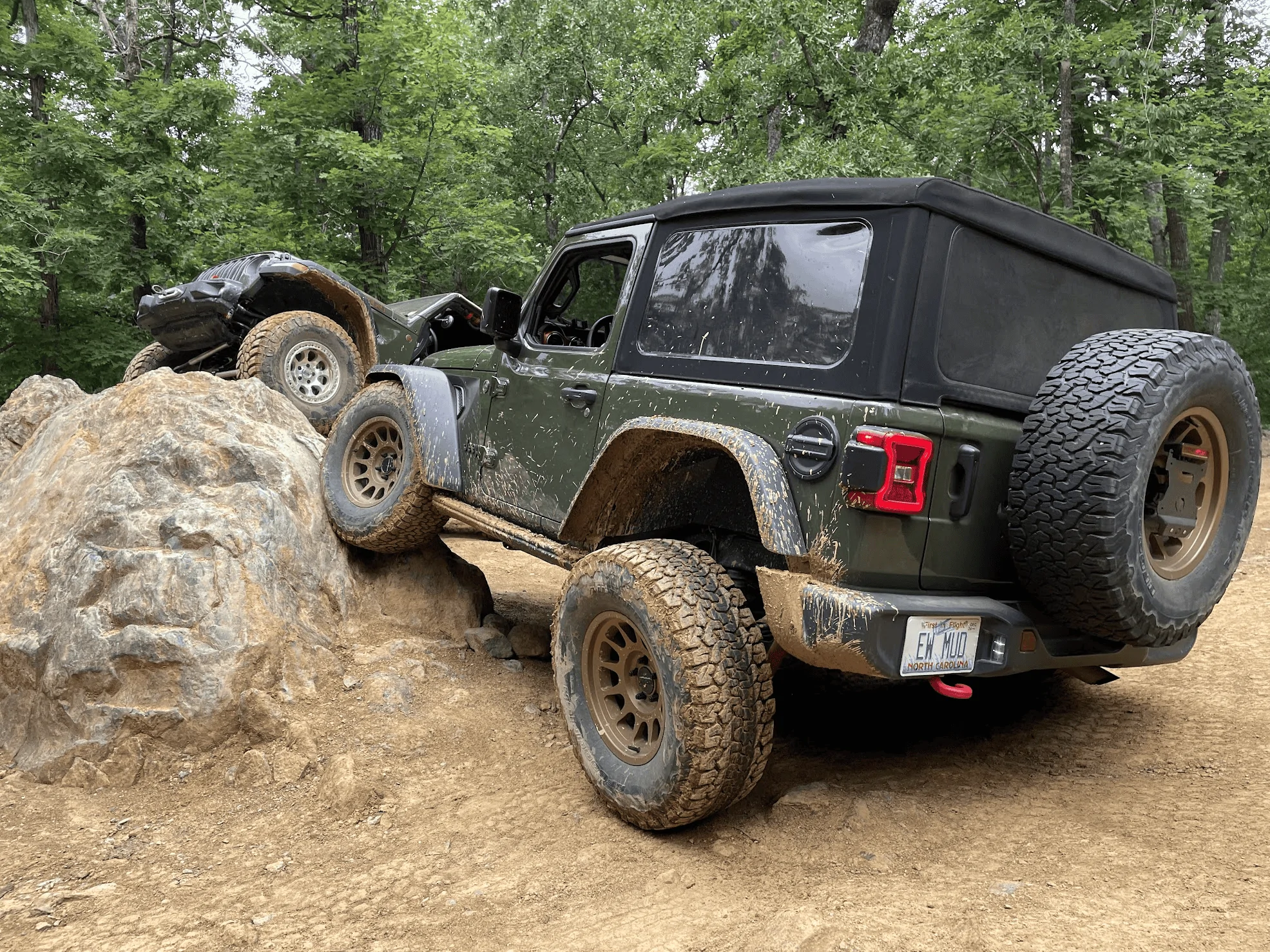

Next, got a wheeling day in mid-May with @Sean L and @yokramer , was a good time.
Jeep Wrangler JL '22 JLR 2.0T build progress/wheeling thread 1717532739187-jn
Jeep Wrangler JL '22 JLR 2.0T build progress/wheeling thread 1717532817016-
Jeep Wrangler JL '22 JLR 2.0T build progress/wheeling thread 1717532859936-05

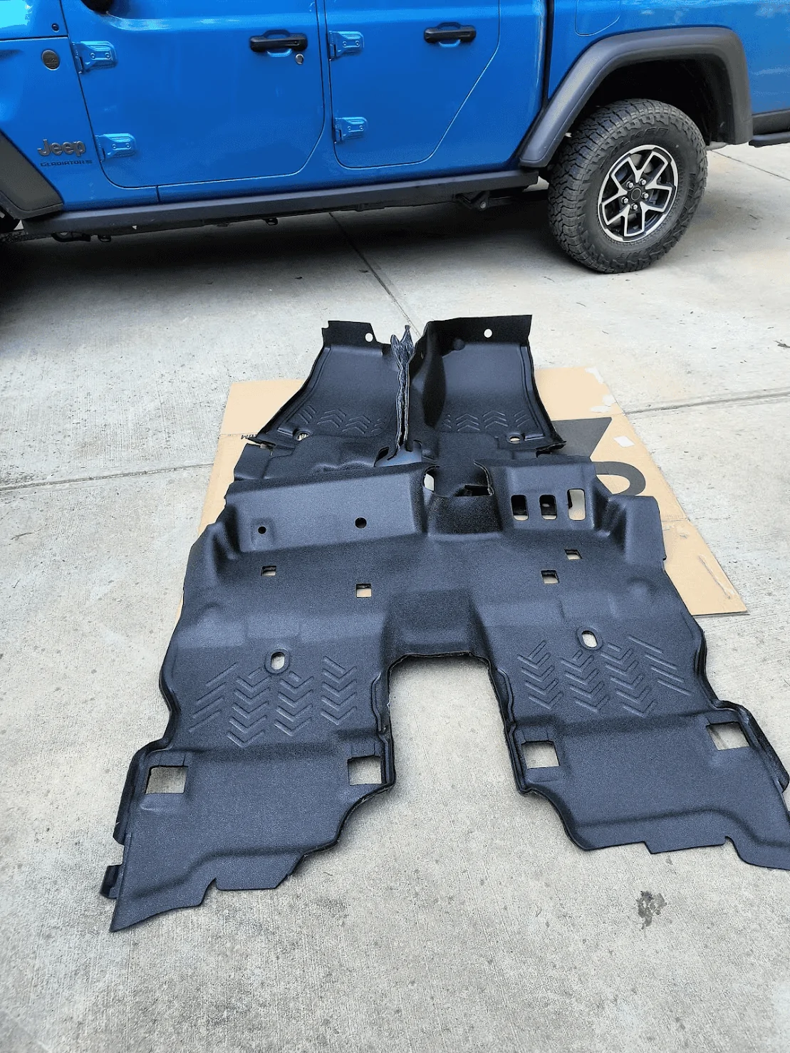

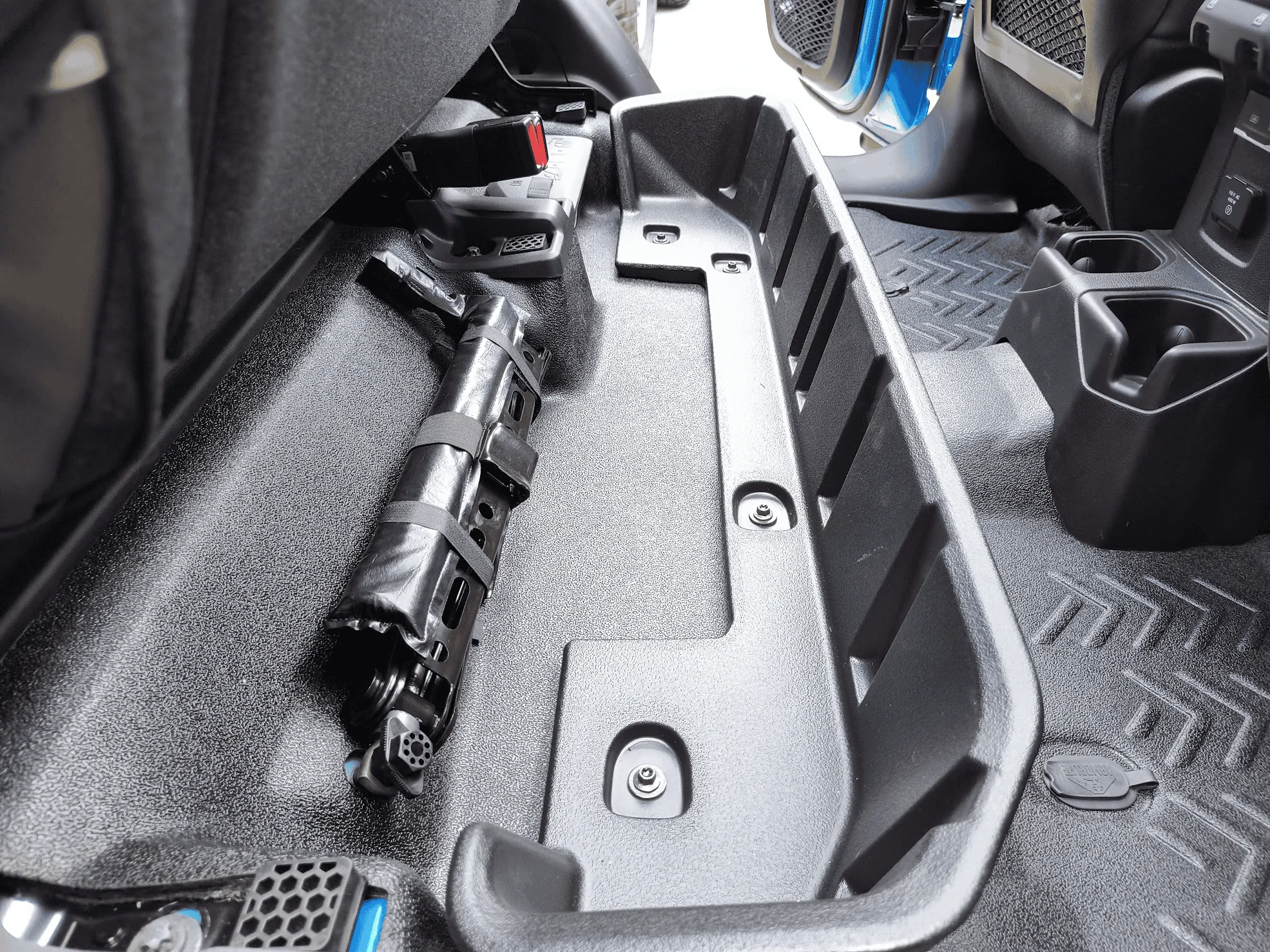

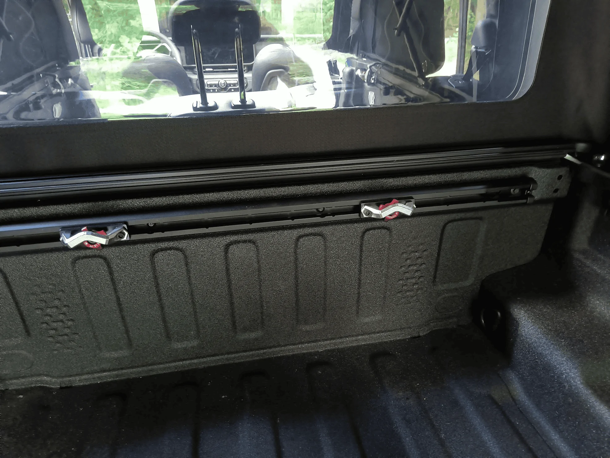

Next project was getting Armorlite installed in the truck. Left the seats in the truck this time, did not hinder install. Came out great.
Jeep Wrangler JL '22 JLR 2.0T build progress/wheeling thread 1717533100459-5h
Jeep Wrangler JL '22 JLR 2.0T build progress/wheeling thread 1717533160958-eq
Jeep Wrangler JL '22 JLR 2.0T build progress/wheeling thread 1717533183810-l0
Jeep Wrangler JL '22 JLR 2.0T build progress/wheeling thread 1717533209790-q
Jeep Wrangler JL '22 JLR 2.0T build progress/wheeling thread 1717533228939-b2
Jeep Wrangler JL '22 JLR 2.0T build progress/wheeling thread 1717533265351-su

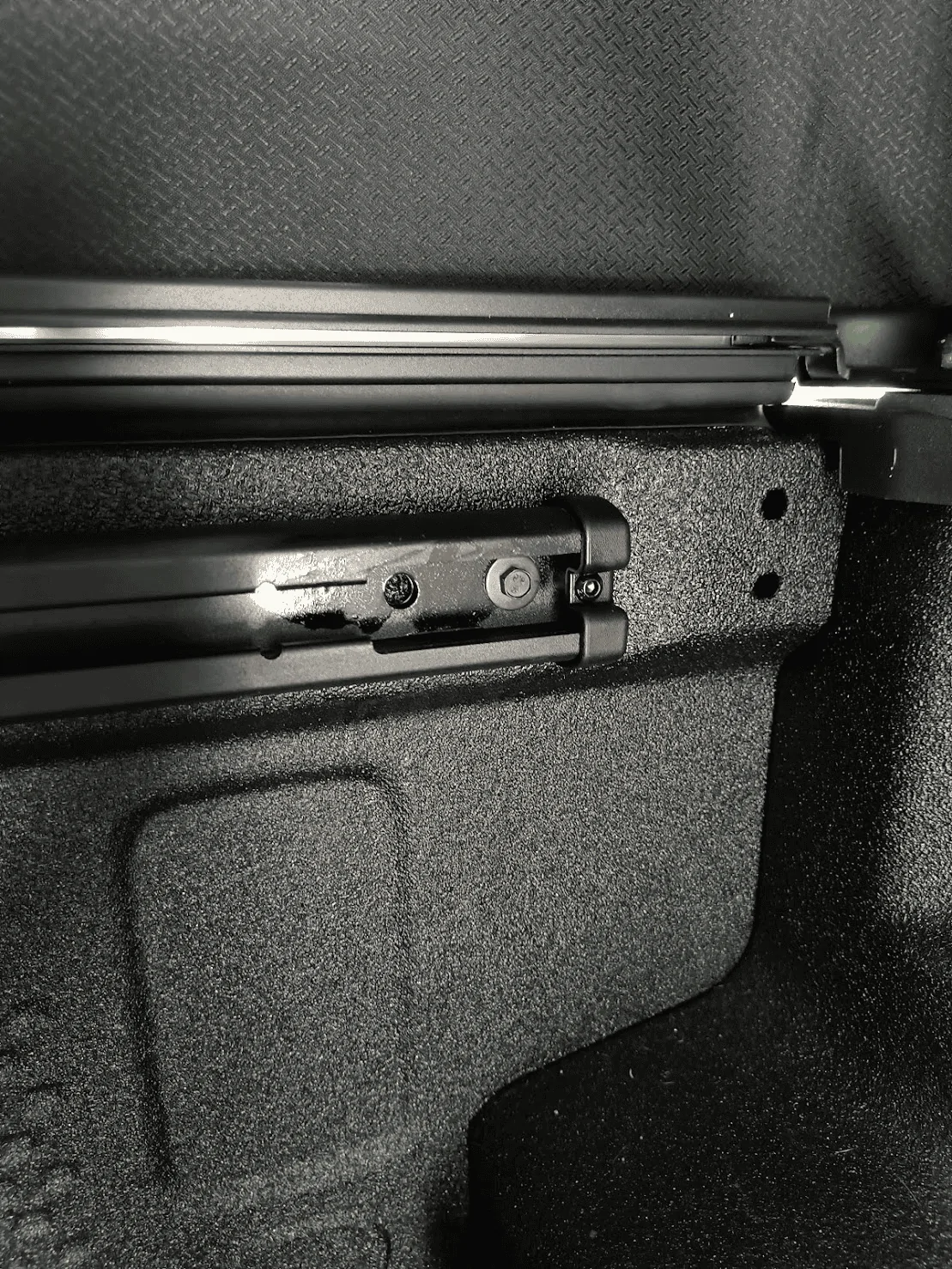

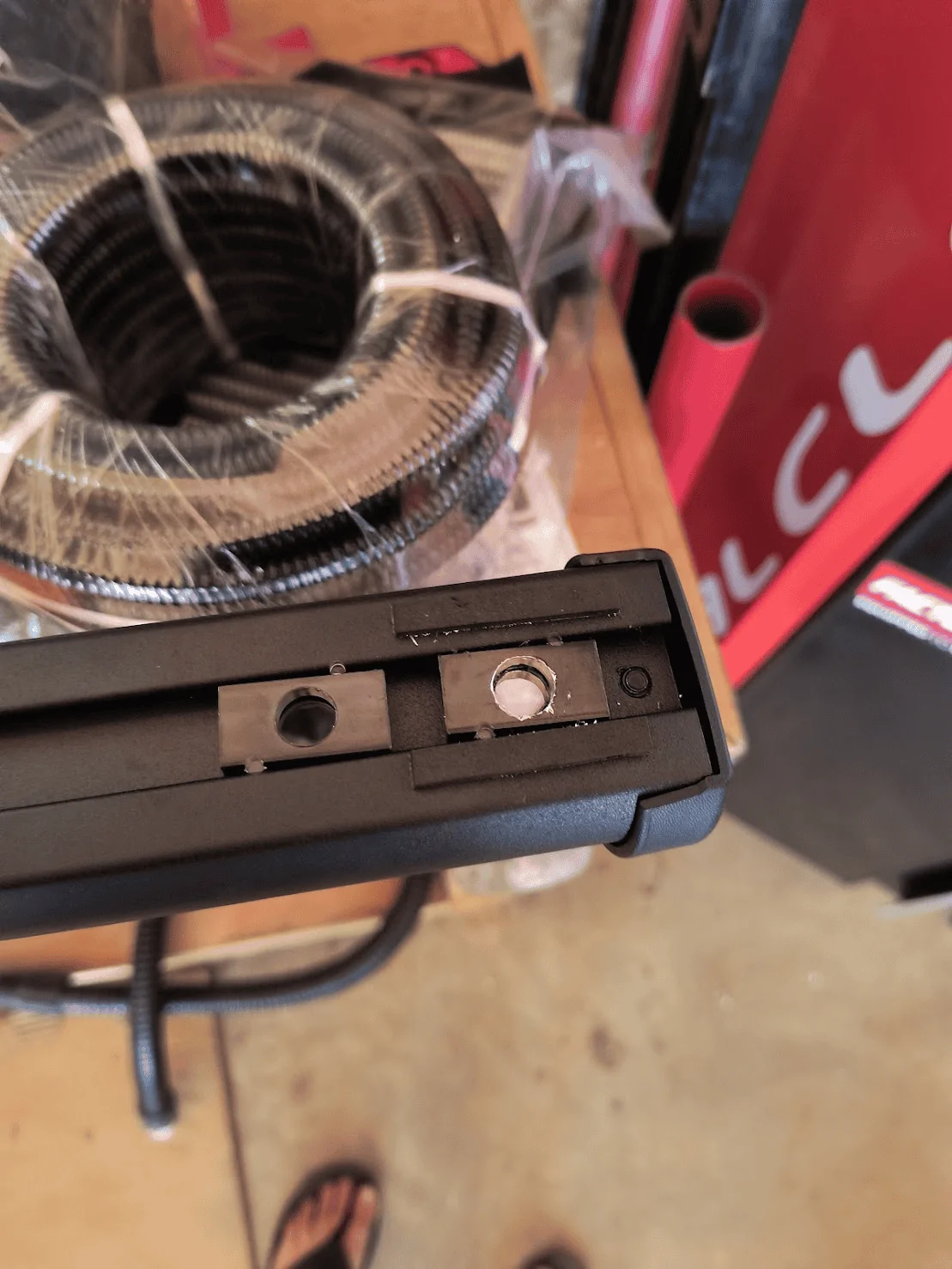

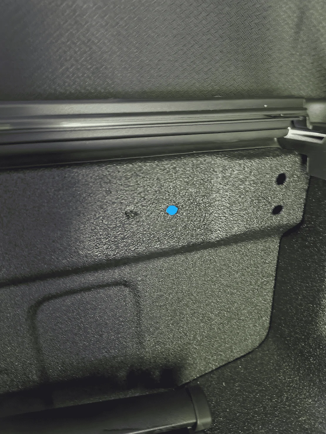

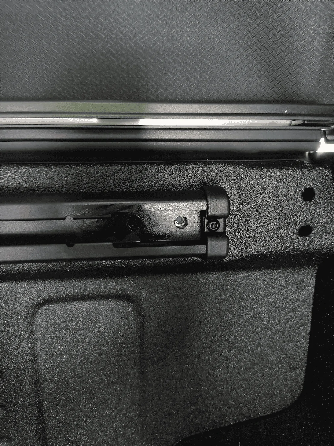

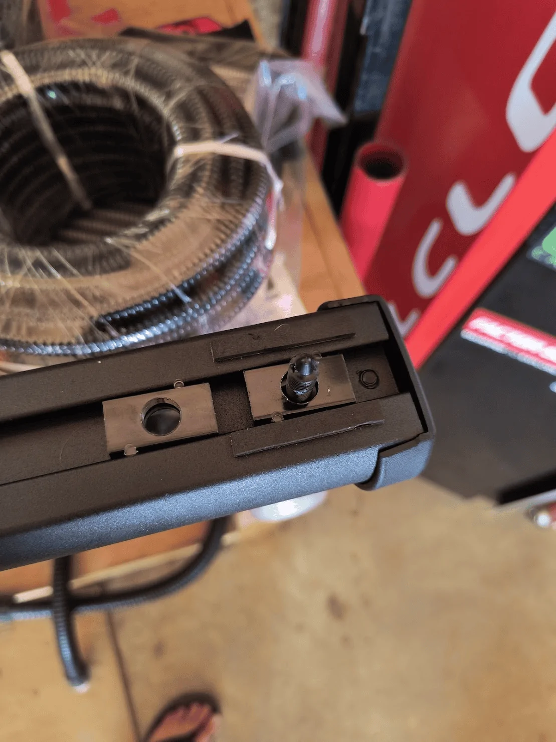

Next project was unfucking my goof with the broken bolt in the truck. On the back of the aluminum bars are plastic Christmas trees for aligning everything, with one right next to the spacer where the broken bolt is:
Jeep Wrangler JL '22 JLR 2.0T build progress/wheeling thread 1717533461293-4i
So, drilled it out:
Jeep Wrangler JL '22 JLR 2.0T build progress/wheeling thread 1717533512657-kz

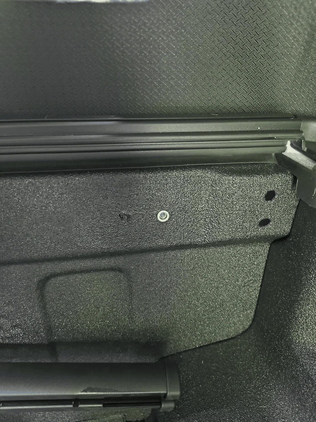

And lightly opened up the hole on the bed:
Jeep Wrangler JL '22 JLR 2.0T build progress/wheeling thread 1717533545423-h7
Insert rivnut (I'm not 100% happy with how the rivnut squished, but I can't get it to squish more without ripping the mandrel for my rivnut tool through the threads, it's got about half engagement but holds torque and doesn't move, so rolling with it for now):
Jeep Wrangler JL '22 JLR 2.0T build progress/wheeling thread 1717533589917-e6
Line up and bolt in:
Jeep Wrangler JL '22 JLR 2.0T build progress/wheeling thread 1717533633697-bd
Jeep Wrangler JL '22 JLR 2.0T build progress/wheeling thread 1717533653685-o
Jeep Wrangler JL '22 JLR 2.0T build progress/wheeling thread 1717533671212-x0

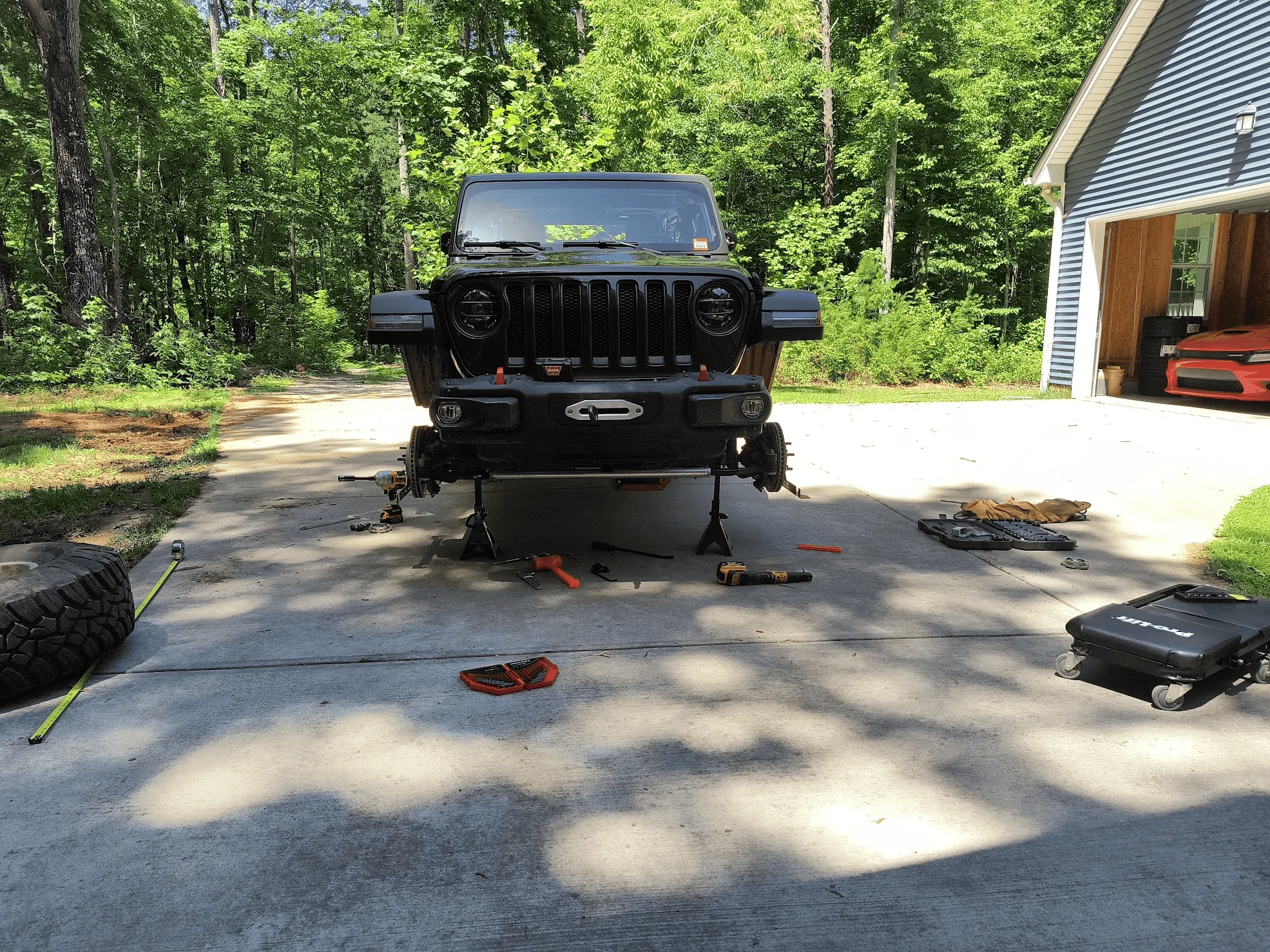

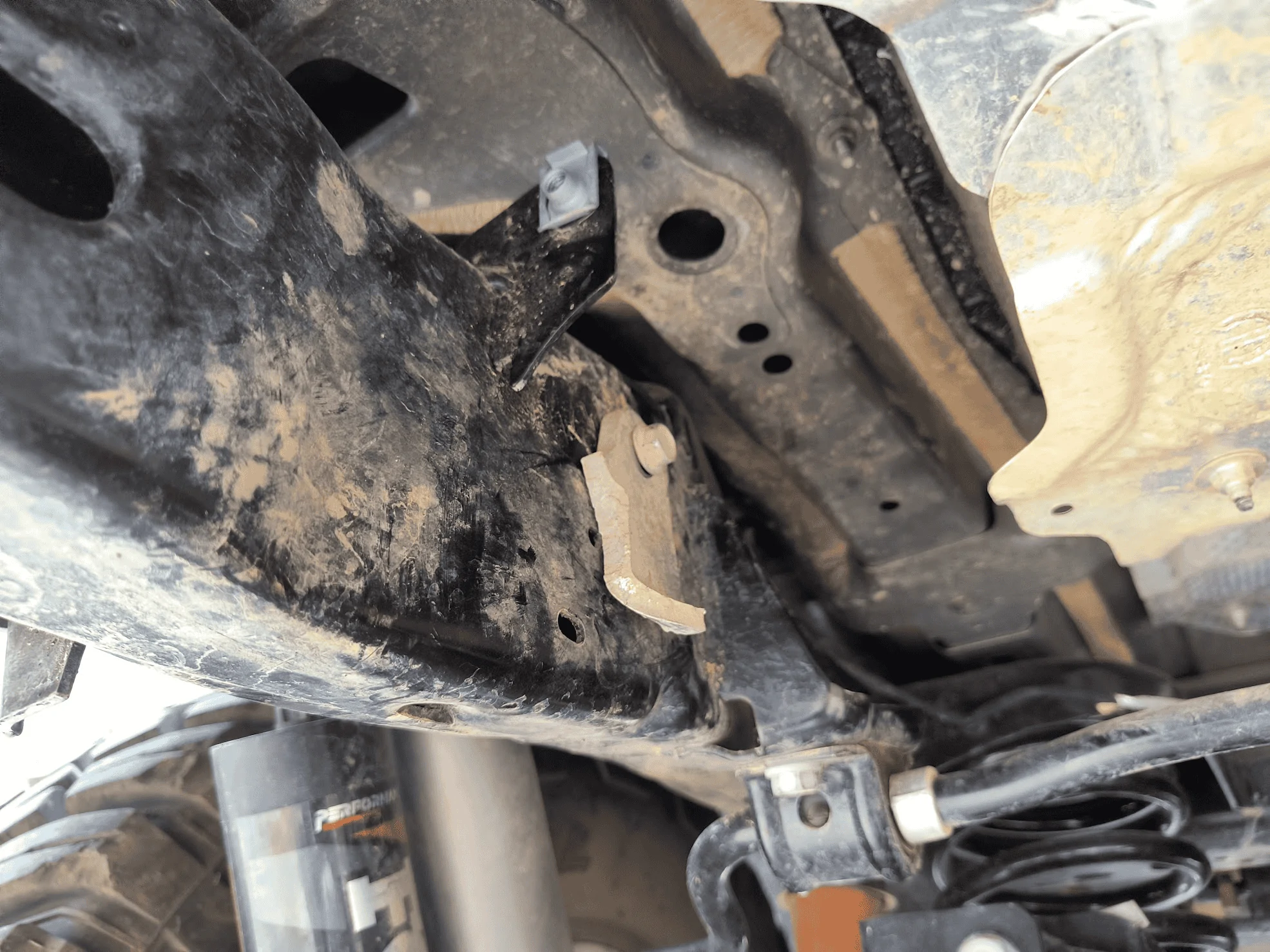

Fixed the alignment on the Jeep this past weekend. When the jam nut came loose (I think when I beached the steering on a rock), it did back the tie rod off a bit. Was at 1/2"-5/8" toe out. Readjusted to 1/8" toe out and all is good.
Jeep Wrangler JL '22 JLR 2.0T build progress/wheeling thread 1718026506053-qs
Not sure if it was caused by the tie rod rotating or not, but did find that the steering stabilizer made contact with the trackbar and the drag link - not horribly hard, thankfully, but did leave witness marks in the stickers on each. Got the stabilizer readjusted and placed back in a good spot as far as I can flex it out and test.
The jam nuts coming loose was a concern. I hit them with the breaker bar a bit harder this time, hopefully next encounter with a rock they'll hold. For the JT I'm planning on going with the Steer Smarts kit instead of the Artec because of the pinch bolt system they use. It's gonna cause some clearance issues, but ought to be more survivable in terms of not suddenly coming loose.
