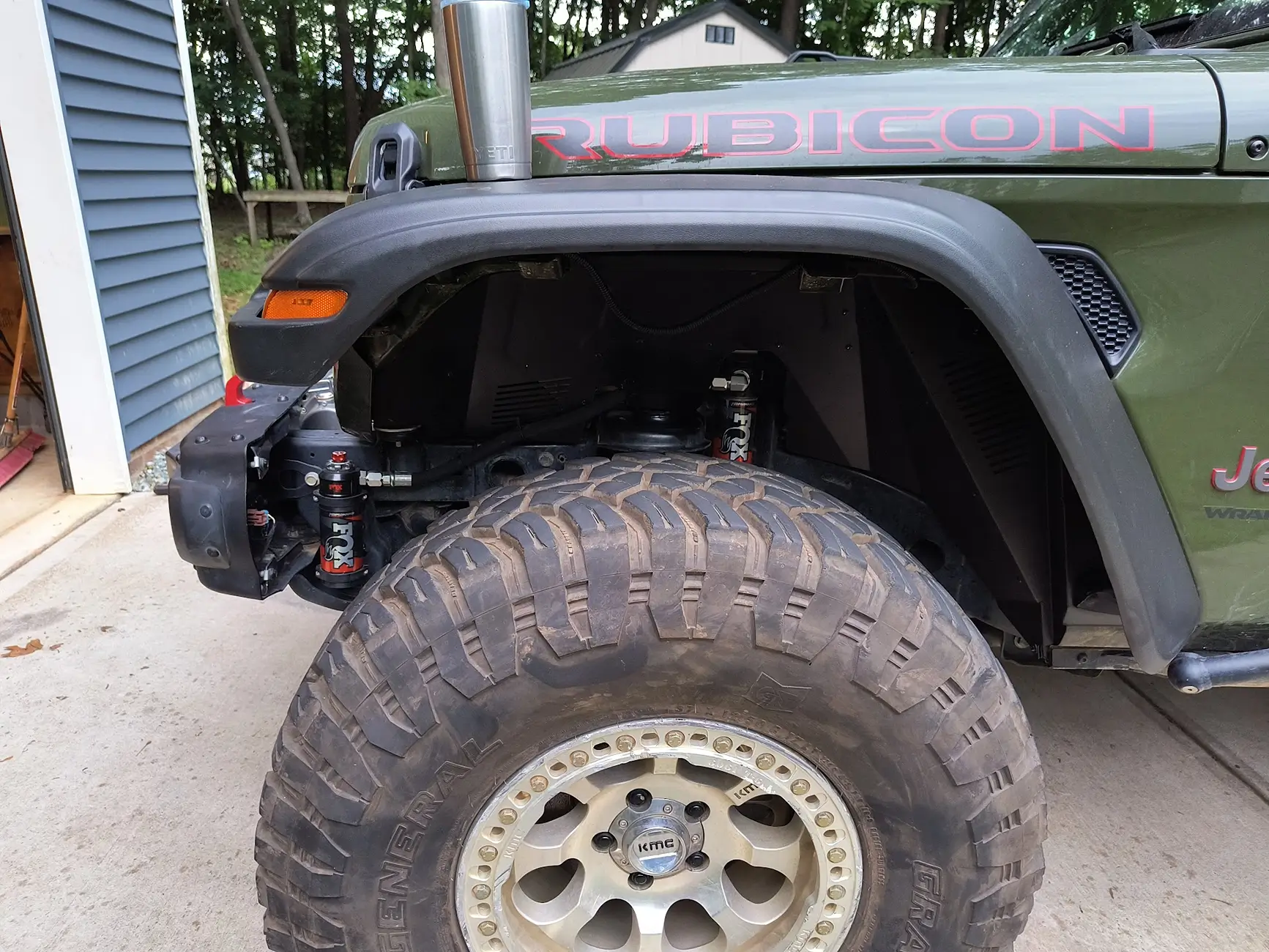

Had a good wheeling trip on Saturday with @Sean L and @yokramer. We ran Daniel > Rocky Mountain Loop > Slab Pile > Dutch John. Super, super impressed we managed to get Sean's JLU Sahara sitting on stock Rubicon suspension and wheels through Daniel. It's our toughest trail at Uwharrie, and while some of the harder spots have bypasses he availed himself of, the v-notch on Daniel is unskippable and pretty sketchy for a stock Jeep. His run through here is below:

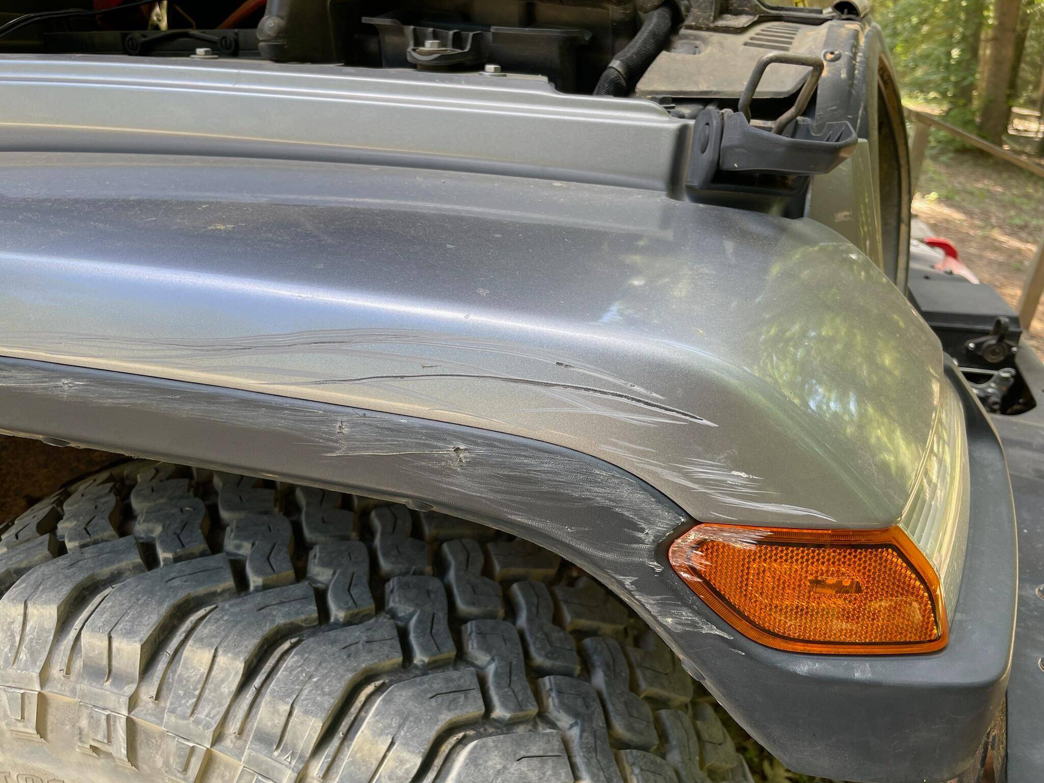

Just little love on the fender to show for it:
Jeep Wrangler JL '22 JLR 2.0T build progress/wheeling thread 1719322128597-vo
The below cover my run up Daniel:

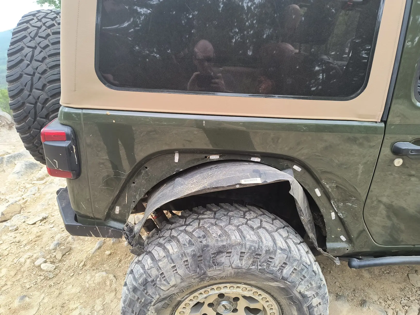

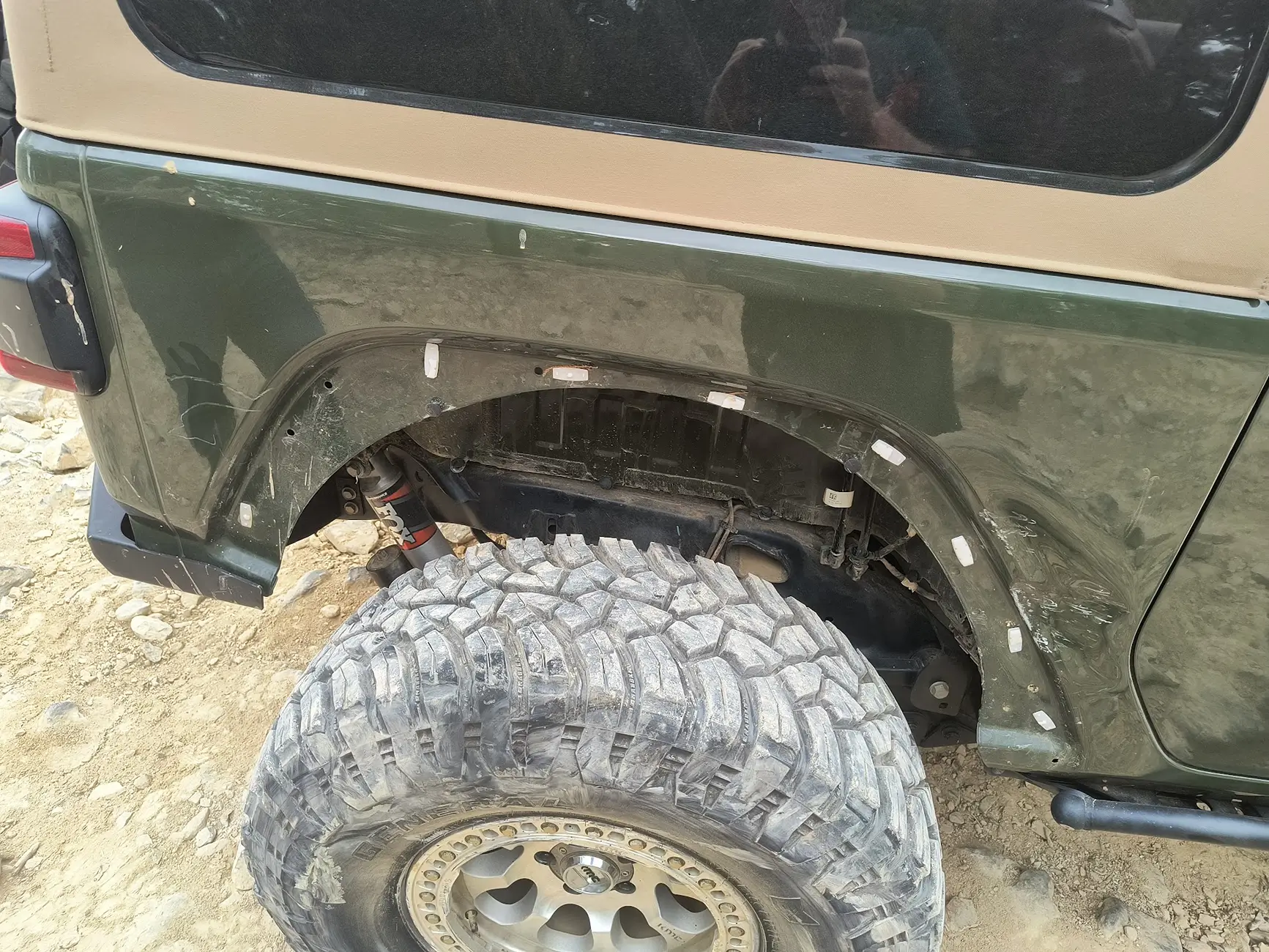

And my damage:
Jeep Wrangler JL '22 JLR 2.0T build progress/wheeling thread 1719322232185-uq
Missed the body thankfully, but the flare's gonna take some TLC to get the inner and outer flares back together right. Clips on order.

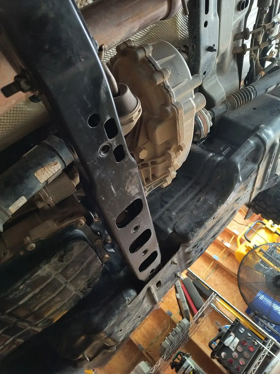

Man, been a hot minute since I updated this. Well let's dig back into the time machine and get this caught up...

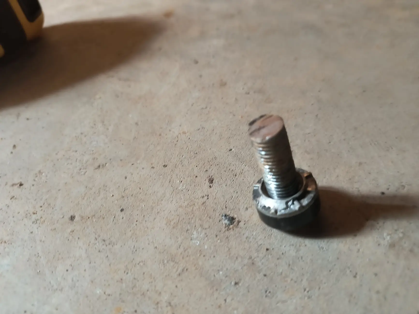

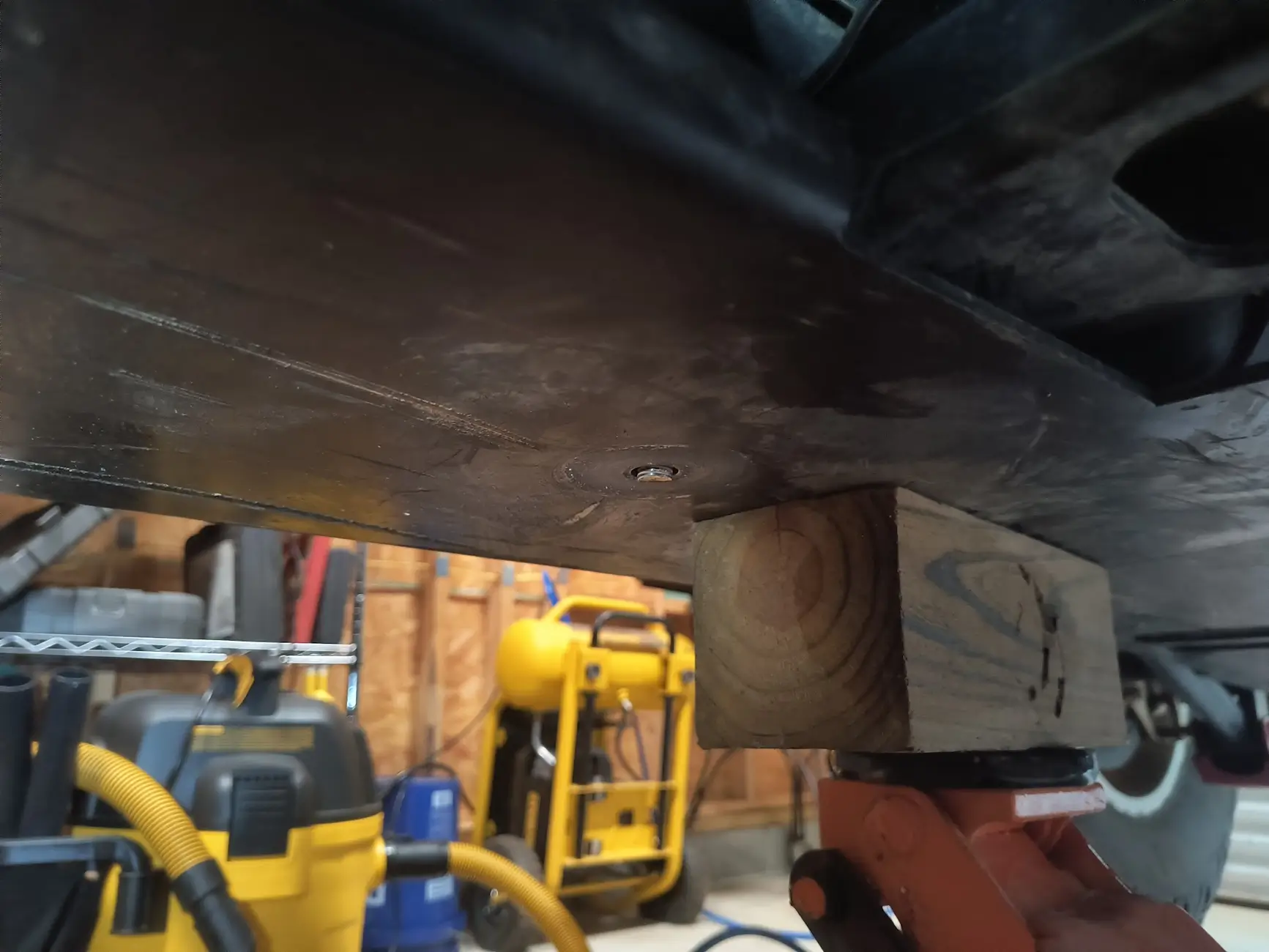

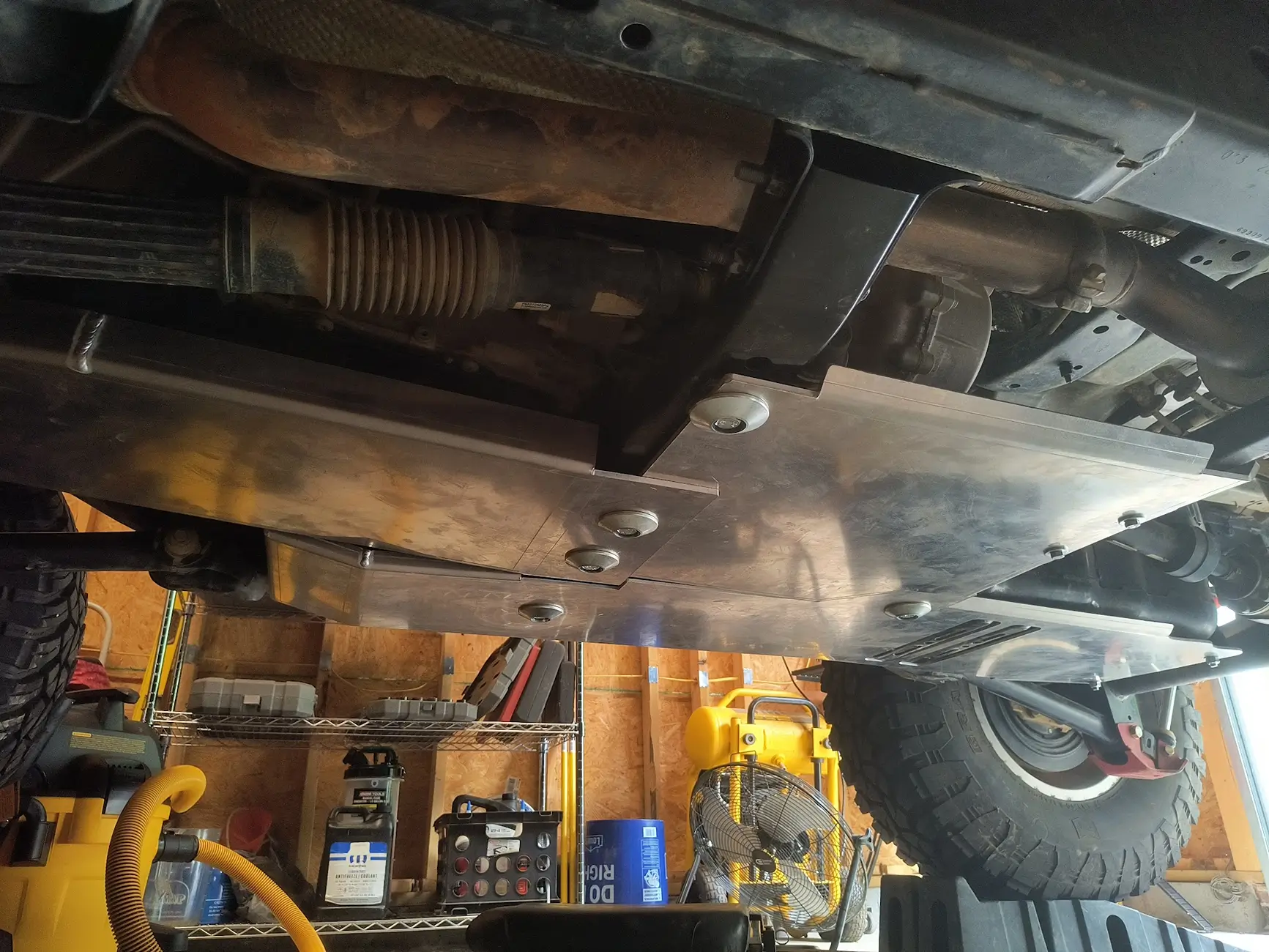

After I got the flares from that incident sorted last June, in July '24 I ended up moving from steel skids to aluminum skids (nothing special, the MORE 5052 aluminum version of the same skids) and had to swap trans crossmembers due to a weld nut in the crossmember that broke off. What a fun project that was.
Weld nut just didn't have much weld penetration I guess:
Jeep Wrangler JL '22 JLR 2.0T build progress/wheeling thread 1758310513896-kg

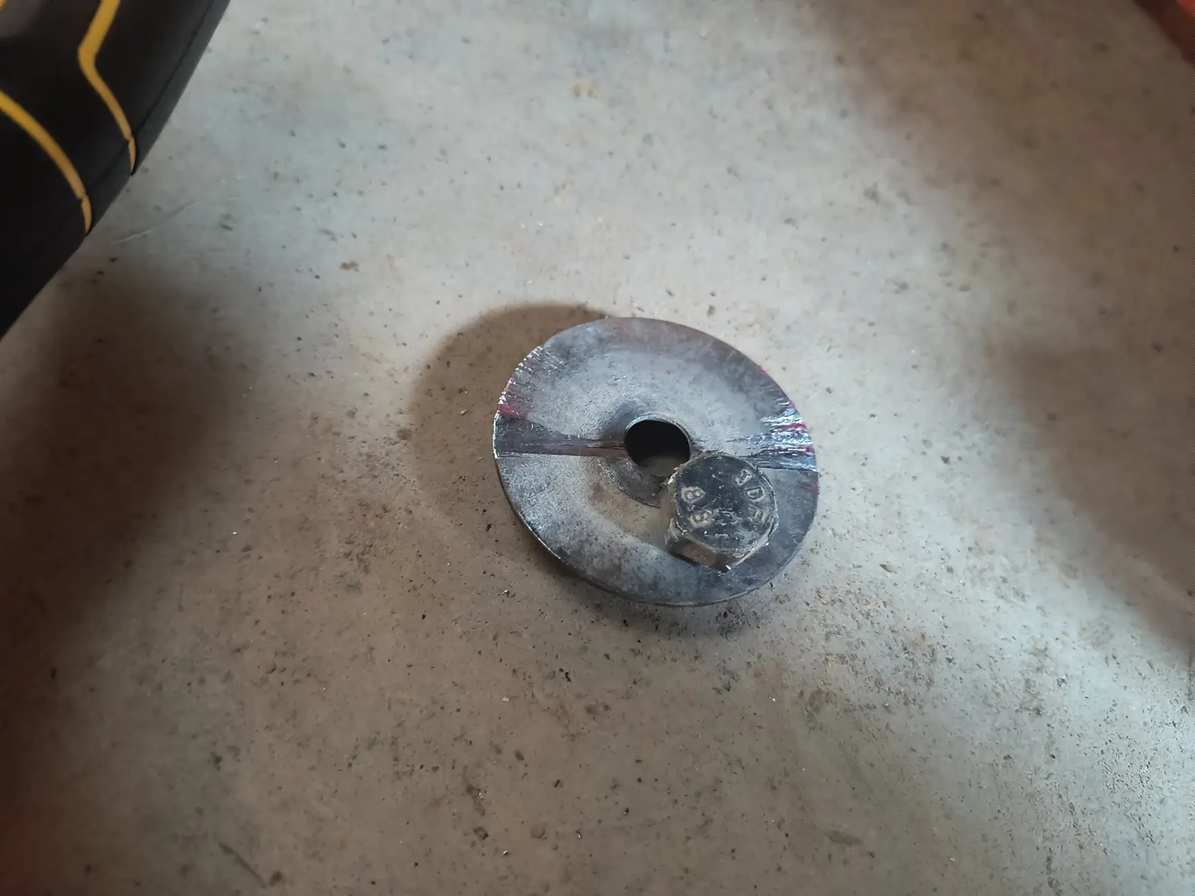

Had to cut the bolt off at the skid to get it out due to the slide washer
Jeep Wrangler JL '22 JLR 2.0T build progress/wheeling thread 1758310591008-n7
Jeep Wrangler JL '22 JLR 2.0T build progress/wheeling thread 1758310631640-pj
OEM replacement crossmember was a stamped steel part though, which is nice I guess, vs the aluminum crossmember it replaced.
Jeep Wrangler JL '22 JLR 2.0T build progress/wheeling thread 1758310717472-sd
Anyhow, aluminum skids went on and have been working fine. Did have to hog out one or two of the holes on it though.
Jeep Wrangler JL '22 JLR 2.0T build progress/wheeling thread 1758310777374-8d

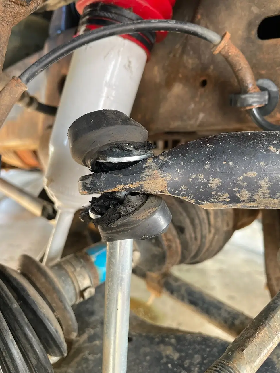

The sway bar links in the Explorer were brand new before that trip, and after, "gently used":

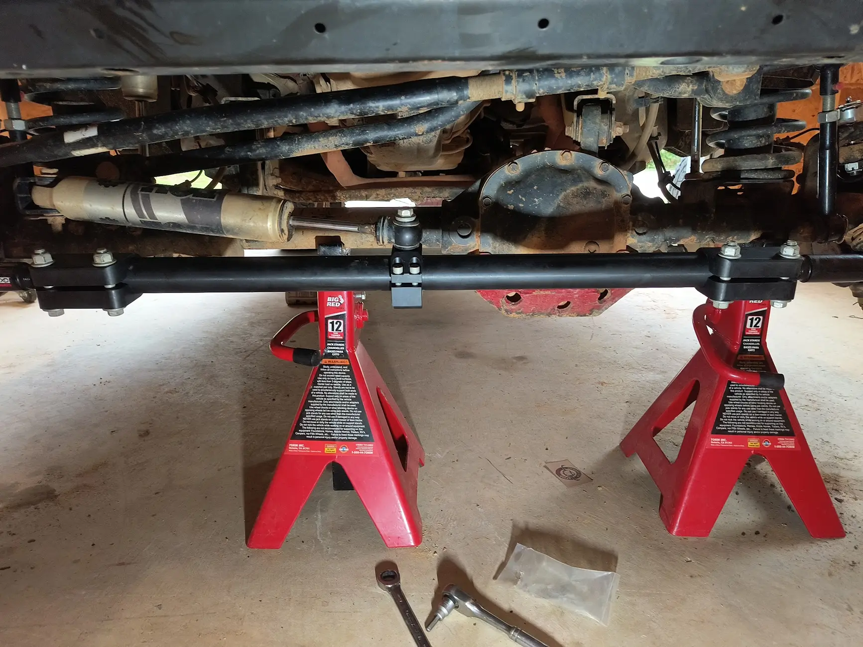

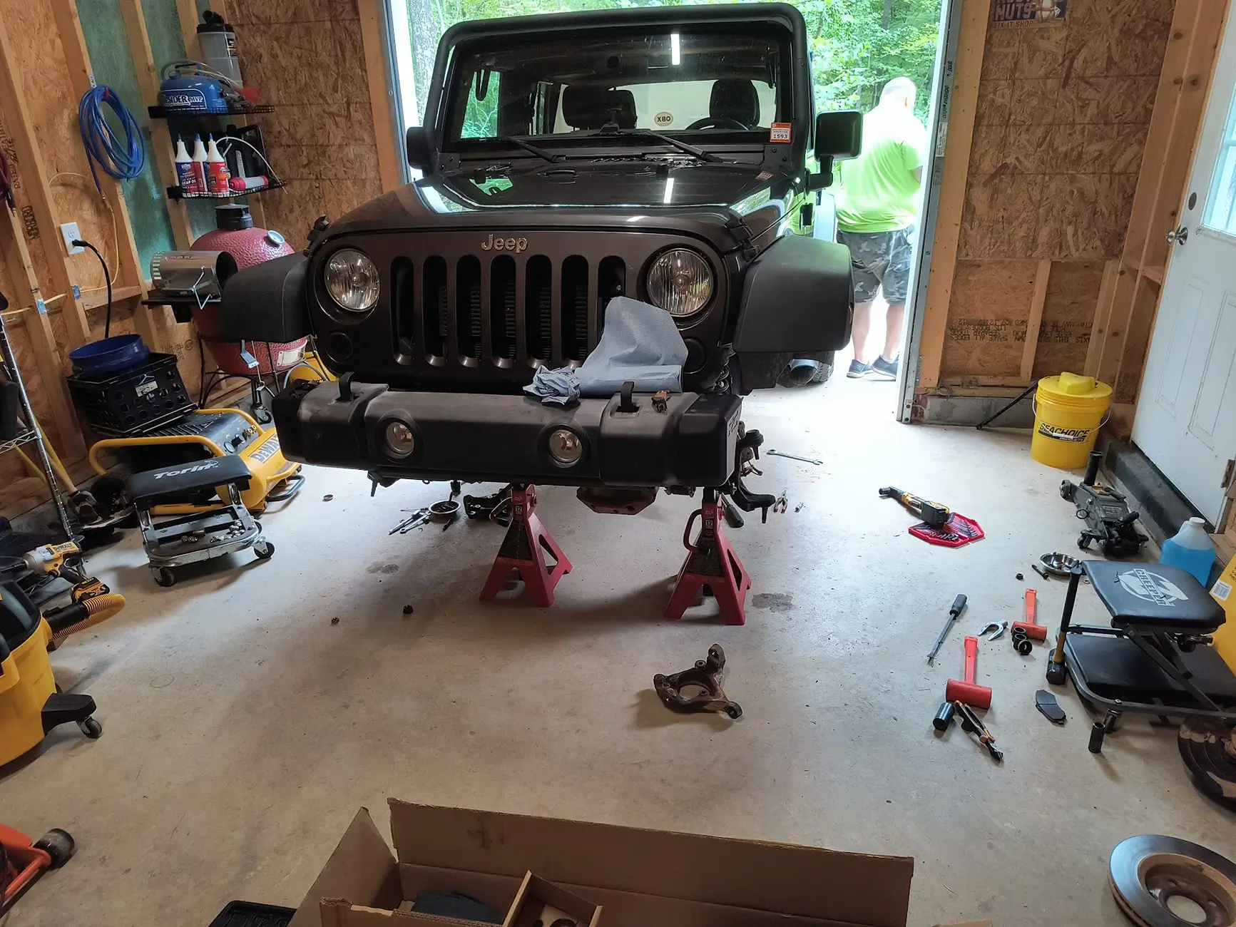

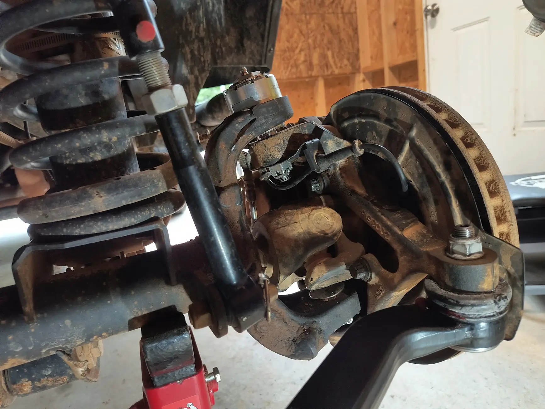

Not my Jeep, but my buddy's JKU. He'd been having horrible death wobble and his whole front end was pretty knackered. Ball joints were shot. Trackbar bushing was shot. Steering linkages were shot. Replaced the whole kit and kaboodle. Steer Smarts tie rod, Teraflex trackbar, and Dynatrac ball joints put in.

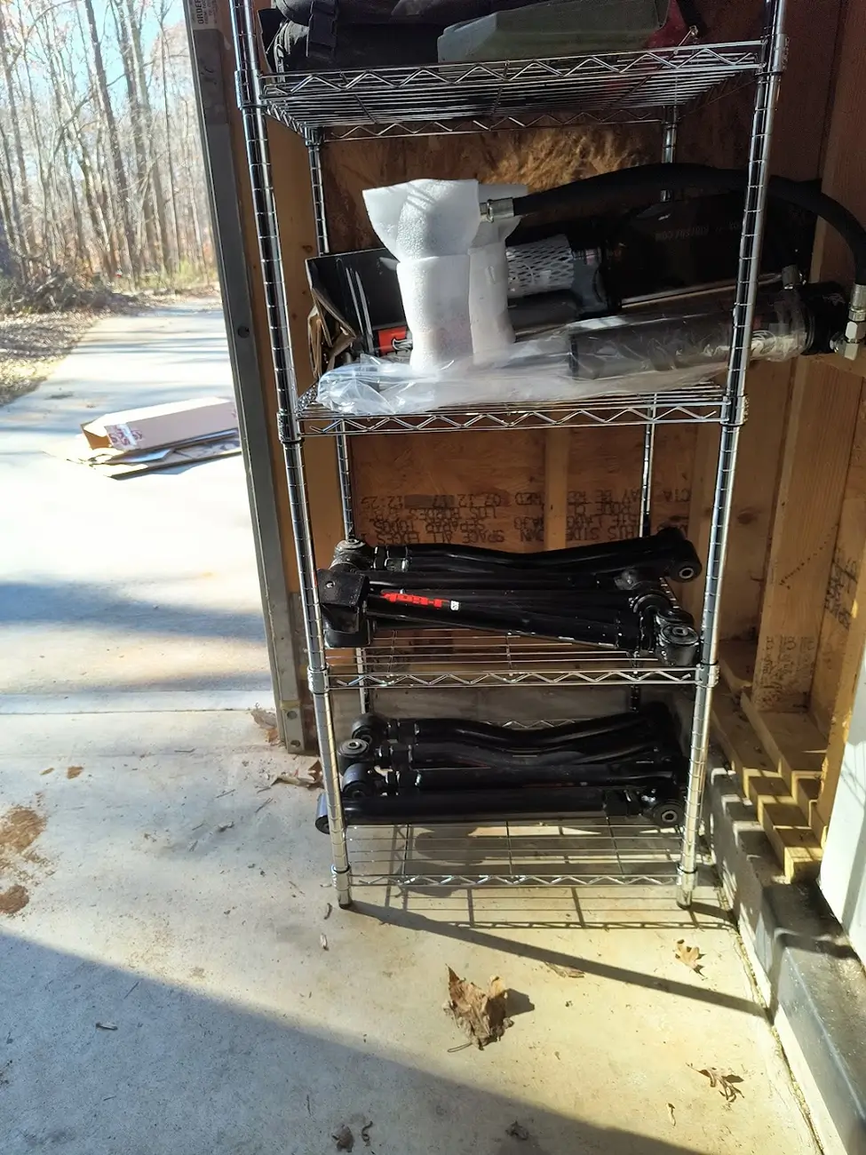

Let's see - then in Dec '24 Santa came early and dropped off a whole bunch of parts that I've only partially even installed because toddlers are insane and the wife (now pregnant with our second and ready to pop any day) and I are struggling to keep up.
8 adjustable arms for the JL (JKS, Clevite bushing version) and lower adjustable arms for the JT (also Clevite bushing version). Longer shocks for the JL and no-lift 2.5's for the JT.

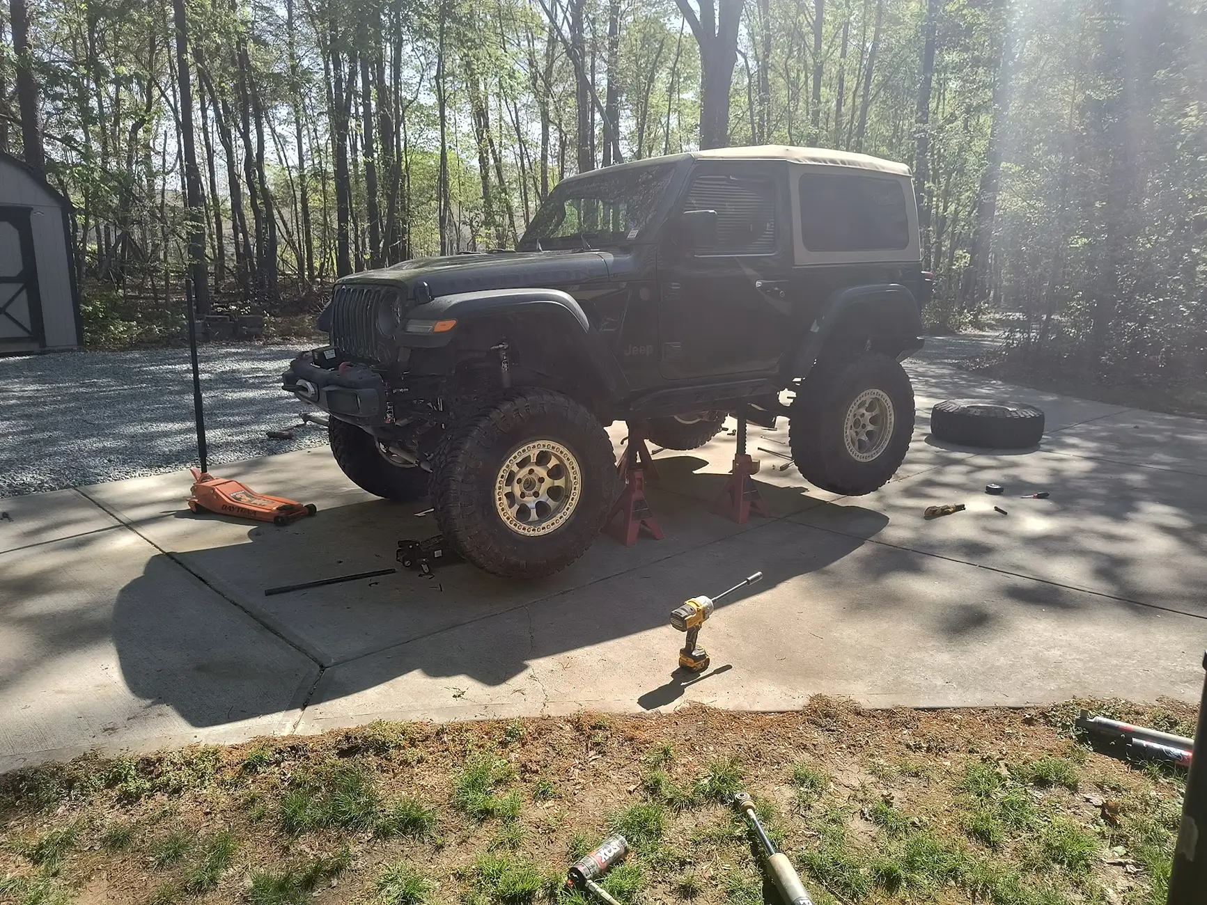

Fast forward to April '25 and I managed to get enough time to install the longer 2.5's in the JL:
Jeep Wrangler JL '22 JLR 2.0T build progress/wheeling thread 1758312228376-6z

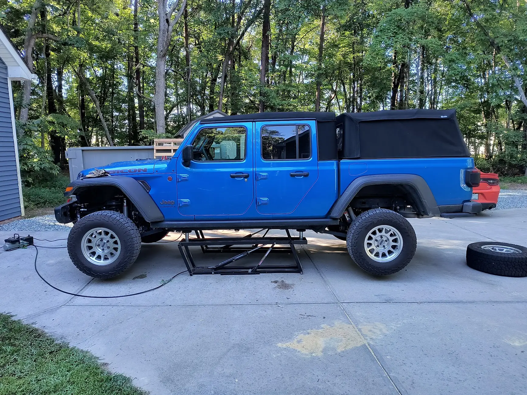

And somewhere in there also in the JT:
Jeep Wrangler JL '22 JLR 2.0T build progress/wheeling thread 1758312297739-nt

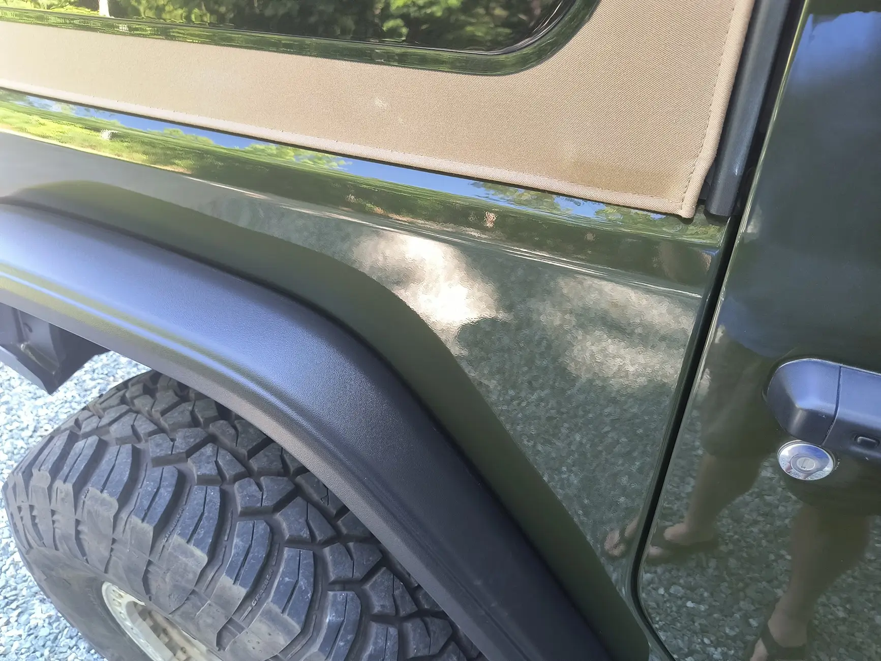

All squared away by the end of the month though thanks to a local body shop:
Jeep Wrangler JL '22 JLR 2.0T build progress/wheeling thread 1758312524731-3s

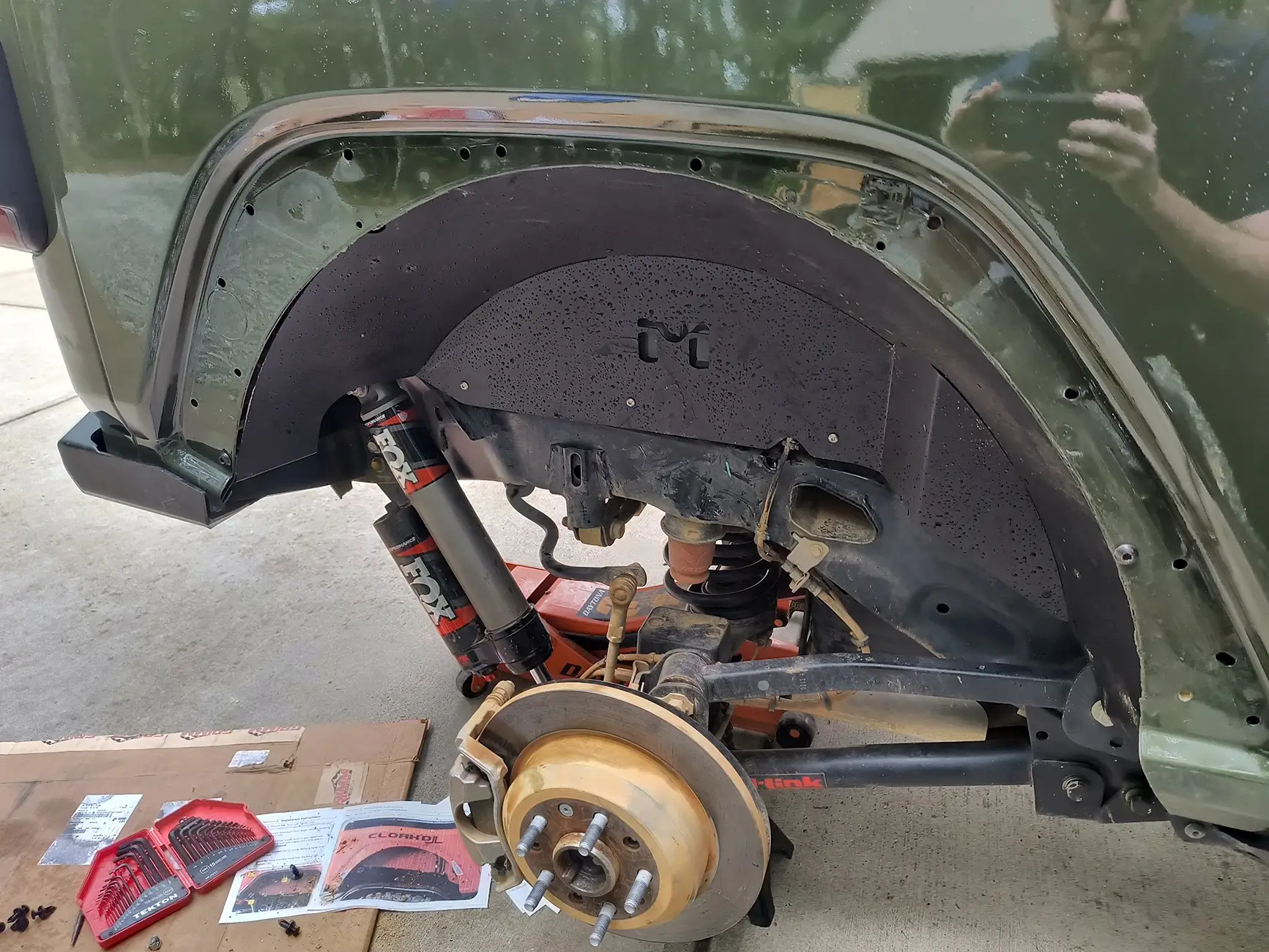

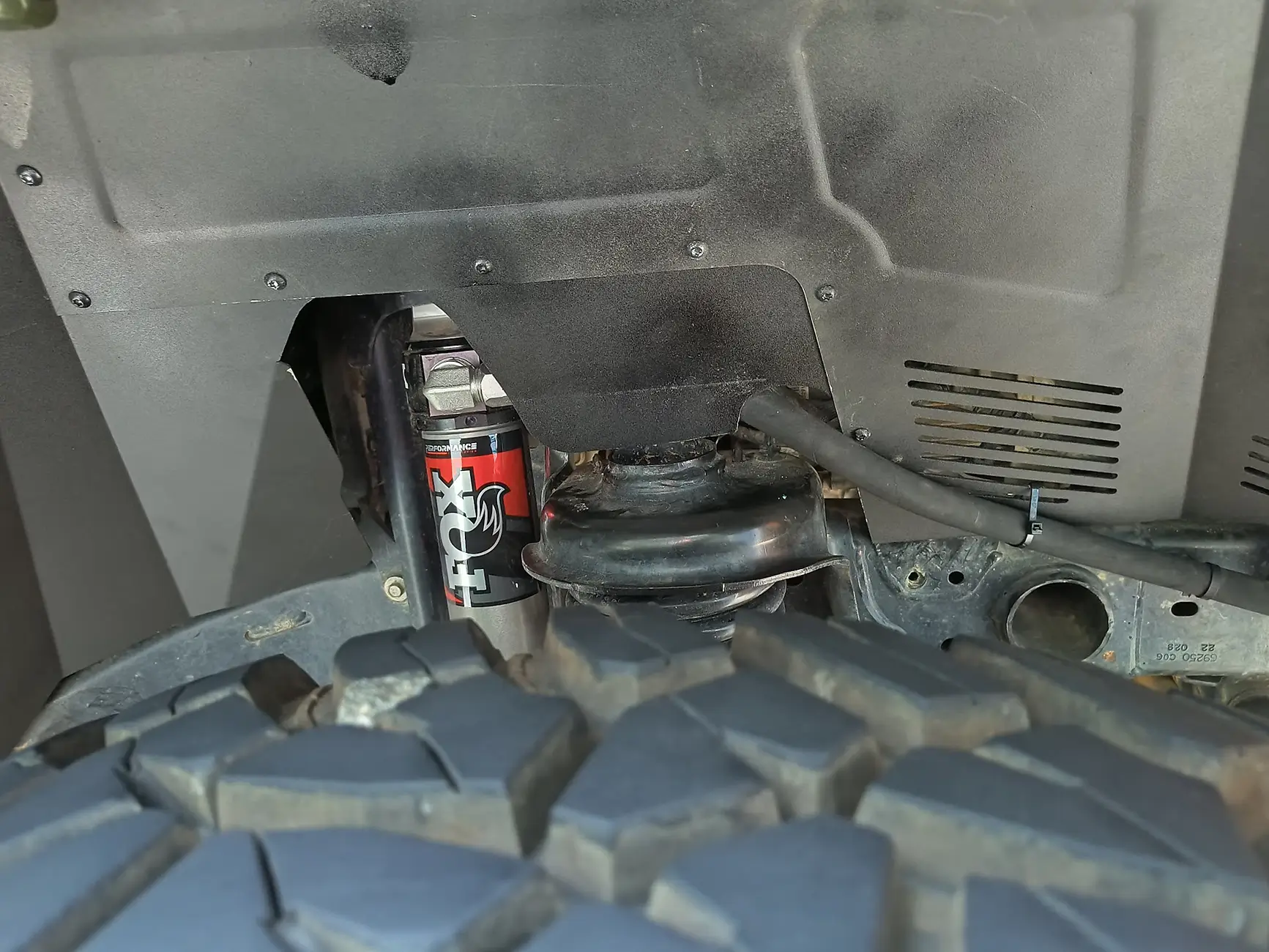

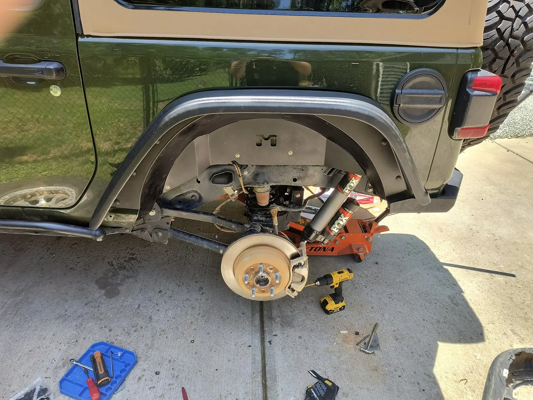

At this point (June '25) I was tired of the rubbing on the stock rear inner liners and I'd chewed up the rear passenger flare pretty good the couple times I ripped it off. So, I decided to replace my flares altogether. Took a gamble on the Rough Country WF1 flares ( WF1 Fender Flares | Jeep Wrangler JL (18-25)/Wrangler Unlimited (18-25) | Rough Country) and they actually don't suck. Time will tell how they hold up, but man, went on easy and look good. Also installed the Grimm front inner liners ( Grimm OffRoad Front Inner Fender Liners Bare - Jeep Rubicon 2018-2025 | 10147|Northridge4x4) and Metalcloak rear inner liners ( JL Wrangler Replacement Aluminum Inner Fender Set, Rear).
All told, project came out pretty well. Been updated a couple times since it first went on, but here's the first iteration:
Metalcloak rear liners went in nice, and the RC flares matched up well
Jeep Wrangler JL '22 JLR 2.0T build progress/wheeling thread 1758313000995-xh
Jeep Wrangler JL '22 JLR 2.0T build progress/wheeling thread 1758313090865-s3

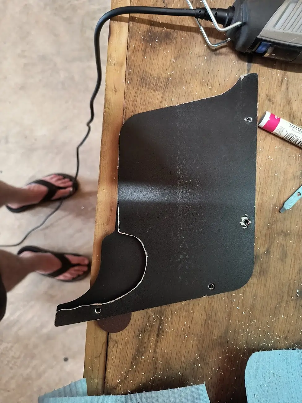

The Grimm liners required some modification of one panel to clear the Fox resi hoses (feet pic for ya @J.Ferreira, any more costs extra)

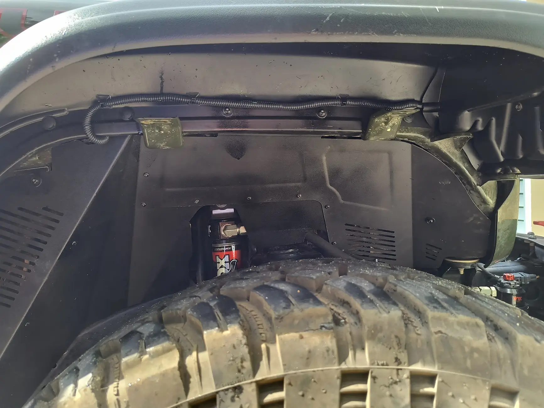

Flares reuse the stock DRL/turn signal and so I just routed the wiring in a loom with some sticky zip tie bases:
Jeep Wrangler JL '22 JLR 2.0T build progress/wheeling thread 1758313411889-cm
All told, the flares look stockish but a little higher clearance

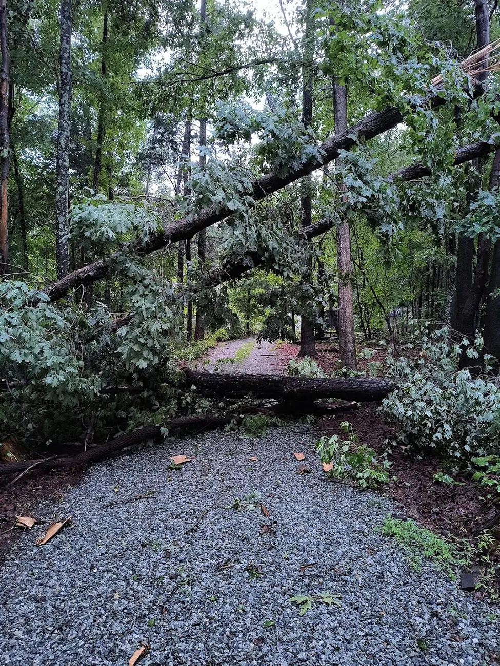

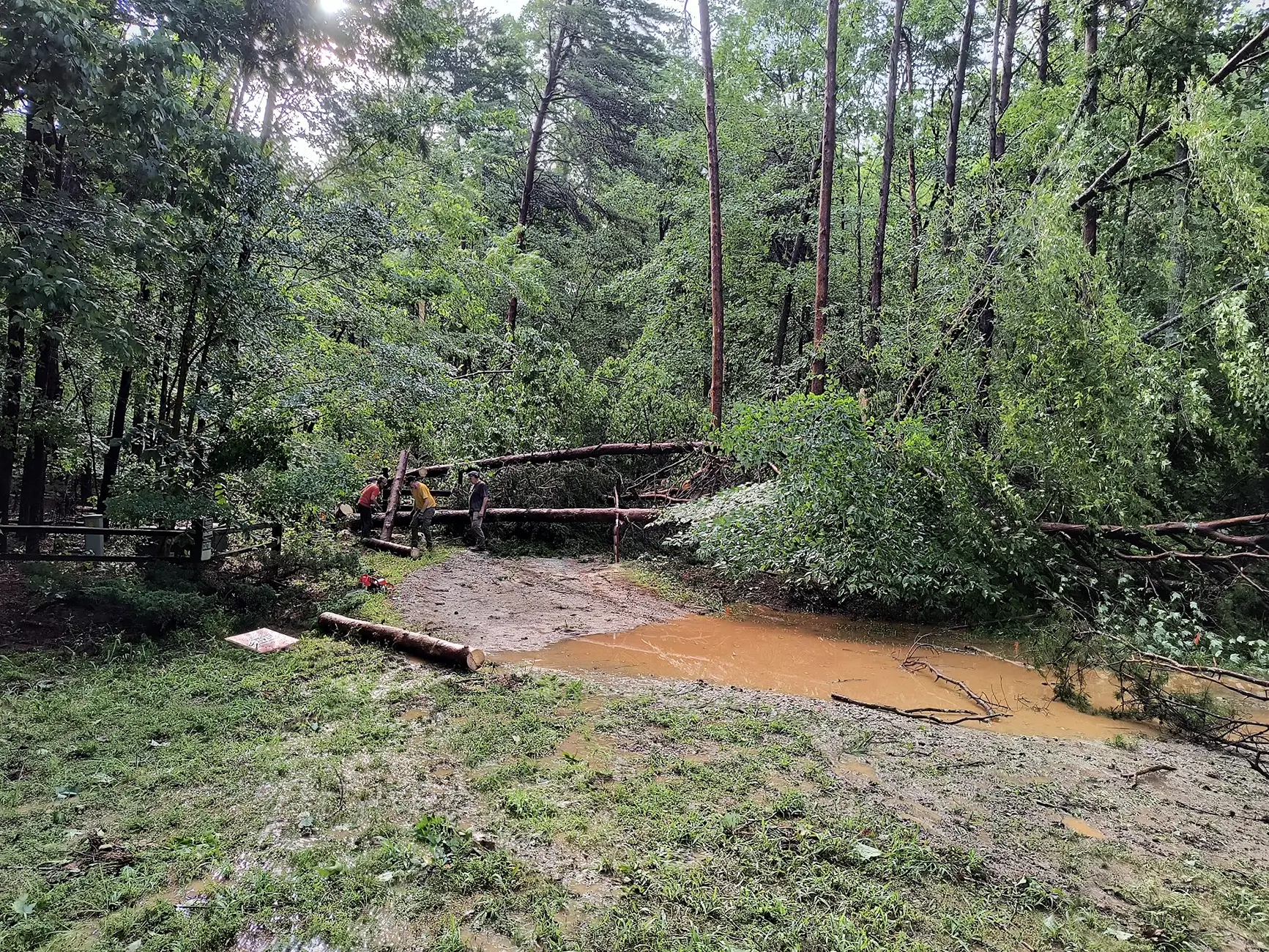

This one's not really a wheeling or wrenching thing, but more a time that the Jeep came in very handy. During tropical storm Chantal in July, the storm sat over central NC and dumped somewhere between 9" and 12" of rain in an afternoon. It also spawned like 3 tornadoes in the NC piedmont. Guess which lucky bastard had a tornado zip right over his house? That's right, this fucker! Lots of downed trees and stuff, but no real damage.
It bent my flag pole:
Jeep Wrangler JL '22 JLR 2.0T build progress/wheeling thread 1758313943991-ir
Dropped 3 big oaks, a maple or two, and a couple sourwoods across my driveway. You can see how splintered the oak trunks are:
Jeep Wrangler JL '22 JLR 2.0T build progress/wheeling thread 1758314007705-5s

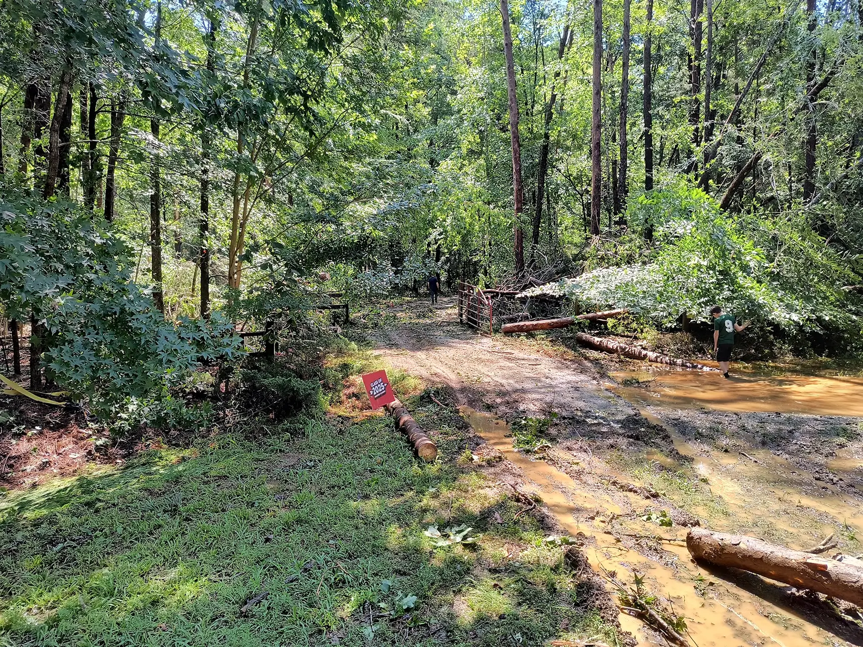

And this used to be the neighbor's driveway, they lost like 6 or 7 tall pines and a load of understory hardwoods here:
Jeep Wrangler JL '22 JLR 2.0T build progress/wheeling thread 1758314062018-1a

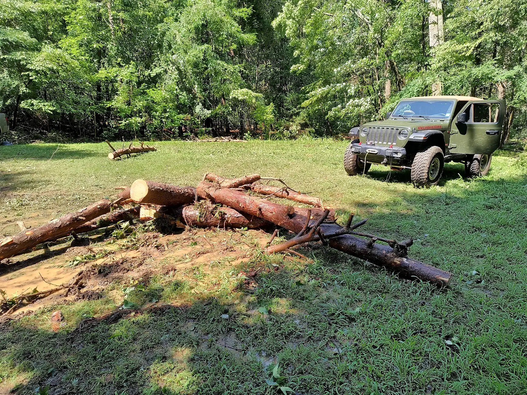

We were glad to have the Jeep because we could put it to work moving big logs so we could spend less time cutting and much less manpower on moving logs:
Jeep Wrangler JL '22 JLR 2.0T build progress/wheeling thread 1758314133428-d

J.Ferreira
Aug 4, 2022
8,289
42,933
Castle Rock, Colorado
www.tmgps.org
1999 Jeep XJ
Good man with the flip flops

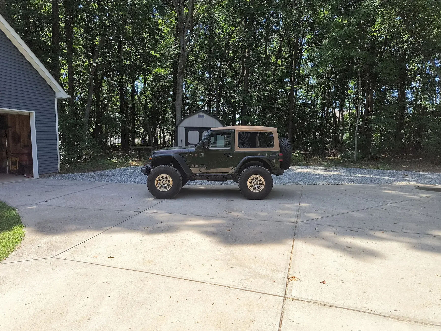

Alright, August '25 - got back out for a relaxing wheeling trip. No wild trails, just a good time with the top and doors off.
Jeep Wrangler JL '22 JLR 2.0T build progress/wheeling thread 1758314410445-5u
Jeep Wrangler JL '22 JLR 2.0T build progress/wheeling thread 1758314667101-nf
