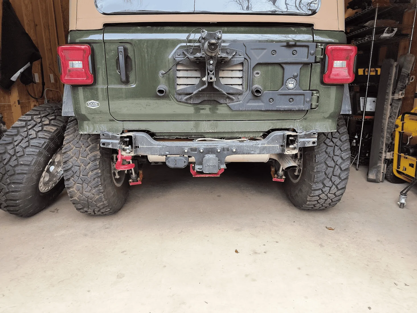

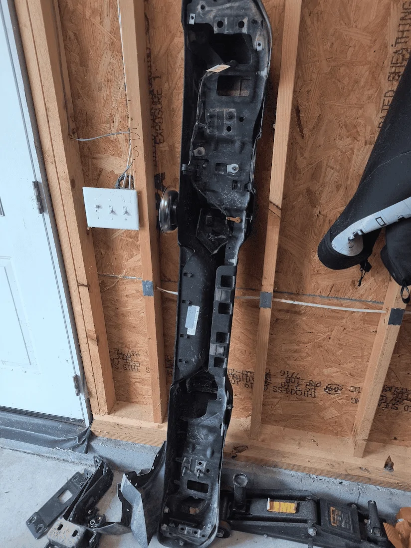

So, I'm not dead. Mama and baby doing well, but haven't been working on the Jeep due to trying to be decent at dad duty. However, baby's being less intense and wife's being awesome and letting me get some garage time, so I'm picking at the Jeep again. Got the Metalcloak "narrow width" rear bumper and Teraflex license plate relocation kit in.
Jeep Wrangler JL '22 JLR 2.0T build progress/wheeling thread 1702170991038
Anyway, got the bumper stripped off today:
Jeep Wrangler JL '22 JLR 2.0T build progress/wheeling thread 1702171041046
Jeep Wrangler JL '22 JLR 2.0T build progress/wheeling thread 1702171054577
Interesting observation is that without the spare I picked up 1/2" additional clearance to the frame at the LCA bracket/skid on the driver's side and 3/8" clearance on the passenger side. Even the HD JKS springs are pretty soft in the early rate and really feel the weight of the spare and bumper.

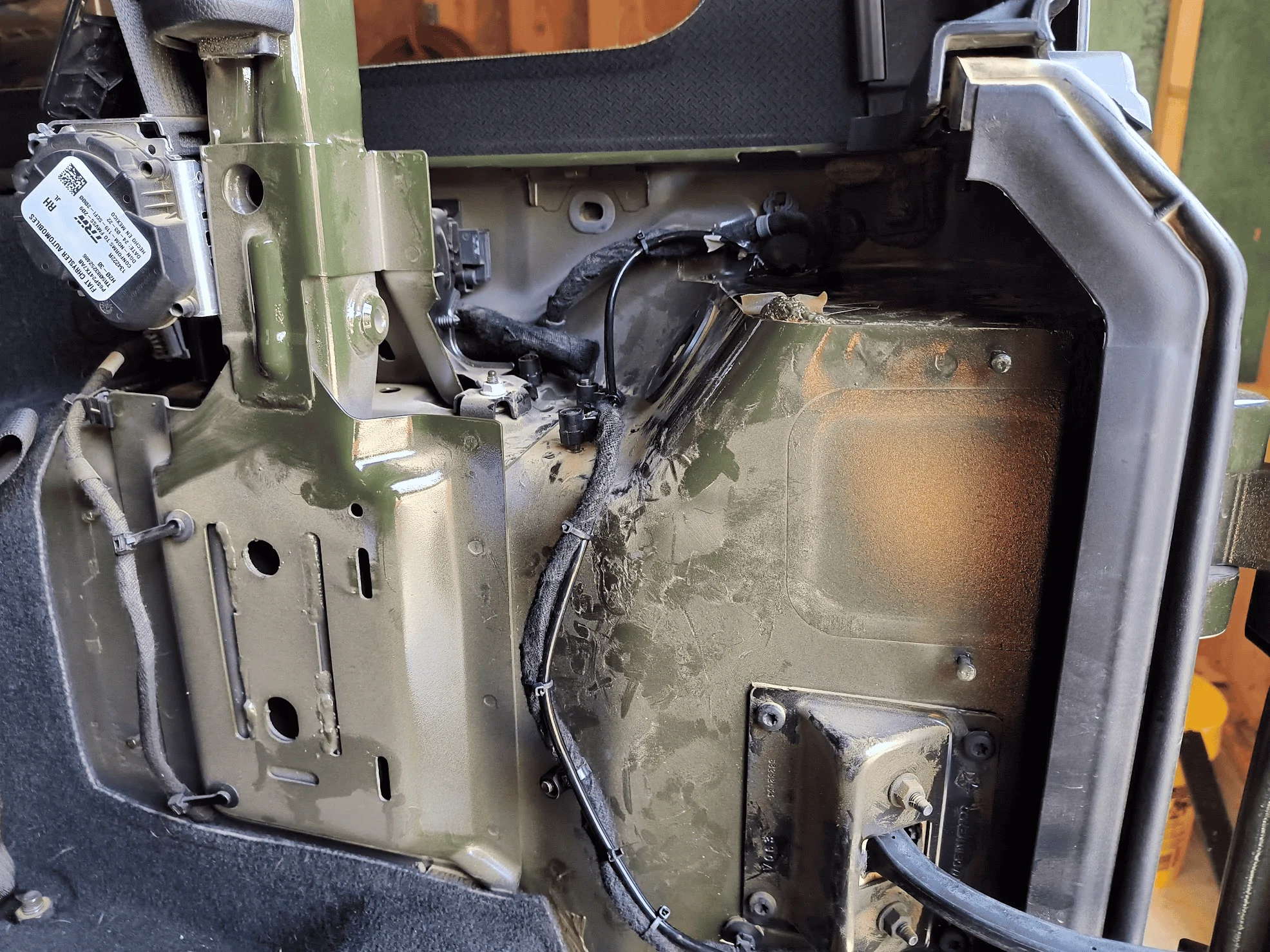

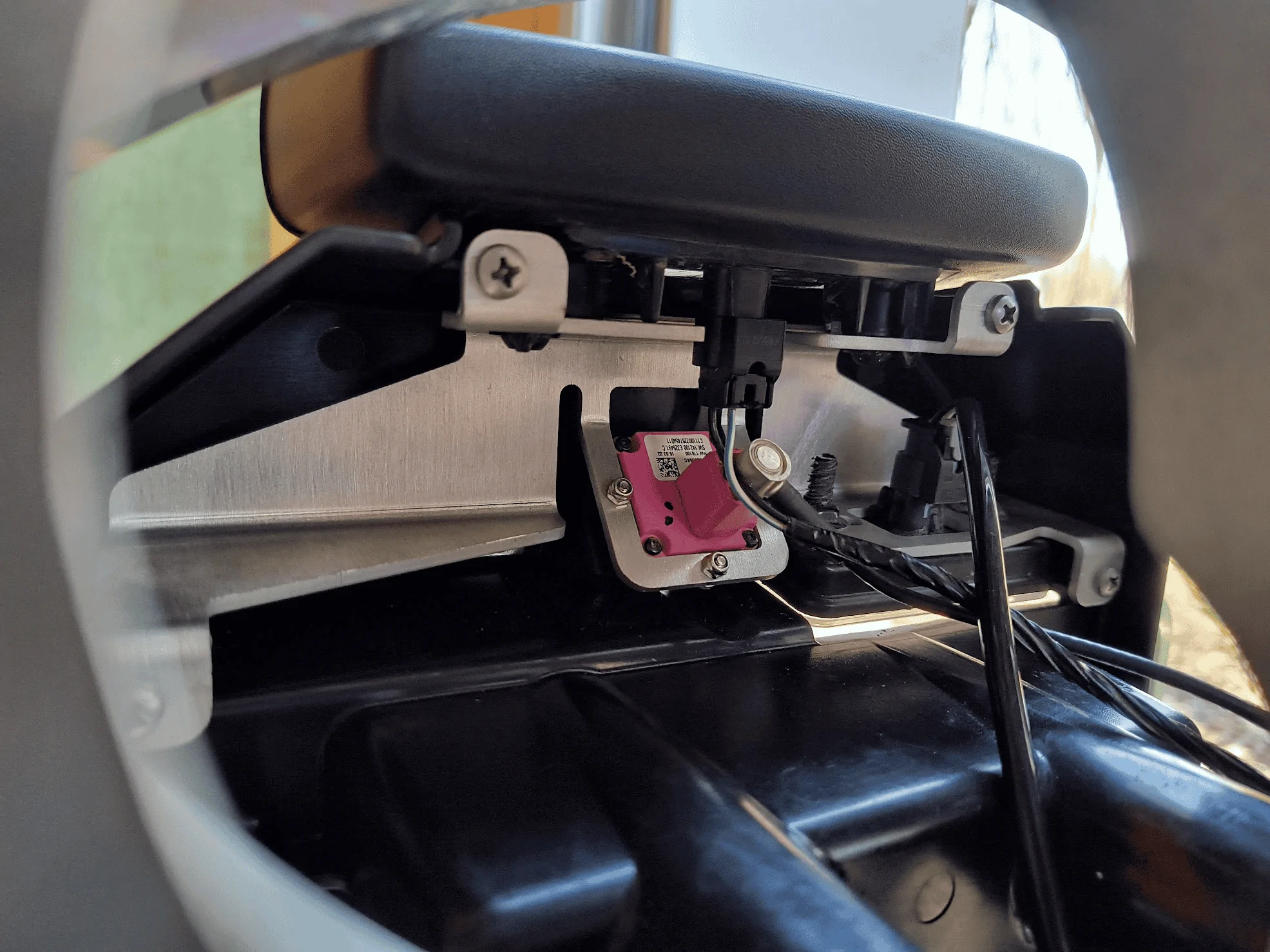

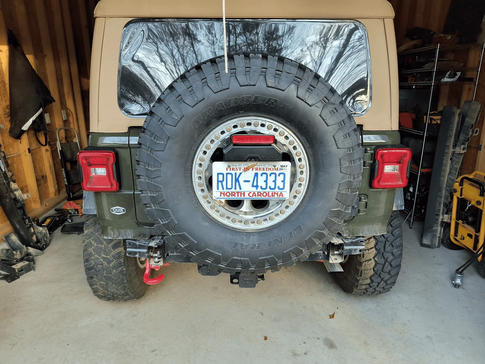

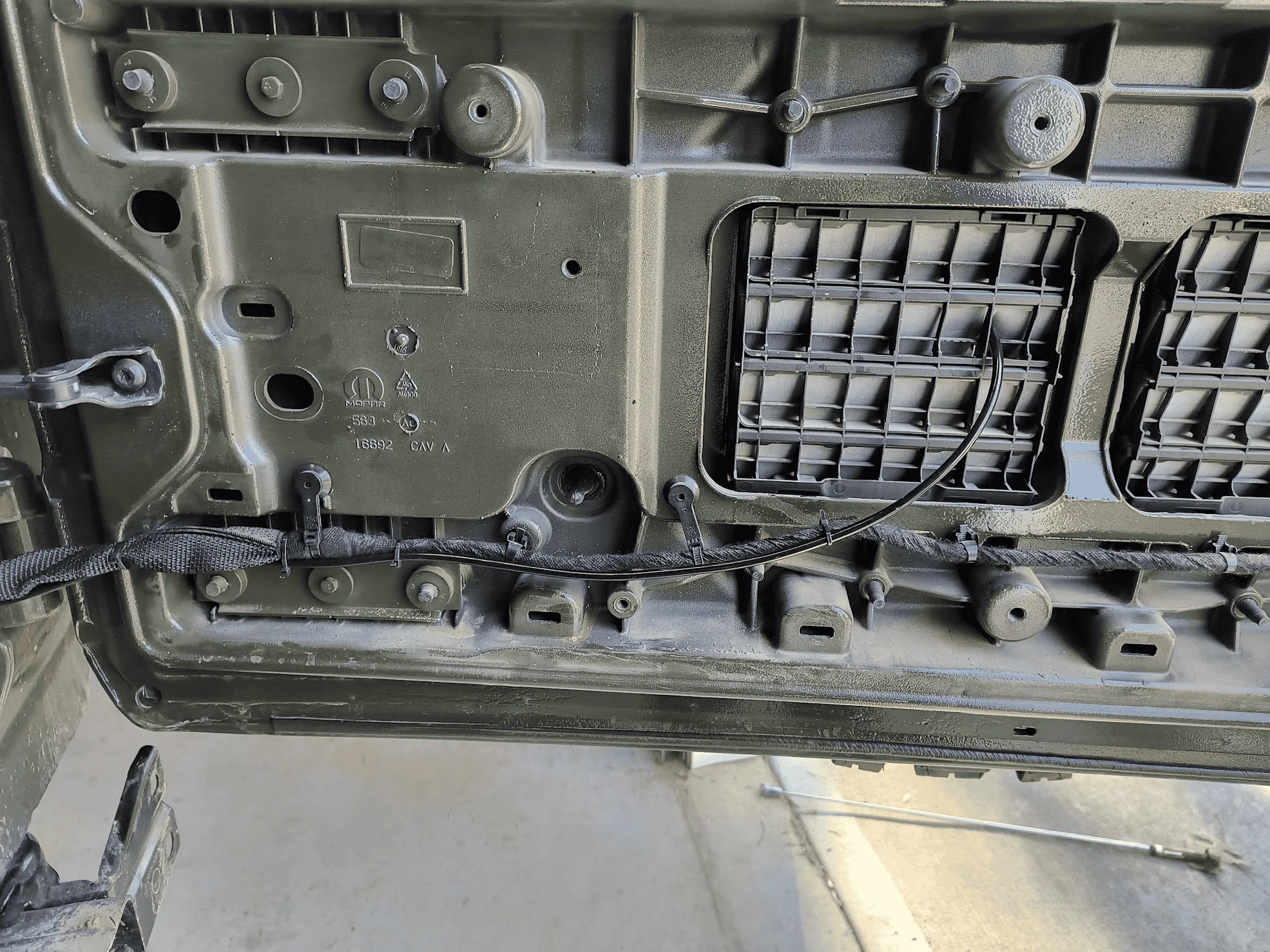

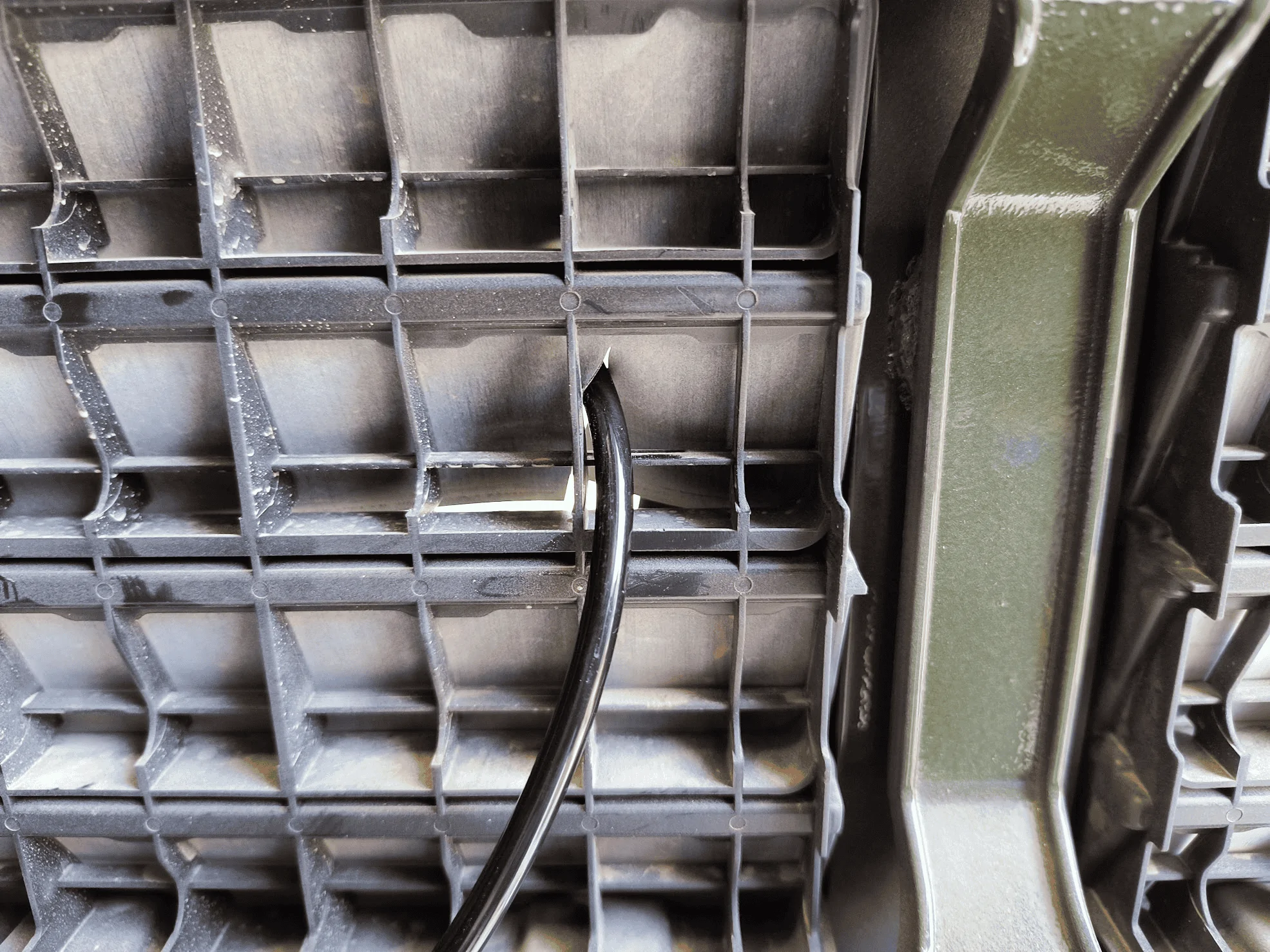

Been slacking on updating this. Got the Teraflex plate relocation in, fairly easy install. Hardest part was slinging the spare around, and the frustration of cracking the plastic panel you gotta pull. Planning on ordering some Armorlite in the late spring, so I'll probably replace the panel when I put that in. Anway, for the routing of the lamp extension wire I just zip tied the provided wire to the tow harness along the rear frame crossmember and then did the following inside:

One thing to note is how tight everything is on the back of the relocation kit. This has to come off when you take the spare off, and for me I have to come through the spare to get at some of the connectors:

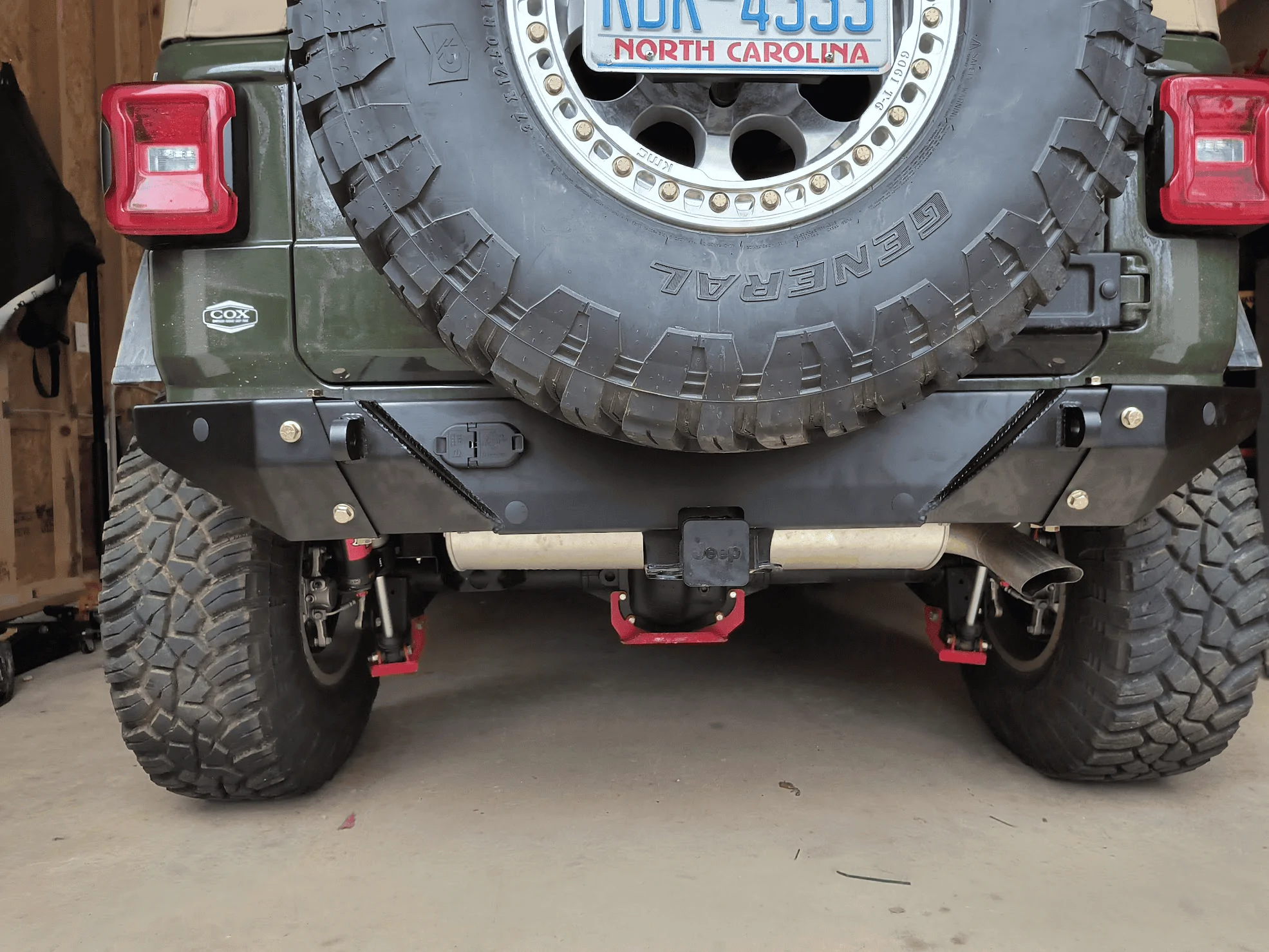

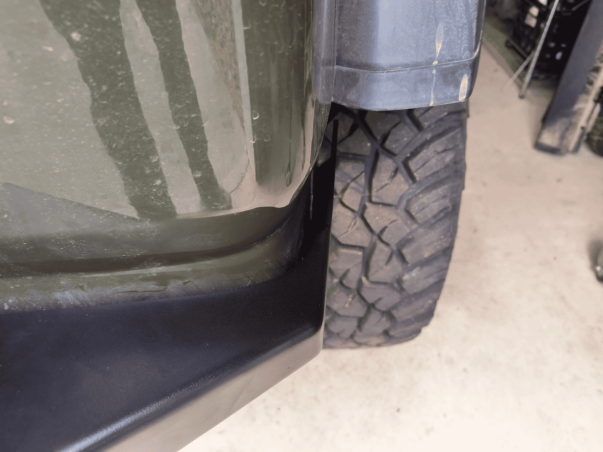

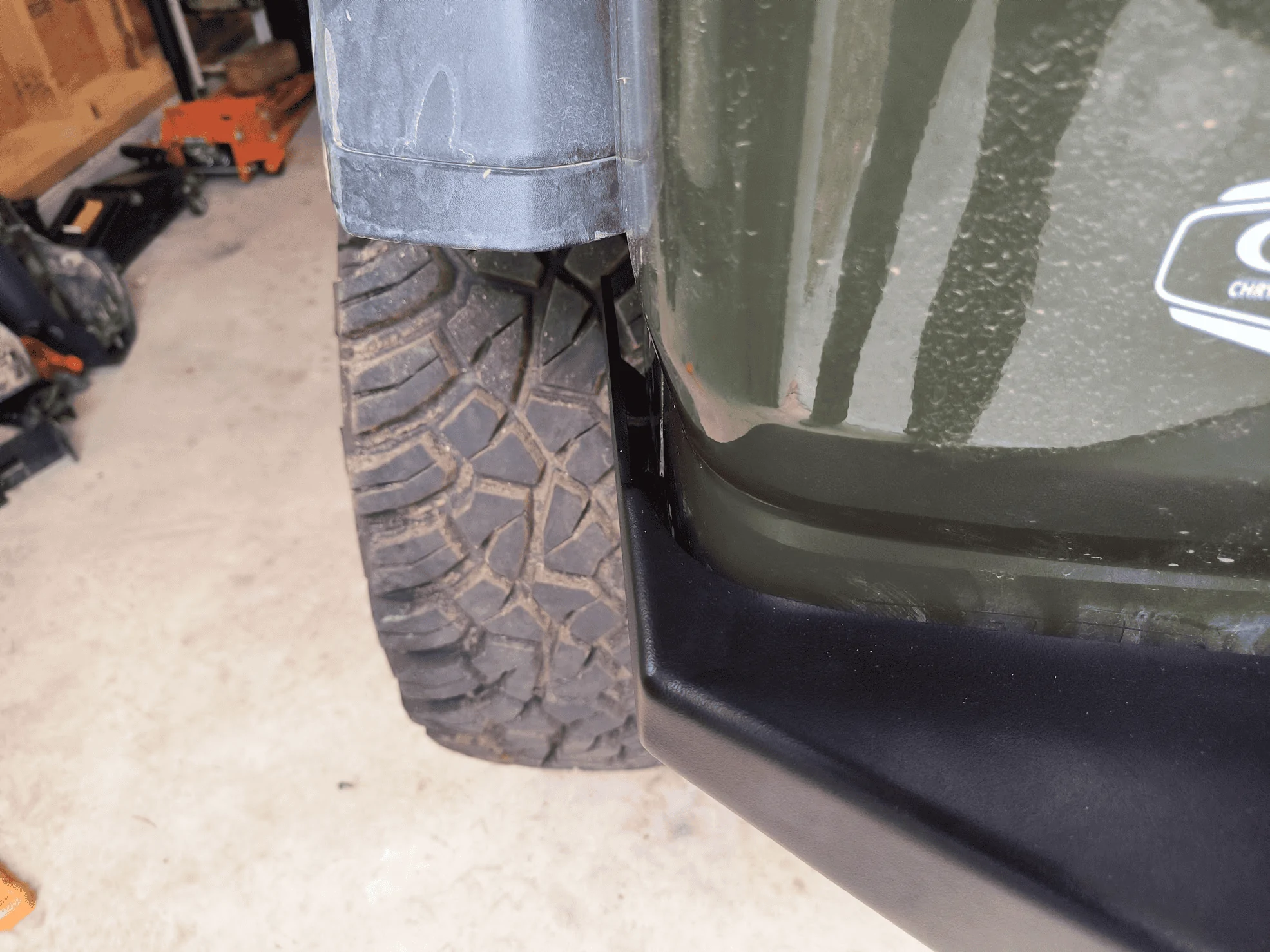

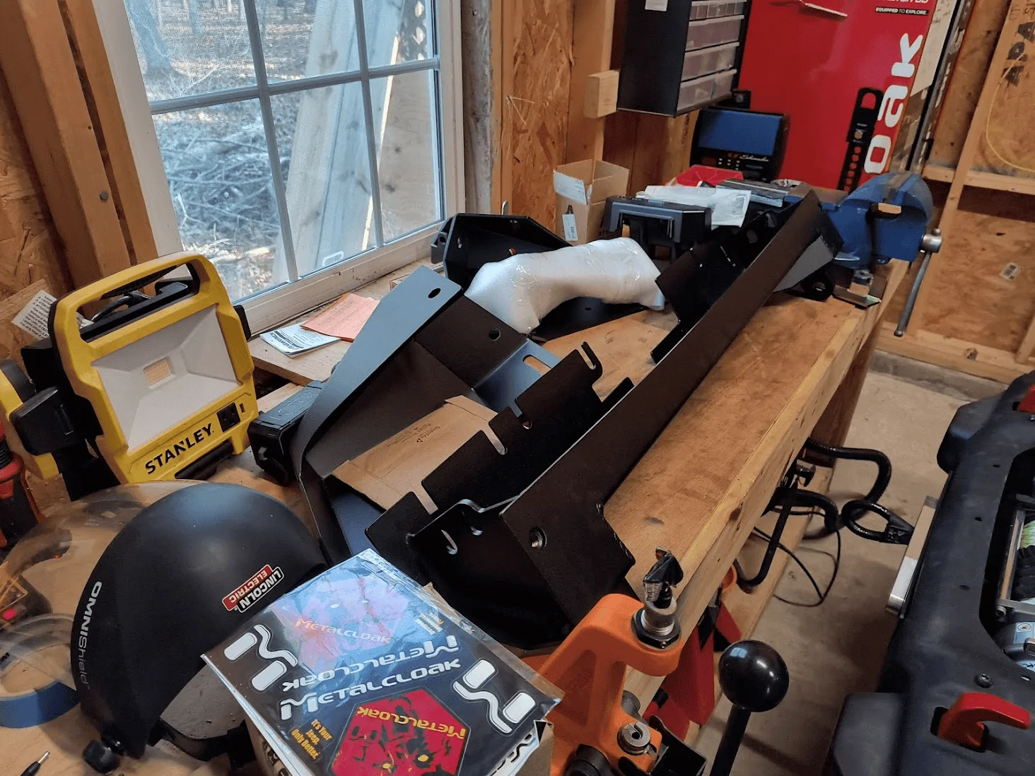

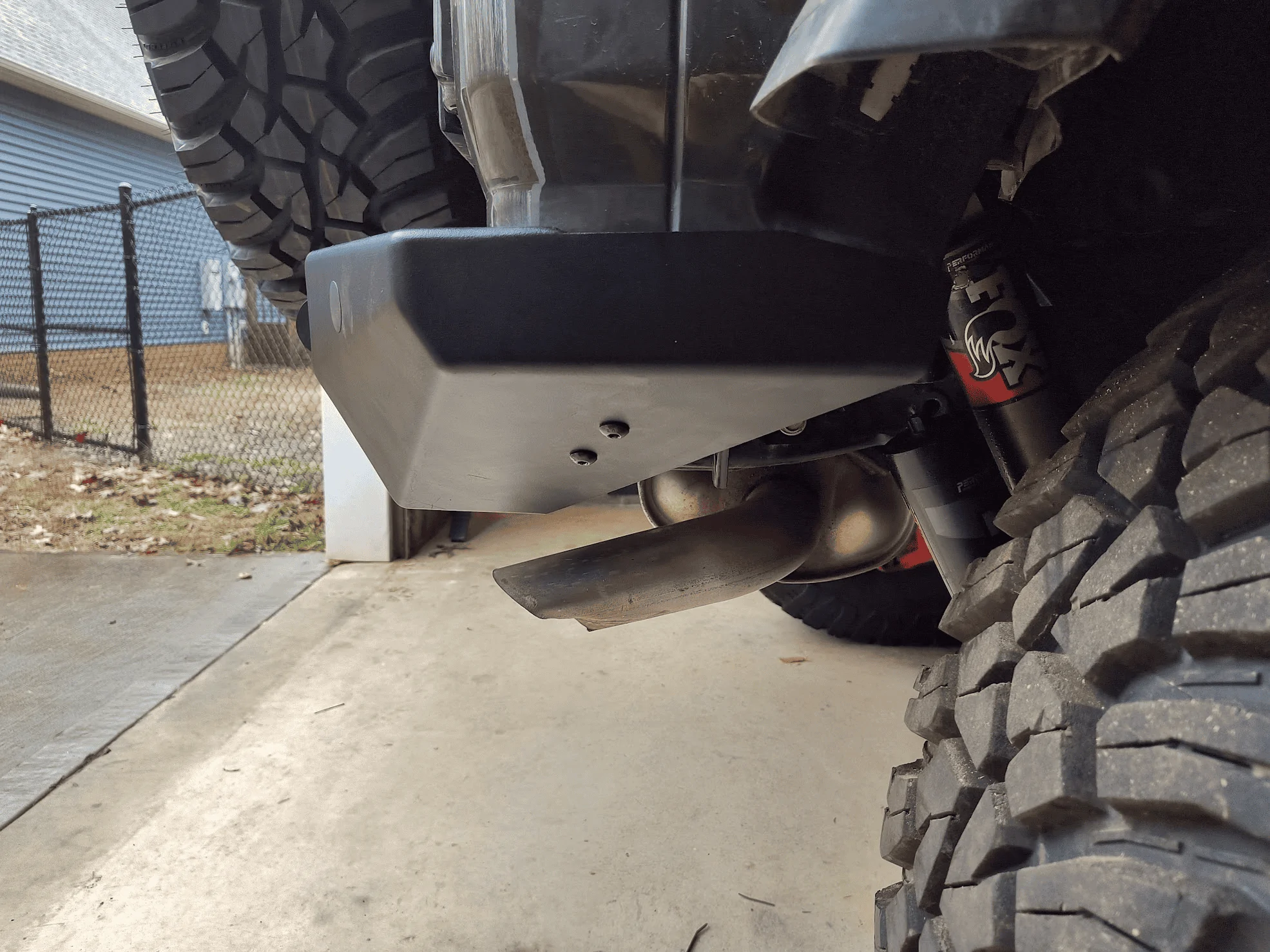

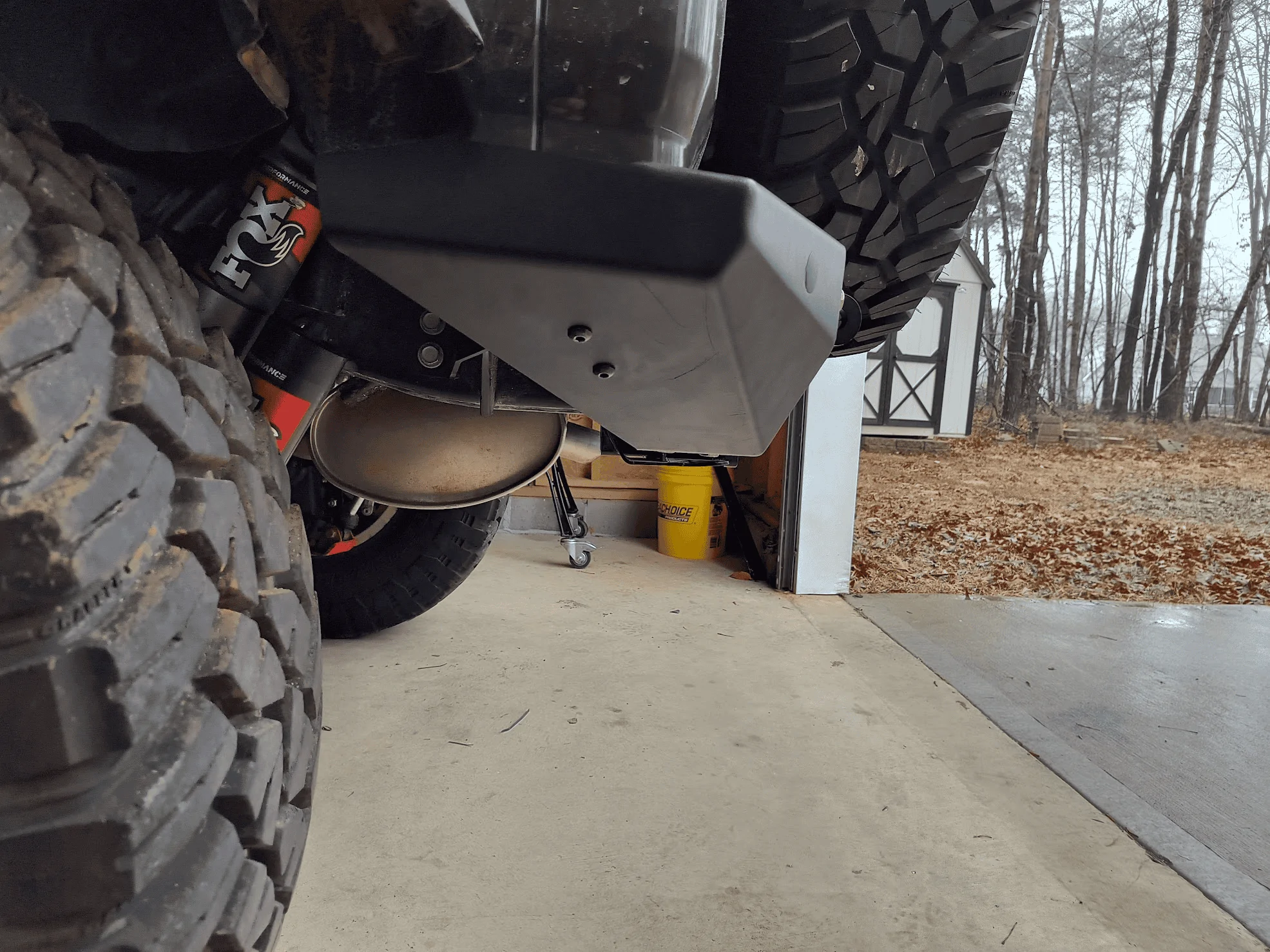

Also got the Metalcloak bumper put on. Pretty happy with the clearance gained, and the lack of weight for a steel bumper. Gained ~5" of clearance at the corners and it protects the tub corners really well:
Jeep Wrangler JL '22 JLR 2.0T build progress/wheeling thread 1706906413271
Jeep Wrangler JL '22 JLR 2.0T build progress/wheeling thread 1706906423552
Jeep Wrangler JL '22 JLR 2.0T build progress/wheeling thread 1706906442984
Jeep Wrangler JL '22 JLR 2.0T build progress/wheeling thread 1706906460852
Jeep Wrangler JL '22 JLR 2.0T build progress/wheeling thread 1706906476681

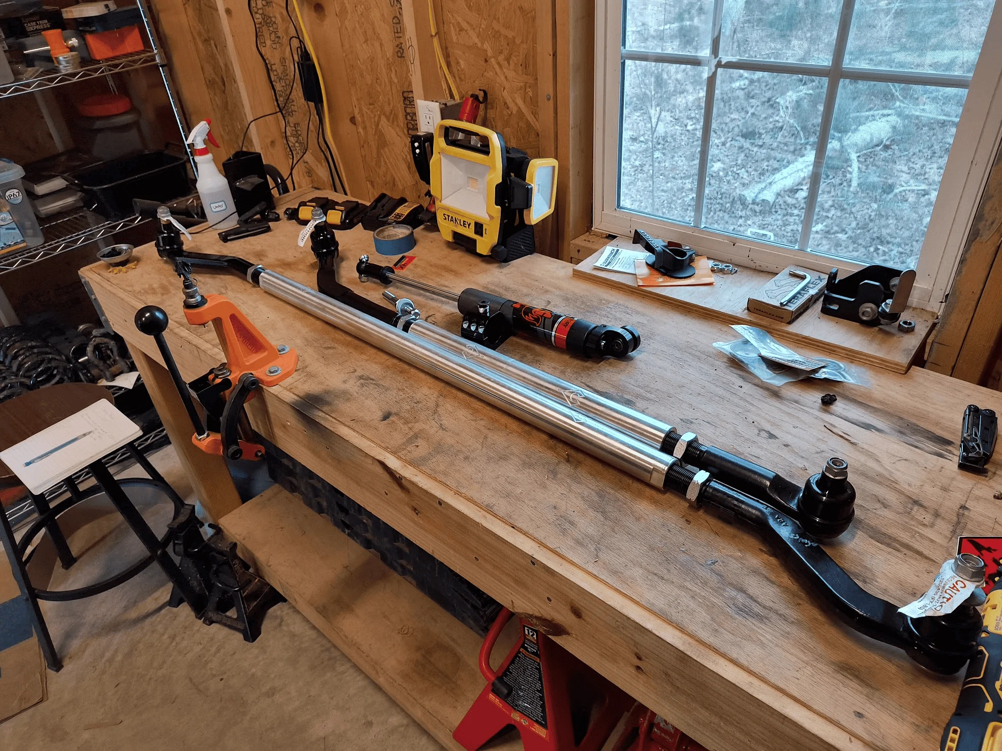

And next project is currently lined up, hoping to have this dialed in before spring wheeling starts. The Artec JL steering kit with 1.75" OD aluminum links comes with Steer Smarts rod ends, which I'm excited about, things are pretty chonky:
I like the bumper, especially their execution on the tow outlet and sensor locations.
Dumping/replacing the muffler soon? Looks like it's stayed safe so far other than the tip.
EDIT: beat me to it.
Yeah, she got to go. Magnaflow's high tuck option is what I'm eyeballing to stick in. Had the same in my JK and loved its clearance. Wasn't wild about the sound on the 3.6, but the 2.0 should just sound like turbo noises so expecting it'll be less shouty.
Looking at the Maggy Crawler or Overland?
Overall though, pretty happy with how it looks. Good all-in-one solution.
The only part I hate about it is the running it through the vent. It is a non ideal solution. Other than that I am very happy with mine.
After this, probably gonna switch out to a higher clearance exhaust, the Armorlite is definitely happening since I'm tired of the carpet, and considering swapping out the MORE steel skids for their aluminum versions since the JKS springs seem pretty weight sensitive. Never run aluminum skids before, figure they won't hold up as well as steel skids, but wondering if I'll be in them a little less since the springs are dealing with half the weight. Worthwhile experiment to try something new I guess.
This is the steering kit I’m gonna get. Don’t see much about the Artec steering on here but it looks pretty BA.
I'm hoping it's as good as it looks lol. Looking forward to getting rid of the crappy stock rod ends.
