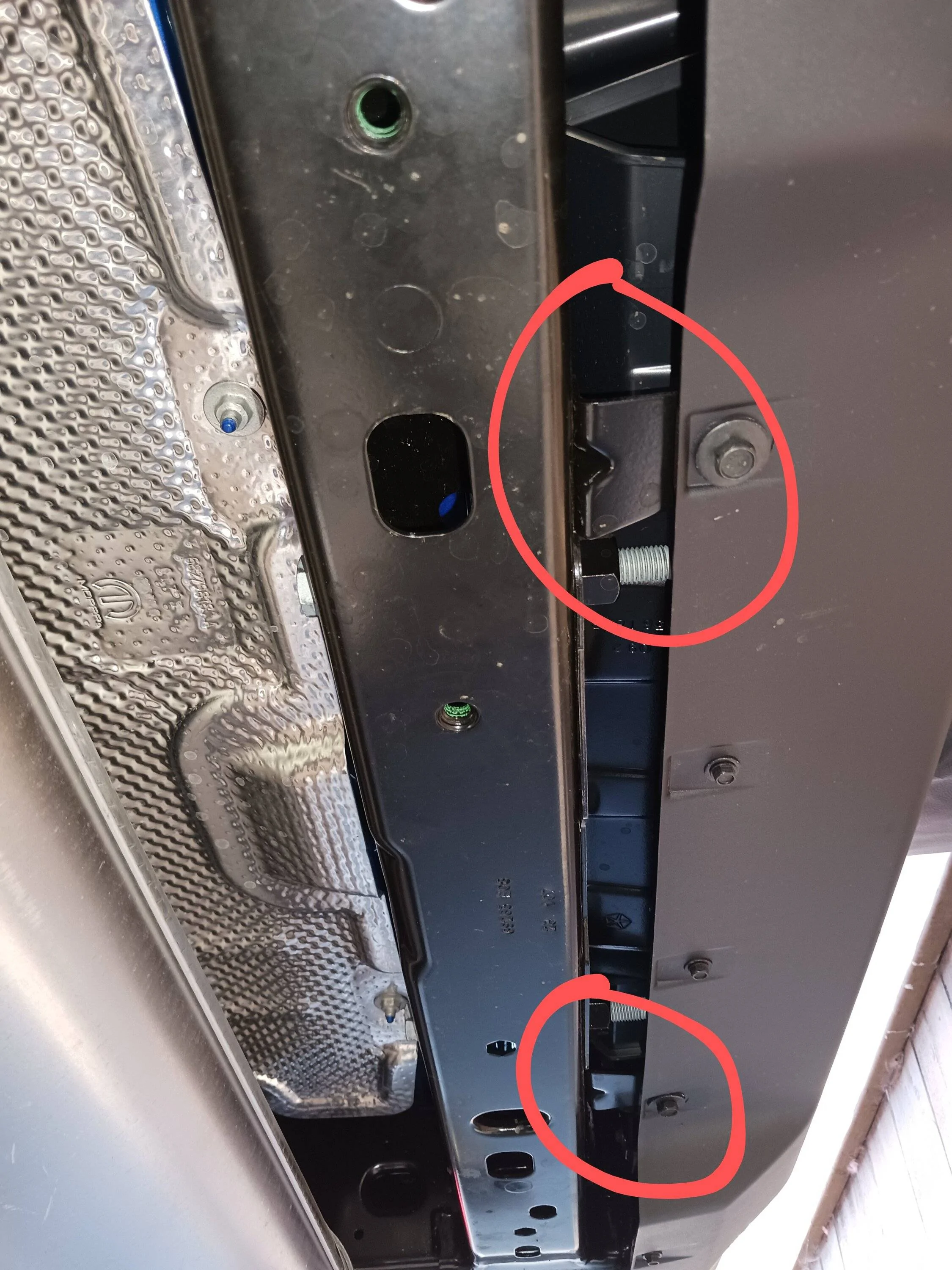

This is a picture of the rear cross-member that shows why removing the rear bumper is necessary.

OK, you think you know the drill ... have at it.. :giggle:
I don't know. Are you saying that, under these circumstances, removal of the rear bumper isn't necessary?

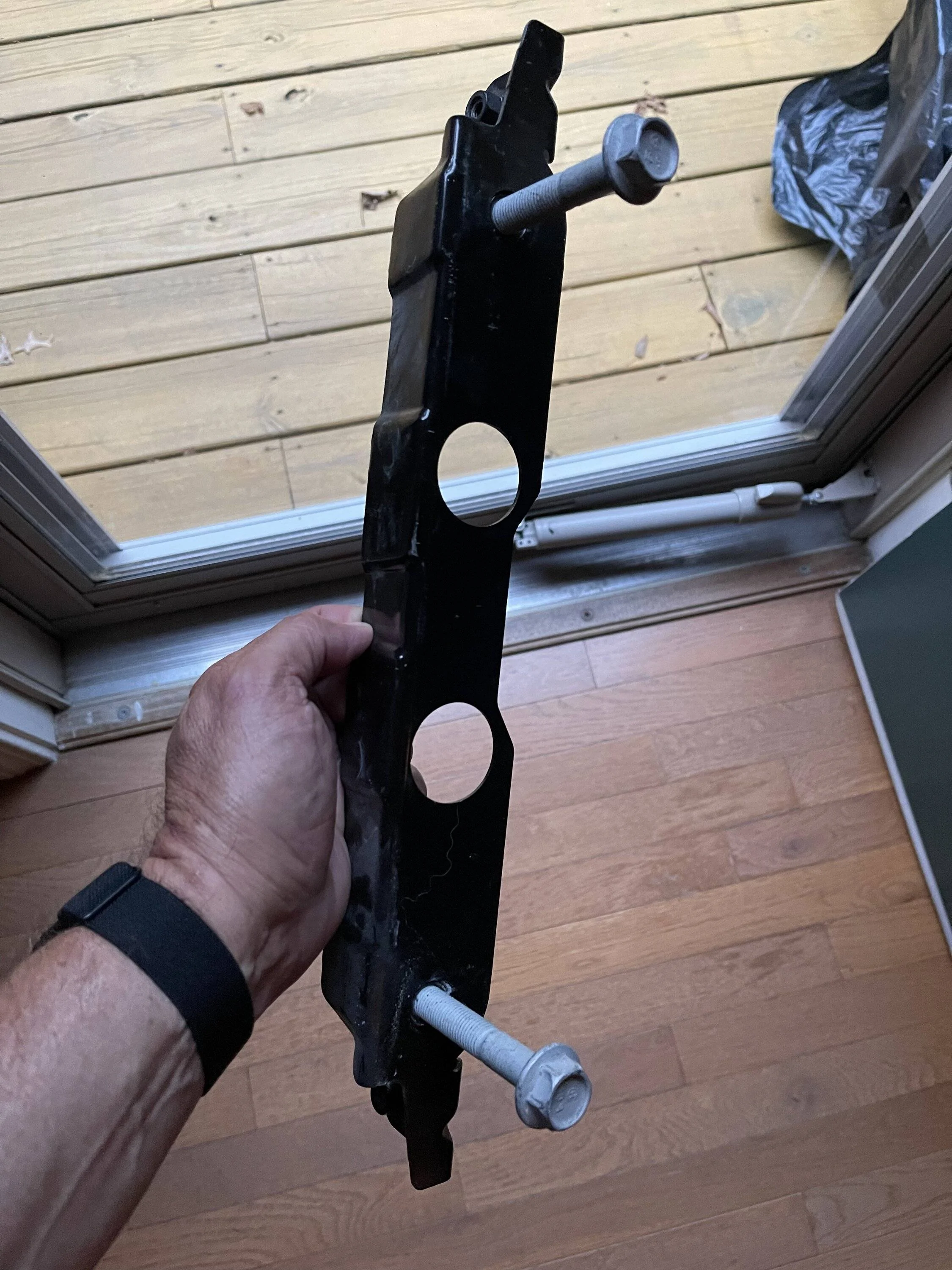

I removed that piece without removing the rear bumper on my 2022 Wrangler Willys XR.
I did, however, drop the rear muffler down some by loosening the hanger brackets.
Jeep Wrangler JL 2023 JLU High Tide Trailer Hitch DB393C1A-CEE2-4F99-B5D3-523B151C20F2
I installed a take-off MoPar hitch I bought from @Sssuperdave and I used a Tekonsha four flat wiring harness.
That Mopar part is "Bumper Mounting Spacer - Mopar (68298924AB". Not all JL's actually have that part installed.
I'm not sure why you dropped the muffler down...
(perhaps that gave YOU more room to work) but ... anyway, regardless .... as you mentioned, you do not need to remove the rear bumper to install a hitch on any JL. (A little prying and the spacer, if the JL has one, is easily dealt with.)
