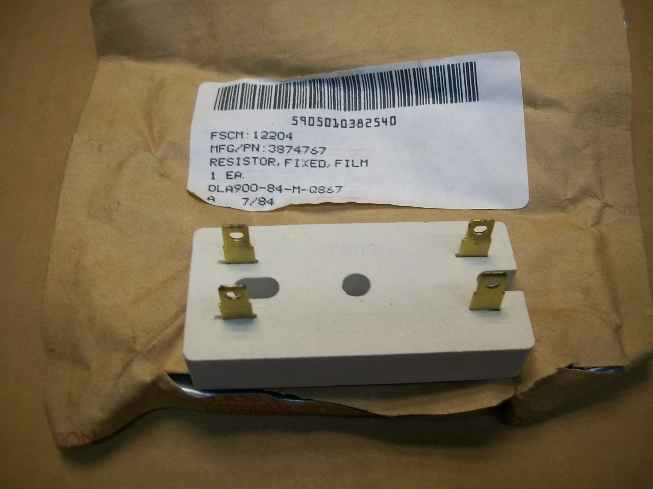

Not sure how old you are, but your "spare in the glovebox" comment took me back to my 72 Chrysler New Yorker. If you had an older Chrysler product, you ALWAYS kept a spare ballast resistor in your glovebox, as they were cheap and easy to replace, but failure prone. It wasn't a matter of if it would fail, but when it would fail.
50+ years later, and CDJR still has this "issue", though ballast resistors are long gone. :LOL:
Never had a 72 New Yorker, but had a couple Pintos that would burn them up. Fortunately, that was all that burned up on them. 🤔
Man, you brought some memories back. My dad carried used points and "condenser," as we called it, in the glovebox of our 1972 Duster. I inherited that Duster and carried on the tradition; every tune up the old points and condenser went in the glovebox. That was the first thing to change out if the engine had electrical problems.
And the Star Connector description you shared makes it sound like a work of art compared to that old condenser. I will get one and throw it in the glovebox, even if it's only for nostalgia sake. Unfortunately... I might actually need it one day.
The 54 year old Chrysler tradition lives on!
edit: Whoa, I just realized you were talking about the little ballast on the coil while I was referring to the condensor mounted inside the distributor. Never mind, my memory failed me. But both were troublesome. My apologies. I'll crawl back in my hole now....

Actually, I was talking about this thing. It was about the size of a deck of cards and bolted to the firewall behind the engine...
