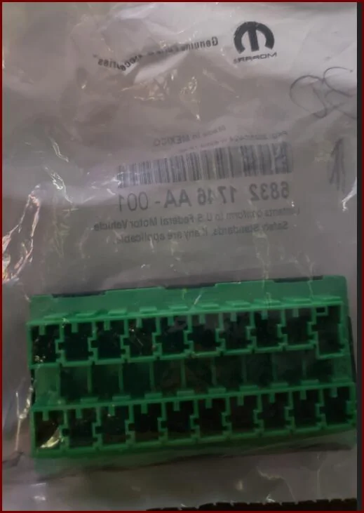

I did some research on JScan, I bought one of the top modules they recommended & the connectors, then downloaded JScan. Also with some research I’ve discovered it could be a green car bus. Has ANYONE had this issue before? If you have did you use JScan to find it? What ended up being the problem? I’m sick of it & beginning to have buyers remorse because it’s been nothing but a pavement princess & I can’t take it on the trails like it’s meant to be.
Jeep Wrangler JL 2018 JLUR nightmare 1751343184255-rz
Yes, your issue most likely is with the Can bus star connector part# 68321746AA. Bad solder joints on the PCB. I got the Christmas tree lights about 2 weeks ago, did some research and ordered that part. The part came in today. I was messing around with it on Friday morning looking over the PCB and put it back in to drive. Since my messing with it all the error codes have gone away. When it would act up the dash would say service 4wd, track sys, loss of speedo info ETC. , and one day lost power steering control. Ill be replacing that connector tomorrow/today after work. 90% confident thats the fix and should be good to go.
Purchased from Mopar Online Parts for 65$
Thank you! I’m currently looking on Mopar for that & potentially an auxiliary battery like someone mentioned above. I’m a little worried about the battery since they’re currently out of stock. I’m hoping it’s the can bus since it’s a much cheaper fix & my husband can do it.

My vote is the CANBUS. I had the same thing happen and replacing the CANBUS cured it. The CANBUS is where all of those sensors come together. Make sure to get a MOPAR part. Amazon has cheap Chinese knock offs that I wouldn't trust. It's an easy part to change, located behind the glove box. There are plenty of youtube videos showing how.
