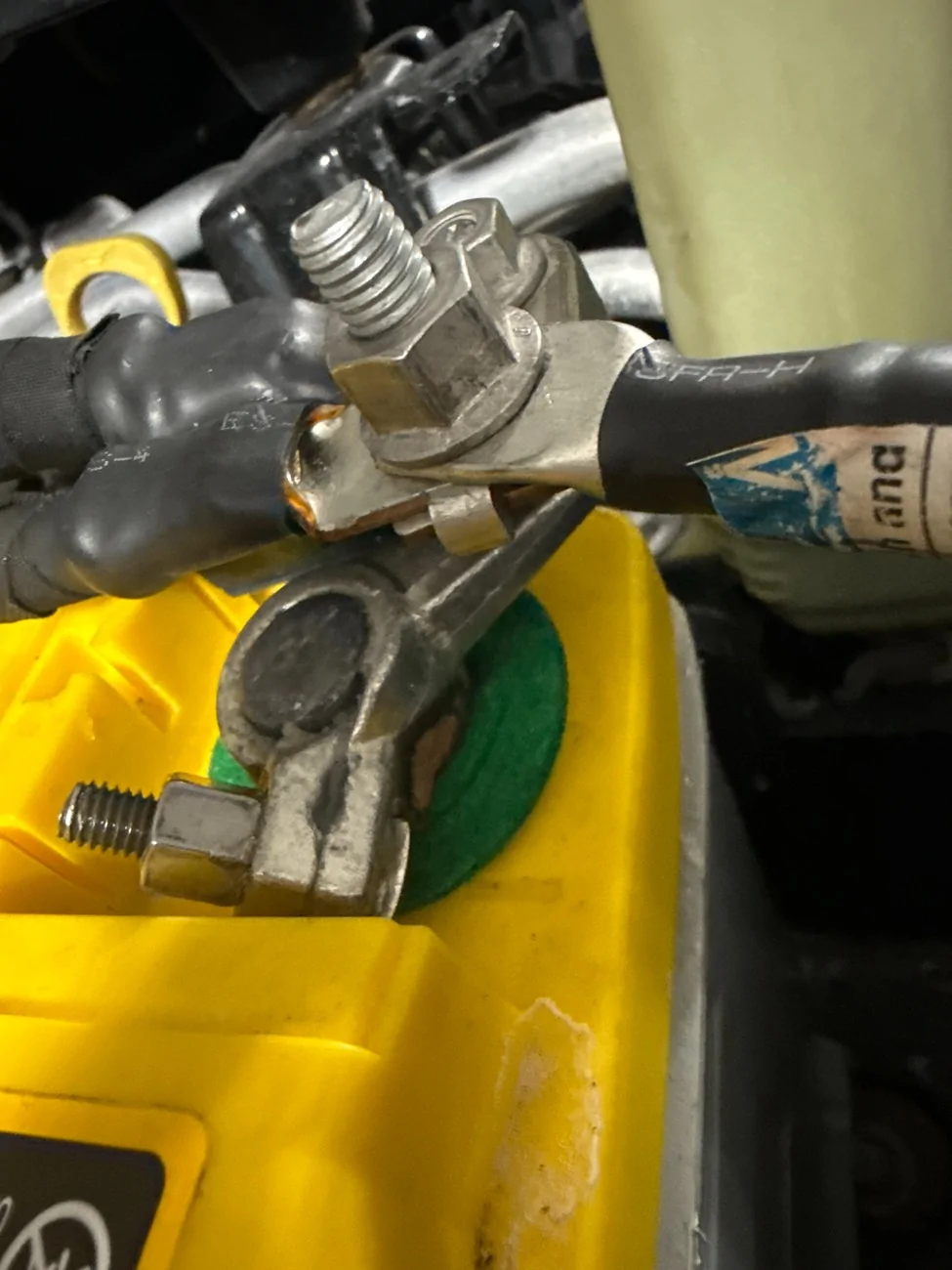

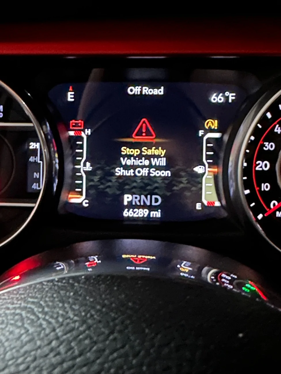

For the past a couple of weeks, I notice cold starts would crank slower. I did not think much of it because I really don't use the Jeep much anymore. A couple of days ago I was driving and got an "engine shut off soon", start stop light and battery light message and my display froze and jeep went limp. Luckily, I was close by my house and was able to park quickly, I noticed white residue on the main battery negative terminal, plus copper discoloration, nothing crazy. I remove the battery and aux to get tested at Autozone, main comes back fine - Aux comes back low and gets a free charge. Pick up 5-7 hours later and install. Turn on jeep (in the garage) and same light display and engine shut off soon message comes on.
Battery is an Optima DH6 AGM, only ~8 months old. Aux battery is ~2 years old (Autozone brand). Still in question, why did this battery cause copper discoloration, thinking faulty battery.

I now check and see if I can bypass the aux battery completely and just use the main by removing the aux battery and connecting the positive terminal from aux to the positive main terminal, same issue all lights come on. I then remove the negative line on the main battery that feeds the ESS system. I turn on the Jeep, and same message and lights turn on immediately after starting. So, bypassing the aux battery never worked for me. I turn off the engine and turn on to "run" only position and notice the battery is displaying 11.8V

  4. I attached a photo does the negative cable clamp need replacing?
Let me know your thoughts, experiences or a fix. Thanks!

As for guestion of negative battery post.
looks like clamp is bottomed out meaning it can’t be tightened anymore
I f you can wiggle/ move terminal clamp. That is loose connection that would explain corrosion on terminal.
I use. CRC brand terminal protective Spray on terminals
