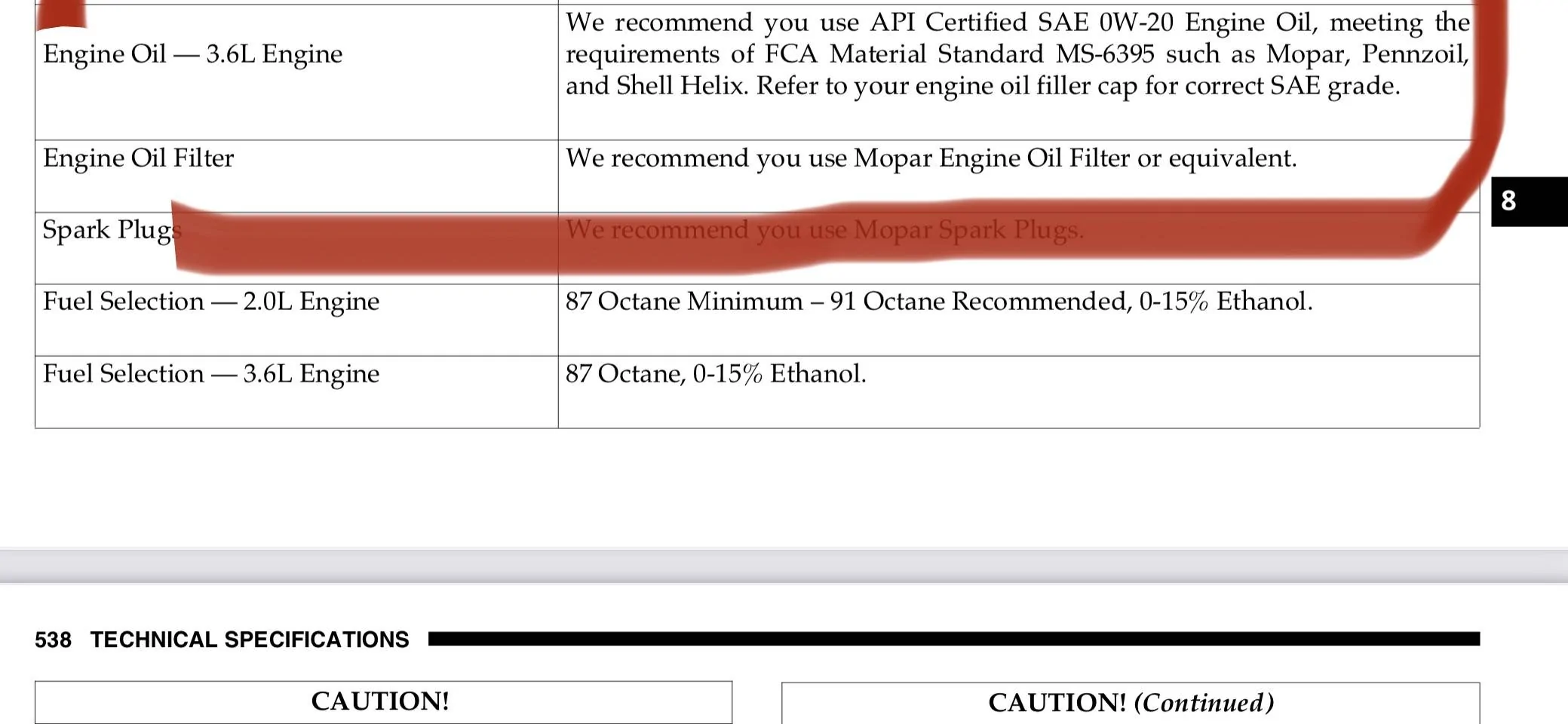

Remember The four-cylinder and the six cylinder have different oil requirements.
This is from the owners manual 3.6
Jeep Wrangler JL 2018 jl 3.6 sludge in engine? D524CB46-080B-4981-9AA0-4013F63B5BDF
Mobile 1 does not meet that specification.
Does it matter? I don’t know. But that’s a great excuse they can use for not paying for a new motor.

OP needs to get @JeepCares on this. The bad head gasket would compromise the oil with coolant quickly, cause it to break down, and sludge up. These engines are just not sludgers. Hell, if you ran a good brand 0w20 you could probably go 20k before it would oxidize enough to thicken up and begin to sludge. Most 0w20 oils are VERY good and are full synthetics. The only semi-syn I've seen is Pennzoil Gold, and you can't find it anywhere. It's darned good, too, though.
Almost all major brands are now MS6395 rated and if not, would pass that test with ease. Any API SP oil would blow that standard away.

Just FYI , Mobil 1 is not a Mopar approved oil per the owners manual spec. I Have been forcing myself to use Pennzoil ow-20 Ultra platinum. I wouldn’t tell jeep you were using that oil it might give them an excuse or reason to deny. I’m not saying which oil is better but jeep specifically requires a spec oil like pennzoil.
Yes, it is. When Stellantis took over, FCA's political issue with Mobil 1 came to an end. Mobil 1 is now labeled as meeting MS6395. Of course, it has always blown that standard into the weeds, by a long shot.

It’s not approved to Chrysler’s bologna spec. You don’t know as much as you think you do.
Yes, he does. Mobil 1 is now MS6395 certified, as I said before. Politics was the only reason it wasn't for a number of years.
Funny, whild FCA wouldn't let Mobil 1 have MS6395 certification, they did let them use it on their lower tier Supersyn oils, which were/are inferior (still good oil) to Mobil 1 oils. That's because they didn't compete with Shell's premium brands, like Pennzoil Platinum, as Mobil 1 does.
My Jeep dealership kept offering Mobil 1 with their premium oil changes in spite of lacking MS6395 labeling.
