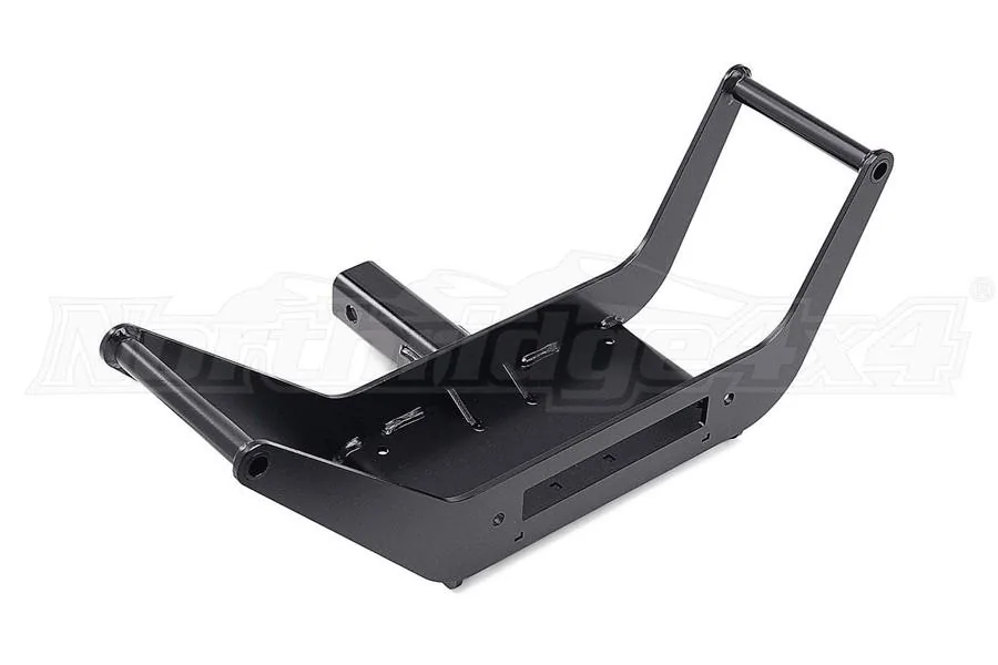

Had a setup on my old poorunner that used this Warn multi mount plate, receivers front and back. Thought I had the world beat, never once used it on the back bumper in 10+ years of wheeling that thing.
